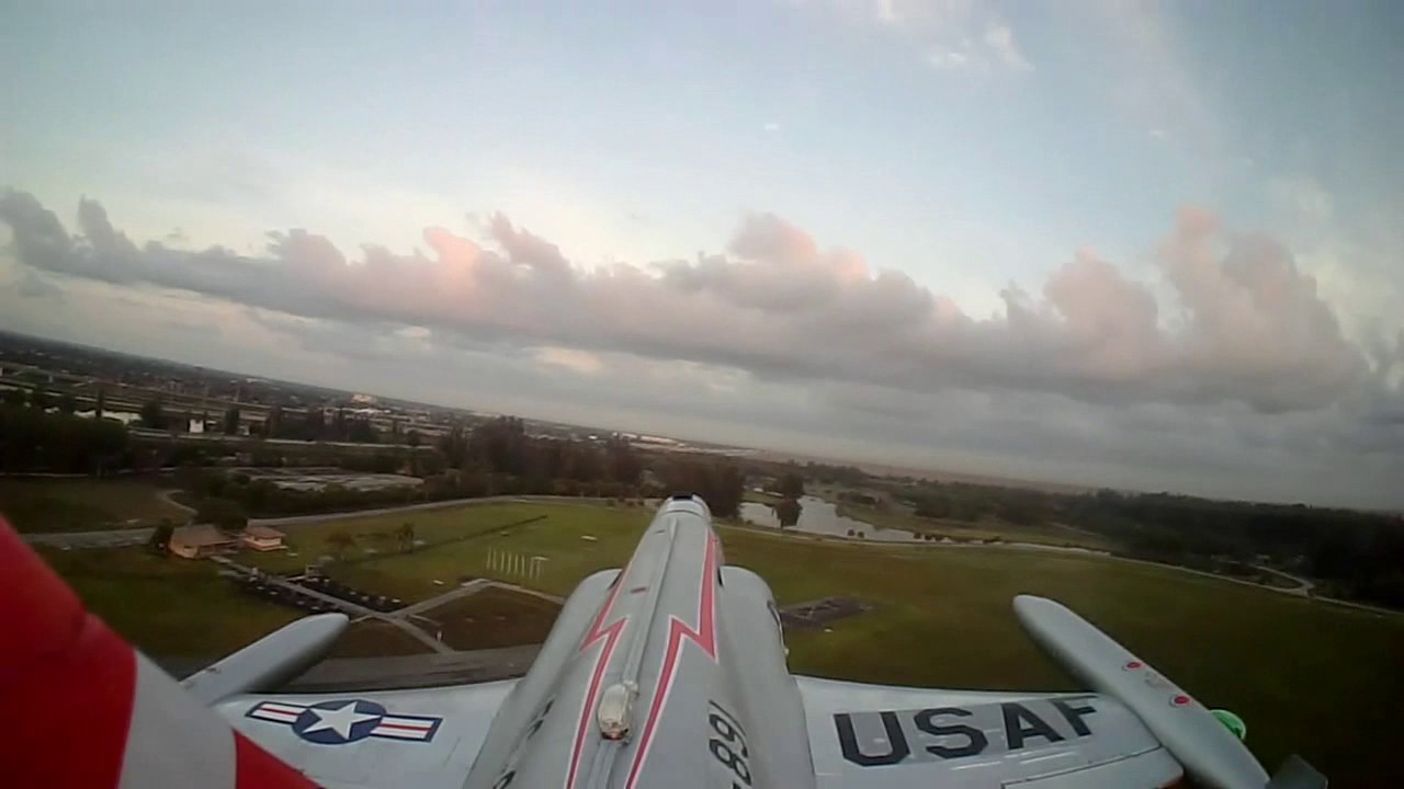

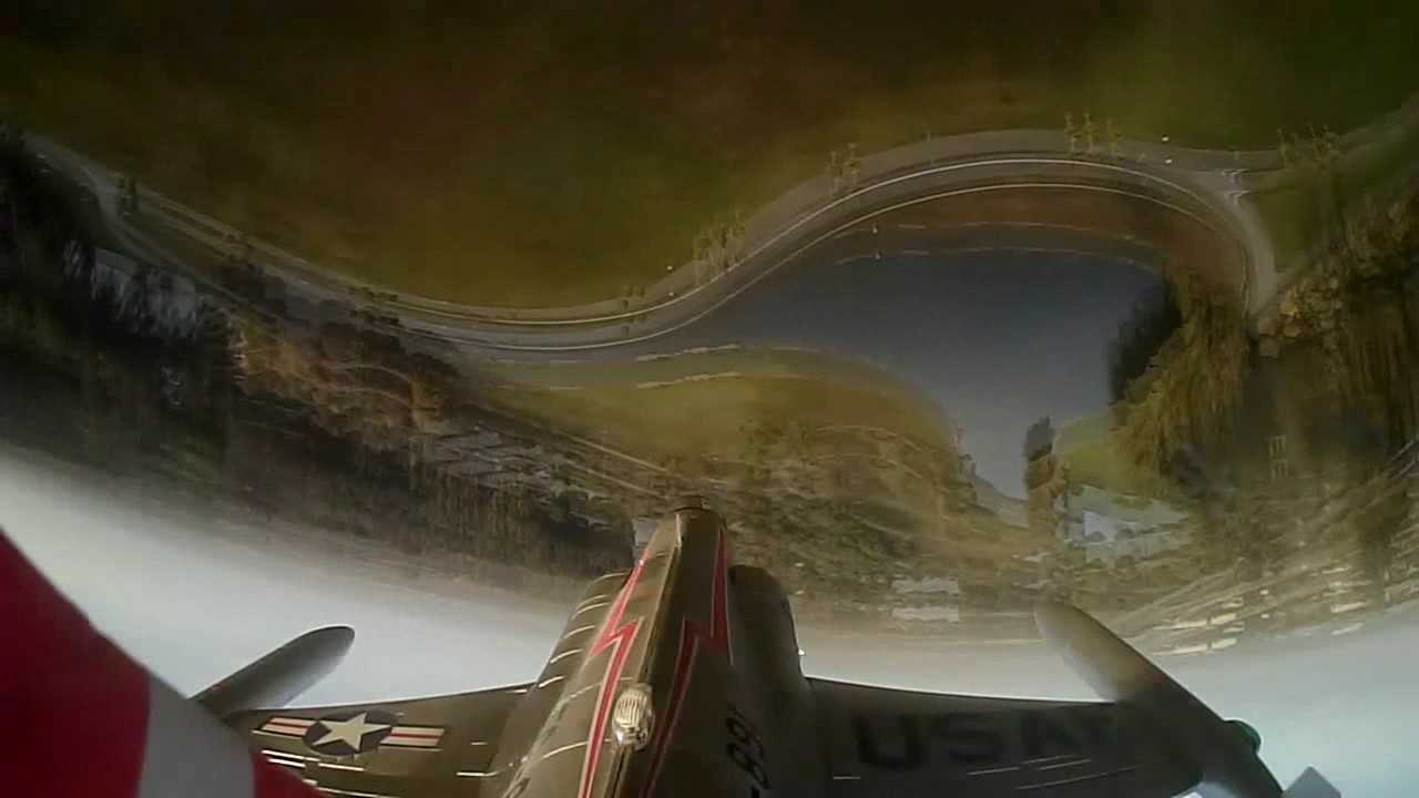

                  Morning flight.

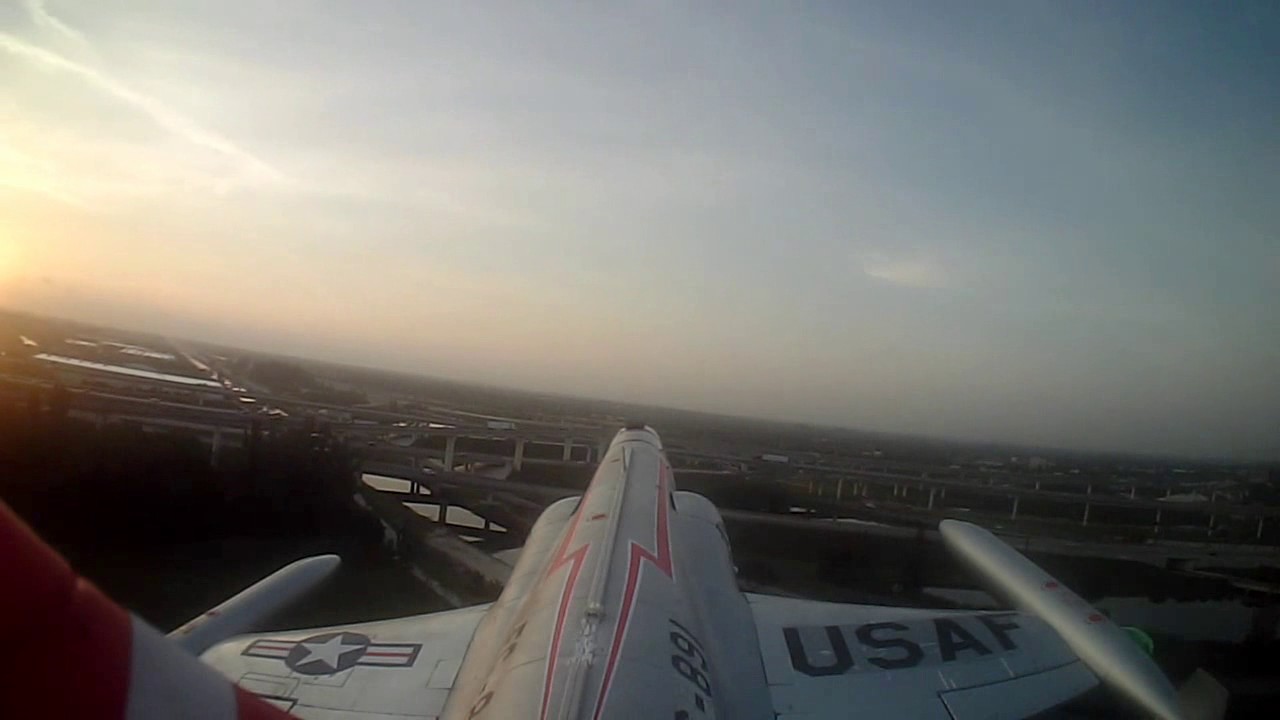

                      Morning flight.
