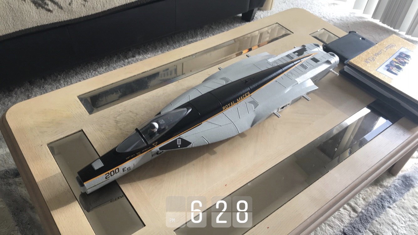

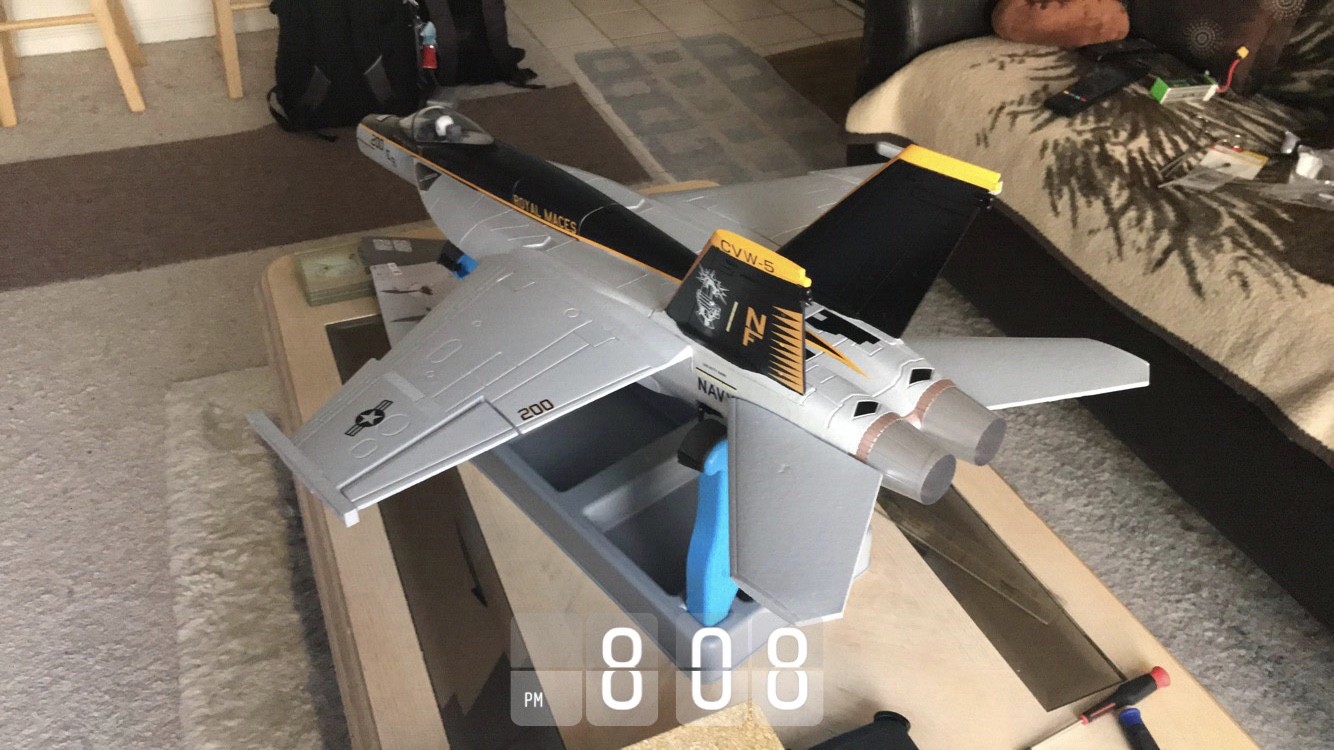

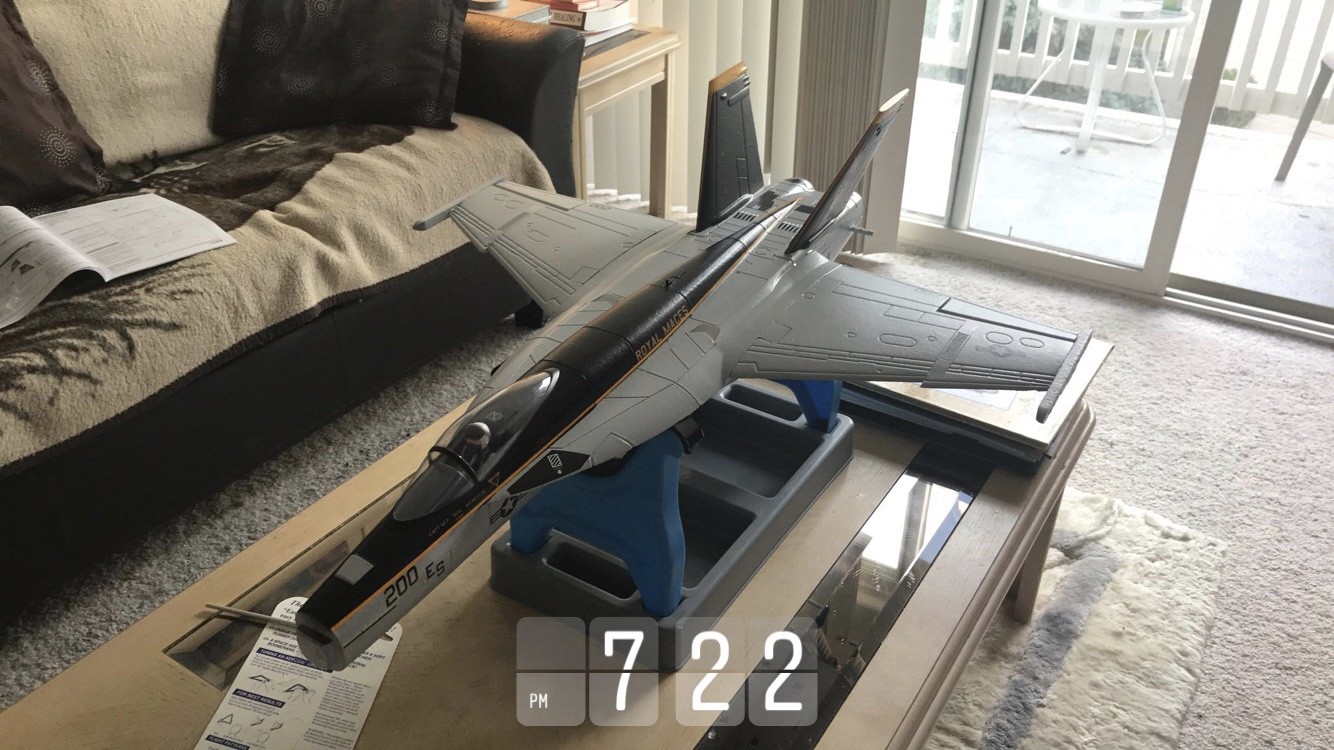

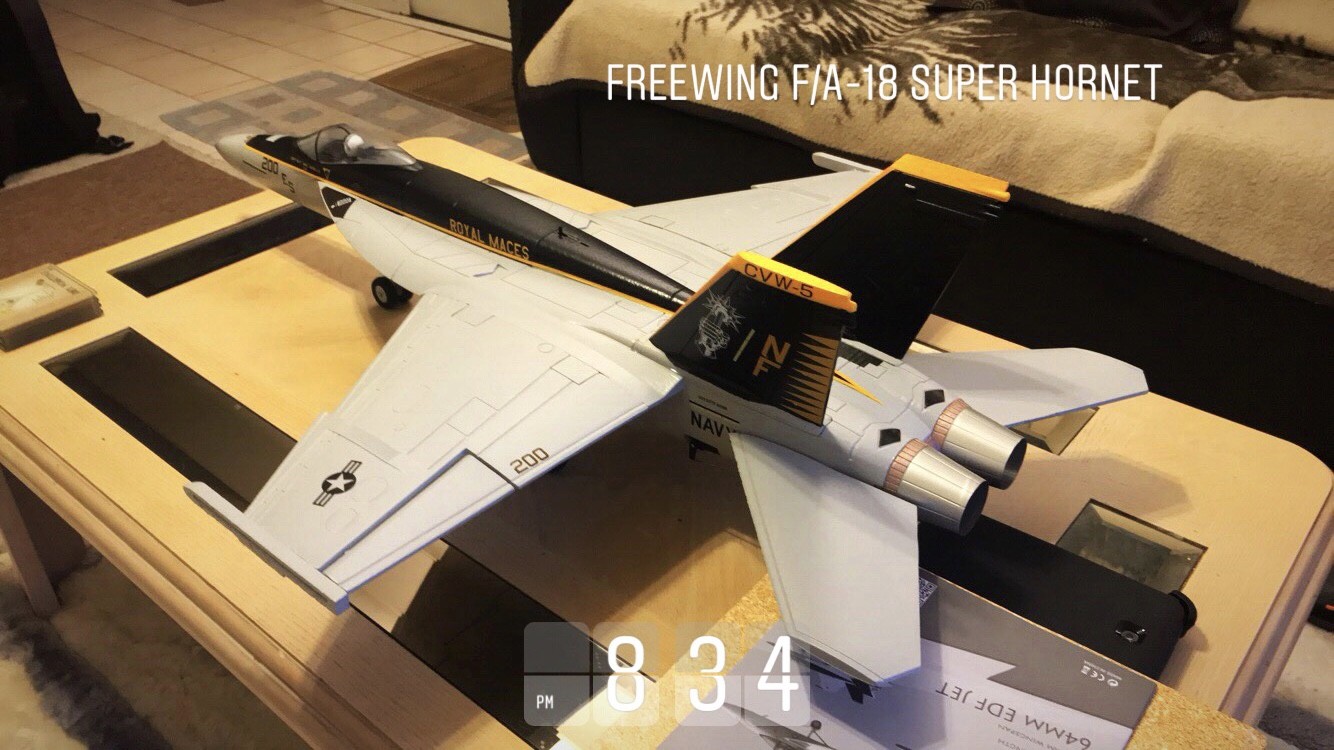

                          #32

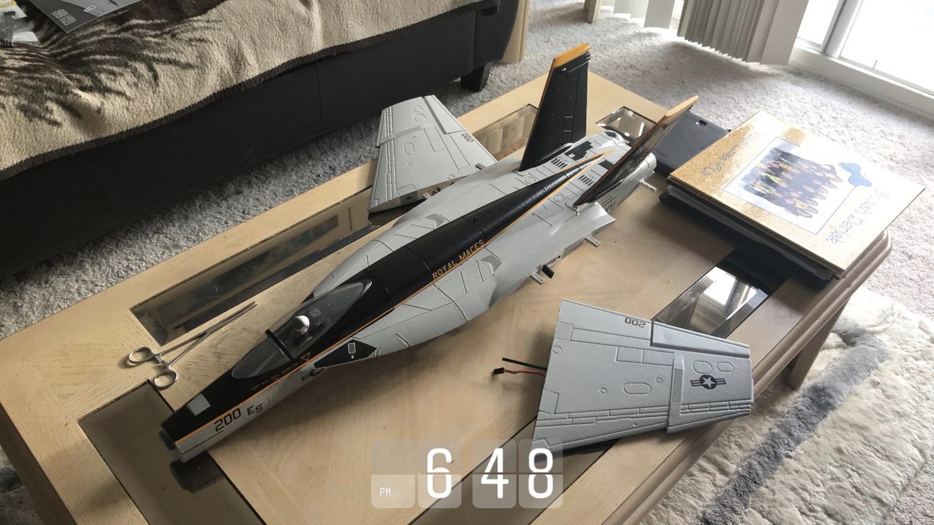

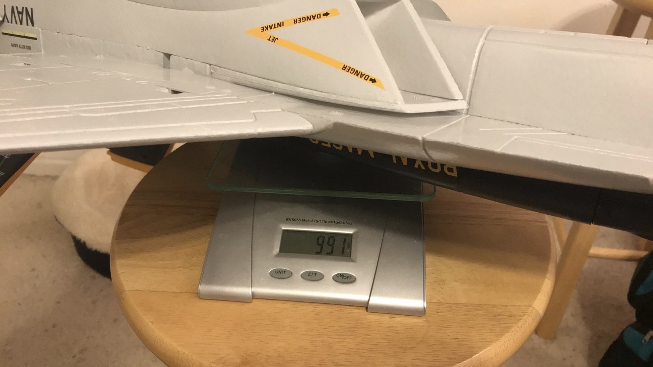

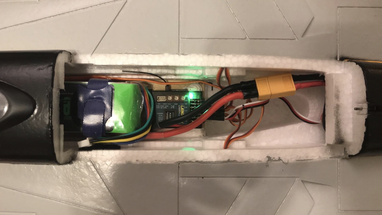

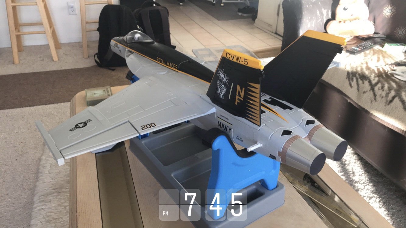

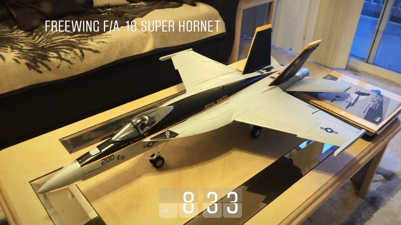

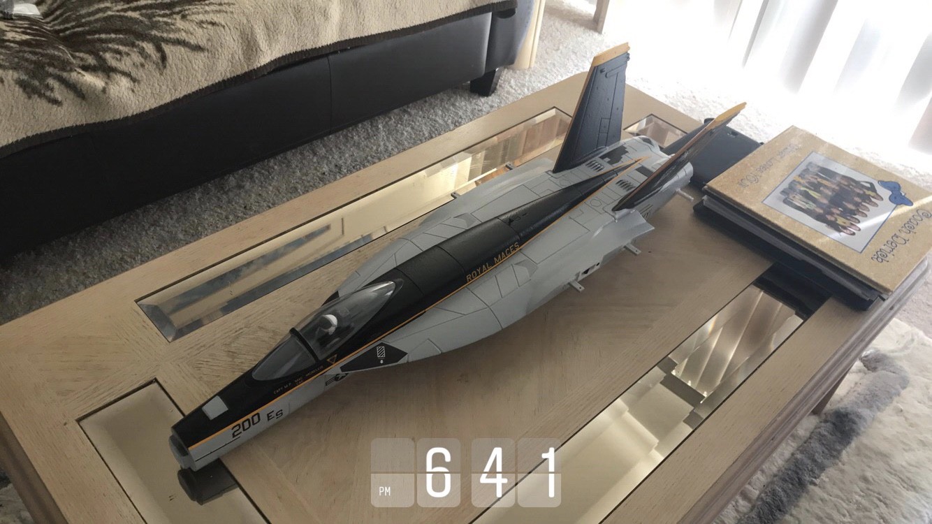

                          I finally completed the assembly and setup on mine. It took me a day to complete 2 coats of Minwax Satin Finish Polycrylic and an evening after work to assemble and tune (see photos below). All of the parts were individually coated prior to assembly.
                          The polycrylic process is always a hassle, but so worth it in the end. The finish looks awesome. I'll be using Pulse 4S 2250mAh 45C lipos which balance perfectly to the 65mm CG and have my rates set with a starting point of 80% on the Aileron and Elevator with 30% Expo on both. Timer is set to 3:10 mins. I also set up the gain settings on the Lemon RX 7-Ch Diversity Stabilizer / Receiver to the same gain settings that I use on my FW F-22 Raptor 64mm HP (which I believe has similar performance).

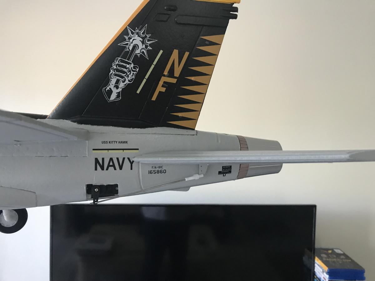

                          I did have a question on the Elevator angle... I have just 1-2mm of Up Trim on the Elevator Angle (just below the fuselage seam and on the "Navy" Decal). The manual didn't specify on this model specifically but I remember it calling for some Up Elevator angle on the FW F-22 Raptor. I wasn't sure if the F/A-18 required some Up Trim as well, so I just added a little bit. Is this correct?
                          Please let me know if I'm missing anything in my setup as well. I am intending this model to eventually be a hand launch / belly lander type (unless for some reason, the performance with the gears isn't as horrible as I think it will be.. though I doubt it since I was very underwhelmed when I flew my FW F-22 Raptor HP with the gears on.. it wasn't until I took the gears and the nose gear servo off that I was impressed). Thanks in advance!

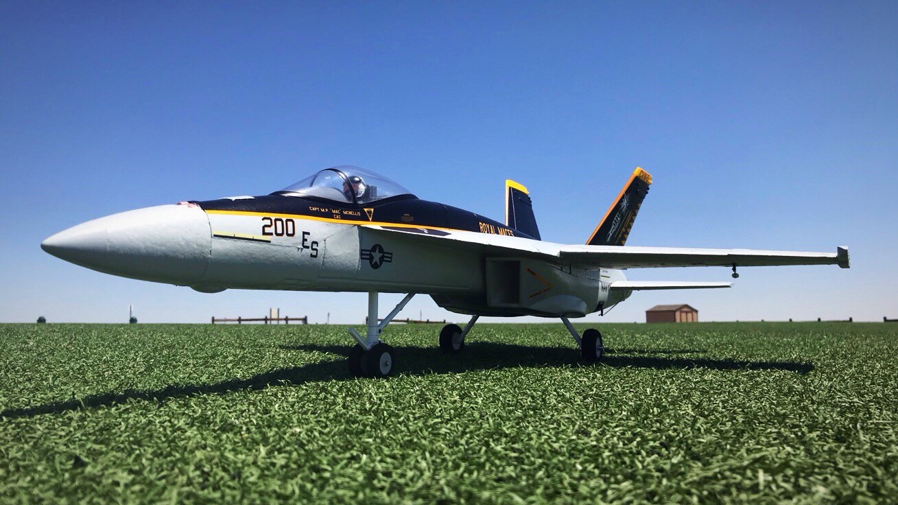

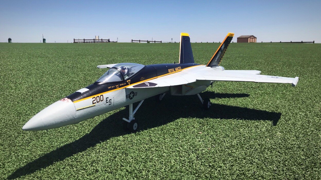

                              #34

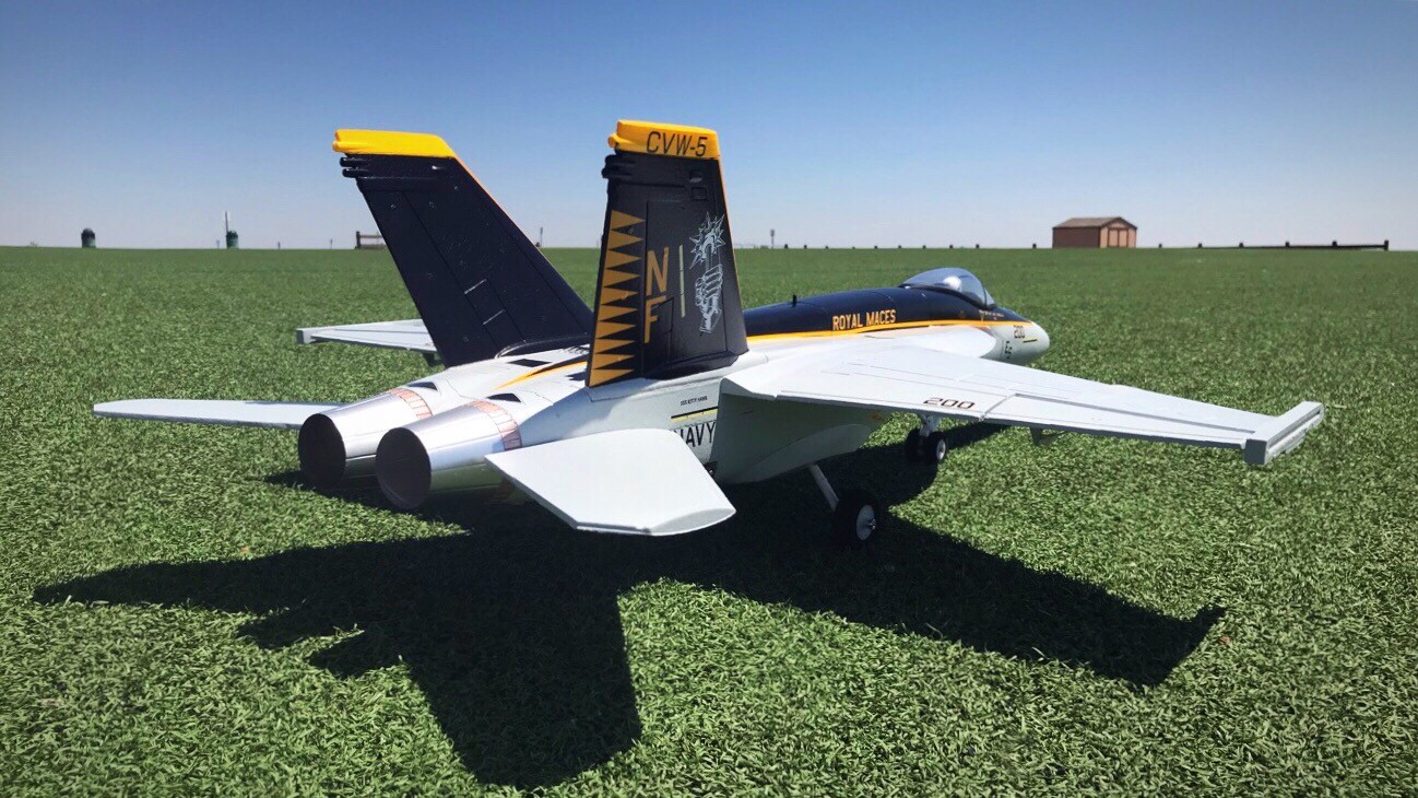

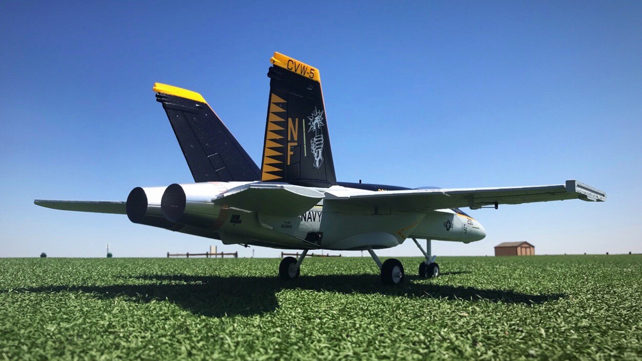

                              Maiden Flight Success! I took (4) Pulse 4S 2250mAh 45C lipos with me for the first flights today.
                              Flight #1 was spent trimming out the plane. Just 1 click of left aileron and 13 clicks of up elevator (-26 on the trim). After the flight I corrected the trims by using the Sub Trim function on the DX8 (G2). Landings with the Hornet can be deceiving.. it likes to float forever with 0% throttle, until it hits a critical slow speed point and then the sink rate suddenly increases. I had to abort the first landing as I overshot the double-wide lacrosse astroturf field I was flying at. I cut the altitude that I used in the first attempt, and had very minimal throttle until touchdown. Greased it in with a high alpha landing.
                              Flight #2 gave me a near scare on take-off. It all started normal, but midway through the roll-out, the Hornet rolled right on a smooth bump on the astroturf seam that separates the double wide astroturf field which acted like a ramp. Just at that time, I was pulling up on the elevator. These two actions caused the Hornet to lift off and rotate excessively right into a harrier / high alpha 10 feet off the ground. I quickly corrected by pushing down on the stick to drop the nose, and the Hornet responded, and I was able to avert a possible disaster as the Hornet accelerated into the sky. The rest of the flight was uneventful and spent getting a feel for the initial rates that I set according to the manual. Using the High Rate settings, I felt that 70% was too mild of a roll rate on Ailerons, so I bumped it to 80% and kept the Expo at 30%. Much Better. The Elevator however was very touchy and backed that down from 80% to 72% with 30% Expo. Now I felt the Hornet was significantly dialed in to my preference. Landing touchdown was more predictable with less of a high alpha touchdown and overall more greasy.
                              Flight #3, I decided to get creative and use that sloping seam "hillish" bump in the middle of double wide astroturf field to my advantage as a "take-off" ramp (like some of the ramps used on aircraft carriers). Full throttle on the rollout, the Hornet accelerated towards the sloping bump and as it rolled right over the bump, I stayed off of the elevator as the wheels gently lost its contact on the turf reaching takeoff without having to pull up on the elevator. A natural land-based takeoff ramp.. How useful is that?? The rest of the flight was spent wringing out the Hornet for flight characteristics as well as testing the gyro gain settings on the Lemon RX 7-Ch Diversity Stab/Receiver. Very stable and no oscillations with all the pots set at 10 O'clock.. the same settings used on my Freewing F-22 Raptor 64mm HP. Just perfect.
                              Flight #4 was spent just enjoying what the Freewing F/A-18E Super Hornet can do with the gears on. Its actually quite agile and spunky, despite it having 93 grams of landing gear weight (including the nose servo..). I'm eager to see how this performs as a hand launch / belly lander.
                              All flights were with the Timer set to 3:30 seconds, ending with roughly 30 seconds left on the timer and leaving the batts with an average of 3.80/cell. With the temp today currently at 97'F, the Hornet performed admirably in the hot Colorado air. Photos below taken post-flight.

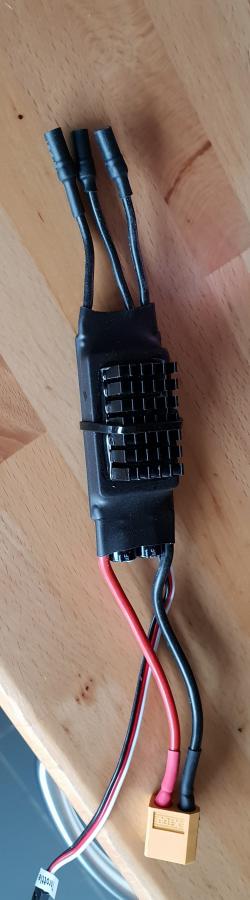

                                        I'm surprised by how well this plane flies.
                                        I have placed a heatsink in the ESC.
