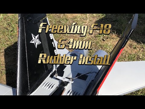

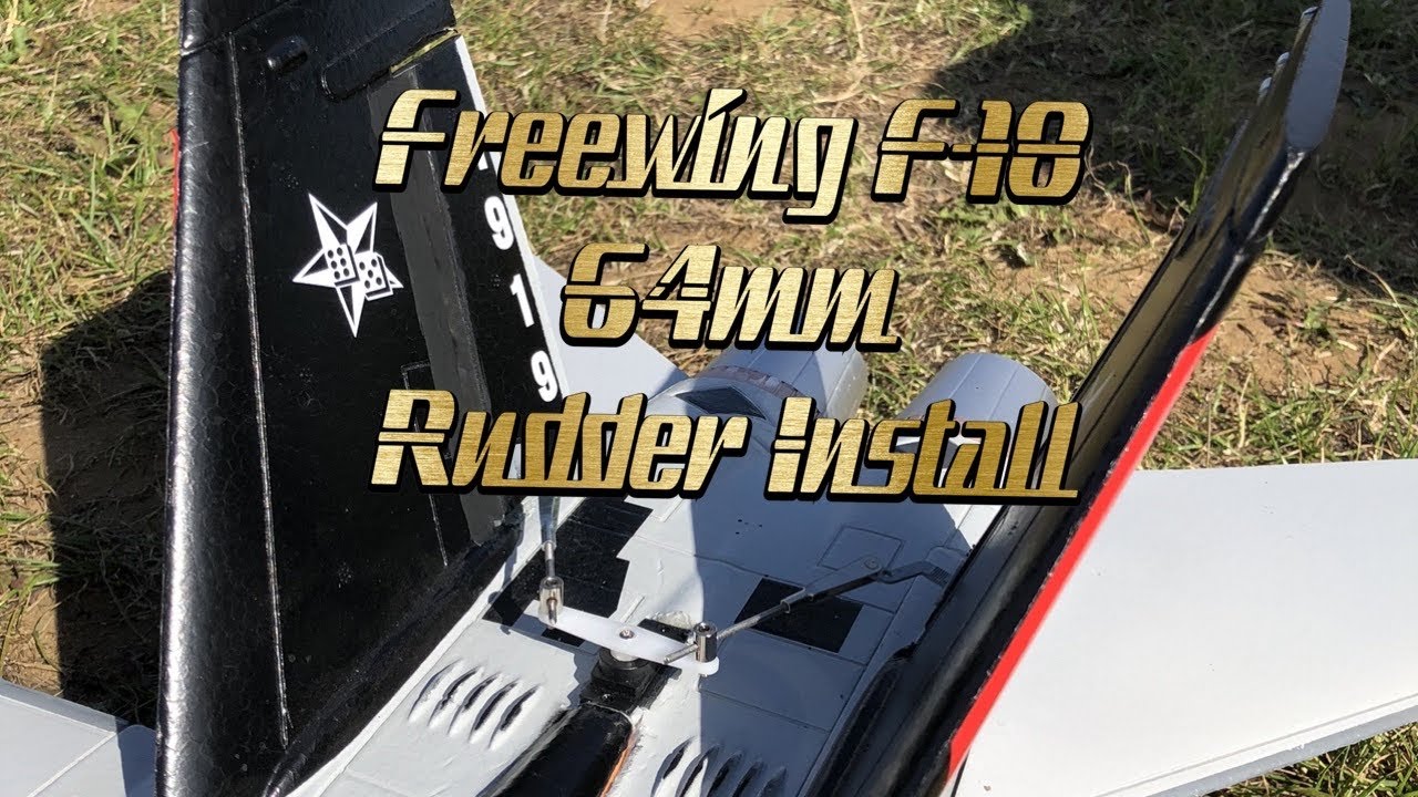

              Just test flown my rudder modification on my 4s 64mm F-18 ... what a difference! Rolls are now far more axial and I can swing the nose round in the turn to counter the adverse yaw mine seemed to have but most of all far more control in high Alpha.
              I used a Savox SH-0257mg (the only micro I had around) which is an amazing servo but at 12 grams perhaps not the lightest. Pushed the battery up into the nose so no extra weights required (I hand launch her so weight is important).

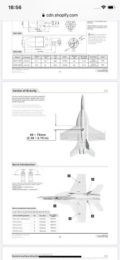

                Hi guys, I've also purchased this F18 64mm edf V2, I'm. Battling with the CG as per the manual 90mm to 100mm with a 4 cell 2200mah battery pushed all the way back it is too nose heavy. Could there be a different CG measurement from the leading edge of the wings. I see some comments say that they had better CG between 65mm and 70mm? Thanks
                • The43rdHammer
                  Smithy
                  • Aug 2019
                  • 118
                  • South East England
                  #68
                  I tried it at 70mm from the wing root glove, and for me it was too tail heavy, wanted to sit on its haunches throughout although it was still flyable.
                  My CG is closer to 60mm now and I slid the battery right up underneath the cockpit, it’s perfect for me.
                  The manual I’m looking at says 60-70mm from the the wing root glove.
                  • The43rdHammer
                    Smithy
                    • Aug 2019
                    • 118
                    #69
                    The CG should be more or less in line with the wing cuff on the leading edge if that helps any?
