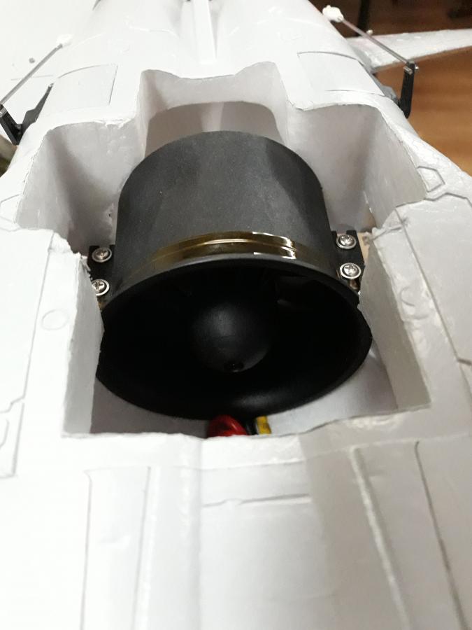

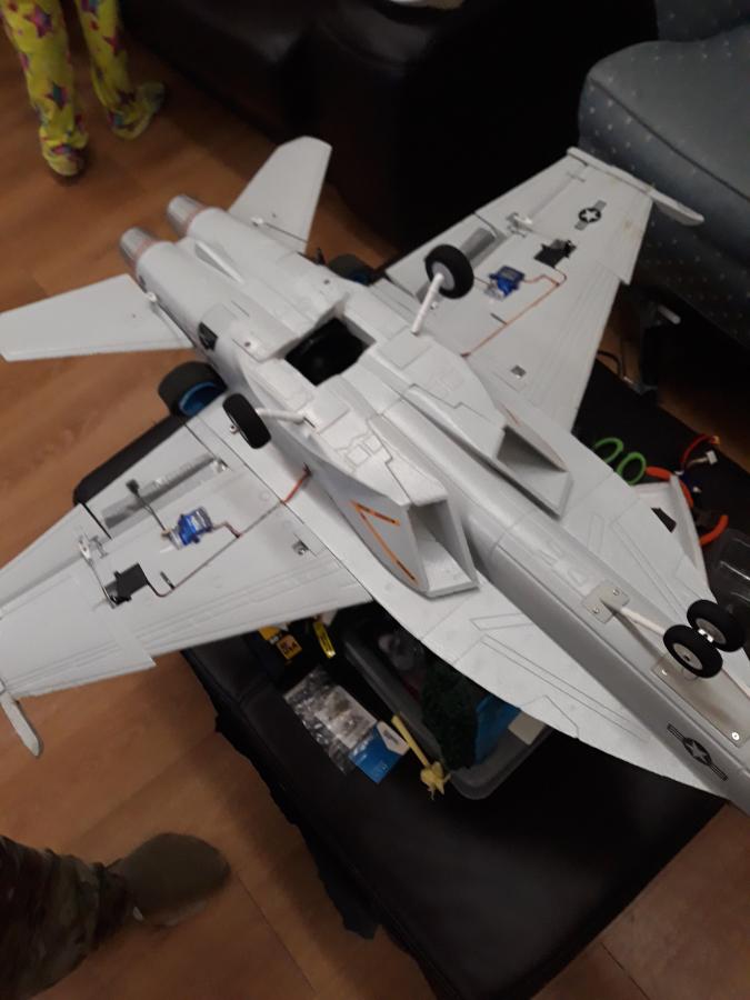

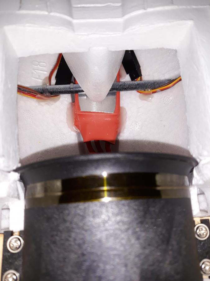

    Here are the pics of the mods. The 70mm power system is https://www.motionrc.com/products/fr...-w-2849-2850kv with a 60amp esc.
    I also wacked off about a half inch off the exhaust nozzles to lower the restriction of airflow being pushed out from the larger 70mm fan.

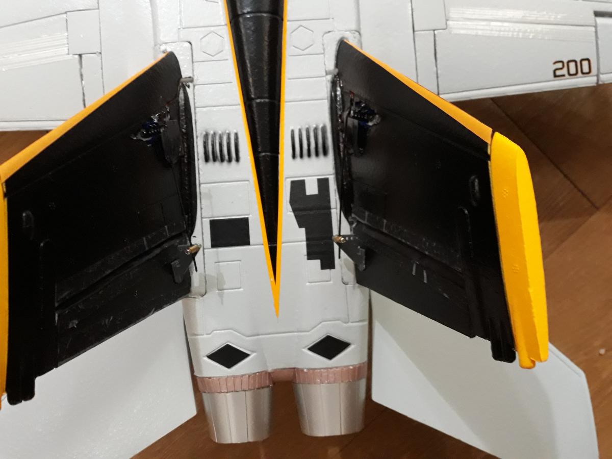

        I have, can't say as I've picked up anymore speed, but there is definitely more static thrust to get out of slow maneuvers and slightly shorter take off rolls. The rudders are very nice to have instead of just yanking and banking. The flap mod I did from day one right out of the box, I had about 30 or so flights on the original power system with the flap mod. Only thing I had to do for the extra weight of the upgraded power system and the rudder servos was to push my 4s 2200mah battery about an inch and a half through the nose wheel area, for the correct CG. All in all I am very happy with her now. Gonna try some bigger mah batteries soon.

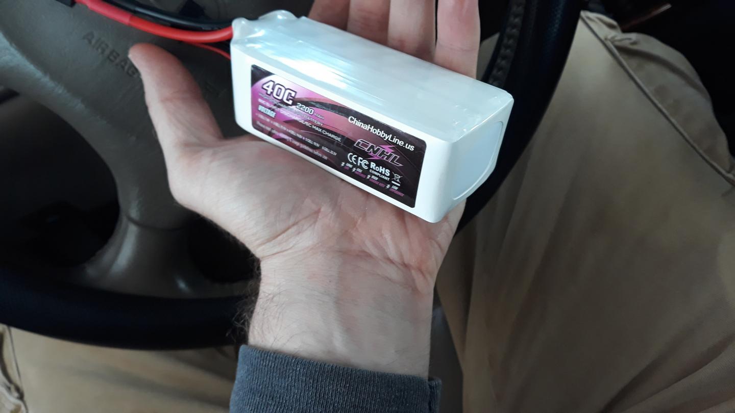

                  On a brighter note, I solves my power desires on this bird. After I switched the motor and fan for a larger 70mm, with an 60amp esc, I wasn't getting my desired thrust on 4s 2200mah 55c. Today however I dropped a 6s 2200mah 40c with 80c burst capability and damn! Unlimited vertical! The down side of course is about 2:15 worth of flight time with the battery landing at 30%.
                  I dented the nose a little after hot swapping the third battery on back to back flights. Rookie mistake, got to remember to let the esc cool down between flights. It had a thermal shut down on a low altitude high G turn. It was just so damn fun to finally see this jet come alive haha.

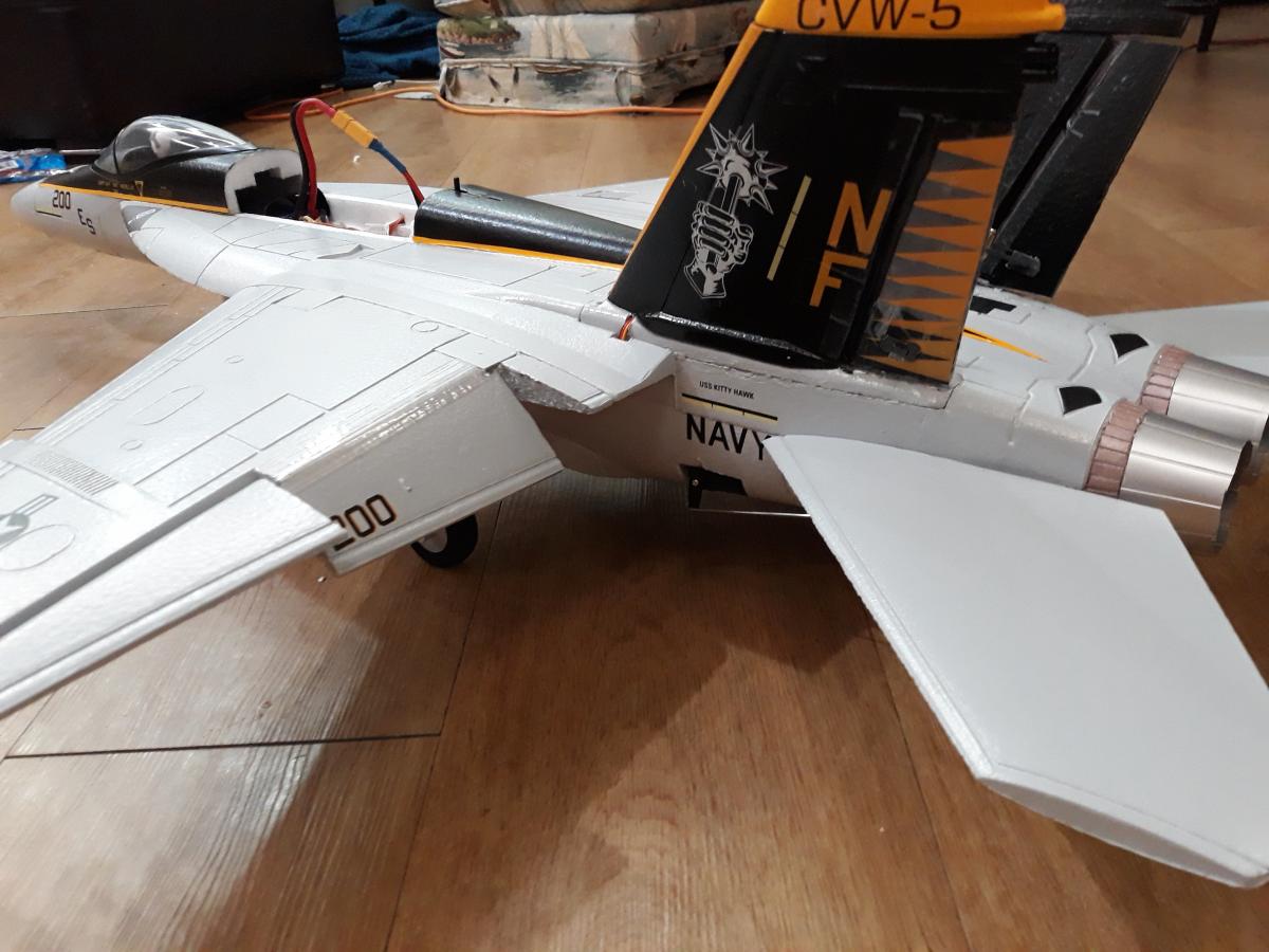

                    I made a few mods so it is easier on the eyes. I take all but the sidewinders off prior to flying.

                      wallacems I really like what you've done with your ordnance! May I ask what 3DP files you ended up using? Did you print from Thingiverse, or resize one of the other sets here, or design your own, or?
                      From a distance your bird looks like a 90mm, well done. Yours must make a nice wall display when it's not in the skies.

                            I used the missile and fuel tank set from the E-FLITE F-15 (painted them) and then used the mounts from an FMS 800MM P-51's fuel drop tanks. It works out great. The bottom tank is a 64mm F-16 wing drop tank that I used an FMS P-51 fuel drop tanks mounts to hang it underneath. I fly in a lot of wind here on the regular of 15 MPH or more, so I am seriously considering adding the rudder modification. The sidewinders were printed for me but I am not sure what file he used. I had to drill and run a rod through the missile into the wing to ensure it does not come off, but it flies more stable with the sidewinders on it.
