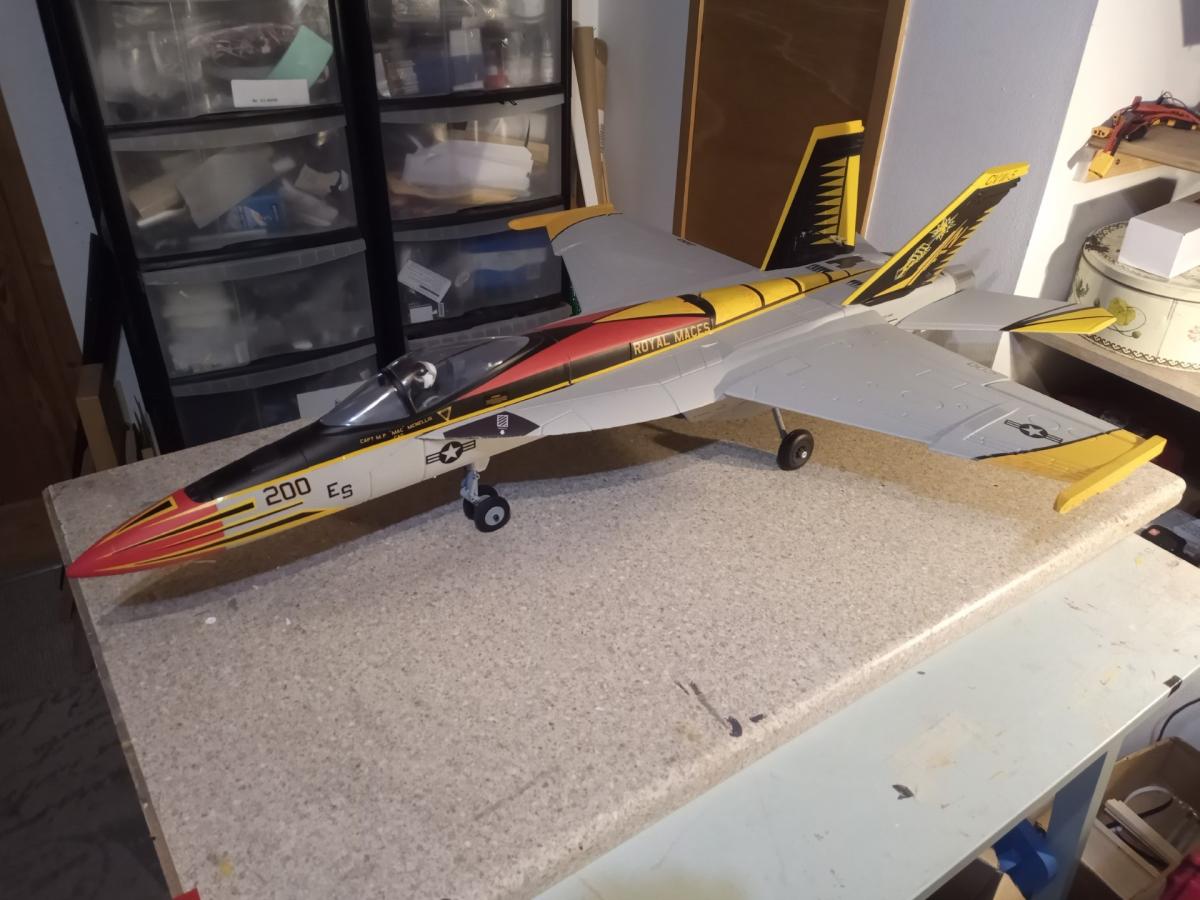

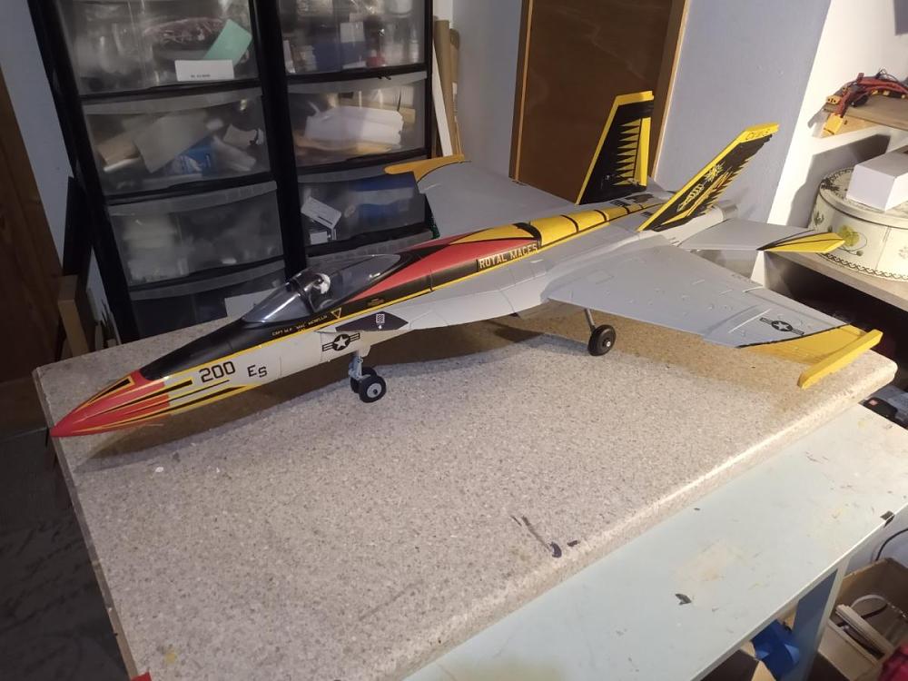

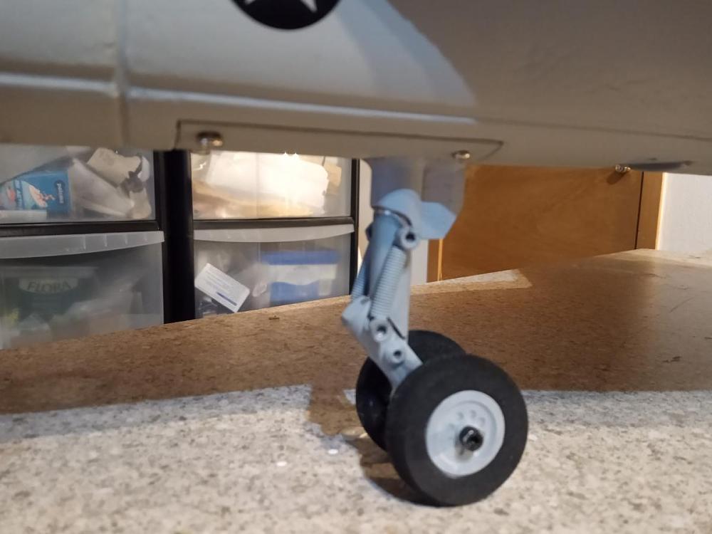

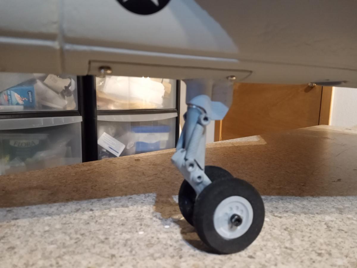

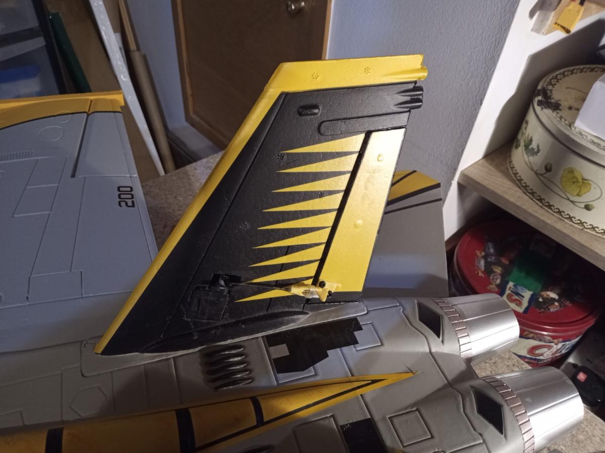

                                My Freewing F/A-18E Super Hornet. I have added working rudders and sprung nose leg and twin nose wheels, 2200mah 4s 60c lipo. Takeoff weight = 1075gms with Xfly 64mm dia 4s 12 blade fan, 2840 3200kv motor, 50amp esc. 1250 gms static thrust 1000 gms actual. Now waiting for Spring when our grass field will be rolled and cut.

                                  With individual and functioning rudders, and upgraded E-flite 2840-3150kv motor and esc from their F15.

                                    Nice setup! Do you mind sharing what servos you used and what parts you used for the nose wheel? I’m too nervous to fly mine without rudders, so I’ll be adding them before I maiden. Have you flown yours yet with that setup?

                                      Jason TGY-1440A 4.5g 0.6kgf analogue servo from Hobbyking or any 5gm 0.6 Kgf 8mm thick MAX THICKNESS FOR A NEAT FIT servo you can find with correct connector end will work i had these in stock from a few years ago and they worked well on my F22 64MM. the nose gear you cannot buy, I made this up from a unit I had in the old spares box fitted into a cf tube with ply angle bracket to create solid support. Had a dozen flights on my F22 64mm no problems. The nose gear works well off my grass field ( short grass ) and the rudders work well for wingovers, landing approaches etc see this to check out requred servo calcs https://www.radiocontrolinfo.com/inf...ne-calculator/​

                                        YAWspeed Jason. EMAX es9051 servos https://www.aliexpress.com/w/wholesa....home.search.0 also works also consider this
