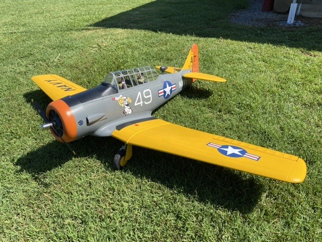

            • Picked up a PNP Eflite T-6 a few weeks ago to fly with my 32 year old son. We bought him one for Christmas last year. I got to fly it a while back and really liked the way it flew. They've been out of production for a bit but I was able to find one at Atlanta Hobby. I've always liked the Navy gray, yellow, orange scheme and was able to find applicable graphics from Callie. I installed an Admiral 6 channel stabilization receiver and Robart 3" wheels and the finished product flies amazing. My son's is still in tbe Air Force scheme and we regularly fly them in formation. Great airplane.

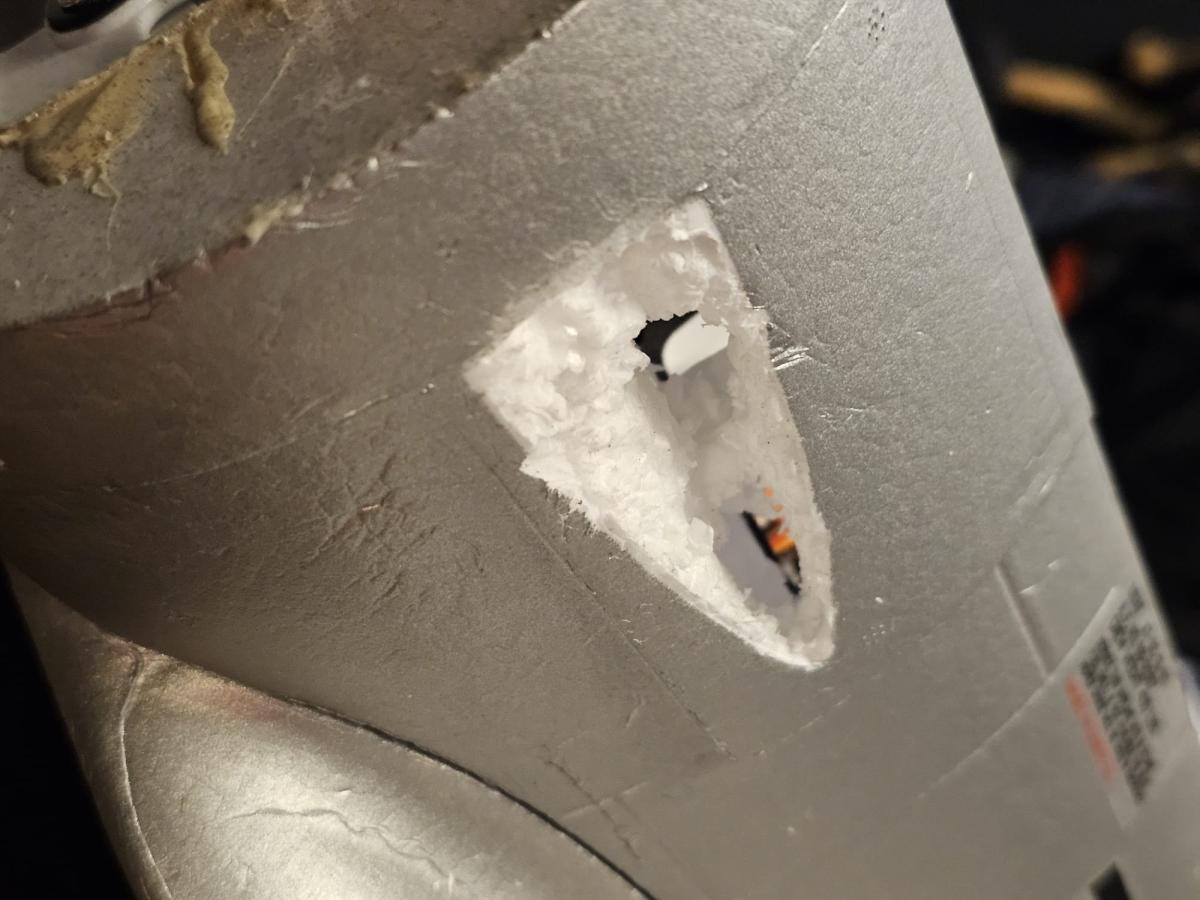

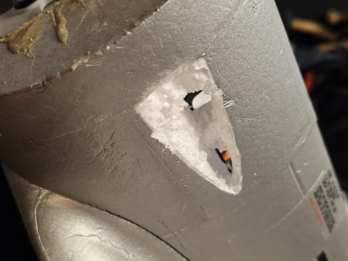

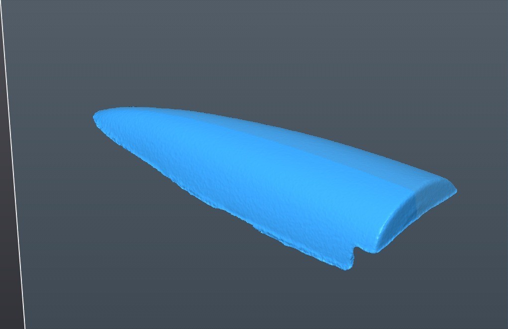

                      • oh boy... did I fell down a rabbit hole! I saw that they rereleased the T-6. I still had the V1 and loved her dearly, however, 3s was just really... meh... so I got the new motor and ESC. Easy fix and nice short project... right? NO! during the installation of the motor I noticed how much this fake air intake bothered me... so I 3d scanned the fake scoop and build a new one in cad and 3d printed it. To allow airflow I cut some holes in the side. Behind that will sit a also 3d printed rack holding the esc so it gets cooled a lot better than under the battery tray..... ok.. fixed...well the exaust looks really off.. the original one has a huge pipe coming out of there.. nonono we cant let that be.. so remove the original part, scan the area and create a drop in replacement you can 3d print... ah a lot better!! now I am done.... well.. the wheels kinda bother me too.. okay put some robart on... but they are way to skinny... kinda like the bulky look of the original wheels.. just cant stand the hubs.. okay lets design new hubs and cut the foam to fit! Easy!... oh the landing gear is lacking some details... i wonder if I can find a original production drawing from back in the days do 3d print super scale landing gear siccors. When I will be finished I will add all those parts to cults so you guys can upgrade your t-6 or SNJ too! Right now I am planing to make a Harvard style exaust in case thats more your thing, a tailhook and some antennas like the teardrop thingy aft the cockpit. If you have any suggestion please let me know!
                        AND SEND HELP!!

                        • The Exaust:
                          well thats a LOT better!

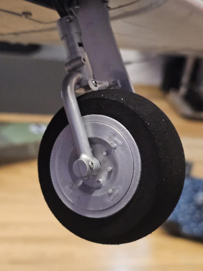

                          • The Original wheel:
                            and my first attempt. Not perfect but getting there!
ID:	445500Click image for larger version

                                here a quick peek and I think thats allready a 100 times better than the original E Flite MG Cover.
                                Click image for larger version  Name:	image.png Views:	0 Size:	973.2 KB ID:	445544Click image for larger version  Name:	image.png Views:	0 Size:	961.8 KB ID:	445545

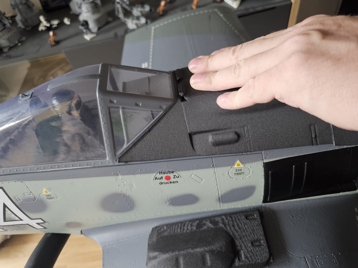

                                    No that was I belive Glasfiber reinforced ABS. I basically did the brute force approach and just scanned the FMS hood, scalled it roughly to size and then made a thin part out of the surface. Thats why details are pretty soft. And I guess it would be okayish but ... well I kinda have airplane autism so therefore its not good enough and I have to get better data :D even so, on a rational level, for a foamy that should allready be sufficient.
                                    I am dabbeling in LW materials a little bit but cant say I am a huge fan of them yet. PLA has the obvious problem with heat and I don´t want to get any deformed parts in summer, I am printing the HO 229 right now in Aero ASA which is a lot better temperature wise but also hard to print.
                                    But my oppinion right now is that the parts on the foamys like on the fms FW 190 are all made from ABS and if you print them thin enough it shouldnt be an issue. PLUS should i ever decide to share any files I want them to be as accessible to as many people as possible and don´t have the need for any expensive printers and super fineky materials. But I havnt made my mind up yet.
