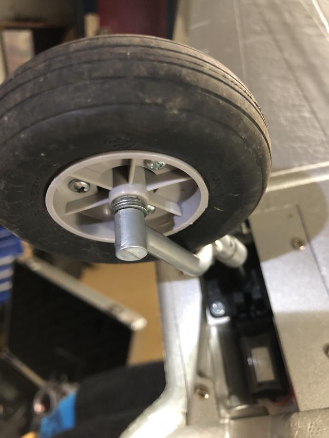

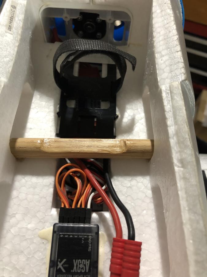

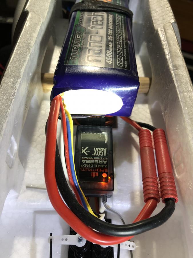

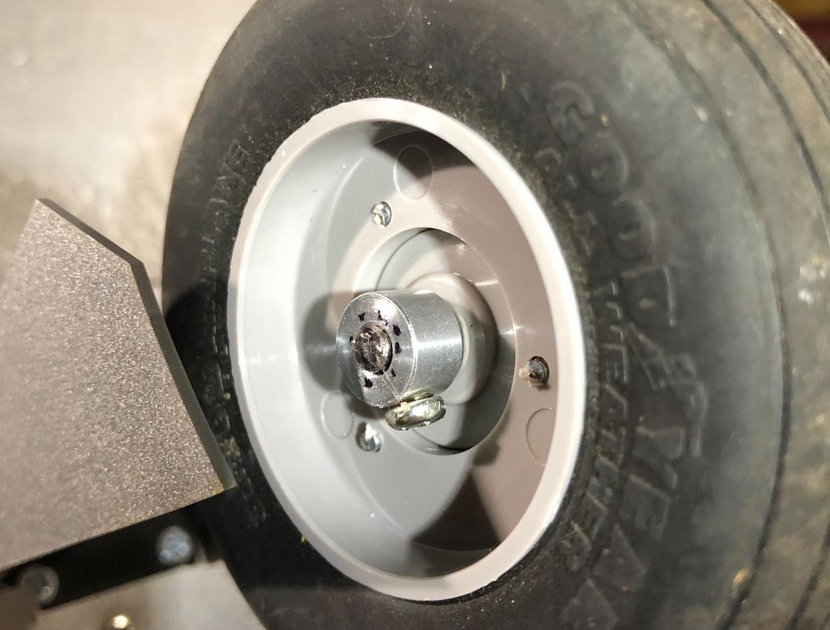

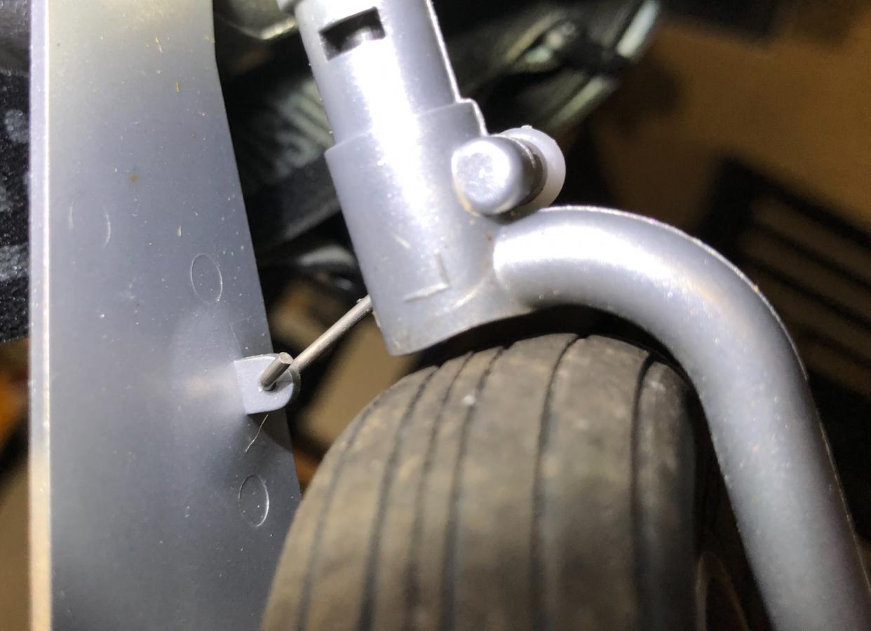

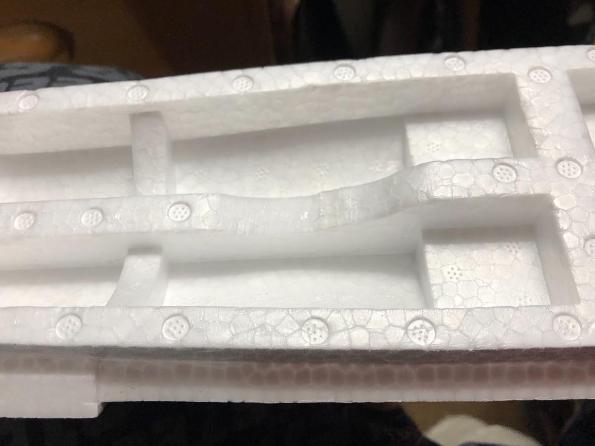

                      To add the 3 inch Robart scale tires you’ll need to sand the bottom of the strut until adequate clearance is achieved. They add washers for clearance when retracted and trim the excess off the axle so the hub cap fits on. I get 8 minute flights from my 4s 4500s and due to their length they conflict with the stock location of the Rx. I simply added a dowel to space the battery upward at the rear. Trimmed a lil off the canopy to fit.
                      I have flown in this 4s configuration a lot this past summer and like all the Eflite releases I’ve purchased, it does have AS3X installed. As stated prior it’s my go to beater warbird because I’m willing to fly it in conditions I would not fly my full on warbirds without gyros in. Growing up in control line then radio control none of the modern amenities that help fly the models smoothly existed so I’m still largely non-gyro in my fleet. But age is beginning to degrade my vision and reflexes slowly and it does help me to have the gyro in poor flying conditions. Therefor this model seems to always sneak aboard the truck in case conditions at the field are less than what I’d like and I really appreciate that .
