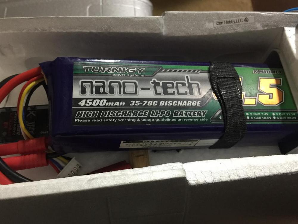

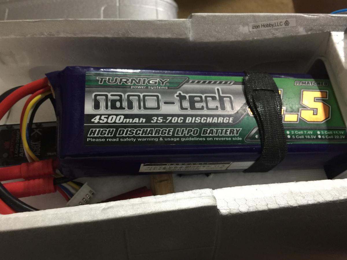

                  • #49

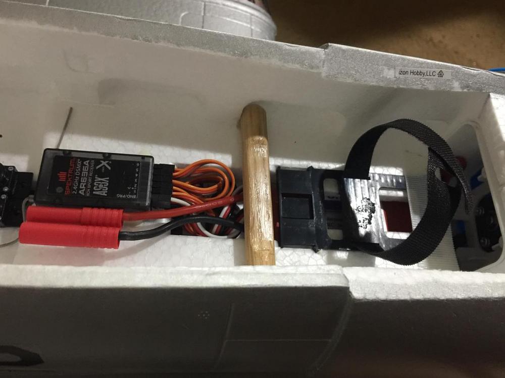

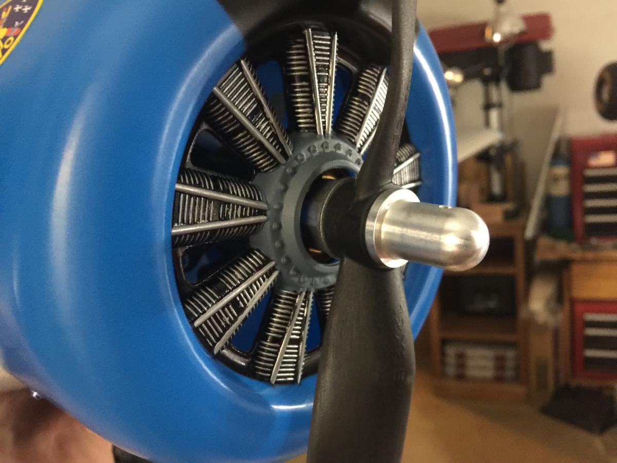

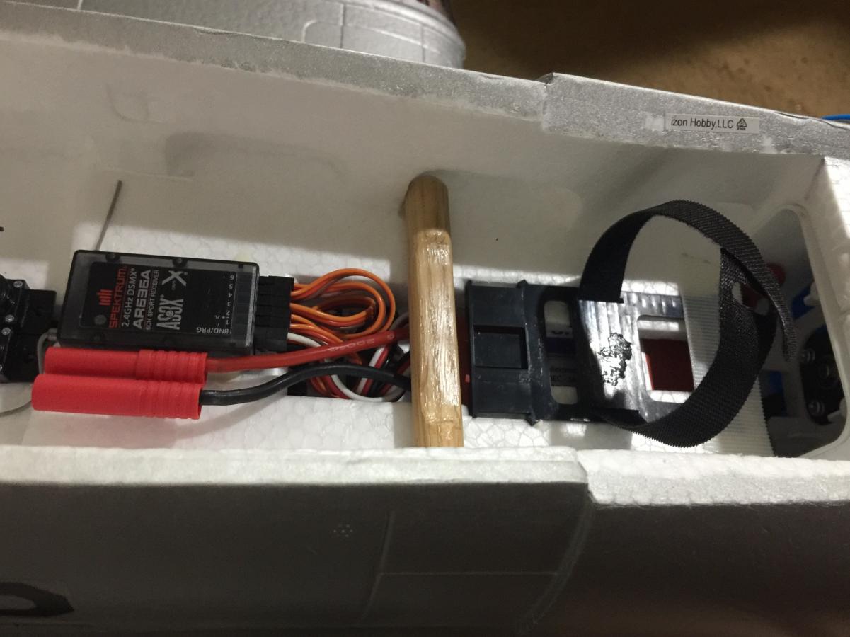

                    Get rid of the stock 2.5oz collet and spinner, replace that with a light aluminum version, I believe mine is from an old PZ T-28.
                    Remove the stock motor and pull the aluminum mount off. The FL3648 will bolt directly to that. Before you reinstall that, The esc is bigger so I use a small fish fillet knife to carefully open up the esc bay under the battery tray by reaching through the plastic motor mount. Remember to allow airflow around the entire esc for proper cooling. I also eased the motor mount open just slightly with a dremel so the esc would slide in. In the battery bay I added a piece of dowel at the aft end to raise the battery above the AS3X Rx. You could move the Rx aft a bit but I just used a dowel to make space. My canopy fit on with no trimming required.

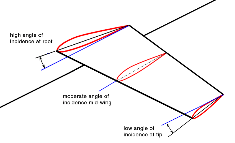

                          Many models are produced with little or typically no wingtip washout. This causes the entire wing to have the same angle of attack and therefore stall at the same time span wise. The term tip stall was never used in the aerodynamics class I attended in college. It’s a stall... Calling it a tip stall would indicate the wing tip has a greater angle of incidence than the wing root and therefore stall first. Full sized utility and trainer aircraft wings are designed with washout. Flying wings must have it!!! Stunt planes with symmetrical wings do not.
                          I flew the crap outta this AT-6 a month ago on 3s. this model can be slowed down to a crawl and hang above stall. My cg was at the forward most point. I was slowing it down so much doing full stall three point landings in calm conditions that I would loose effective airflow over my control surfaces as it sat down. It’s a ***** cat. Looking at the wing, it appears to have a small amount of wingtip washout molded in and this would certainly account for the wing stalling at the root first and not the entire wing stalling at the same time which would cause abrupt rolls at stall. With full flap and some wind, it will need to ride the prop in with some power.
                          I will say for the record, that when I fly, the rudder is the primary turning control surface. I always lead with rudder and follow with appropriate aileron control, whether it’s a normal input or cross control. Whatever is required for conditions. That way the fuselage is kept straight in flight and not sideways as in slipping, causing a drag source. I can takeoff, fly, and land without using the ailerons if need be. Practice that by setting a three channel model up with throttle n rudder on the left stick and only elevator on the right stick. Or, try n refuse to use aileron on the 4 channel set up.
                          Forget burning holes in the sky
                          With any new rc airplane, during maiden and initial flights, the most important thing you should be doing is testing how the model responds at stall. Several times!
                          Does it shudder or give any noticeable movement as it approaches stall, roll on a wing, or pitch straight forward during stall.
                          Exactly what does it do
                          Clean... with gear and flaps up
                          Dirty... with gear and flaps down
                          Dirty in a turn to final two mistakes high
                          Feel the model out entirely like you would do when you fly a real airplane.
                          Washout pictured...

                              Click image for larger version  Name:	84F01646-111C-4880-8439-C3259296A179.jpeg Views:	1 Size:	107.9 KB ID:	120533Click image for larger version  Name:	51FC4D69-6182-4D6D-AC18-36F51180E629.jpeg Views:	1 Size:	89.9 KB ID:	120532Click image for larger version  Name:	5EC4FD88-35B7-4CCD-9FB3-A89C35D3D266.jpeg Views:	1 Size:	103.6 KB ID:	120531
                              I flew this 4s set up today several times. Winds were 5mph straight down the runway with mild gusts. The airframe was right at home with the added weight and the power was just what was needed. No flap three point full stall landings were still a snap. Such a *****cat... She loves 4s way more than 3s and so do I...!!!!

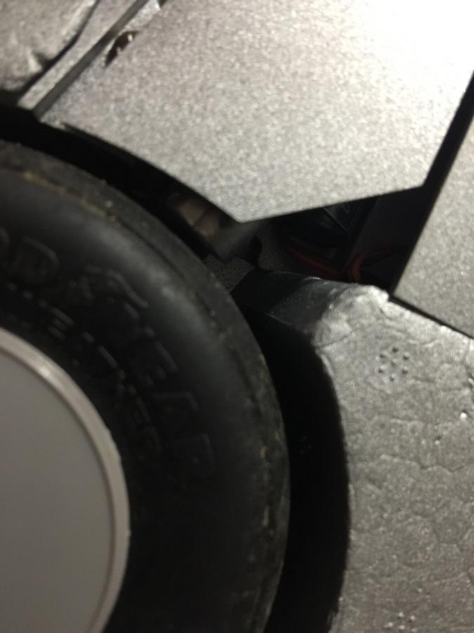

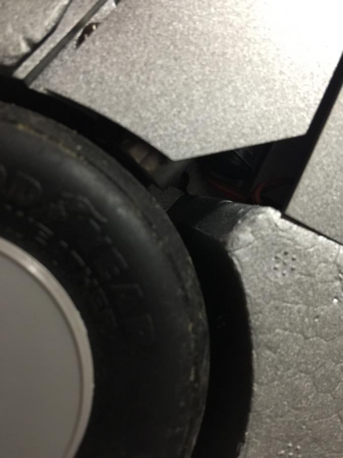

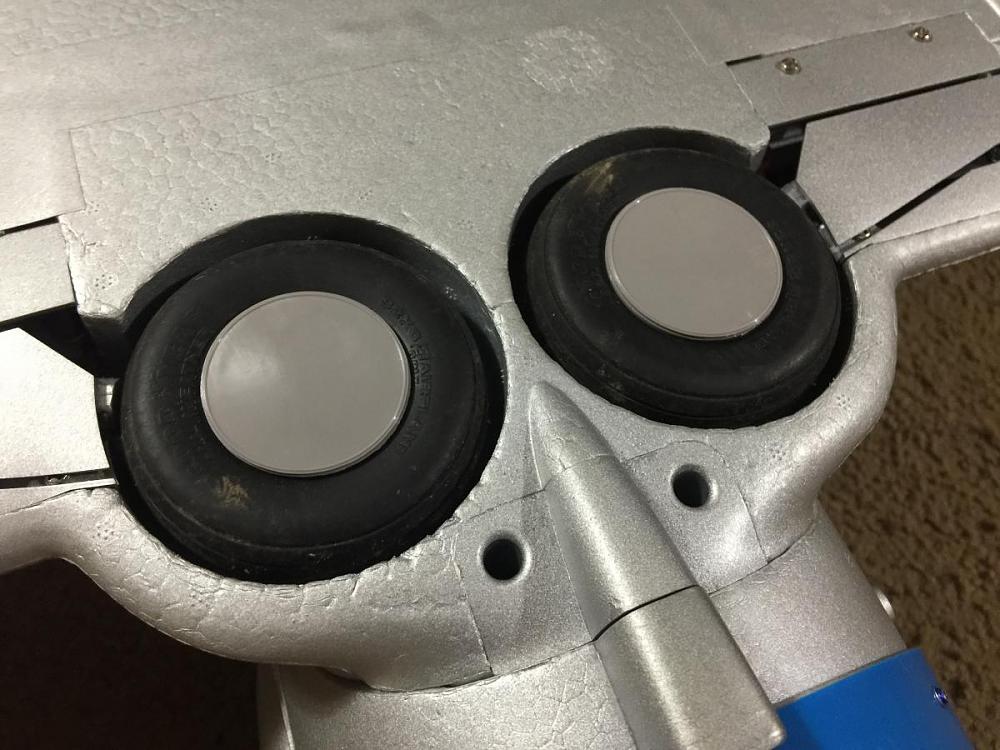

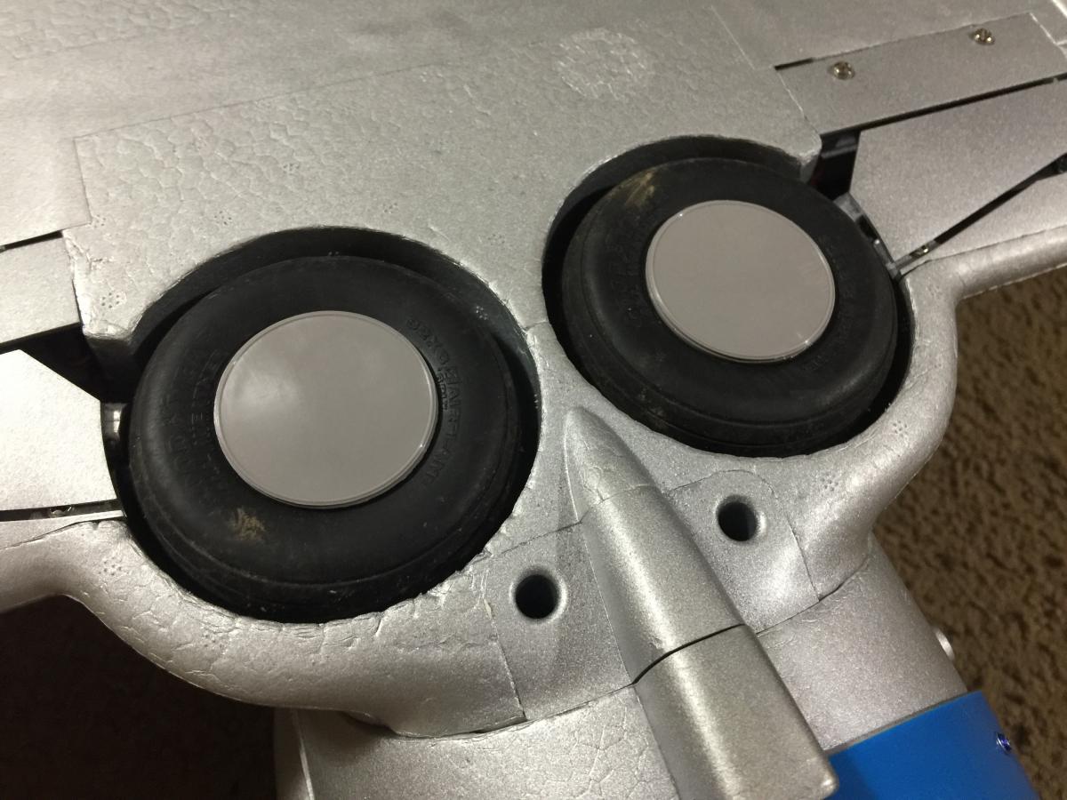

                                  The airframe is large enough that 4s is a non-issue weight wise. I always upgrade tires to Robart scale wheels. Hard foam factory tires absorb little shock. On this bird I trimmed off about 1/8 inch or so of the lower strut plastic so 3 inch Robart scale wheels would fit. It tracks great, gives better shock absorption, and looks much more scale now. I fly from a rough surface and the gear are doing just fine.
                                  Once you upgrade to 4s it’s going to be obvious that this is where the model should be.

                                  • #57
