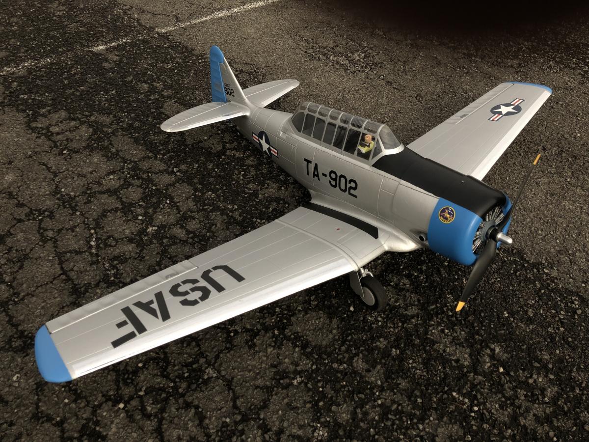

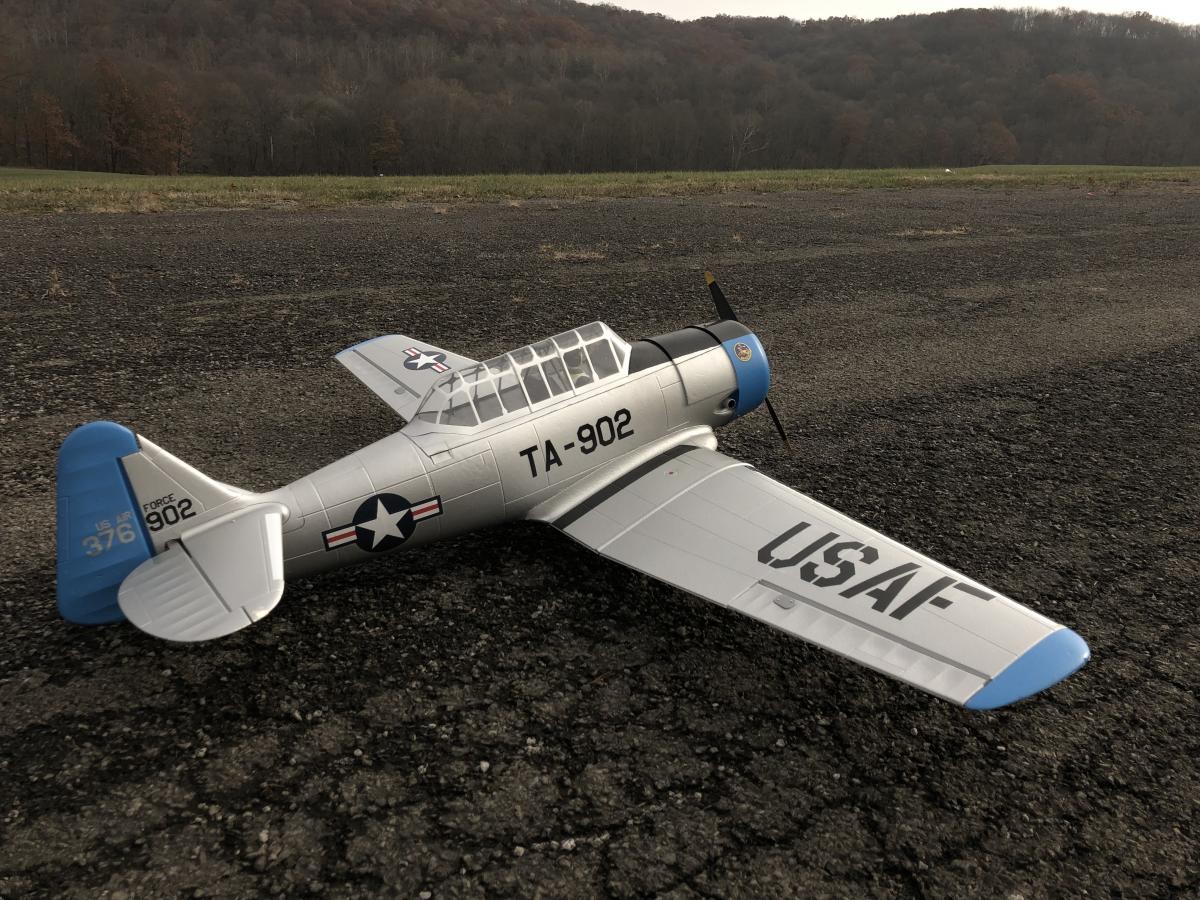

        While both are available I used our rough runway as it provided the most bounce factor, grass will help muffle it a bit. Grass will have to be trimmed short as the prop really hangs down on this bird.
        You can see how rough our pavement has gotten. It’s why I’ve been shifting to bigger models. We have no control of paving as it’s owned by County Parks... Perhaps we’ll be all grass with a rock runway soon.

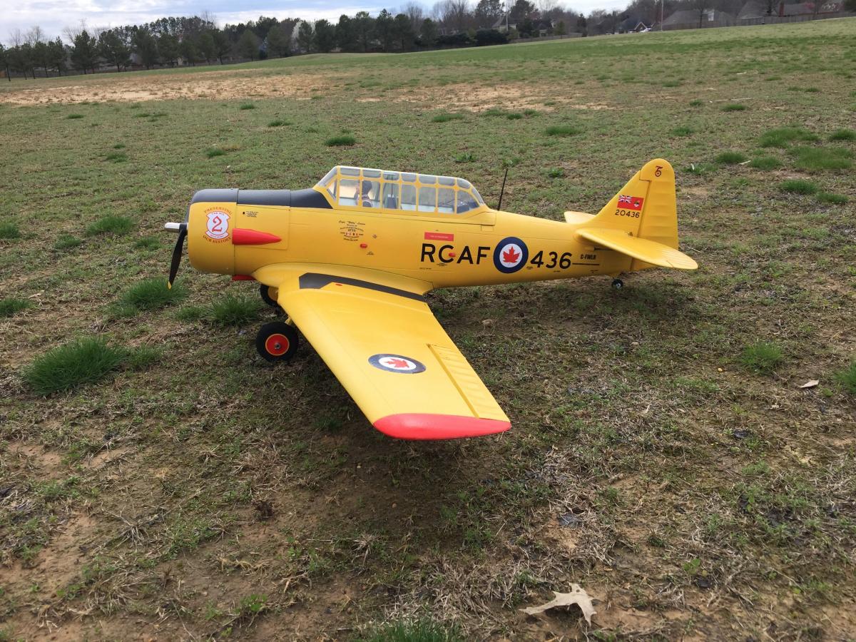

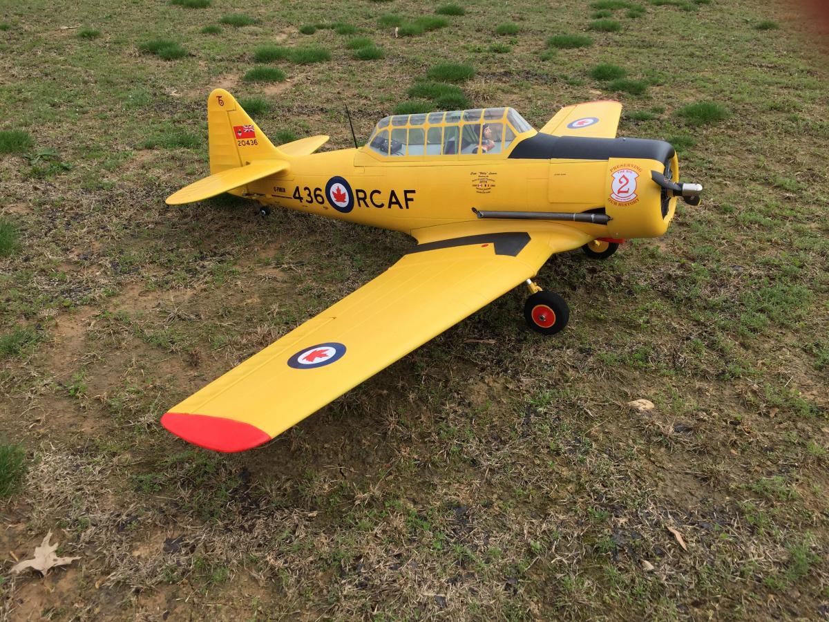

                                  Finished the wrap on this plane, with help from Callie. With a little luck I will maiden this weekend. The scheme is actually a little on the boring side, but I like stuff with a local flavor. The up side is, it should be easy to see against about any sky;-)

                                        Maiden + 4 flights today. All went well, this is a very nice flying plane. I need to order a couple of Admiral 3700s for this one.
