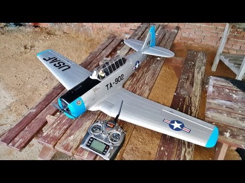

                                  Here's one right here
                                  • #37
                                    In the video it appears the AT-6 is stock. I do not recommend just tossing a 4s in!
                                    The stock motor in the bird is the venerable 15-980kv that was originally used to power all the heavier ParkZone warbirds on 3s with 10” props. Using a 12” prop on 4s loads it up way too much!
                                    I agree with TomC that these motors will take a beating and the prop will have to be downsized to accommodate the added load. Keep the amp draw at 50-55max for sure. Anything over 55amp and the motor will cook.
                                    Due to the larger airframe and slightly added weight of the AT-6, I have pulled both stock esc and motor out. I installed a 60amp Turnigy Plush esc with a FlightLine 3648-880kv motor and will run those on a 4s 4500mAh battery. I can now also use a 12” prop to help get around the big cowl. The airframe is plenty big enough to handle it all and any added weight will be welcome on windy days. Don’t know if any of you have weighed the stock spinner on this plane but at 2.5ozs it’s another bandaid to add nose weight flying a small 3s system on what should be a 4s bird.
                                    Ill use the stock motor n esc to power a smaller model.
                                    Amp tests with a 12x8 prop
                                    20amp 1/2 throttle
                                    36amp 3/4 throttle
                                    55amp wot
                                    The weather here is warming up so perhaps I can fly it before long.

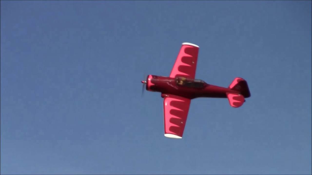

                                      Hey fellow AT-6 fans,
                                      The old Top Flite AT-6 has been around for quite awhile, and I recently came across this one at the Arizona Electric Festival in Mesa Arizona last weekend. She's roughly the same size as the new E-flite AT-6, but is a "built-up", using balsa, ply and covering in an ARF format...
                                      She's been recovered in an imaginary Reno-Racer scheme, "The Pink Lady" and really does move out, although I think the two planes (the new E-flite AT-6 and this one) are very comparable in speed.
                                      Here she is being flown by owner Craig B!
                                      This particular model has a pretty neat background history, so be sure to watch to the end of the video and hear Craig explain how he acquired the model and who exactly built it...
                                      Enjoy the Show!
