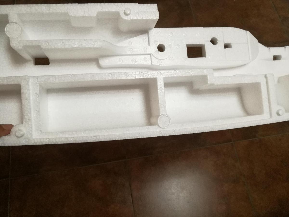

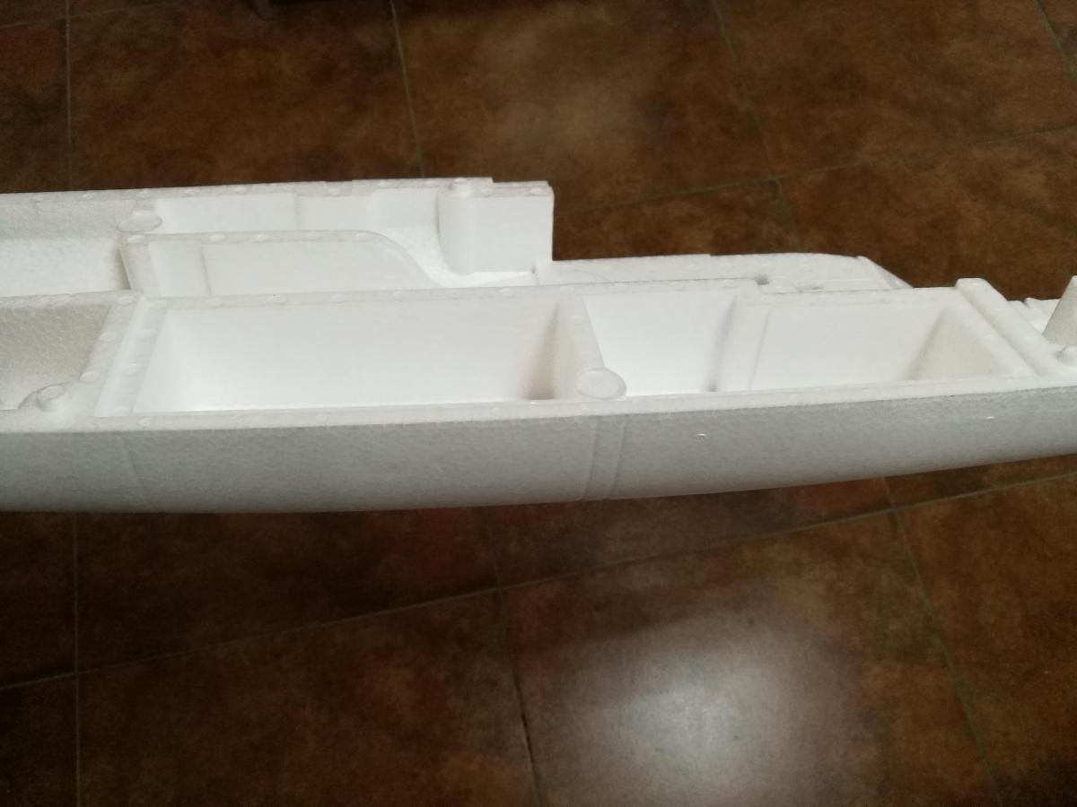

              Originally posted by Gringotuerto
              I wonder if it is structurally possible to fit with bomb bay doors, or if that section is required to stay intact for strength. Of course adding a drop capability would be a common modification, it if is possible without major structural change.
              Yes, plenty of room.

                                To answer Gringotuerto's question, yes, there's plenty of room for a bomb bay modification. In fact, what isn't present in the pictures TiredIronGRB posted is the plywood spine that is glued into that inset area between the two fuselage halves. We included that so that, when the modders cut into the doors inside of the panel lines, there would still be adequate reinforcement to stabilize the fuselage. The real B-24 had a walkway that went along the center of the fuselage; in our model, that centerline is where the plywood plate is. In the next few days as I have time, I'll post pictures of it at the factory before it's sandwiched between the two fuselage halves during assembly, and I'll also post measurements for Adam, Bob, and Co. Our idea was to make modding as straightforward an affair as possible. Simply slice along the panel lines, hinge as/where desired, and add an actuating servo. You won't need to hack up the fuselage interior... the mod can be accomplished very cleanly.
