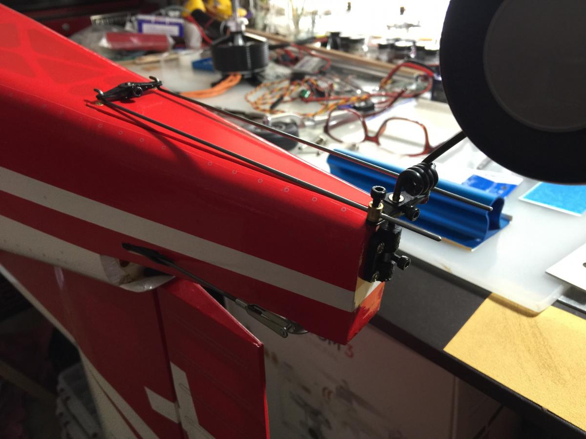

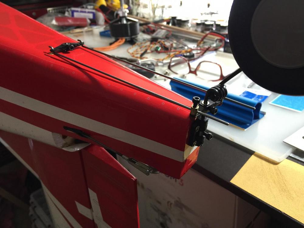

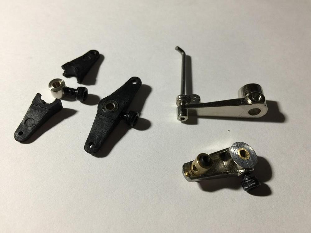

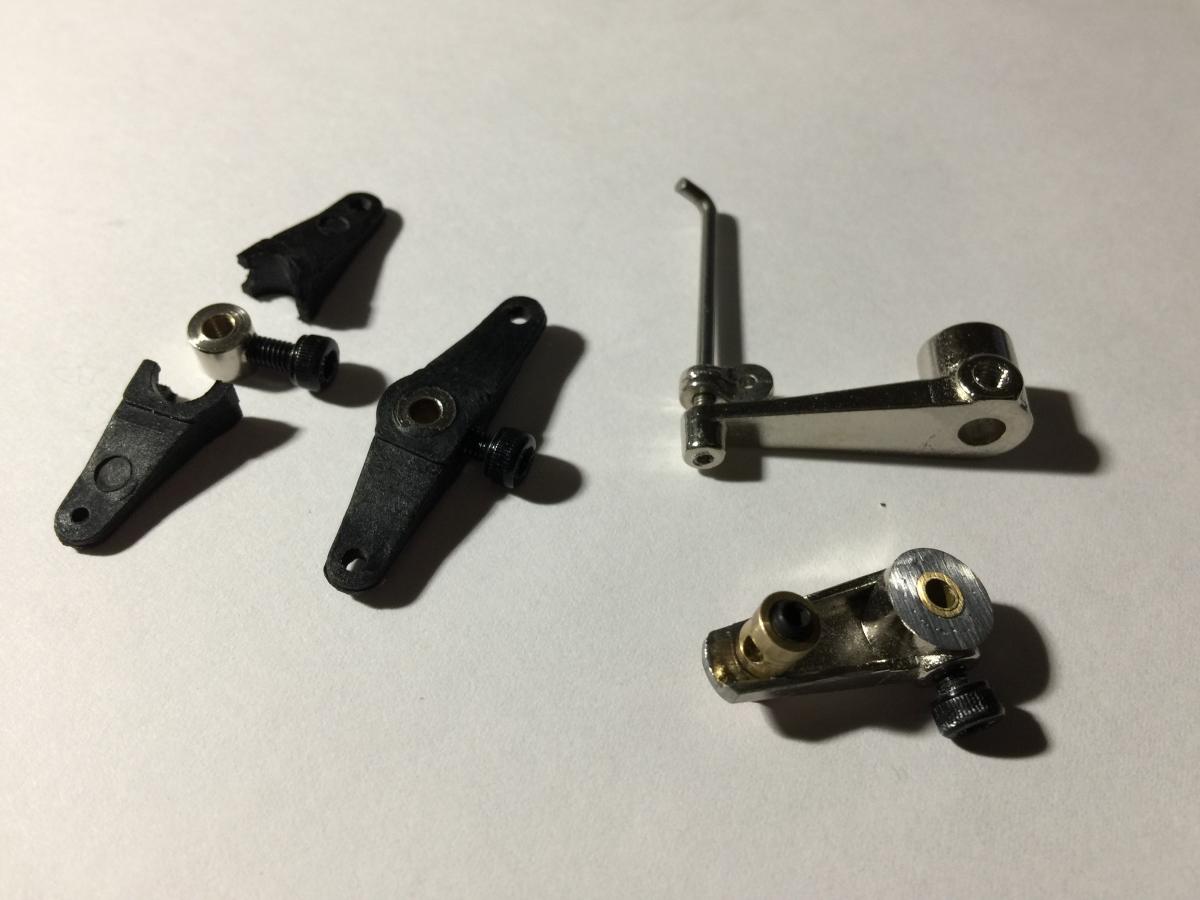

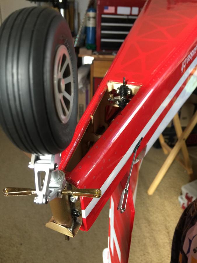

      On the big VC PC-6...
      Here’s a picture of the cheap nylon bellcranks and tailwheel that come with the kit.

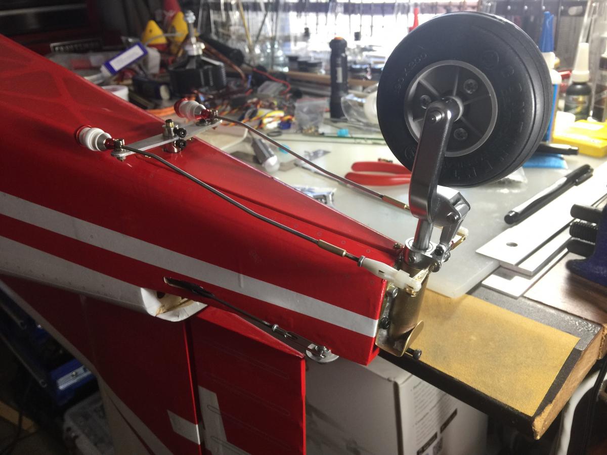

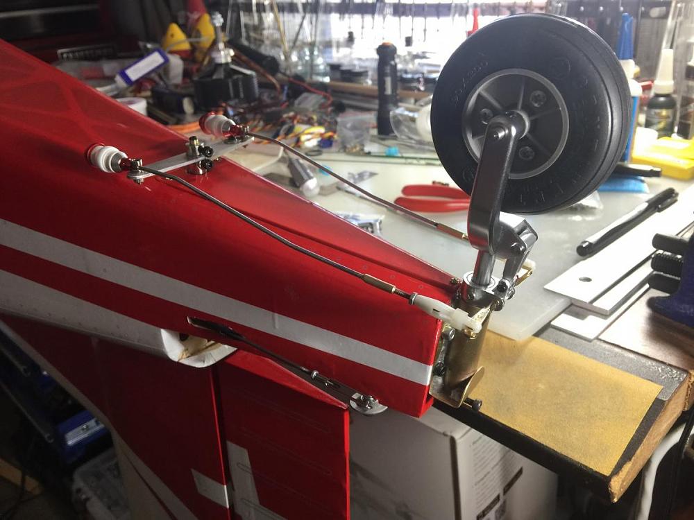

      The metal replacement parts were all either existing things modified by me or fabricated new.

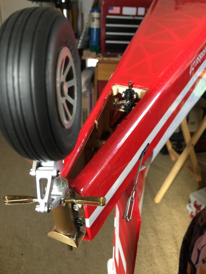

      New installed parts
      Tailwheel mount bracket is brass, soldered from two pieces
      Completed unit
      Works very well indeed...!

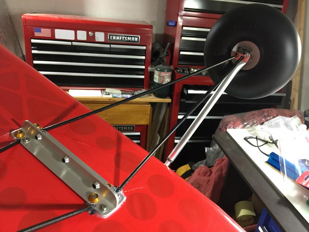

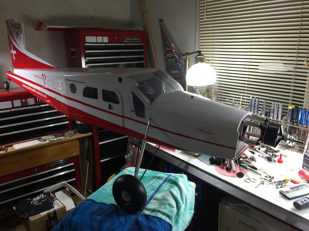

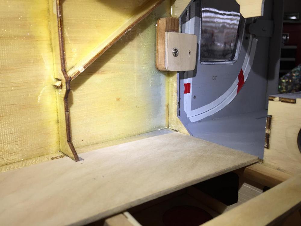

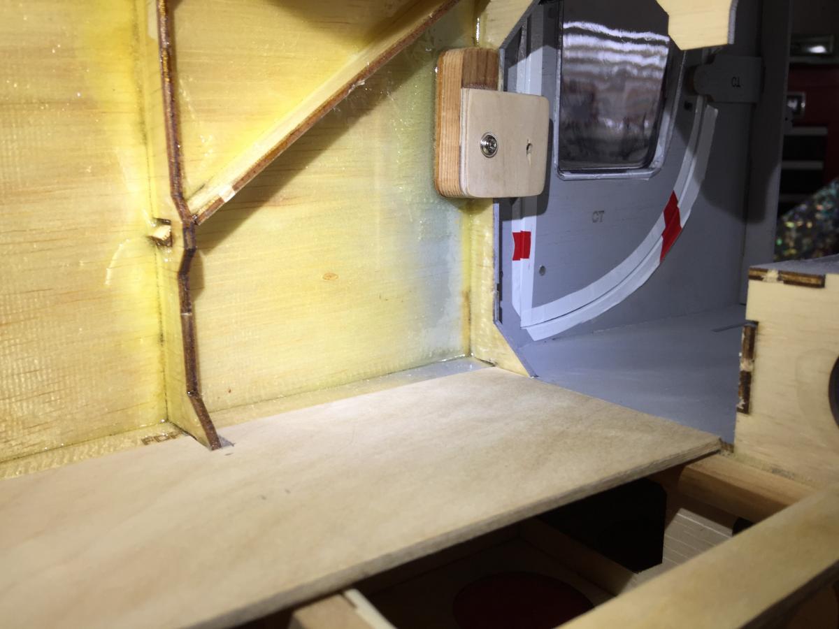

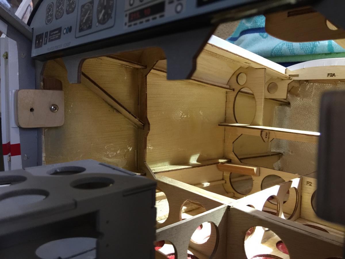

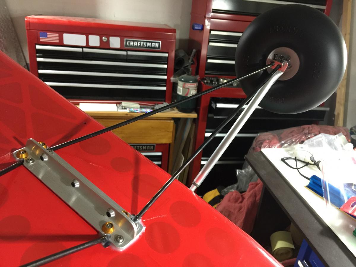

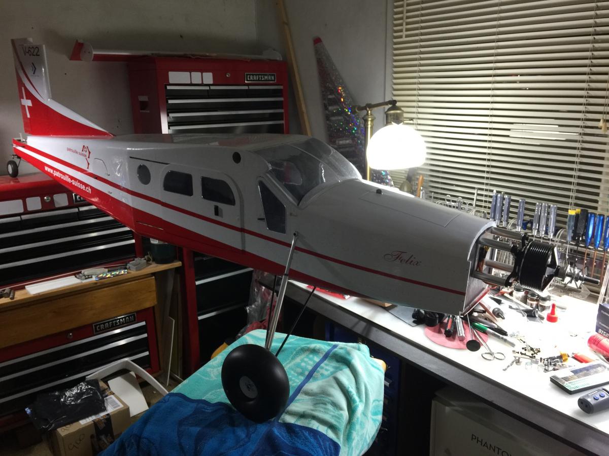

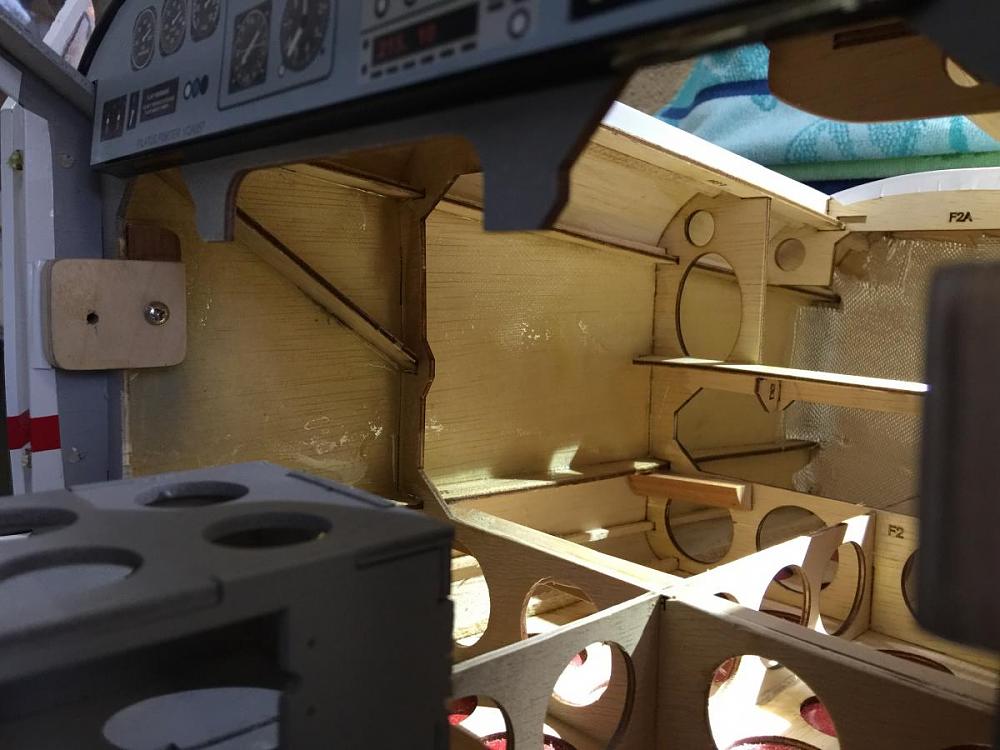

        Main gear also had plastic mount parts.
        Tossed those and used two pieces of aluminum angle to mount the gear.
        Tires are 6” Dubro inflatables
        Lands like it’s riding on pillows, prefers grass
        I added a reinforcement doubler to the upper main gear shock mount as this seemed weak to me.
        Fiberglassed the entire nose inside as I expected the torque from the 9 horse motor would twist the firewall off its mount.

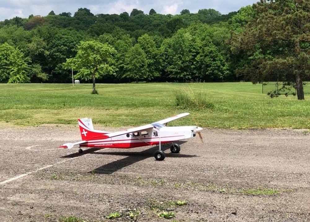

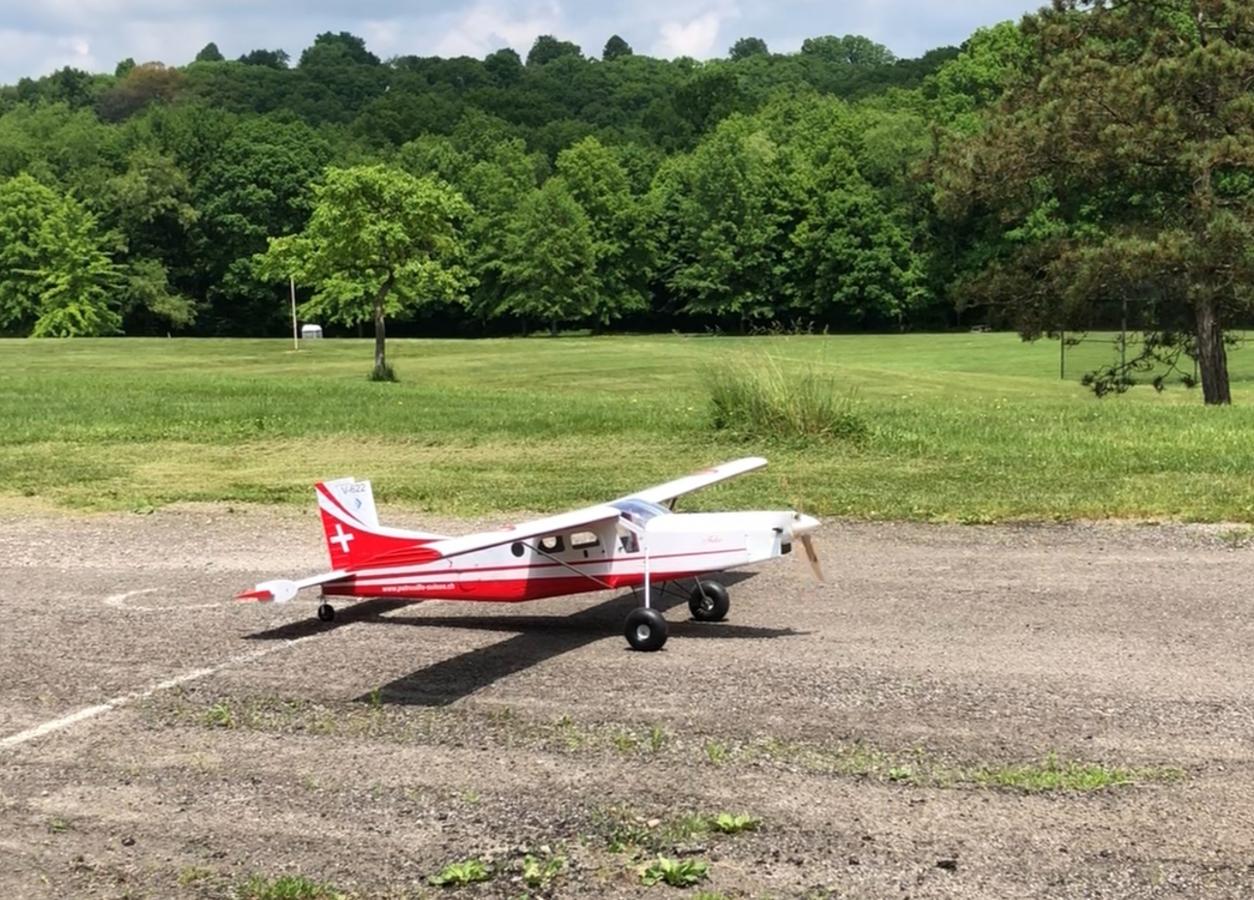

          It’s a nice flying airplane in spite of the added two plus pounds of upgrades I did. Very light on the controls and with loads of power to spare.
          The 6” inch main tires look right at home and the gear upgrades make takeoffs n landing this 24 pound bird a snap.
          I hope to add some Skydiving Barbie’s in the future when time permits.

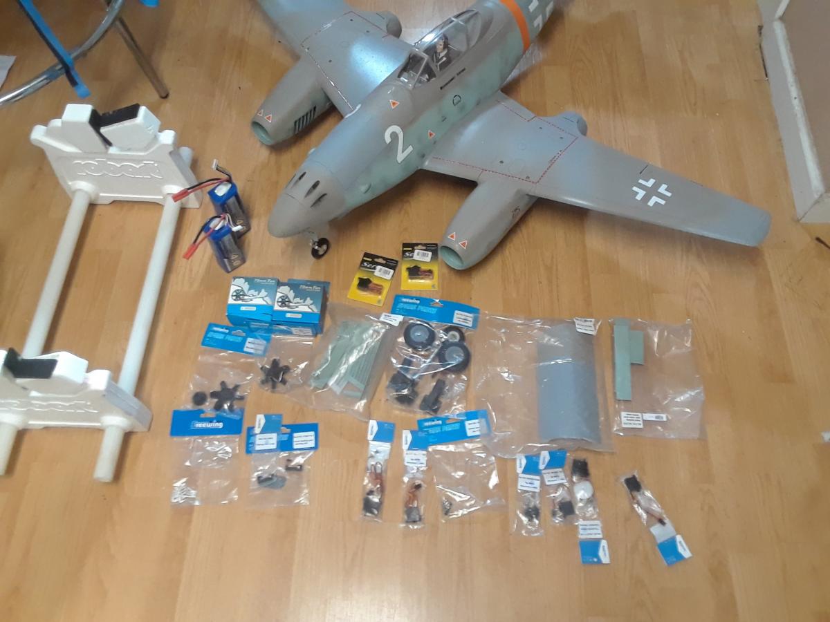

ID:	139894 Deal of the day picked up me 262 never flown no hanger rash plus two 6s batts complete gear set complete set of servos plastic kits plus more and an stand 300$ down side 6 blade version
                    #389
                    Not too big of a down side, and what's good about that is upgrading is just a click away at motion.
