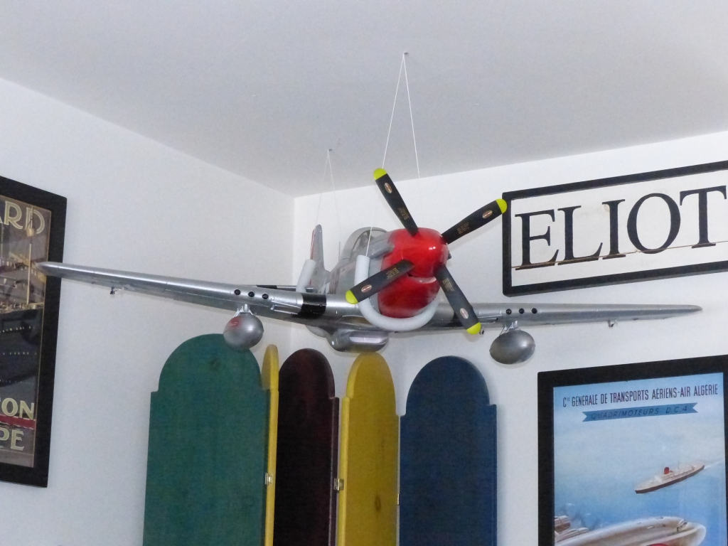

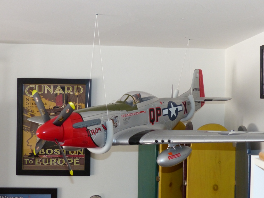

                        Even though I'm still waiting for my new airbrush to do the weathering, I decided to hang my "Iron Ass" up in her new spot in my cave.  She is actually aiming right for the Zero across from her on the ceiling.
                        Addicted to planes!

                          Originally posted by Looking good!!! Flying weather will be here soon.
                          retiredflyerEven though I'm still waiting for my new airbrush to do the weathering, I decided to hang my "Iron Ass" up in her new spot in my cave.  She is actually aiming right for the Zero across from her on the ceiling.
                          Lon

                            RE: Freewing P-51 w/MrRCSound build
                            Now you have to airbrush some .50 caliber bullet holes in the Zero to complete the scene :angel: .  BTW, what airbrush did you purchase, if you don't mind me asking? I have an old Badger 100 and a Paasche (don't remember the model) that are both side feed, double action. Don't know if you've seen it, but I posted my build on a "silent" compressor over in the Airbrushing forum section. http://www.hobbysquawk.com/thread-1320.html  Hope to get a chance to actually use it soon :rolleyes: as I get the bench cleared. Also, I'll check the cg tonight after I get off work.
