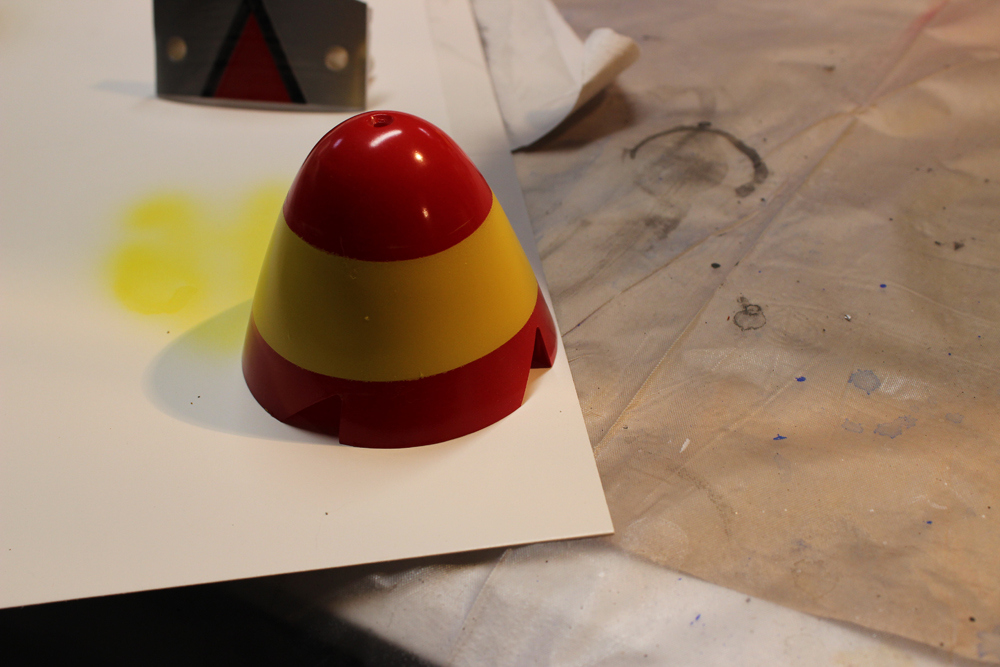

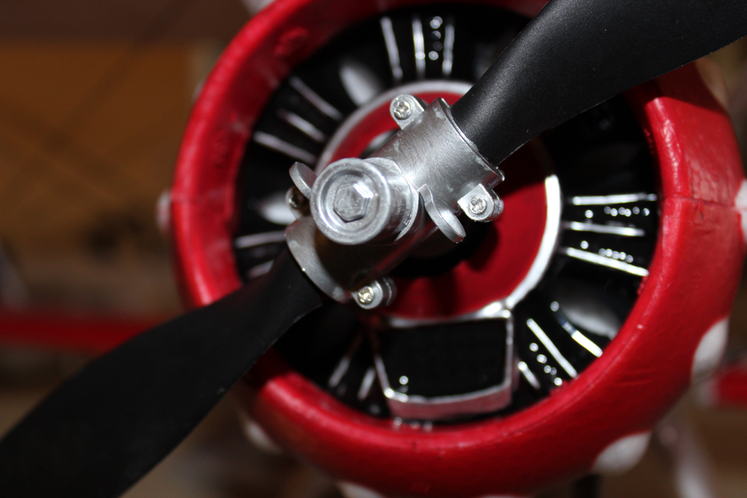

            Looks and sounds great SR!  Mine is nearing completion, as I had a little more work to do, converting her from Iron Ass to Old Crow.  Interesting that they don't have the stripes on the bottom wing.  See you went the 4 blade as well, good for you!
            As for the spinner, I made my own out of Iron Ass's
            Turned out great!
            So, hopefully, by the end of Monday I should be able to fire mine up as well.

              Great job on the spinner. I took the easy way out for now and just modified the Old Crow spinner and cut for two more blades. Not a perfect fit. I still have the Iron Ass spinner if I want to try and paint the yellow stripe. Can't wait to see yours!

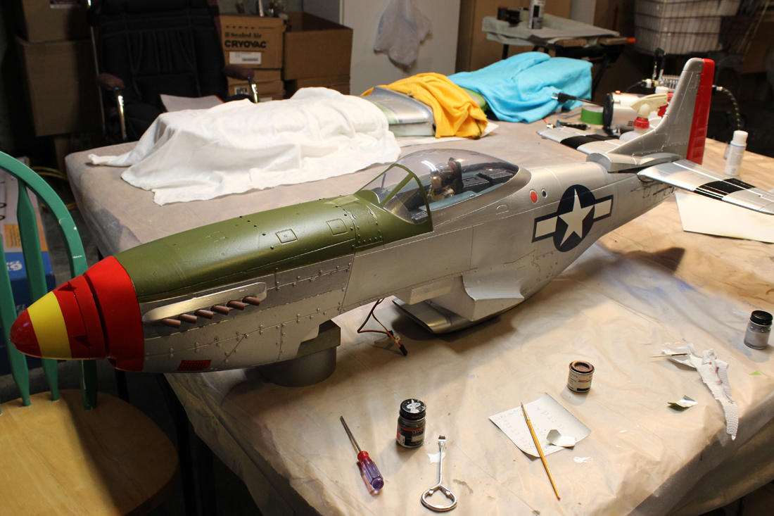

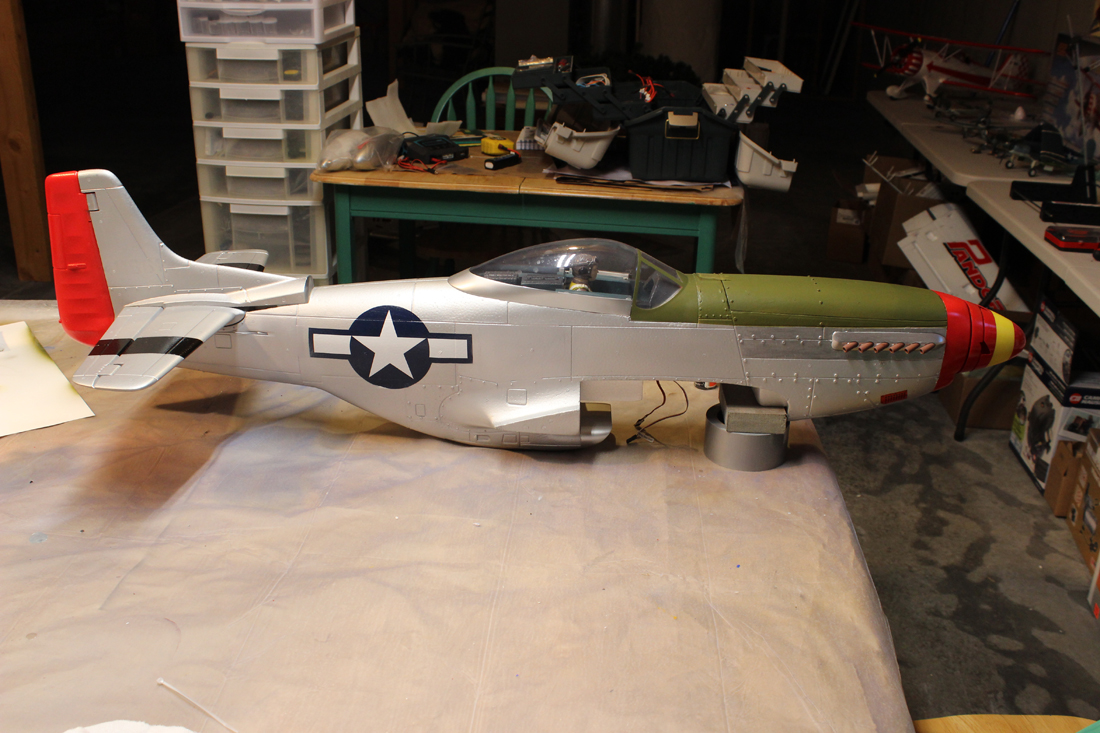

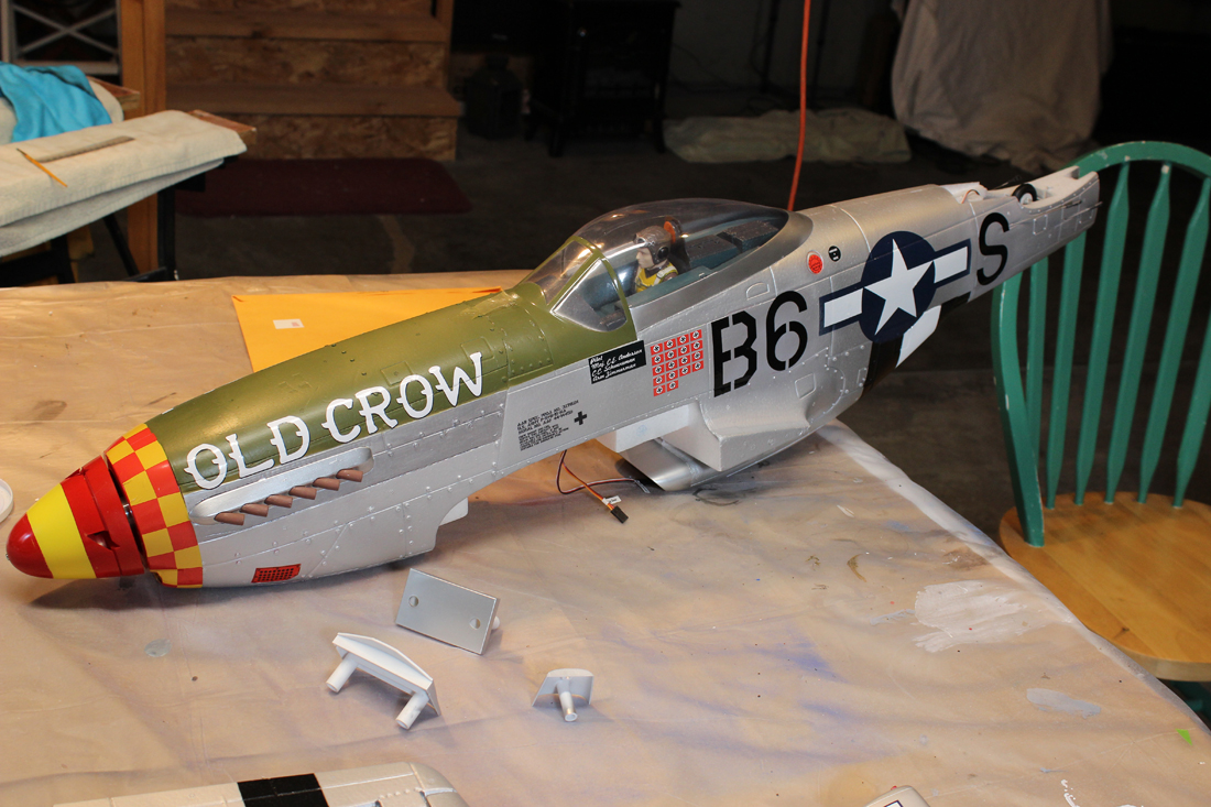

                This is as of this morning, still a ways to go but she's really starting to shape up!
                Just giving her some time to dry again, then back at it.
                Weather is shaping up to be nice today, I might take a break and go flying

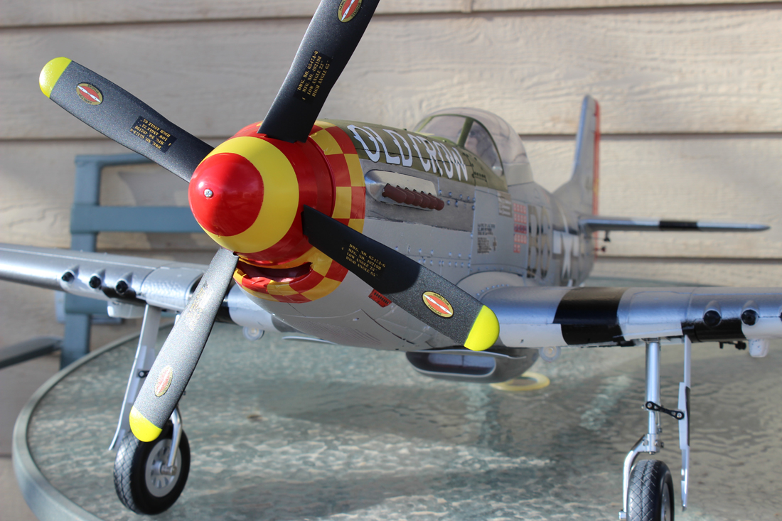

                  As of this afternoon:
                  Coming along, love those Callie Graphics

                    Sure looks great, I really like what ya did on the exhaust stacks. Would love to see a close-up if possible. Those dark grey stock stacks are a sore spot for me. I even ordered a spare exhaust set to experiment with but haven't had a chance to yet.

                      Hey Steve, I hear you.  I hand painted them, the stack covers are hand painted with Testors Model master Chrome paint and the stacks themselves are painted with Humbrol rust color, although I'm sure Testors would do just as well, I just happened to have a can that I've been using for the last 20 years or so, lasts a long time if all you paint with that color is exhaust stacks. Painted the chrome first, then the rust, flipped her over and did the bottom as well.  I agree with you, its ugly when you leave it just stock.

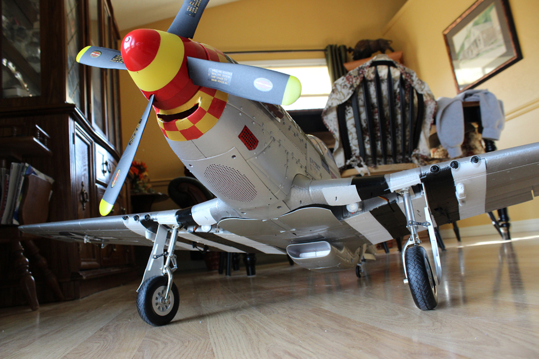

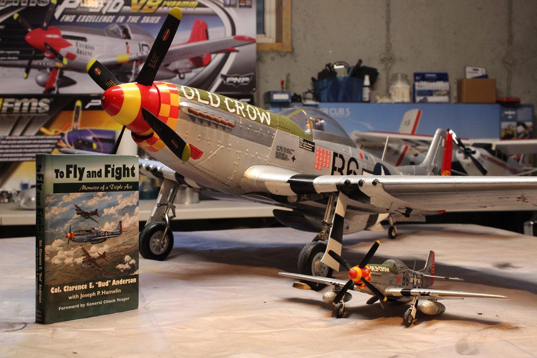

                      Here she is in all her glory!
                      Just posted a bunch of pics in All Us Newbies...

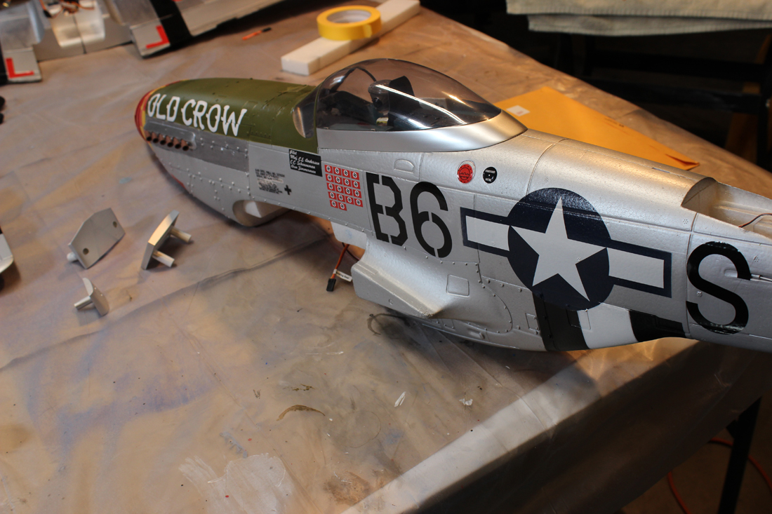

                            they're 1/8th scale and I also ordered the nomenclature set for her as well, then you can stencil as much as you want. The Old Crow decals by themselves were $29 including shipping, you can't beat that!
                            Oh, by the way, I'll never complain about a nose decal application again! Putting the red and yellow square decal on the nose is a real challenge, good thing the decal material stretches, its like very thing rubber.

                              Anyway, got the sound system calibrated and two coats of Minwax on her.
                              Just thought I'd pass on something that I found handy.
                              After Lon's unfortunate argument with his propeller, I decided that one more safety barrier was a good thing, so I made the mix switch (back right on a Dx8) the kill switch for the throttle.  Engage the switch (position 1) and you're good to go, disengage (position 0) and no throttle!   Now, here's the bonus for all us sound system users, that switch will also turn off the engine.  You hit it and it's just like shutting down the real thing, don't have to mess with your throttle trim, to start her up, hit the switch again and off you go!
                              Try it you'll like it!
