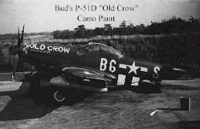

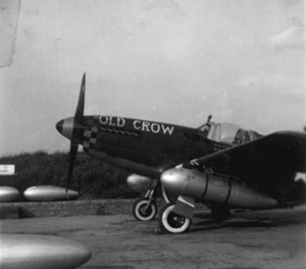

        Hey guys, Jim just sent me this message, to help with the age old question of what the heck the paint scheme was.......
        Dan, My dad said only his B model had the white sidewalls, but then I sent him a photo of his Old Crow in green with white sidewalls and he said, wow, but he is pretty sure the silver D model never had white sidewalls. His original crew chief Otto Heino painted the white sidewalls with barn paint. When he came back for his second tour and got the D model, Otto was a line chief, but must have come over and painted the D models tires white when it was still in camo green.
        What I learned from Merle Olmsted, who was the expert on the 357th FG, was that a photo was just a snap shot in time. Paint jobs, etc, changed daily. So, just because there was a photo one way, did not mean it was not another way. At least I have one photo showing the green D with white sidewalls. Dad is very sure the silver D never had white sidewalls. Hope this helps, Jim
        Thanks Jim, I answered him, saying that I could understand the paint jobs changing daily.  You got a bunch of guys in their 20's, just think back to when you were that age!
        Anyway, my thinking was that the little fuse stripe is still there, so what the heck, paint of the invasion stripes on the bottom of the wing.
        They may have been removed when his crew stripped the green off the plane in one night because Bud happened to mention that it was pretty white over Europe (winter) and she stood out.
        Anyway, Lon, there is a picture of the D model in green with the white sidewalls
