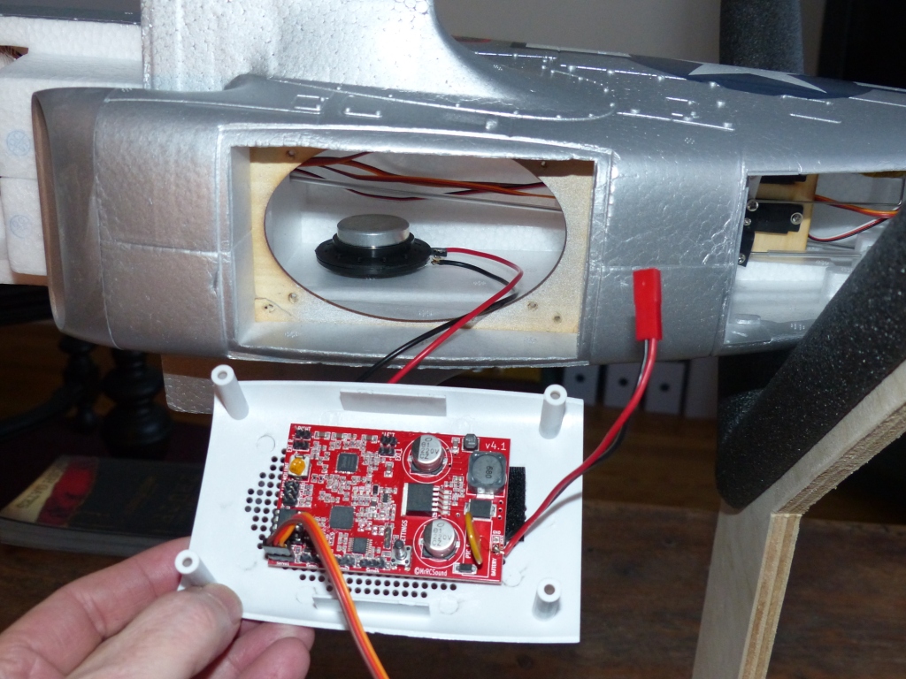

                  RE: Freewing P-51 w/MrRCSound build
                  Thought I'd throw in a couple of pictures on my installation so far:
                  First one is the tt-25 mounted to the sound board I made from some 3/16" Depron scrap I had laying around. I just pressed the plastic speaker grill down on the Depron to mark where it needed to be cut.  I also spread a thin coat of 30 minute epoxy where the tt-25 would be placed and let it dry.  I also punched a small hole right in the middle for pressure relief.  I then peeled the protective paper off and placed it on the epoxy with a small weight that stayed on overnight.  It seems stuck very well and I've used this method on my Cub with success.
                  Next I attached this sassembly using small screws right into the holes already there for the stock speaker
                  Finally I decided to mount the control board on the battery hatch cover (at least at this point)
                  Everything seems to fit and after reattaching the plastic grill I gave it a try.....:exclamation:LOUD:exclamation:.........and that was with just this one speaker!  I bought a bass transducer for the rear but it might be too heavy (almost twice the tt-25 wt.)  So, I'm very happy with this upgrade so far.  BTW, I do have the annoying buzz others have but maybe some ferrite rings will solve that. Also had to make up some jst extenders for the speakers.
                    Hey rc-eflyer,
                    I like your work. I have been at a standstill for a few weeks on my P-51. Just got all my parts and will continue this week. I will post some photos of mine too so we can compare. I will be putting the bass transducer up front as I already epoxied the TT-25 out back. I also have the controller board out back, so we do have some differences.
                    I like the looks of your foam board in the front. Not sure how I'm going to do mine yet. I was just going to epoxy a 1/4 inch piece of foam right to the back of the grill and epoxy the transducer to that.
                      Thanks Retiredflyer, always more ways than one to skin a cat I guess ;) . I'll really be interested in where your cg falls with that bass transducer back there. I installed the receiver last night and tried to tidy up all the wires. Man, the wiring is somewhat of a nightmare :cry:.

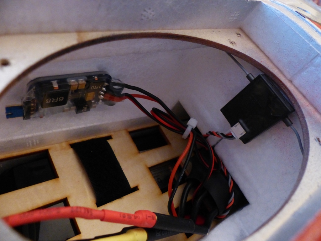

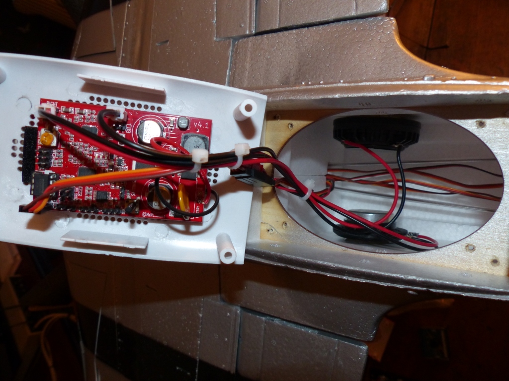

                          Back into the Mustang build...decided to put both speakers in the rear area. Looking at the wiring, it was easier than making a longer connection for one of the speakers. Each speaker is attached to opposite sides of the fuse, and the controller is right under them. I only needed an extension for the power and the control servo (which will be the throttle).
                          Man, what a bunch of wires. I just hooked up and bound the receiver last night to try all the control surfaces and gear. SWEET! Love the gear sequencing and those super bright lights. Had to adjust the main gear doors a bit for full closures and no gap. Today I will attempt the BEC, and the gyro install.
                            Know what ya mean bout the wires:dodgy:. I had to move my receiver after I had it all nice and tidy :@ . Got it all in and put the wing on........no tail retract :( . Got that straightened out.....right aileron started acting flakey :dodgy: . Traced that down to the connector itself but couldn't get the the pins out to inspect. I'll just buy a new y-connector as I would never fly it with shaky ailerons(or any other control for that matter). Anyway back on topic....do you think that's gonna be a CG problem or just use a bigger(heavier) battery to compensate? I haven't checked mine yet to see how my setup is gonna balance.

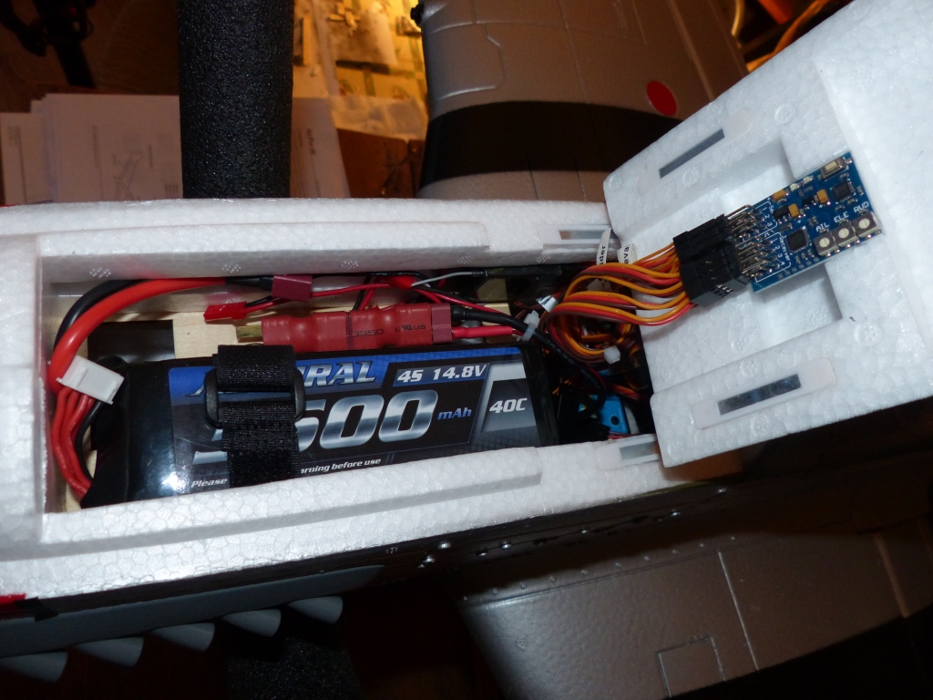

                                  #17
                                  OK, finished with all the electronics, finally.  Like I said, a wiring nightmare.  Took a while to route and wire tie all the wiring in a nice, neater looking configuration.  The speakers are both in the rear compartment along with the controller board that is velcroed to the hatch.  I installed the Eagle gyro to the battery hatch cover and that seems to be a good place.  It is epoxied to the hatch with enough slack in the wiring to open and close the battery cover.  The receiver is on a side wall in the back of the battery area and the UBEC is underneath in the front speaker access area along with the satellite receiver.
                                  Everything is working so now it's time for the final assembly and CG tests!  Can't wait to see how that works out!
                                  Addicted to planes!

                                    #18
                                    Boy you are putting my wiring jobs to shame! Looks great!

                                      #19
                                      I'm anxiously following your progress here, as I am going to be addressing this exact same issue.  While eflyer put his controller and transducer in the front, but closer to the CG (with possible second transducer or bass unit to go in back), you have placed virtually everything fairly far behind the CG point, although you do have the gyro up front (not much weight there though, of course).  So, let's see how the CG turns out, and then of course, how she sounds and flies!  I am looking at the new Freewing "Old Crow" P-51D coming out soon, but I think it's pretty much identical, with the exception of the 80A ESC.  Keep us posted!

                                        #20
                                        Yep, great job! :cool: I'm also eagerly awaiting your cg tests. If you're good I might be able to use that bass speaker after all :D
