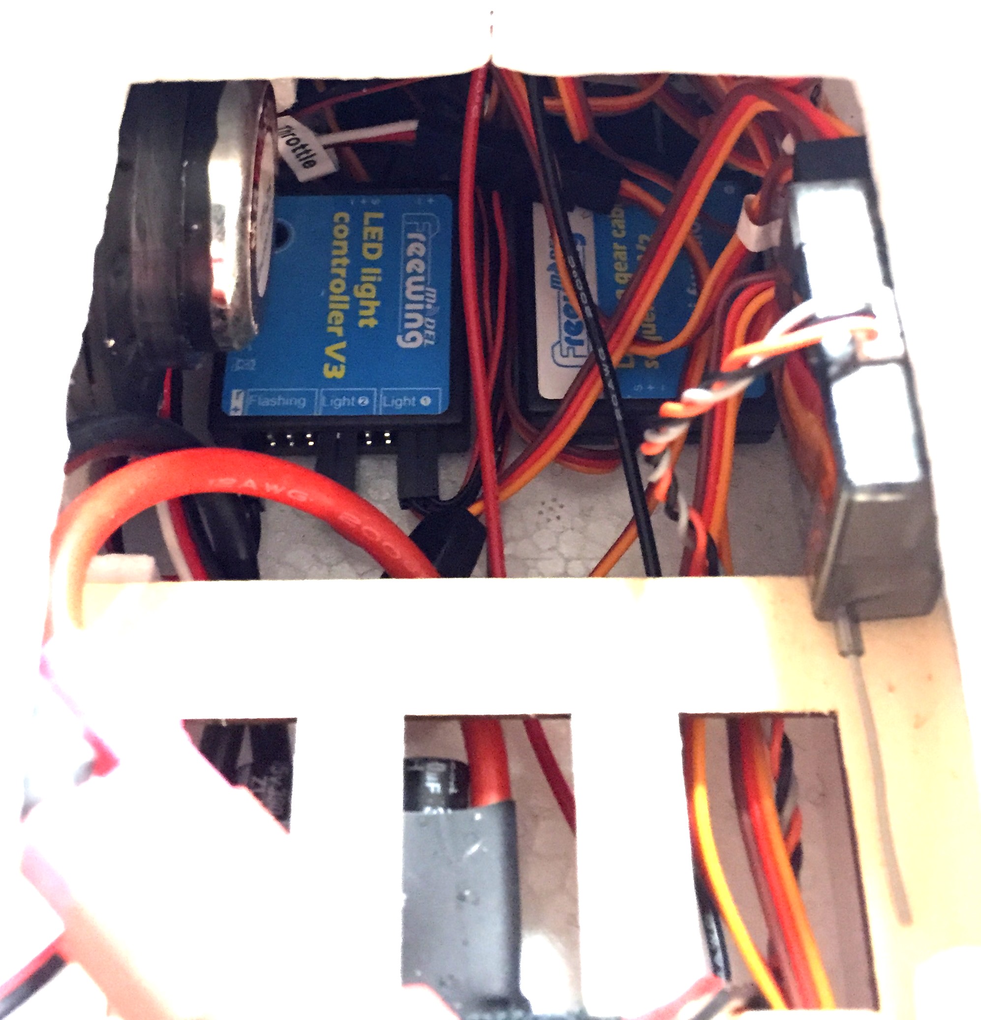

                        Grossman,
                        I have mine mounted inside top of fuse, up to the edge of battery compartment.

                          One thing to keep in mind is the space the gear sequencer and LED controllers take up when you attach the wing. Mine is mounted on the starboard side with the connectors pointing down toward the wing and up high enough to clear all the wires and boxes and a small sat. rec. up even higher.

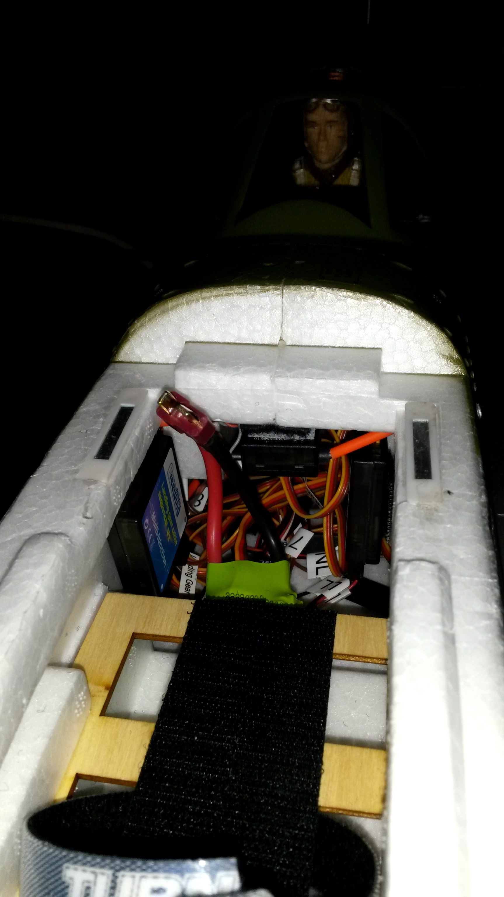

                            Grossman....heres a picture of what I described.
                            Lon

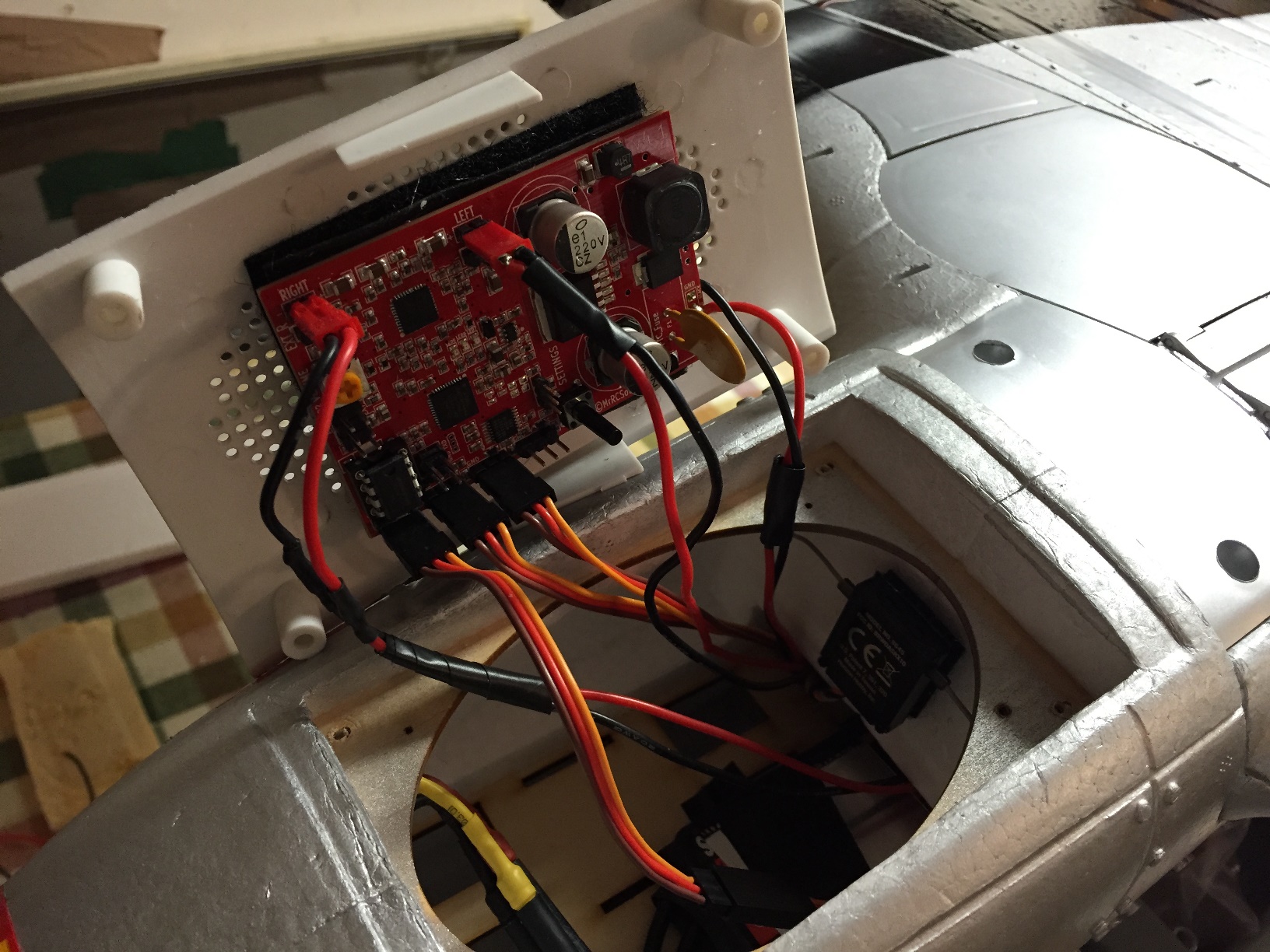

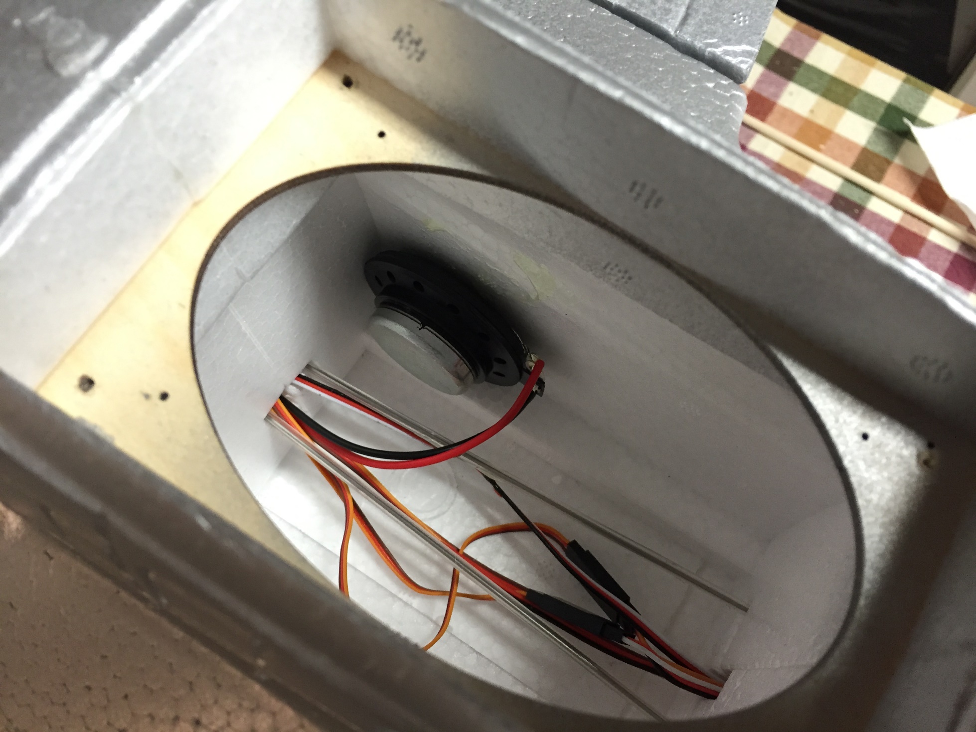

                              On my Old Crow, which I finished tonight, I have the receiver mounted left side just behind the battery tray, with remote receiver tucked up underneath the battery tray (the large open area where a speaker would go).  Then, the LED controller and gear sequencer side by side right on top of the wing, just behind the leading edge.  My MrRC sound system is installed with the control board right on the front speaker grill (where the speaker for the Freewing sound system would normally go), while the front transducer is right side, just behind the battery tray, opposite the receiver, and the rear transducer is left sidewall in the HUGE rear speaker area.  Pictures of all this attached.  I do need to clean up the wiring a bit, but otherwise done, and she balances perfectly with a 3600, and just a bit nose down (which is how I like it) with the 4000.  I'm ready for next decent day to maiden her!  That may be several days as we have wet, cool, windy weather rolling in.  Good luck!
                              Front compartment  Bottom - control board  Rear transducer  Ta Da!

                                #55
                                RE: Freewing P-51 w/MrRCSound build
                                Hey Gman, my set up is almost identical to SR71CC's layout. My receiver is on the starboard side just aft on the battery. Wires are all facing back. I had the added placement of a separate UBEC and the gyro. I posted photos at the very beginning of this thread.
