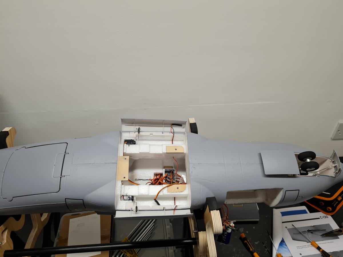

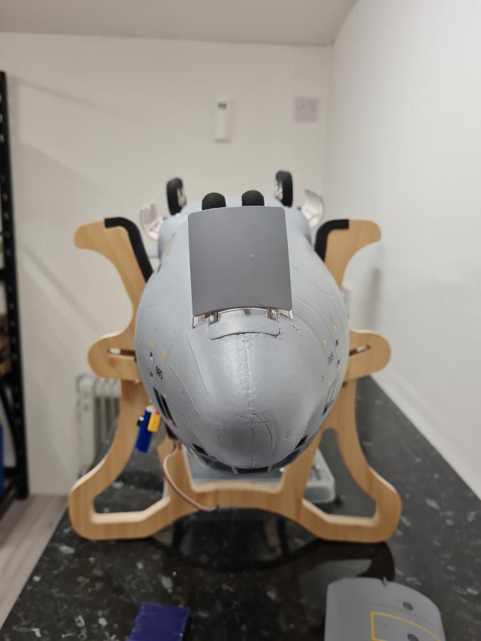

    Ok, so tonight i centred the nose gear servo and adjusted the onose wheel. I noticed o of the main gear doors needed adjusting. I've noticed a slight servo sound once the main gear is up and the doors are closed, I've adjusted the main doors linkage to the max without going too far, but it still does it intermittently. I need to adjust he rear ramp servo arm as once closed on the servo tester the servo sounds under stress.
      • 8814
      #462
      A slight intermittent servo sound is not a big deal. Is the door closed to your satisfaction or is it being forced? An RC modeller's basic skill would have you make a new rod that's a better length or try a different hole in the servo arm.
        It does it when the doors are closed because the servo arm is hitting the foam at the end of the stroke, I made a cutout at that point and no more servo noise.
          Ill have another look with everything removed so just the servo arms are in place. This is a good solution mate. I'm loving tinkering with it so far
