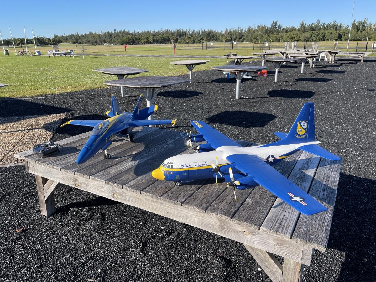

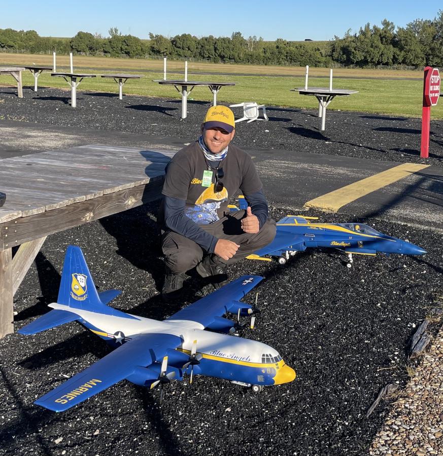

                            Click image for larger version  Name:	B4E3889C-AF8E-479A-A580-2F9246657B3F.jpeg Views:	0 Size:	297.4 KB ID:	289762 Finished the maiden of my C130, although it took me a lot of time to finish the build and set up right, the airplane did indeed come with flaws, particularly on the elevator and rudder hinges. Both flap servos burned out on me during a short test and after replacing them I noticed they were placed in opposite wings, meaning reverse servo was on wrong side causing servo to work harder and buzzing, they got really hot and both burned out during a minimal flap set up.
                            I did indeed go through aircraft details as advised above, thanks again. So back to hinges I had to remove and glue loose hinges on elevator and rudder, that was really tricky as they are all connected together underneath the foam. This was vey troublesome and had to break it in order to glue and stabilize better. Foam on the rudder was damaged and had to putty and repaint.
                            Maiden flight went great, I flew with 10 mph cross winds and although she did handle well, I will need to install a gyro to stabilize her better, I took off with half flaps and it needed a bit more power than expected but nice and scale. She rolled to right a bit had to trim and get her high. We recorded video I will put it on YouTube today.
                            Landing was perfect, she slowed down nicely with half flaps, just need a little elevator mix but no biggie, I actually almost landed with the gear up, being nervous, so as I approached powered up and did a go around, landed her perfect. Overall the airplane felt like it needed at least half throttle to stay in the air, not too much of a floater.
                            Overall great show plane to have, with only a few people around the park the C130 caught everyone’s attention at the field. I flew her for almost 5 mins with a zippy 2200 60c and the meter read 14%. I’m gonna try a 2700 for more flight time.
                            Click image for larger version  Name:	6A7F703C-1BEE-4AF9-936B-047BA50CFD14.jpeg Views:	0 Size:	213.2 KB ID:	289761

                              Congrats on the maiden Brinka! Good looking plane.
