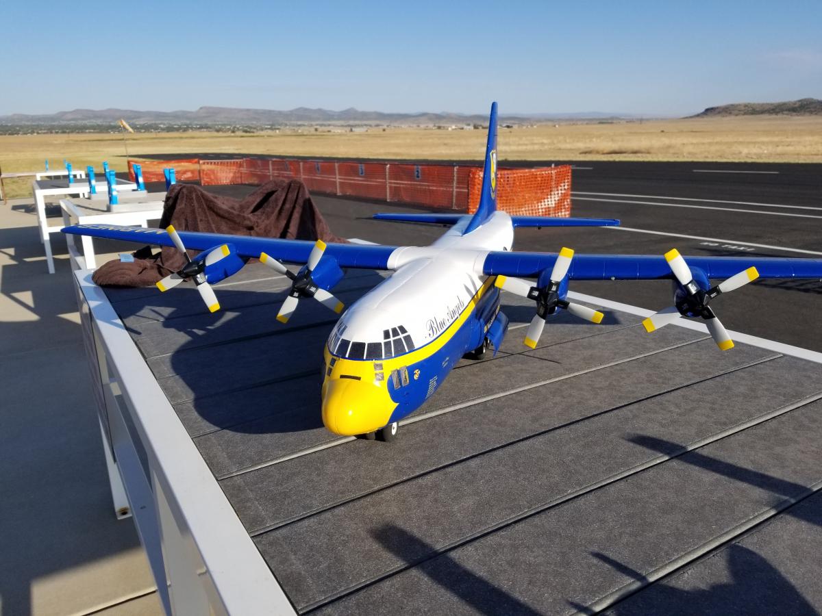

      First flights on mine this morning. WOW! Just WOW! This one exceeds my expectations in so many ways. Appearance and in-flight performance to name two. I did not need to apply even one click of trim to any control axis. Flew it for five to six minutes on 4S 2450 and 2700mAh packs. Sadly, I was alone and so did not manage any in-flight photos. I cannot WAIT to get it back out for more media ... Here are a few static shots. Though I had planned on going with Callie's Coast Guard scheme, when I started vetting it out a little ... which I should have done that BEFORE I selected the scheme ... you think I would have realized/remembered that the base color for that scheme is white. And that means a repaint. So for now, we went with one of the included sets of water-slides. Which are indeed quite nice on their own merits.

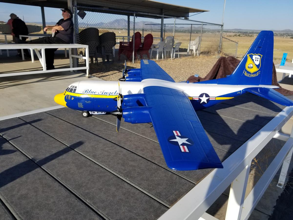

              More flights this AM ... this time with a camera clicking away!
              • icepirate3
                • 214
                #367
                Great shots!! Avios did a wonderful job making this plane look the part and it flies pretty nice as well! Just wish they took as much pride in the electronics IN the plane as they did with the how well it looks and flies.

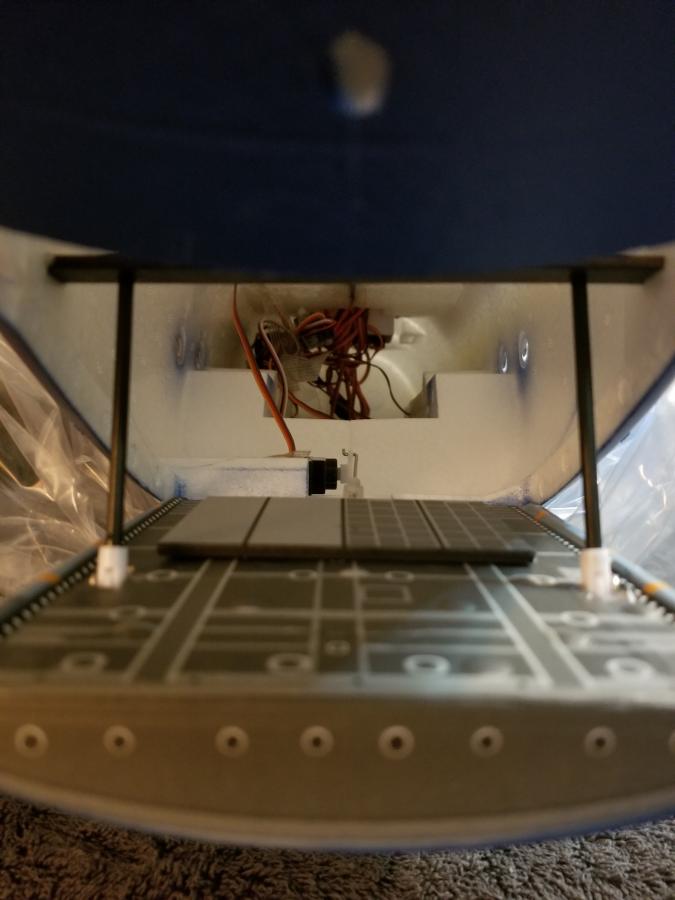

                  So I just opened up my new BA and so far, I like what I see. The flaps sit nicely in the wings and should work perfectly out of the box. The finish looks much better than the original grey version I received and all of the decals are straight and right side up. The ramp now just has the 2 rods that go through a horizontal piece and have a couple covers at the tops to limit it's down travel which is a HUGE bonus improvement IMO! What a pain it was to line up the two sets of rods when they became separated. The wiring does look a little cleaner but i haven't pulled the main gear yet to check everything yet. The rudder does still need a little trimming at the top but does feel like you might be ok without but I'm playing it safe. I am planning on running all of the servos with a tester for a while before assembly as well.
                  I wasn't planning on putting gloss coat on but it just doesn't look right without so the "build" will have to wait. I'm not going the spray can route this time so I need to get to the store tonight and hopefully get at least one coat done.
                  Will post pics of the changes later tonight in case anyone is curious.

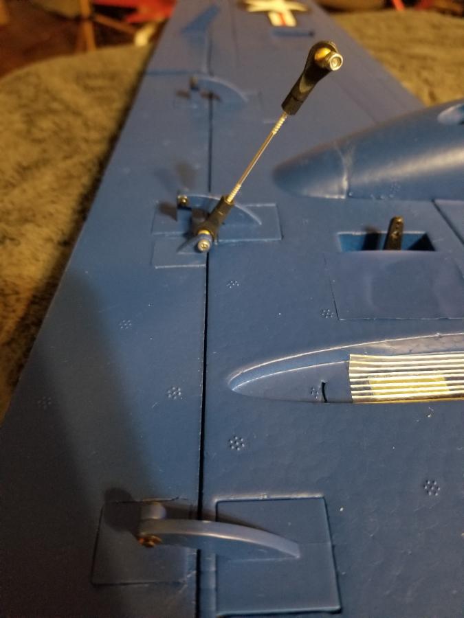

                    Finished assembling my BA and there's definitely some improvement. The landing lights inside of the main gear shut off when the doors close. Which is nice. The wing landing lights stay on but that's ok with me. The wiring is basically the same with the main gear being the only lead that's labeled, at least in mine. The rest are simply taped up. I did notice that the 4 screws holding the main gear were not even close to tight. They were finger tight at best so make sure to check them!! I ran all of the control surface servos for about 8 or 10 minutes each and so far so good. No heat and they felt smooth.
                    The flaps do in fact work MUCH better. Overall I'm pretty happy with the improvements and kudos to HK/Avios for making changes. Just wish they would have been made before it was ever released. Just my opinion though

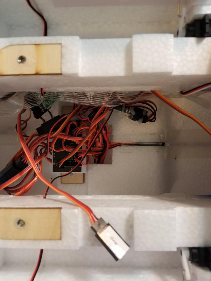

                        So the maiden of Fat Albert didn't go so well. It passed the range check and the throttles all calibrated fine. Took off and it flew great, only needing a little nose up trim due to the heavier battery (3000mah). Flew for about 3 minutes doing turns and climbs just like any other maiden.
                        Dropped the gear, did a gear check and turned downwind. Dropped the main flaps to takeoff and it felt fine. Just after the turn to base, there was a strange, high pitched sound and I lost all throttle response. Had full control otherwise so I setup to land in the weeds. Didn't have enough altitude to get the gear up unfortunately although I did hit the switch. It came down nice but I do live and fly in the desert. It came down in thick tumbleweed and ripped the doors off. And it's scratched up pretty bad as well.
                        Got it back to the table and everything works as it should. I ran the throttles up and cycled every surface, gear, and flaps and the engines never quit. The 4 small bullet connectors were fine and everything was plugged in snugly to the receiver. (Lemon 10ch+ satellite) The battery had 68% left in all cells and only has a couple cycles total.
                        I don't know and have put it in the shed for the foreseeable future. Not going to guess on what caused it but I'm not a happy camper at the moment. I will get it out in a week or two and see if I can figure out what caused it. Spent 6 hours putting clear gloss coats on the last 2 nights and now it looks like it flew through flak. I should have known not to waste more money on this but i really wanted to give HK another shot. Oh well. Live and learn.
                        Only have a couple before pics.

                            What does the cling to the ESCs look like? Could have been ESC heating and thermal shutdown if they are encased well in foam with no cooling air flow.
                            Lack of proper cooling air passages is a common theme in foam models.

                              I may be "reaching" by focusing on this sentence. Check all the propeller nuts and/or motor shaft set screws to see if one or more of them came loose. See if any of the props can be pulled slightly forward and backwards on the motor shaft or if the prop can be turned independent of the motor. That sound is reminiscent of when one of my props were loose (not this plane) and wasn't being turned by the motor. If memory serves, since these are counter rotating motors/props, the ones on the right side of the plane spins in the same direction as the way the nuts go on. This can cause the nuts to back off during motor operation if they weren't done up tight enough. I put FoamTac on all those nuts.

                                Not sure how they are encased but i'm pretty sure I lost all 4 at the same time as there was no visible yaw as I was cycling the throttle once I knew there was a problem.
                                  That's kind of what it sounded like to be honest but i'm 90% sure I lost all 4 simultaneously. I use foam tac as well on the bolts and had just checked them prior to takeoff but I admit that I didn't check the motor mounts. I want to check where the low-voltage shutoff is set as I am leaning towards it being set WAY to high as a possibility. Or something may have happened to the board they used as a junction between the 4 ESC's. The only thing labeled inside is the main gear so it will take some fishing to figure out what is what. Not going to stress over it for a while though as I came close to just putting my size 12 through it's backbone before loading it up. So for the sake of salvaging any hope on flying it again, it will stay in the shed for a couple weeks. :neutral_face:

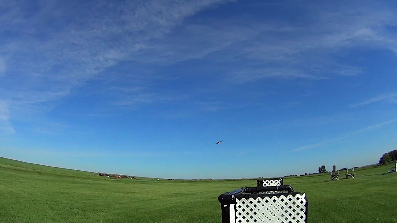

                                      Got a camera that works and go a full flight on video this morning.

                                        Nice job! Looks like handling 10' high scale grass is not a problem! I bet you could have taken off and landed with the gear up!
                                          • 8814
                                          #380
                                          I does plow and cut grass quite badly on that. It was due to be mowed. On GeoTex, it's easy, except for that horrible squeaking noise come from the wheels. I've oiled them. The grass did pull those little lights on the gear doors off. I've got them glued on now. It also does tend to steer based on the grain of the grass. The steering only has minimal effect.
