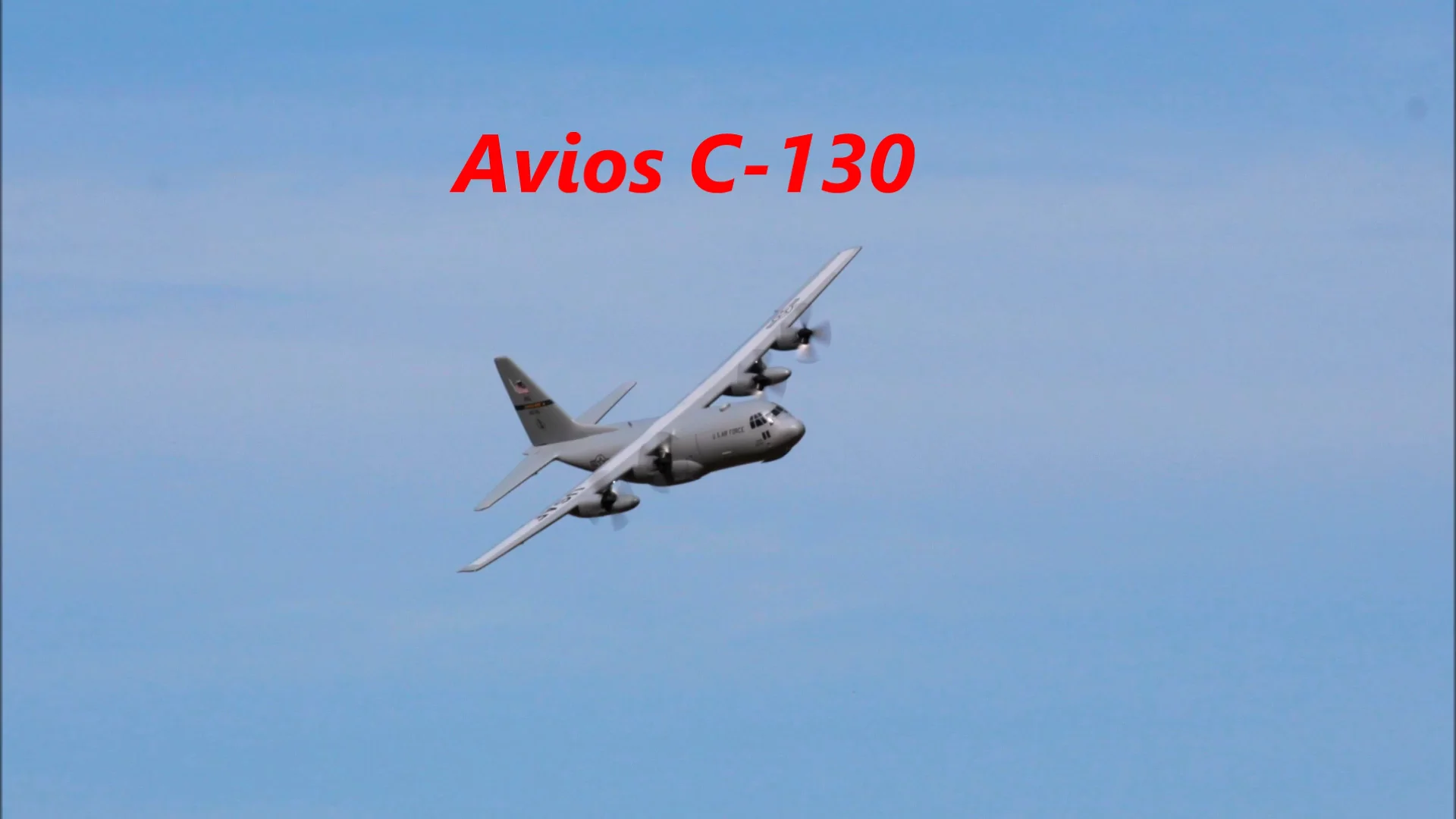

        The weather was unseasonably good today, so I had to get out and take advantage of it.
