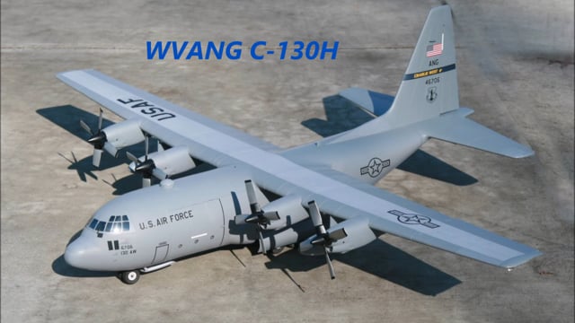

        This video is from last Sunday. Wind was very light, about 5 mph. I think the plane is relatively smooth, though the pilot could use some practice;-)

          From the "onboard", it looks very smooth, unlike the maiden from Demo7's video. That plane was almost out of control at many points in the flight. Another friend had a HobbyKing B-17 that flew like that on the maiden about 3 years ago. It was so scary that he has not flown it since. Turned out to be a very expensive static model.
          Your video also showed how bumpy your field is. Everything shook like crazy when rolling on the ground. How's the landing gear holding up to all that rattling?
