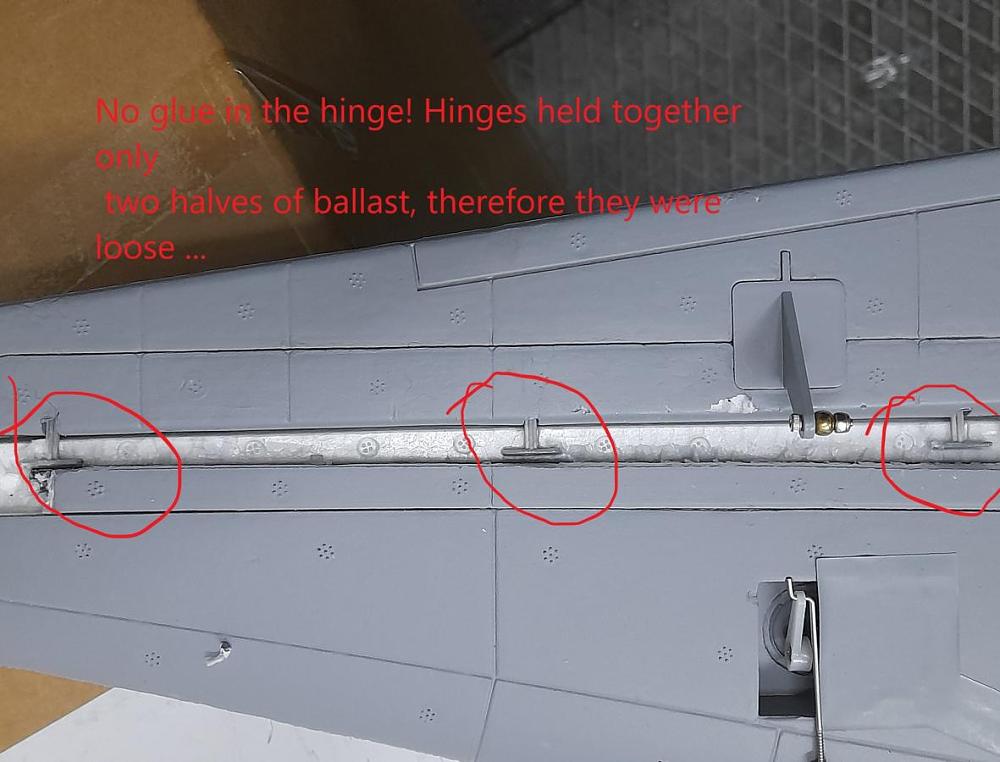

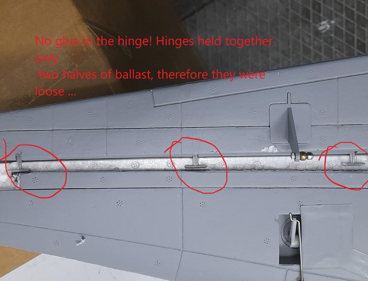

                Hello everyone. I would like to share the issue of loose controls in the C 130. I purchased the model more than a year ago and it was my big surprise when there were loose elevator and rudder when folding. Reading the forum you can see that the problem is not unique ... I decided to fix it in a good way not to come back to it. I peeled off a piece of foam on the steering enhancement. There is a carbon tube on the elevator, right next to the hinges, you need to be careful. It turns out that friends from the Far East stuck the halves of the steering wheel together, but they did not glue into the hinges, so they are loose. I invite you to the movie, best regards
                https://youtu.be/75bnf26Dz98
