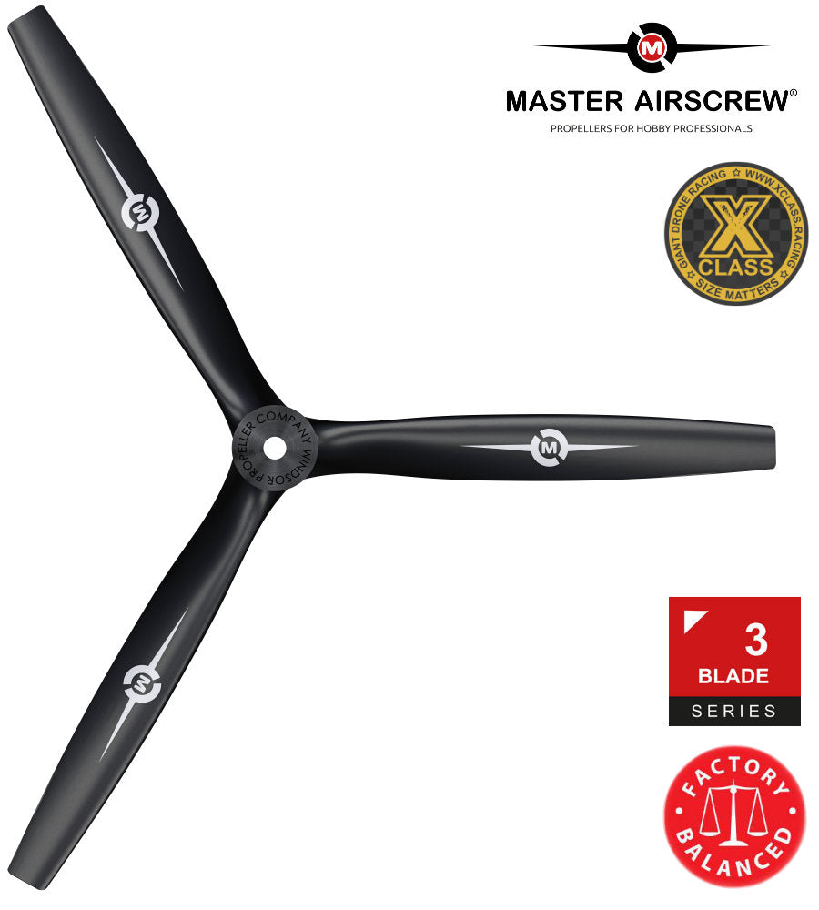

                        Master airscrew has 13-8 or 13-12 three blade.
                          3-Blade Series for Model R/C Airplanes FB - factory balanced propeller - for more information click here   3 blade model airplane propellers specially developed for the most demanding hobby professionals. Great performance and scale look both for electric motors and glow engines. Carefully crafted from Glass Fiber Re

                          I was just on their site searching last week.... Found the 13x8 but not the 13x12.... Thank you , thank you!!!! I appreciate the help of my experienced brothers!!! Thanks!!!:Cool::P:)LOL
                            #53
                            wow I never knew they had a 13x12. Nice
                              #54
                              On order!! 4 normal, 4 reverse..... :P

                                      Now that they are located, 13x12 Master Airscrew standard and pushers....
