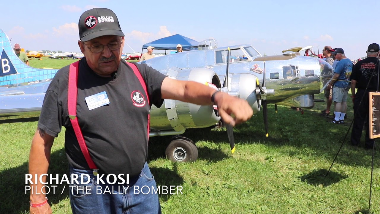

                        1/3 is a huge project!!! Good for him for finishing it!!! :Cool:

                          I can't even begin to feel his kind of pain 17 years!! Now Mr. Hardway get back to work sir!!!
