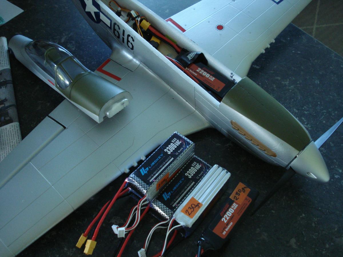

                • Refer to Flightline's P-51D's (850mm) Owners Manual...Page 3, ... Center of Gravity.
                  The correct CG is 80mm (3-5/8") back from where the cowling meets the wing. This is correct, however,...
                  For "Newbie Fliers" (who have only flown High Wing Trainers), ...should the Owners Manual state that LOW WING PLANES are NORMALLY
                  BALANCED UPSIDE DOWN!
                  If Newbies balanced the P51 right-side-up, the battery would have to be installed very far forward and the balance point would feel very unstable, tipping forward toward the nose or backward toward the tail. If balanced upside down, ... the plane balances very solidly with the battery positioned in the location illustrated in the two pictures. Just thought I'd bring this up so someone doesn't wreck their plane on the maiden voyage!
                  The balancing point is arguably the most critical step of achieving a successful flight. Too bad FlightLine doesn't explain the balancing point more clearly!
                  If your plane is pulling severely left at launch, and also doing a nose dive too, maybe you didn't balance the plane up-side-down?
