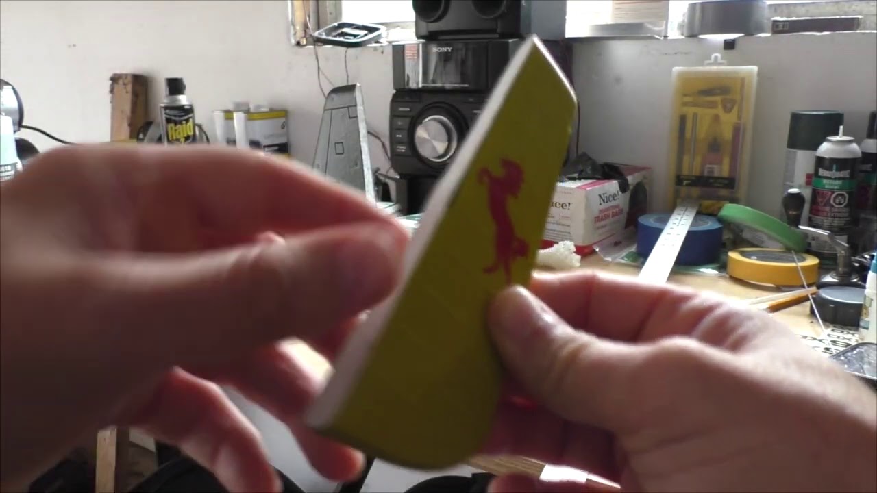

        I did a short vid of my rudder mod. The only thing was that it was difficult to find the correct pushrod length because of the small diameter of the hardware. My pushrod came out at about 15 inches.

          I used a sleeved pushrod kit with clevis' that motionrc sells in the accessories as a 2 pack. I added a rudder easily to the p 51 but that kit might be too short for the dora. I added a rudder to the Dora as well with the 2nd sleeve and an old pushrod I had.
