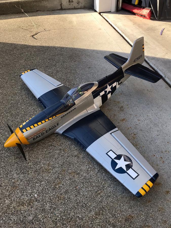

          And like the Phoenix she rises from the ashes...

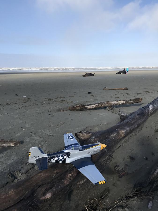

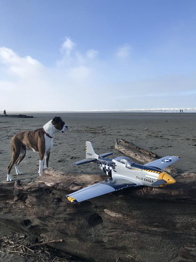

                                    Took my FL Mustang to the ocean last week...LOVED the ocean air and wide open space! Had a great flight. Unfortunately I forgot the proper XT60 adapter for the charger so I was only able to get one flight in but it was awesome.

                                      Love it and your co pilot!!! :P:Cool:

                                          Thanks! She is a professional airplane chaser! :P
