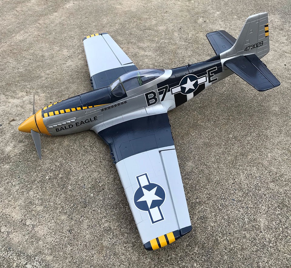

                            Got the rest of my decals from Callie and bought an APC 9x6 prop I am going to go try out. Wish me luck! LOL

                              Finally! A flight without breaking a prop! Sheesh! LOL
                              Man I love that APC prop WAAAAY better than stock. Flew faster, more efficient and much less noise! In fact it was near silent. And the best part, handled the landing like a champ! The only thing is you have to dremel out portions of the stock spinner to fit. The prop needed to be reemed a bit as well. But it's worth the effort. Glad I bought a couple.

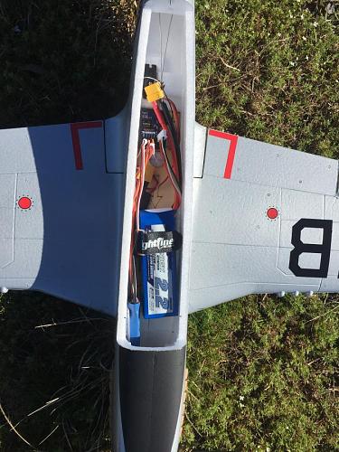

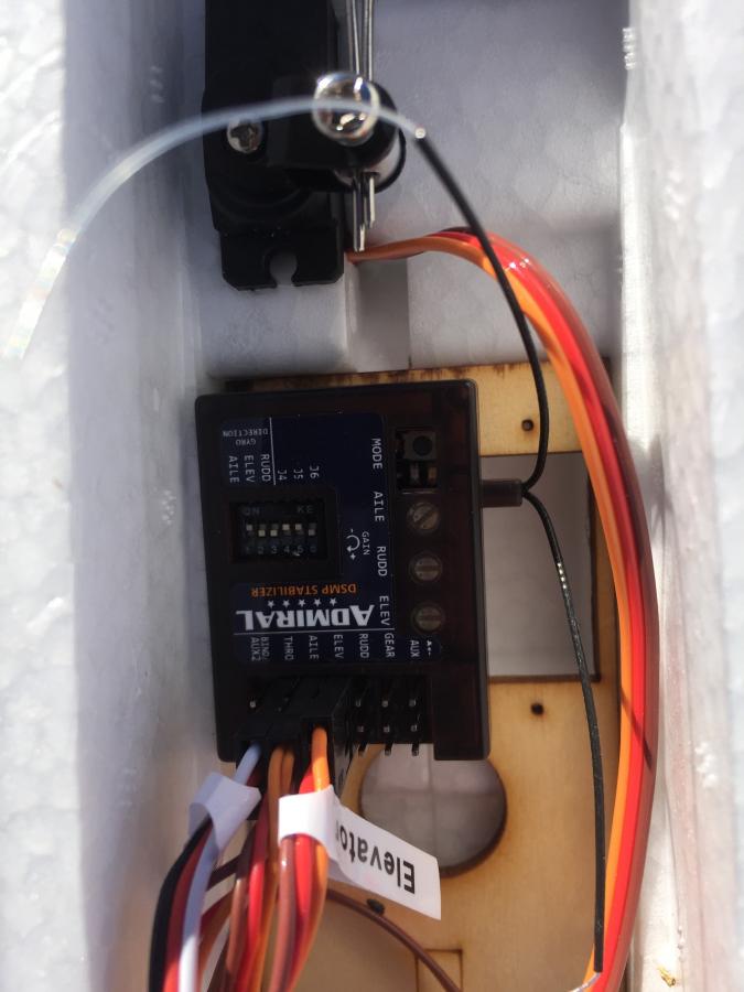

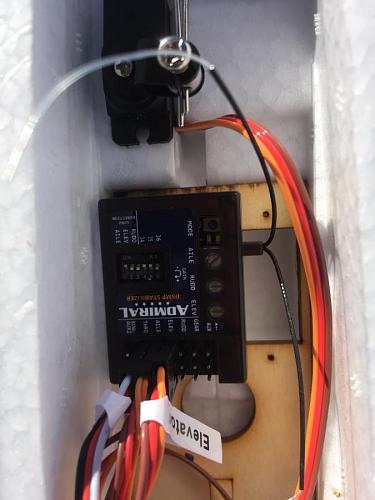

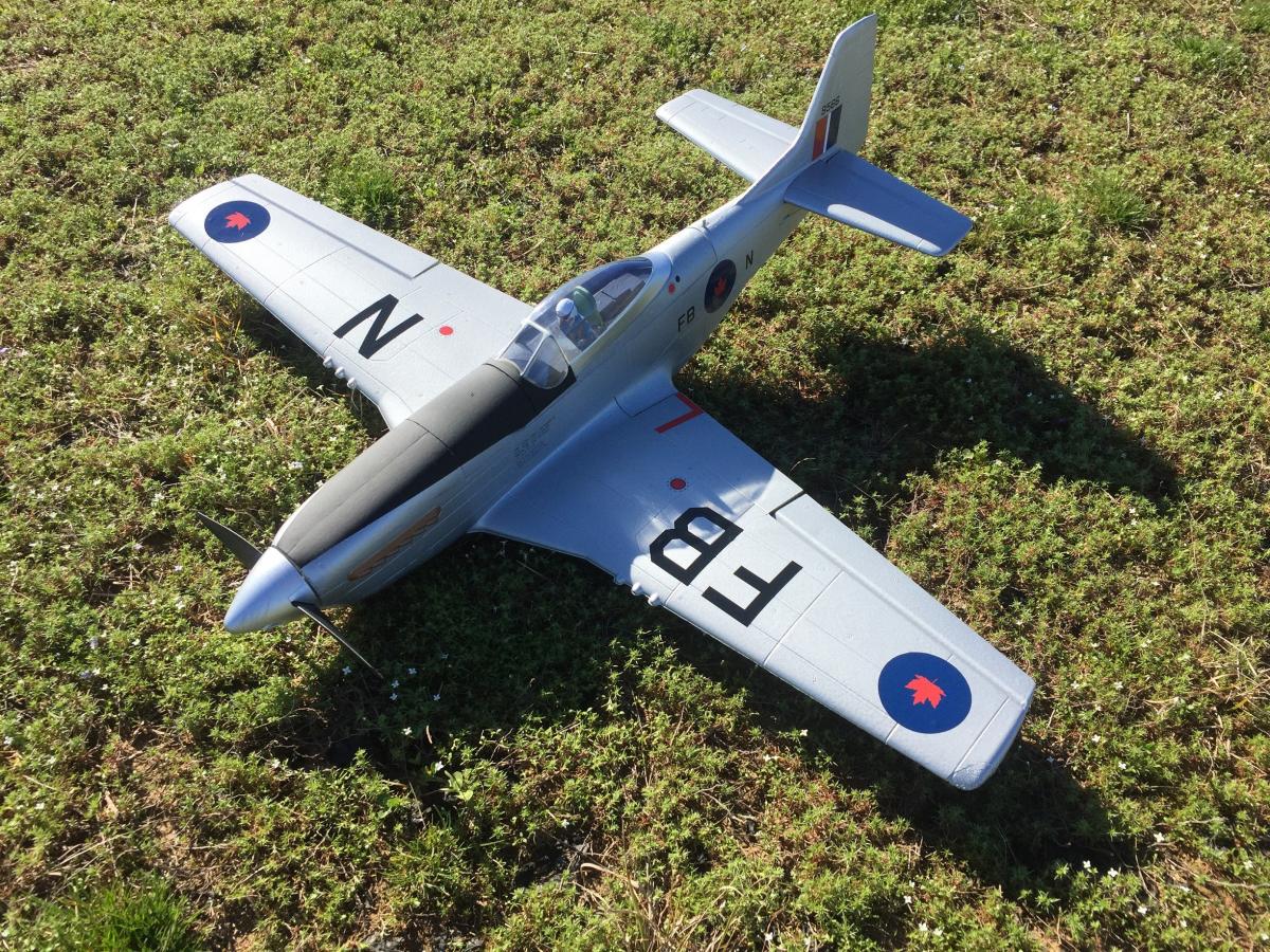

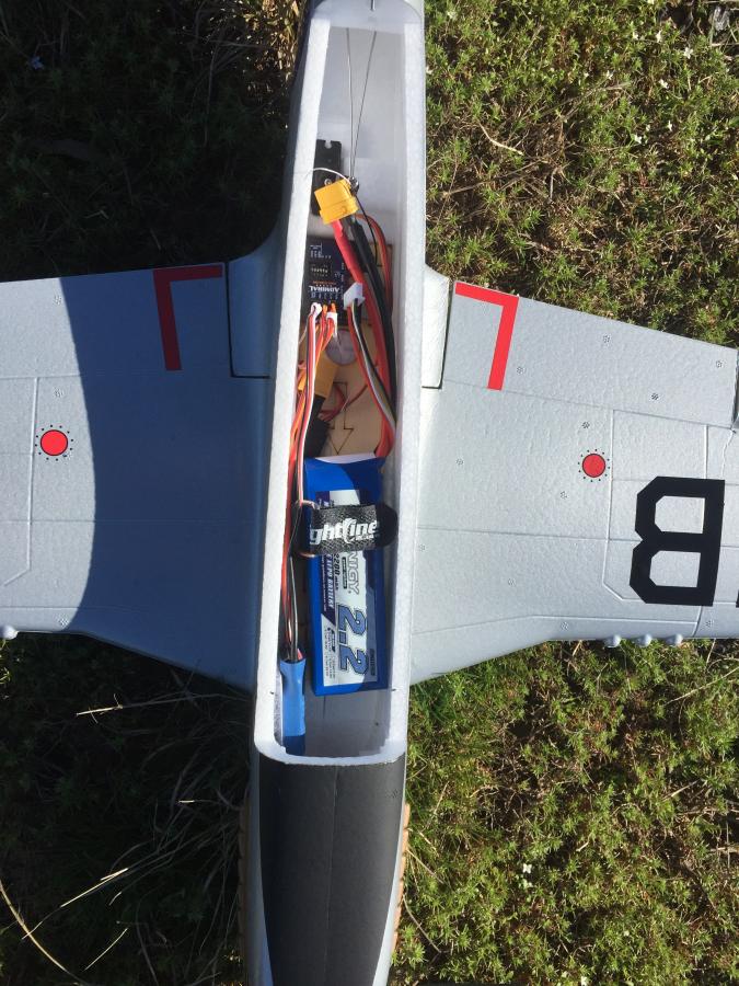

                                  Got my maiden flights in today. Wind was around 10 mph and sunny around 60 degrees.
                                  I thought I would set up my "recovery mode" on a switch in case I wanted to launch using that but for my maiden I didn't want to chance it as I wasn't sure of my gain settings on the receiver and what might result. So I turned the switch to "off" or so I thought!!!! :Sweating:
                                  Flight 1: I launched into the wind with an underhand toss at about 2/3 throttle and then got quickly on the sticks. Well I had a heck of a time controlling it as it was fighting my every input. I thought I just had the gains too high (they were at the 12 o'clock" position) but it was worse than the normal wing wobble - it was pitching and rocking like crazy. Eventually I managed to bring it around and cut throttle and was able to glide on in - miracle I didn't break something! Then when I went to pick it up it was then I noticed the aileron movement when it was tilted and I discovered that the "recovery mode" was on the entire time. Lesson learned - Yes the plane will fly in recovery mode but it is unlike SAFE and it will fight every move you make!!
                                  Flight 2: Launched the same way only this time with just the normal stabilization. It took off nicely but noticed at higher speeds had wing rock so brought it in to adjust aileron gain. No other issues with control. Reduced gain switch to a little past the 10 o'clock position.
                                  Flight 3; Launched the same way but this time I knocked the aileron stick at launch and fumbles to get control. Hit ground with left wingtip and struck prop before cutting power breaking it off. No damage other than a little wingtip rash and the broken prop!
                                  Flight 4: Swapped out prop with one of the two I ordered with the plane and launched again with a newly charged battery. This time no issues at all. It flew nicely and handled great. It has plenty of speed (for me anyway) on a 2200 3S. Added a little bit of left aileron trim and flew for over a little over 6 minutes with 3.85 remaining on each cell.. Flew with the recommended throws and at low rates. Even at low rates the roll rate is very quick!
                                  What a fun little plane! I love it and will be a frequent flyer at the field!!
                                  Photos show my receiver setup and battery placement at recommended CG.
