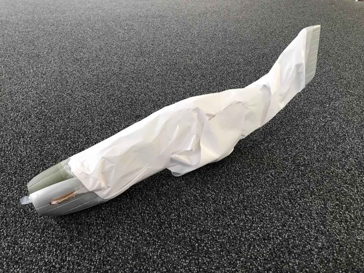

                    Started on one of two Mustangs I'm prepping for follow up video in the next week or so from MRC EU. Anyone like to guess from the masking what the scheme will be on the first?

                      Some very good suggestions already, but can I also suggest our Admiral hinge tape. This medical tape is soft and whilst not low tack as such, it is very gentle on the paint surface, which is great for foam. But on canopy's its great too as its extremely flexible, so its great for curves of canopies etc. Best of all, there is no bleed. Its what I've been using today with the first of these two custom scheme's we're working on.
                      Here's a link, its all I use for masking now:
                      1" (25mm) Wide by 5 yards (4.5m) Long Waterproof Hinge Tape - Clear from BenchCraft - ADM25HTAPECLR This hinge tape from BenchCraft will not leave any residue behind while providing excellent adhesion. Used to create hinges, seal seams or gaps between control surfaces and wings/stabilizers, repairs and many other uses.
                      Stuart.
