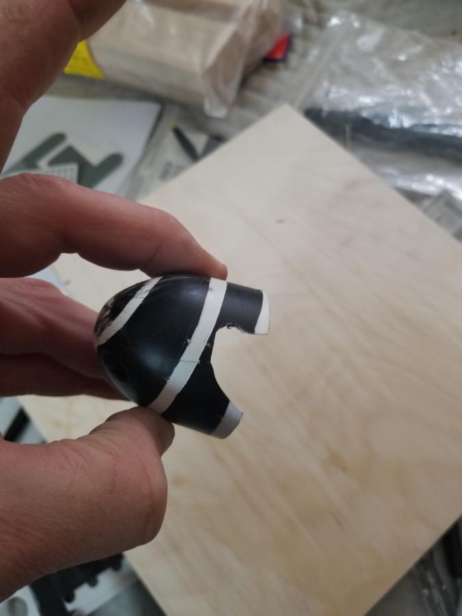

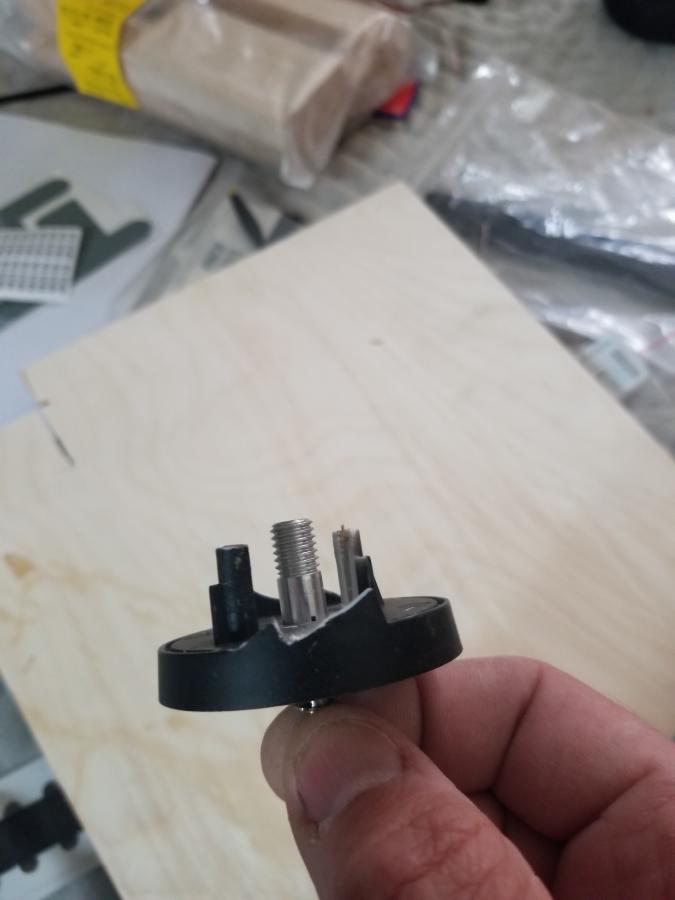

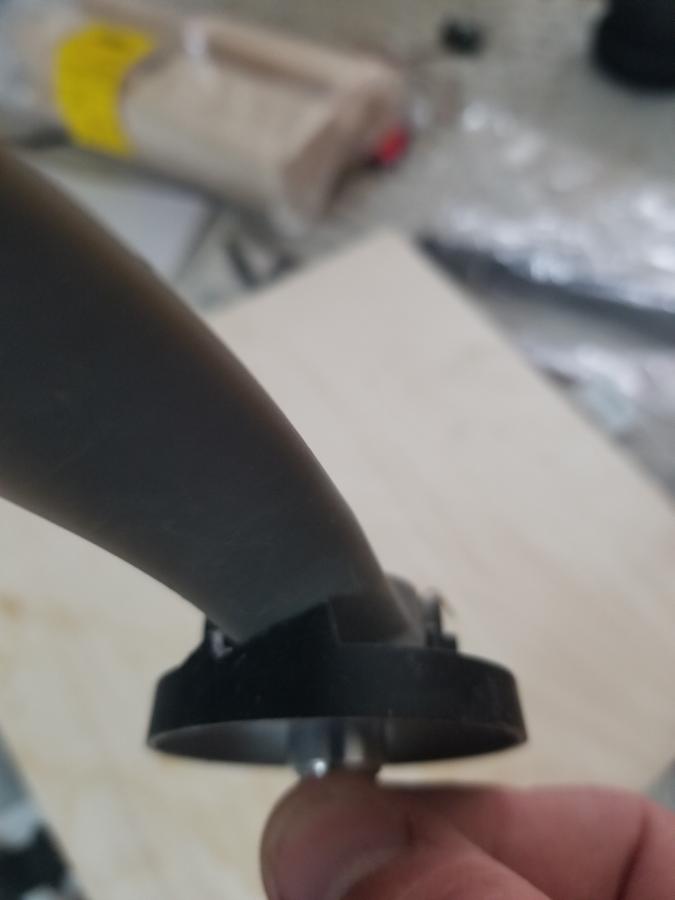

                      • salali With the APC props you have to upsize the hole. It's easy to do with just a drill bit and pliers to grab the drill bit. I know it sounds a little suspect but I have done it for many years and it's easy. I found that when I use a drill or my drill press it always catches and spins the prop, which hurts and is annoying. And you need to modify the spinner with a dremel tool. It's worth it, you won't break the APC props as often as the factory props. Here's a photo of the spinner modified for my Fw190, I did the same for my mustang. Click image for larger version

                        • Originally posted by SanExup View Post

                          SanExup Thanks for the pro tips. I did not consider any mods to the spinner so again, thanks for sharing your experience.
                          • salali I hope that helps, if you go that route. I also use the apc 9x6 gasser props without issue. They are a little more durable than the thin electric 9x6, both are more durable than the stock prop. Maybe it doesn't have as much initial thrust at launch but honestly I don't notice the difference at all, hand launches seem the same, overall speed seems the same. But I have no real means of measuring other than feel and experience of both props and they seem comparable to me. Happy flying and gentle landings!
                            • SanExup Your recommendations helped. I completed the mod. I think it turned out pretty good. This was my first time using the rotary tool so the lines could be cleaner but overall, I think it turns out good.
                              • salali Nice work! It always is rewarding to have it look good on the table, and yet when its whizzing by at 80 mph it matters less. Happy flying!

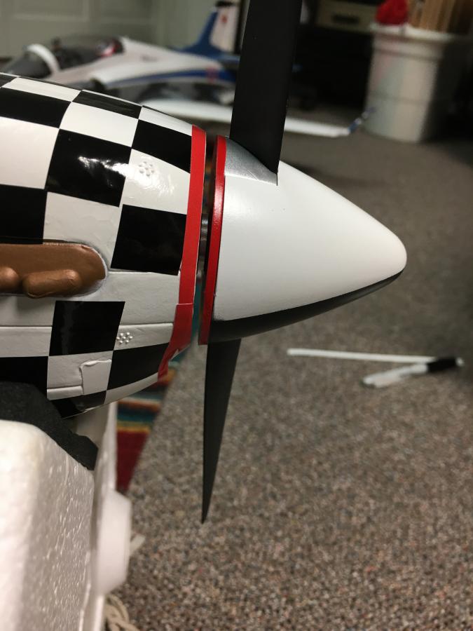

                                        • Hey guys. This seems to much of a gap between the the prop hub and the plane. Is that about right? I can’t get it to go closer. Thanks.
