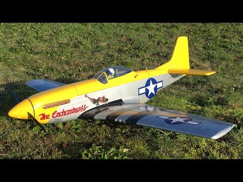

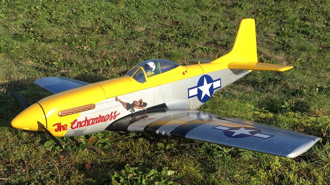

                                    #297
                                    This is the FlightLine P-51 Mustang With RECKEM ROYS RC on the sticks.

                                      #298
                                      I really like the yellow. Thanks for the vid, enjoyed it much, watched the whole thing. W
