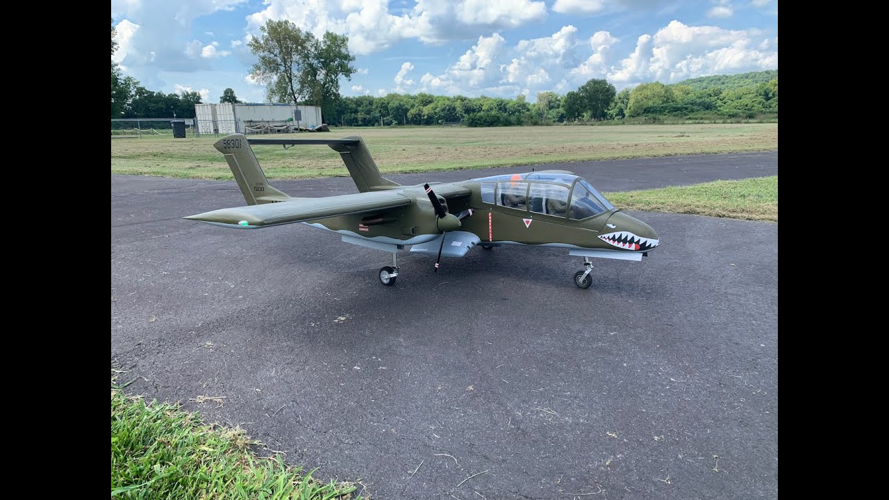

  • Flying Trout
    Nospel,
    A lot of questions. I can only speak from my experience. My setup: Rimfire 46 ( 800 kV), Castle Phoenix Edge Lite 75, 4S 5000 (x 2), Master Airscrew 12x8x3 ( counter rotating). 1995 watts at 135 amps full power. Empty weight 14 lbs 6 oz, flying weight 16 lbs 6 oz. I would definitely use a separate receiver battery. My battery wiring is two in parallel so that both batteries power both motors. The ESC’s are in the fuse. I also combined all the wiring to the wings in 2x6 multi pin connectors from Hansen Hobbies. I did a fair amount of 3D printing. Unfortunately, not in a position to print for others at this time, but in addition to nose gear doors have 3D printed the main doors as well. Other details are the counter rotating spinners, gun mounts and guns, turbo exhausts, longer main LG links that make the struts look a little more scale. Callie Graphics. Video of the maiden here.
    Craig

  • caddguy6
    In regards to my Bronco maiden a few days ago, here's the parts used to power and control her. Everything performed beautifully and provided plenty of power.
Name:	Bronco Specs - JPs Build.JPG

  • caddguy6
    Well I finally managed to maiden my Bronco. Overall very happy with the flying qualities, performance of the power system and basically just the WOW factor. Such a great looking plane especially on a low level flyby, landings are quite easy. Only issue I need to resolve is to increase the total amount of elevator travel, an easy fix by means of swapping out the servo arm with a longer one. The guys at the field loved her too!
    Here's a YouTube link of the first take off and most of the second flight. Bear with the video, it gets better a couple of minutes in. https://youtu.be/_Rh0l29WyKM
