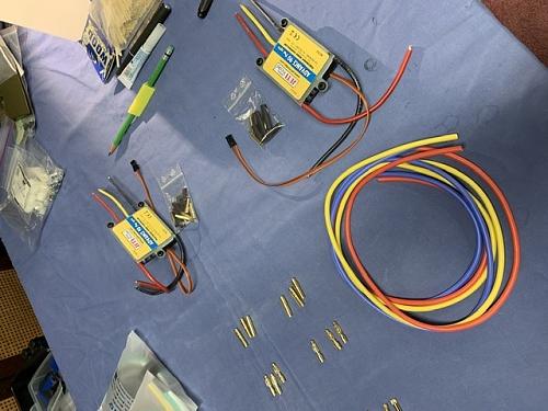

    I installed the CC Caps after researching it and reaching out to castle for more information.
    Click image for larger version Name:	IMG_2545.JPG Views:	0 Size:	135.7 KB ID:	233419. .
    Mike
    Hello, can you tell me more on how did you find what capacitor you need to use and where you bought them?, please.

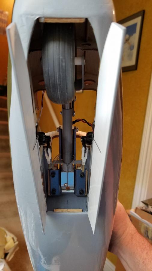

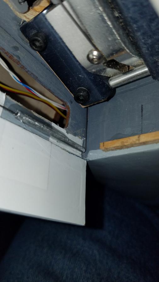

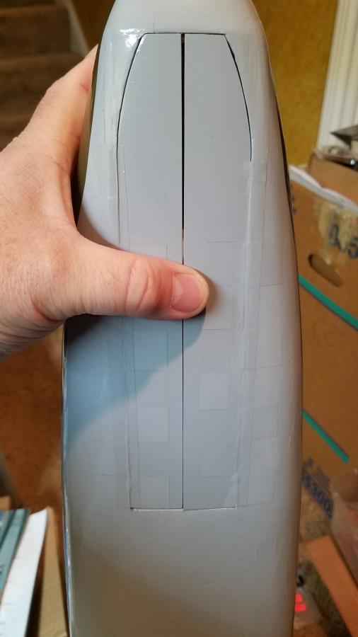

    Well i just got to thinking way to hard and came up with this.

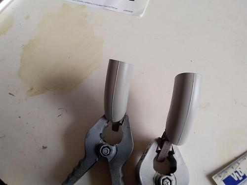

    Monokote style hinges, wire torque rod for open. Now thinking on the closure rod that will catch the last bit of travel of the gear to close them.
  • sam51401
    This may just work out for gear doors
    The laminated nose door is 1/16 so by applying a 1/16 overlap on some monokote hinges, i can keep the door snug and flush to the side of the nose bay. For the closing and opening, KISS is in force here
    as a torque spring on each door will open them and a U shaped wire catch that will connect to the doors will close them as the gear leg is retracted. This may work equally well on the mains also but lets fly it first.

  • sam51401
    Posting a question to the masses on a simple hinging method on the nose gear doors.
    1. piano hinge, Thickness of the door may not allow a flush install and possible interference
    2. small Dubro hinges, same issue with the piano hinge i believe, not allow a flush install
    3. Sonic Tronics offset hinges, high probability but placement may interfer with steering
    4. Monokote or tape hinge, simplest for a flush hinge in this case given the least amount of hinge work.
    Durability is only question but works for control surfices
    Still thinking up a mechanical means of actuation

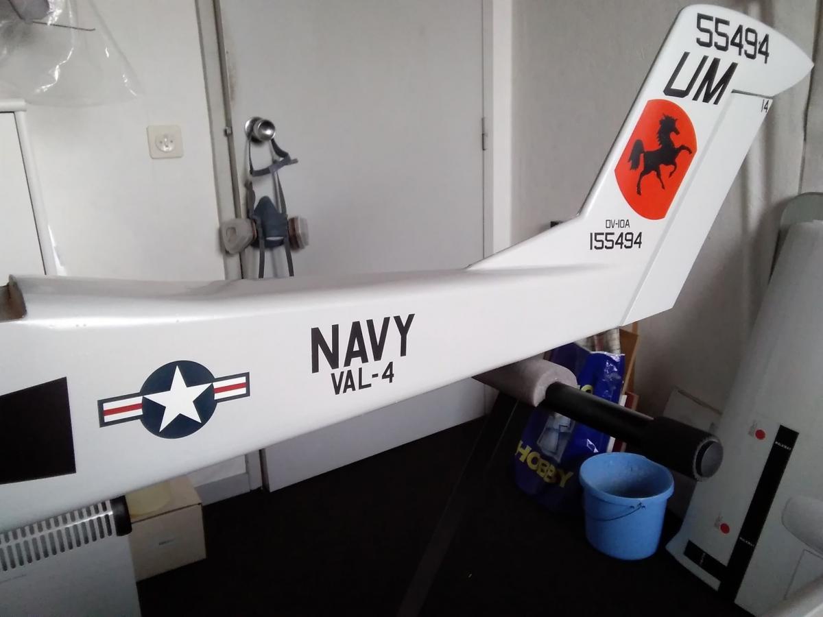

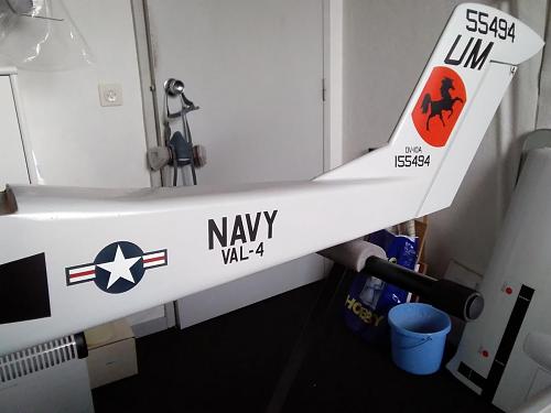

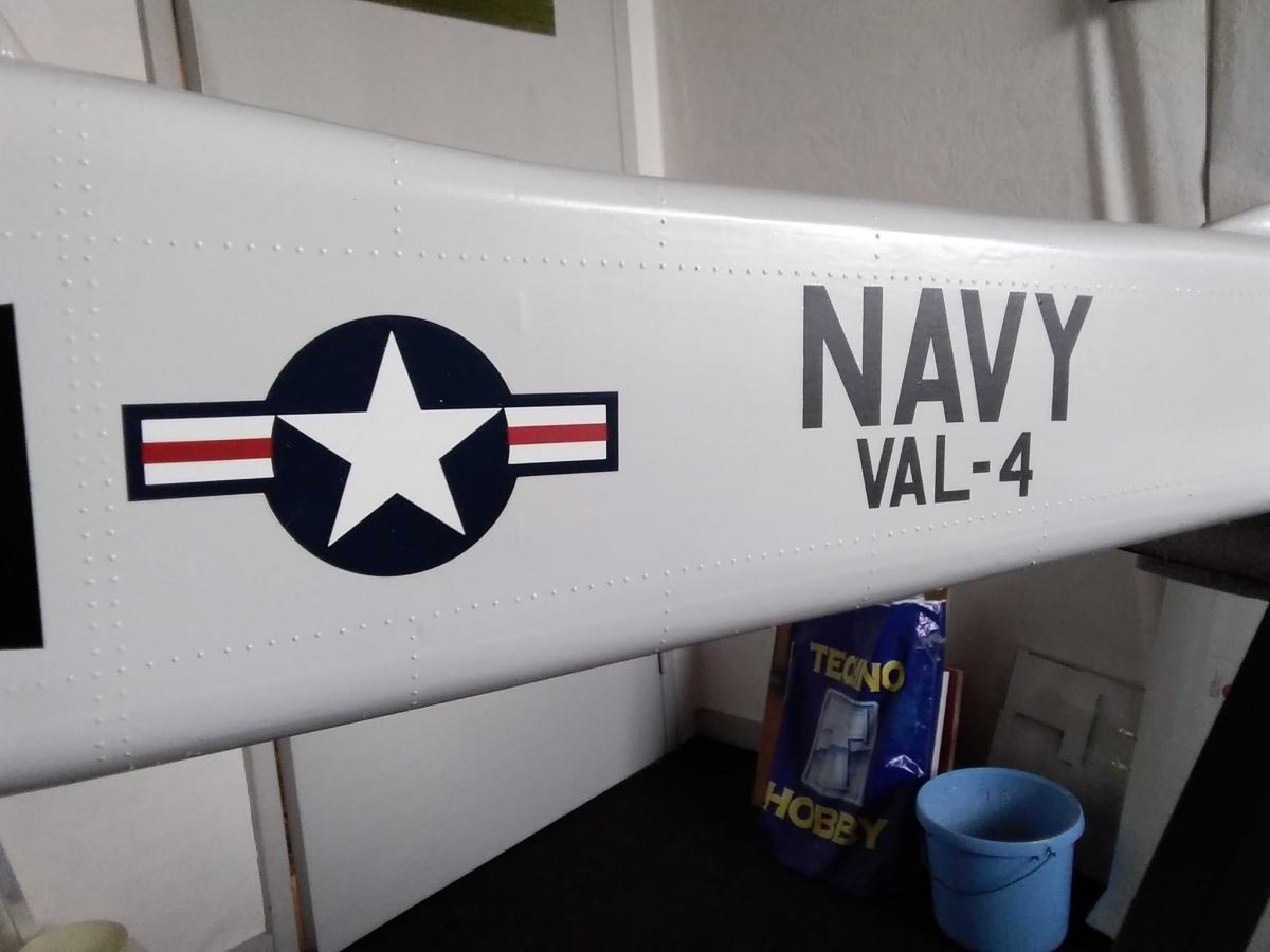

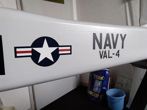

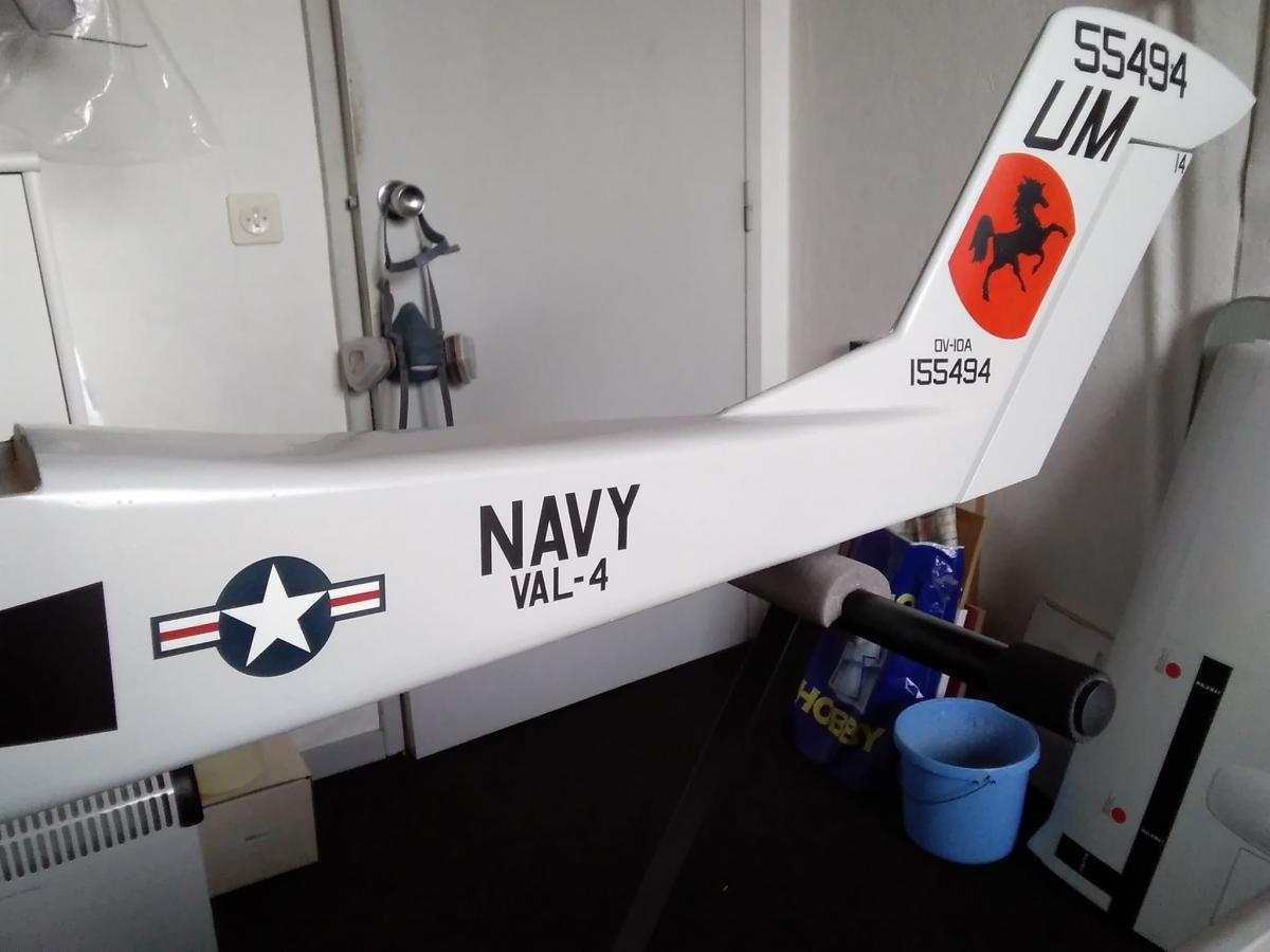

    Some more work done on the decals and painting... coming along nicely
    Almost ready for clear coat, assembly and weathering....

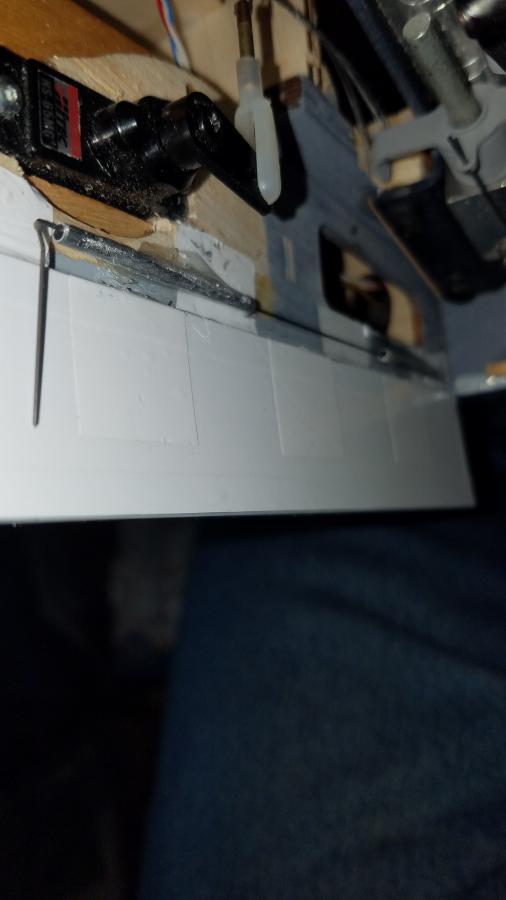

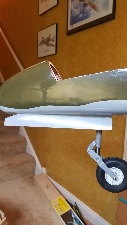

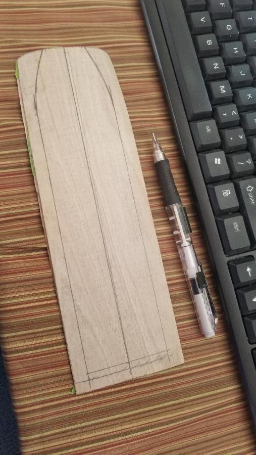

    Well, working from home and able to jump back and forth to the Bronco has me thinking way to much to get this thing flying. Anyway, i just could not pass on that big hole in the front with the nose gear so i molded some layered 1/64 ply last night. Im wanting to try a scale mechanical closure for the doors so no servo and sequencing will be needed.

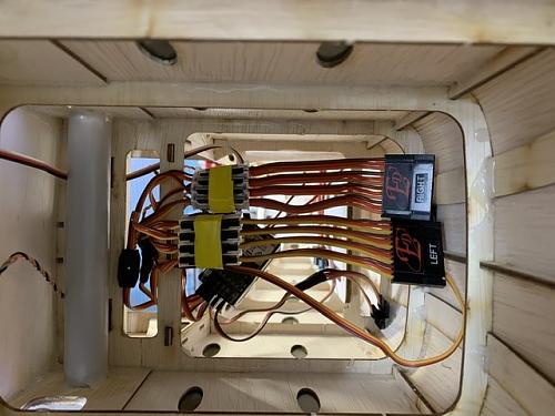

    Nice wiring job, too, caddguy6 Those multi-pin connectors are lifesavers!

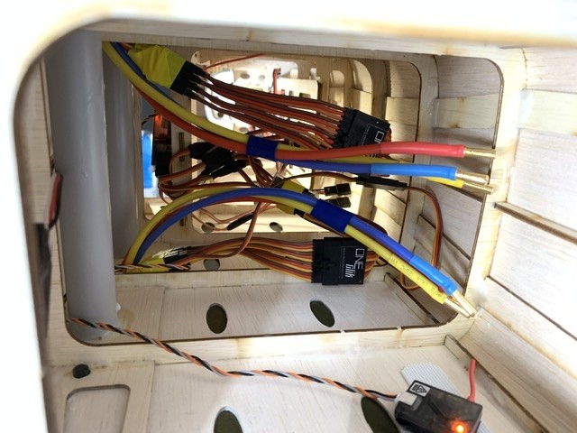

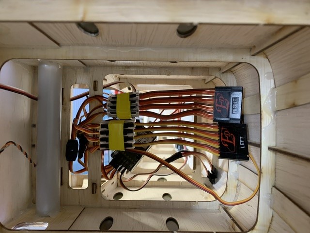

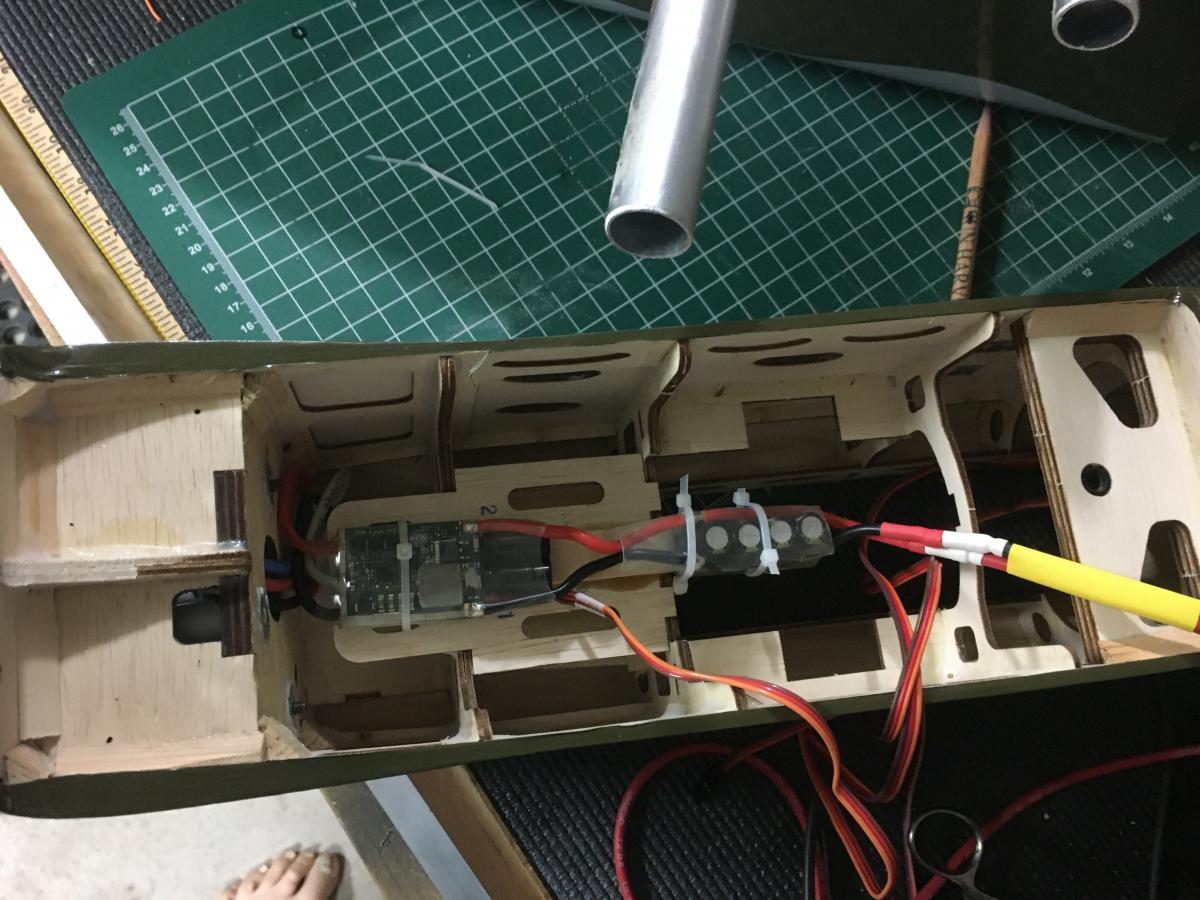

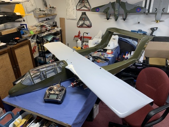

    Well being quarantined moved up my Bronco build and I'm quite happy about that. This project is really rewarding both from working on a model of such a great full scale aircraft and from working out all the internal equipment placements. It appears the only holdup for completion will be the Tru-Turn three bladed spinners. Until this virus slow down is over spinner orders are on hold. Today the flight controls were powered up for the first time, so cool. Still have plenty to do but am enjoying every minute of it. Click image for larger version

    Decals and paint masks from Callie came in... combined with some home made water slides i'm back in buisness...

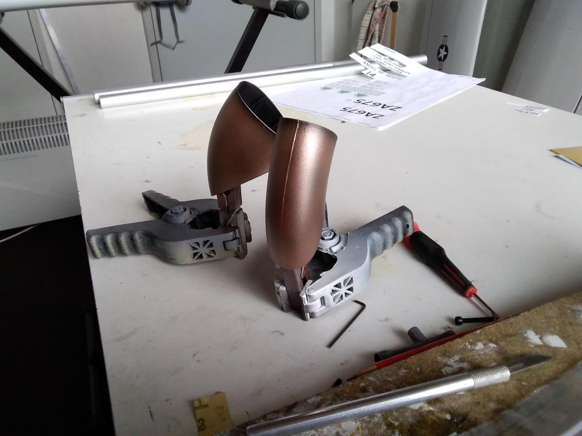

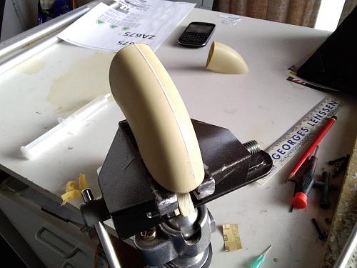

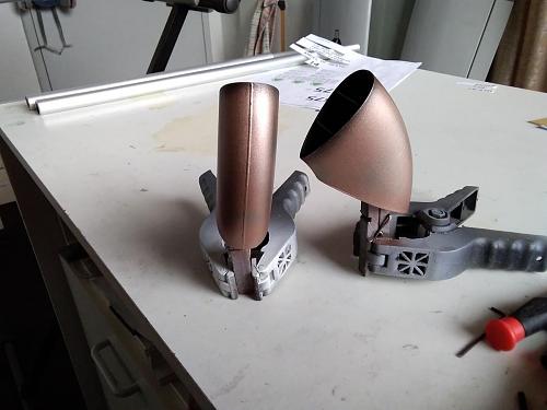

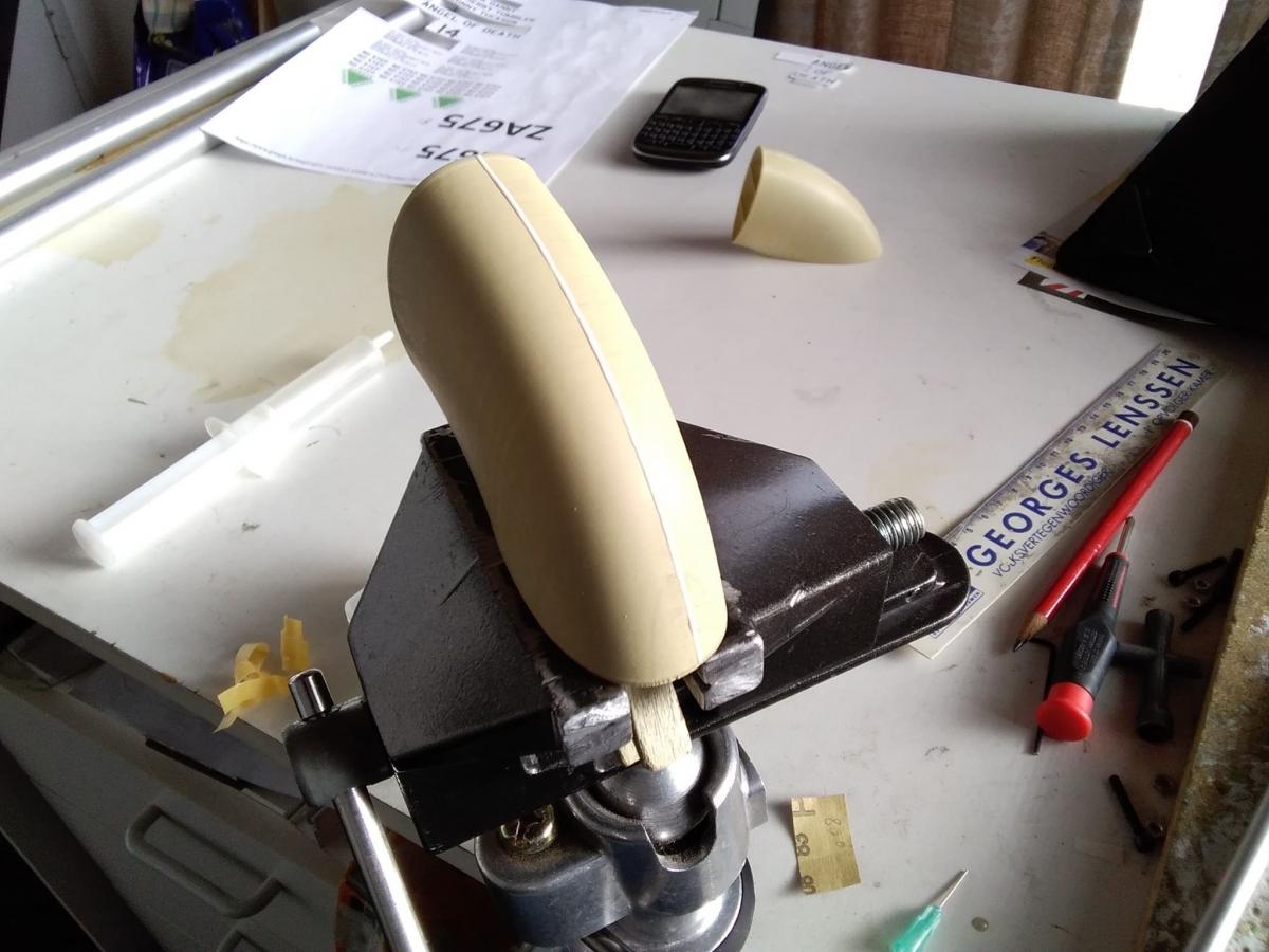

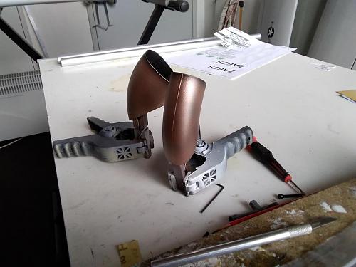

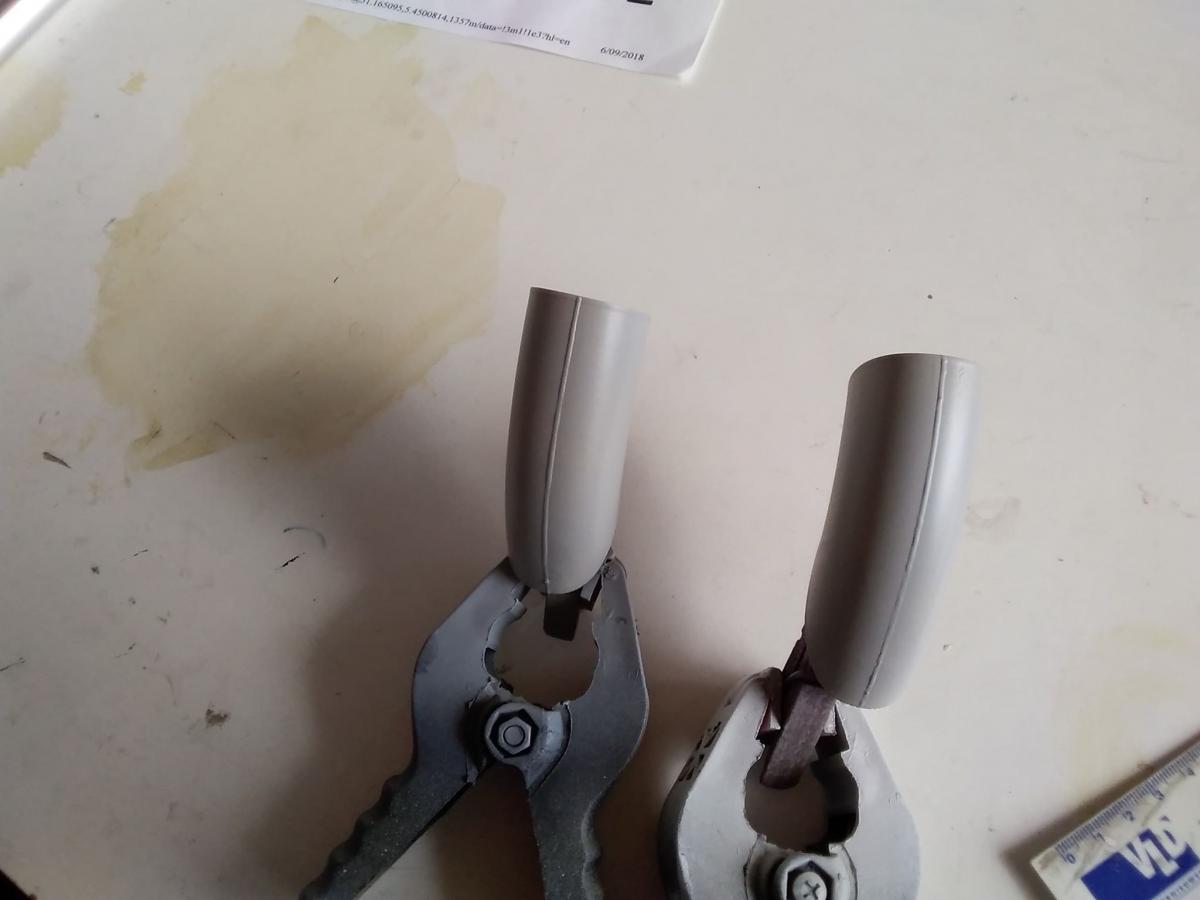

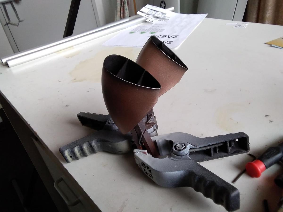

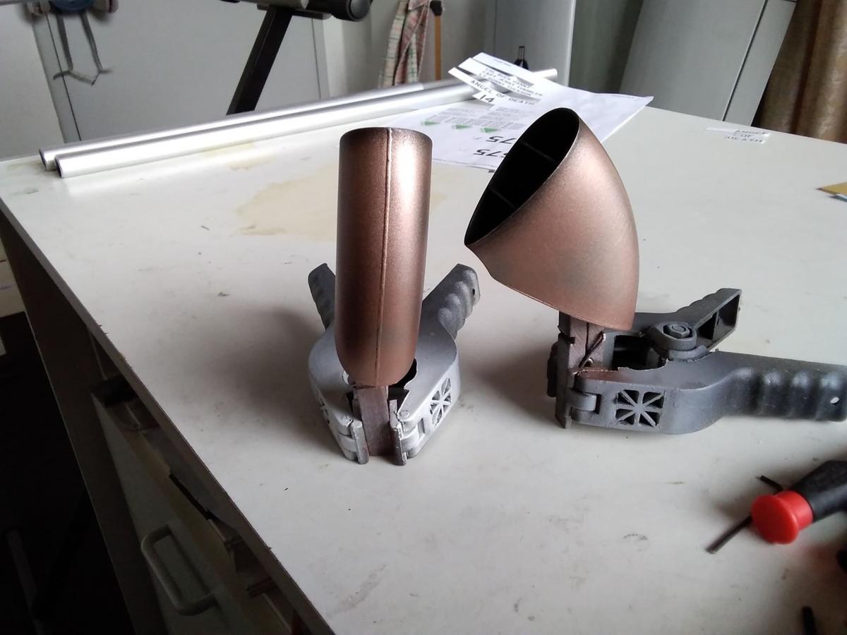

    I had the nice looking 3D printed exhaust still lying around unpainted, so they were next... upon looking at photo's from the full size i noticed a rather large weld seam over the entire exhaust... hmm.. lets see if we can make that as well..
    The prints were primed and sanded, and i gave it a try with simple white glue.... result was exactly what i wanted...
    After a light primer coat...
    So out came the airbrush to finish it all up...
    Very pleased with the result..
    Didier

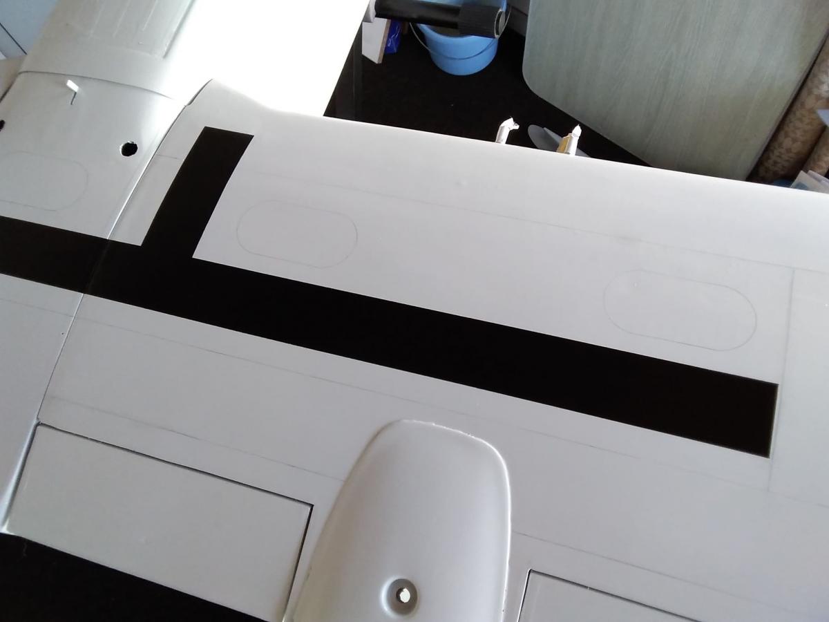

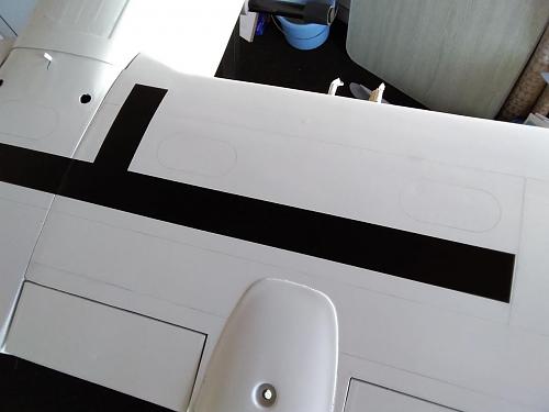

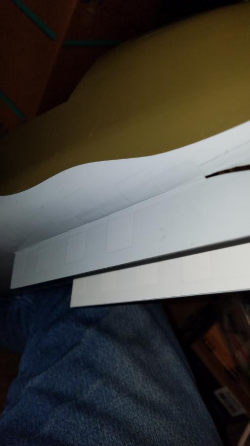

    Due to the corona virus thing i've been running out of supplies to continue the build.... so i made some panellines on the wings using a simple pencil, after a final coat of varnish it will be sealed...
