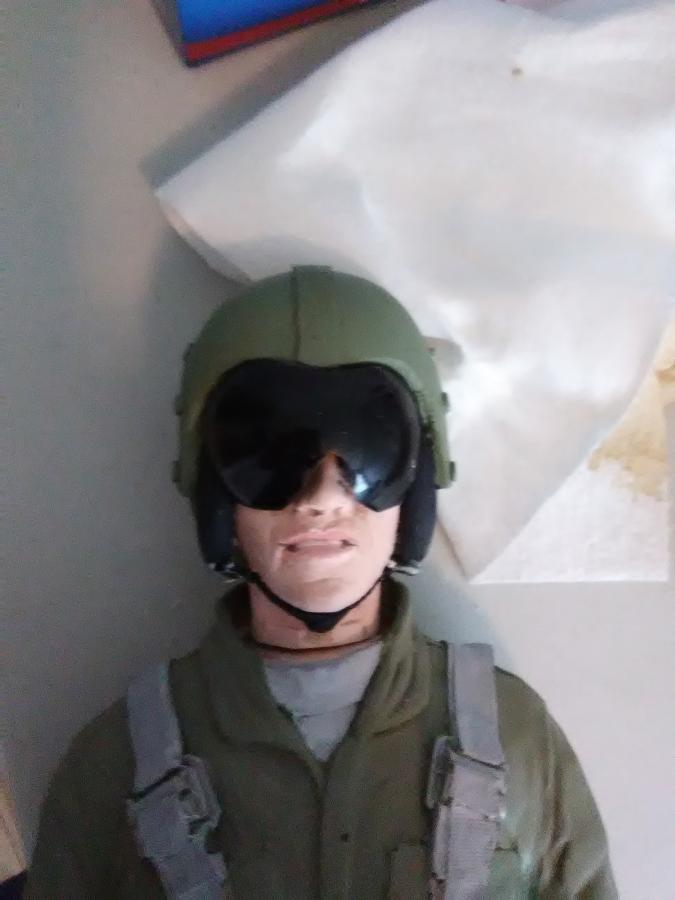

                                      • Request to MA in process for both 15x7 and16x10 sets. Pilots also in works but with another source. Will post more details when I hear back.:Cool:
                                        • Pilot teaser, one with visor down, one up.
