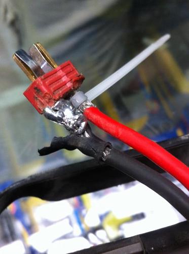

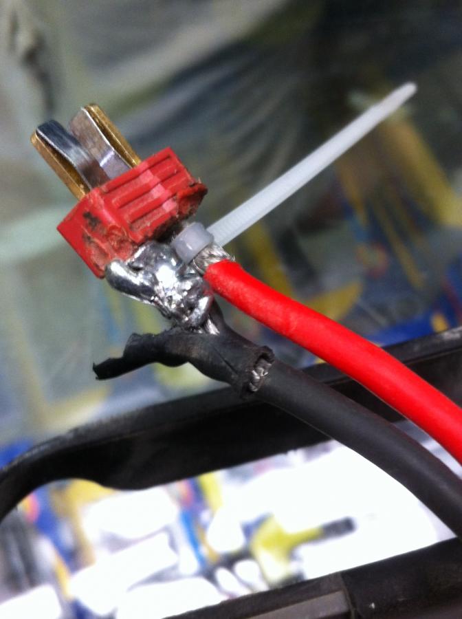

                  #88
                  Originally posted by Boots Whirlygig
                  :(I’m finding that my soldering skills are not great. I even bought one of the solder gun, thinking that might help, nope. Many of my batteries have deans, even 6S packs.
                  Practice , practice and more practice. Don't overthink it. If they come out looking like this your doing it wrong.
                  Mike Click image for larger version

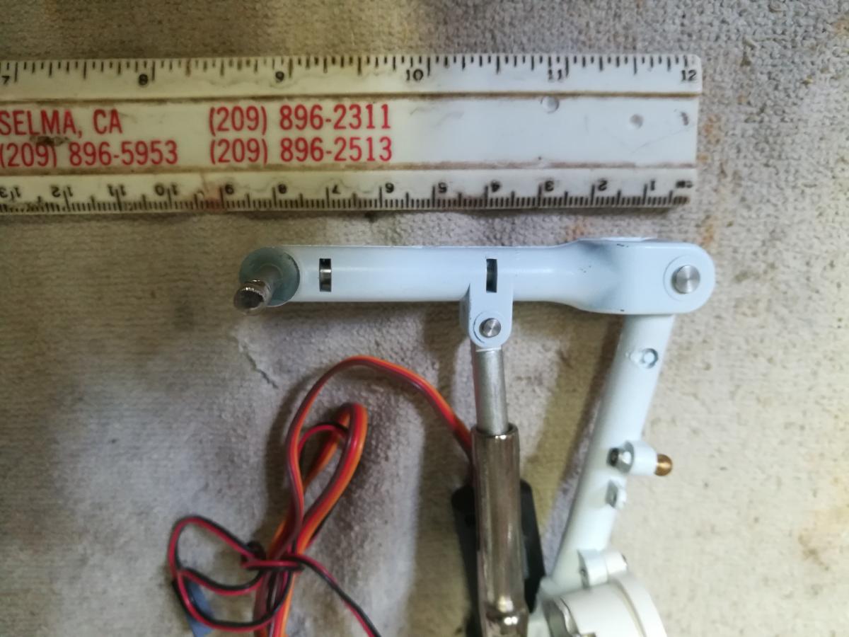

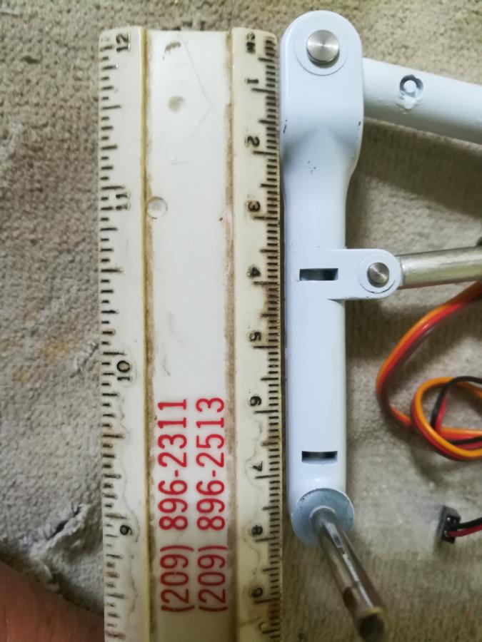

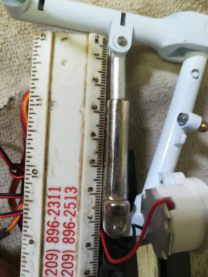

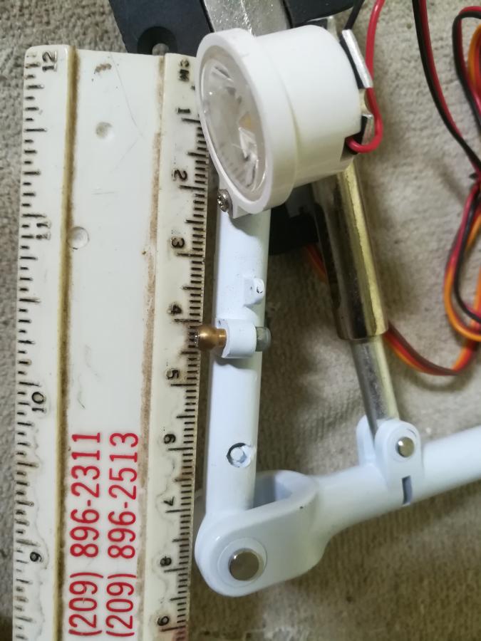

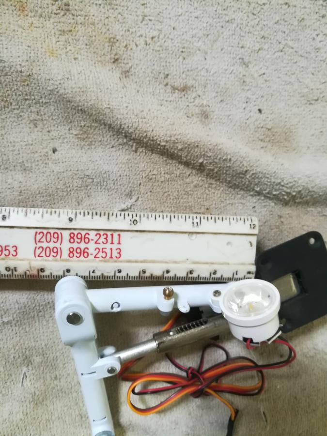

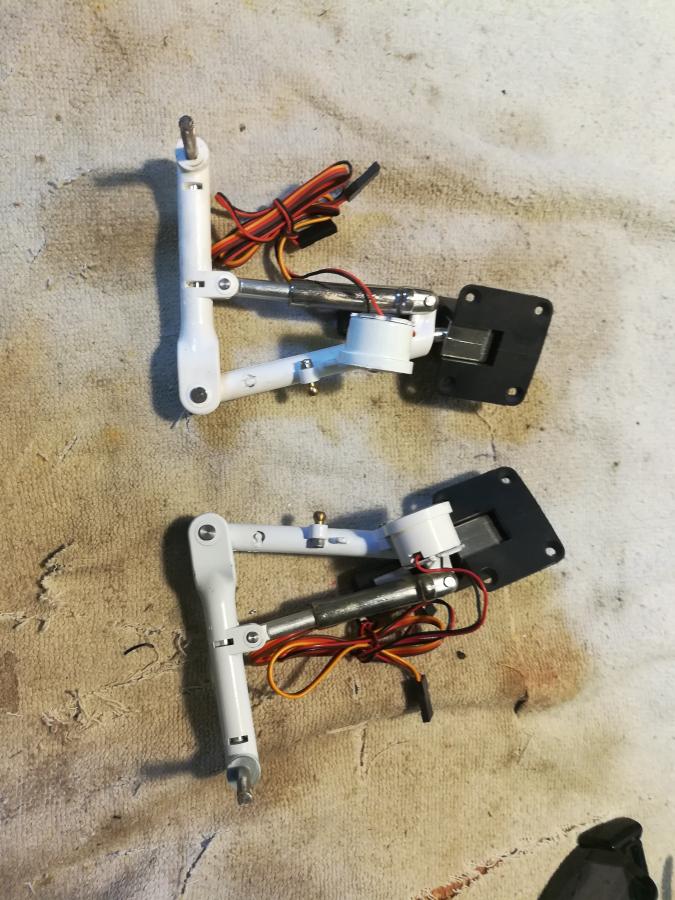

                                You mean like these, I have a brand new set waiting for the day mine give out in my Yak.:)
                                  #96
                                  DUDE....FANTASTIC and Thank You :Hug: Now to get to work and start the tape comparisons :Cool:

                                    #97
                                    Your welcome OV, sorry but I couldn't get the pics to load right, for some reason they coming out sideways, I had them so you could read the ruler better, not good at these phone pics and posting.........:Confused:

                                      #98
                                      Great pics DC, thanks.
                                      So from what I can see, are these molded with a steel pin center? I believe the end of the strut that goes into the retract is bent and non-removable from the top end of the strut The lower trailing arm looks good and good size wheel can be used. Wheels are turning on converting these to bronco struts.
                                      Sam

                                        #99
                                        Sam
                                        Now I am not real sure how these are built because I have never taken one apart but I did hear of some guys breaking these retracts right below the ball link and the main pivot point, so there must not be any metal there, not really sure, I might take one apart to help you guys see how they are built and if you guys need anymore pics and measurements I will try to get them for you and with better pics.?

                                          #100
                                          DC, what is leading me to my inquiry is that in the first pic above, those open slots in the lower arm seems to indicate that a wire is placed in the mold and then it incases the wire/axle to form the lower strut I dont see similar slots in the upper portion of the other strut unless they may be on the opposite side. Maybe we can get MRC guru's to give some insight to our inquiries and offer some help. I believe these are the best bet in a working conversion for the OV-10 and with possibly some minimal work to "play" the part.
                                          Can you give the diameter of the nose wheel please just for clarification?
