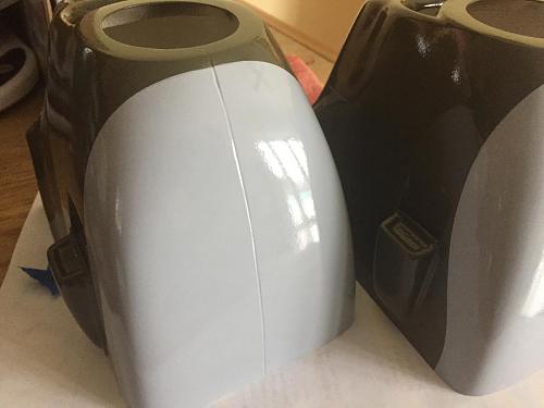

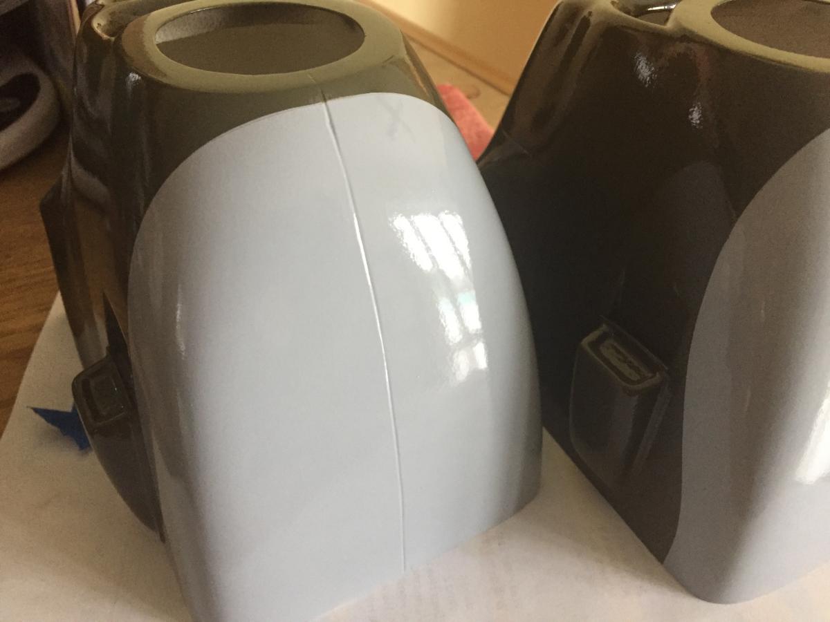

    Just noticed that both of my engine cowls are the same, the scoop is on the same side. Will someone else check their kit and see if it's the same before I contact Motion. Click image for larger version

      I just checked the video and I see that the scoops are correct. One will on the inside and one will be on the outside.
          This is true to the full scale.
