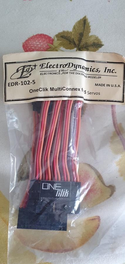

                #427
                i just got my 5 servo connector also this weekend. But i'm unable to keep working on my Bronco due to all the works on my home. Is impossible !!!🤨

                        #431
                        Originally posted by wrangler1
                        I'm also waiting for the SBUS TO PPM converter that i ordered 3 weeks ago !!!!.
                        Is there other way that you know that i can do it 🤔 ?
                        I just got 4 off Amazon direct from FrSky(overseas) so im waiting for the boat also. I opted for the 4 output version just for flexibility for other setups. Im going to Y the Sbus and then use them for flight controls of Ail1, Ele, Rud, Flap on one then Ail2, Rud, Flap. Ill have an extra open port on one side but it will clean it up some.
                        So just thinking of this i think the cabling will be as this
                        From the fuse to each wing
                        2x Sbus(4 srv on left, 3 srv on right)
                        2x ESC1, ESC2
                        2x Retract(LH/RH)
                        2x Battery
                        2x Lights
                        2x LG doors(optional) Like to do mechanical actuation if i can work it out.
                        I could use the ED multiconnectors(3 servo) to pick up the ESC, Retr and lights so that will give THREE total connections(per side) when installing the wings
                        I think thats enough and may have little room left even using Sbus:astonished:

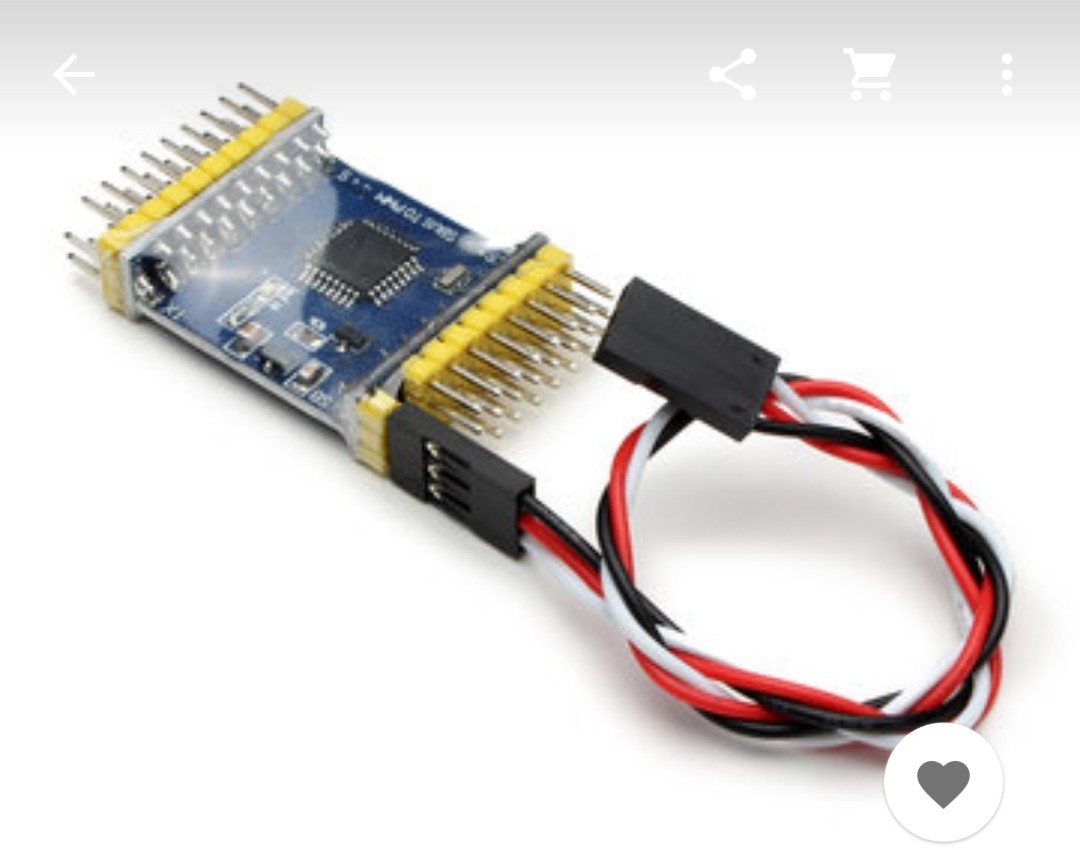

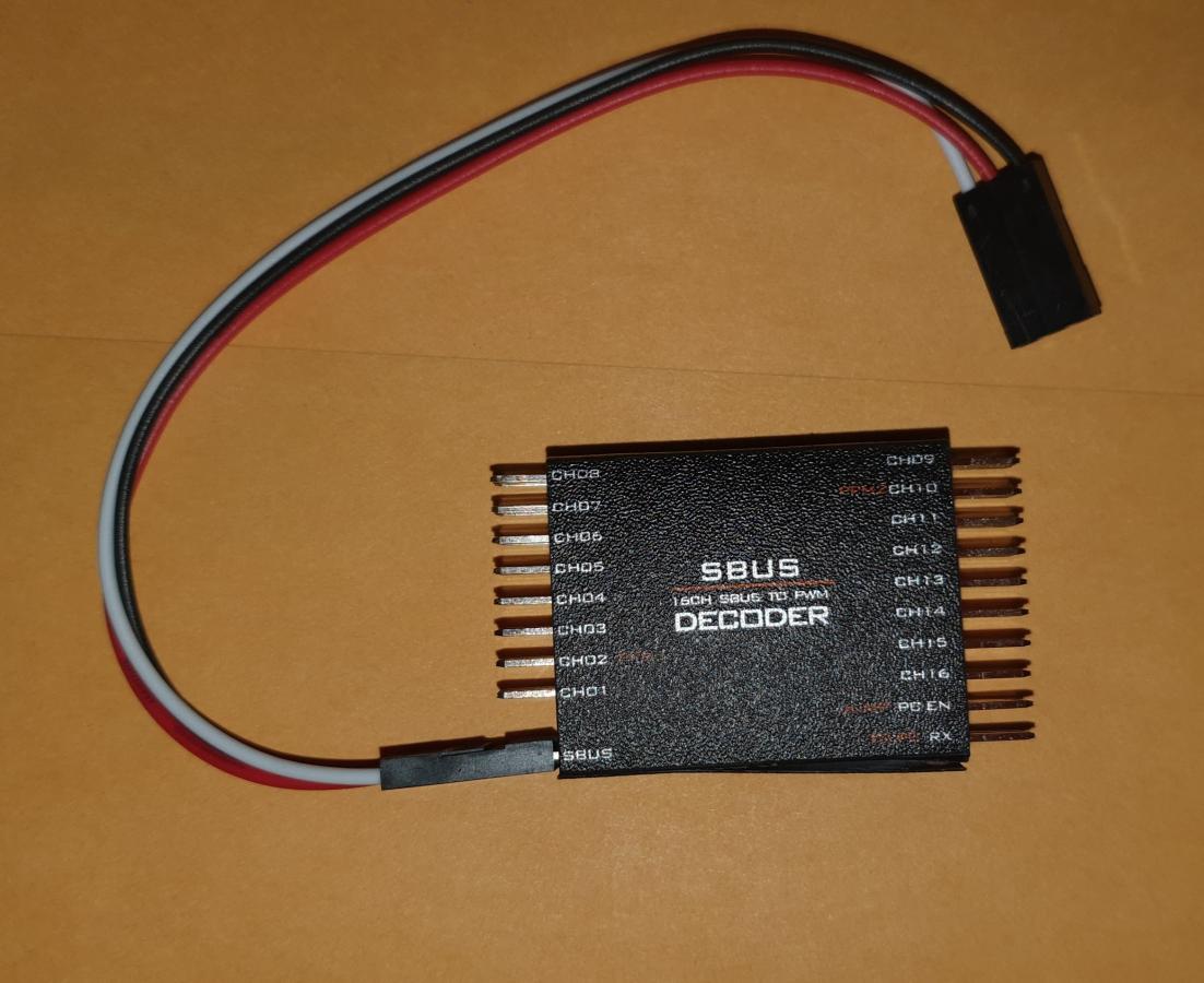

                            #433
                            Hello to all !!. i just got my 2 SBUS TO PPM converters and my custom made Callie Graphics with some nomenclatures.
                            I still have my house upside down that's why i didn't work on the plane, i think i have 2 more weeks before i can do something to the plane 🤨🤨🙄🙄. But on the other hand i obtain a home theater space so i'm getting entertained looking for A/V Equipment. jejeje.
