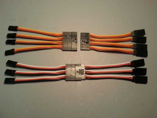

          I'm trying to sort that out also. There's a bunch of wires. I might use these from Electro Dynamics as I happen to have a set laying around. I have the set that does 3 so that would deal with Flaps, Ailerons and the Gear.
            Mike Click image for larger version
            Thta's the same way that i went !!
              I'm soldering up extensions to try and keep all the connections to a minimum. Figuring the exact length has been a headache. It's coming together slowly. The nose wheel steering set up sucks.

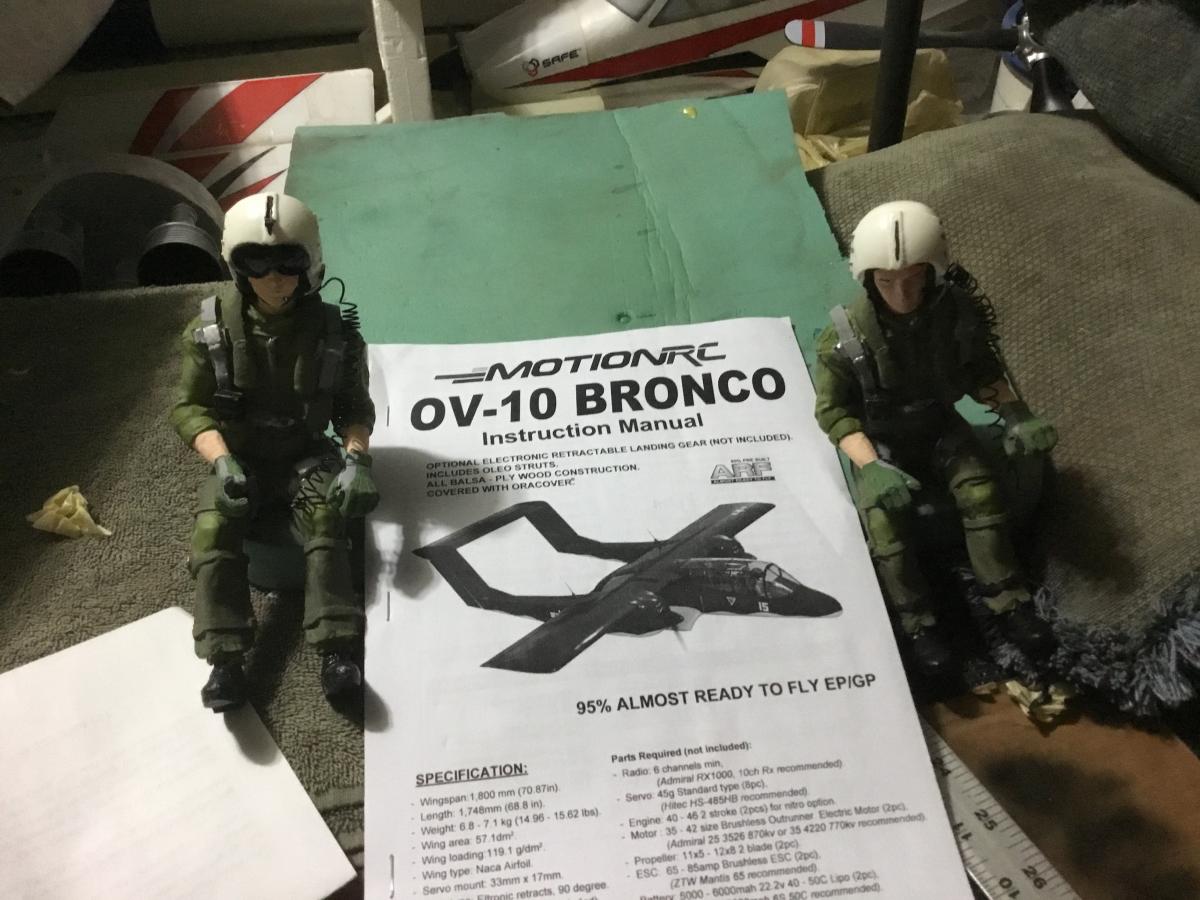

                        Originally posted by MikeT
                        Got my pilots from Mike over the weekend. Waiting on retracts and I'll be set.
                        Mike Click image for larger version Name:	IMG_0208.JPG Views:	0 Size:	123.9 KB ID:	207185
                        Are those the 1/7th scale?
                        • sam51401
                          • 368
                          • Sellersburg IN

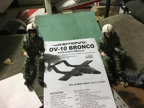

                          #572
                          Hey Tbolt, yes they are 1/7th as i have the same crew for mine. Have to cut the legs about the knees but they are awesome. Once i get my wiring and retracts in ill finish the cockpit and crew. My club is having a warbird meet in Oct so im trying to get mine up for that.

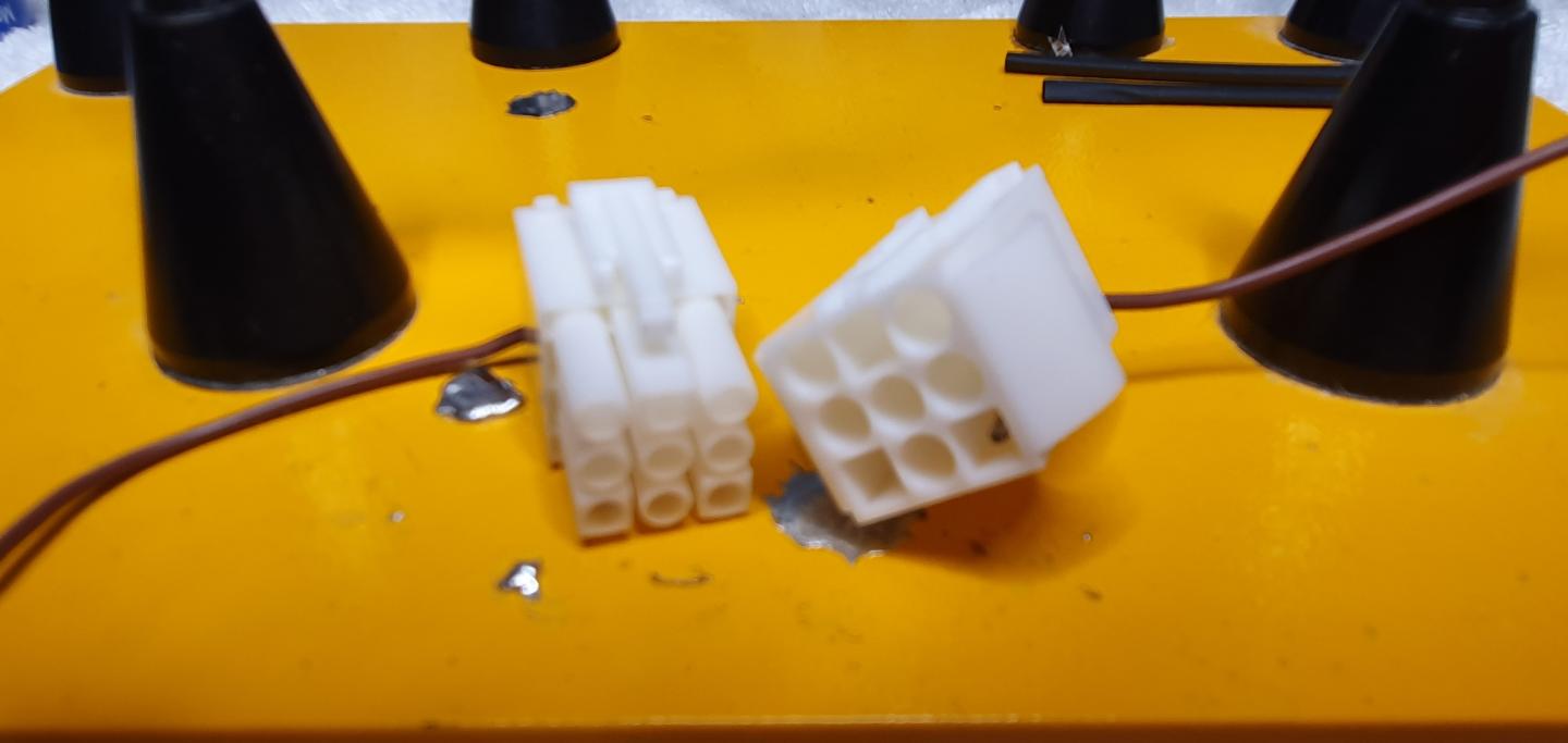

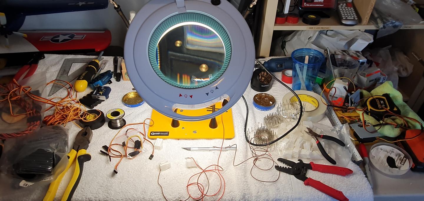

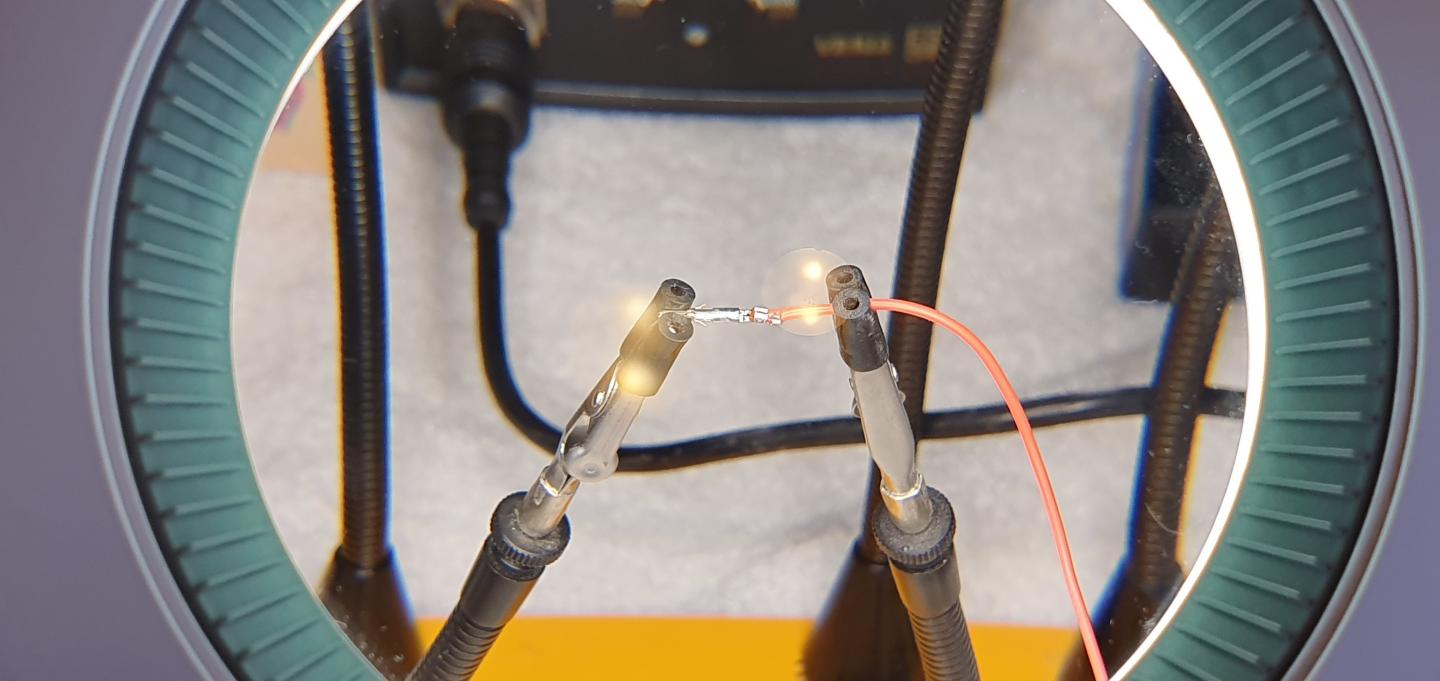

                                        Hi to all, i'm resuming the build of the Bronco, but i will try another servo connector wich i think will work good Because it has 9 ports, since the ground and the positives are common, i will have 7 ports for signals. I'm in the soldering process.
