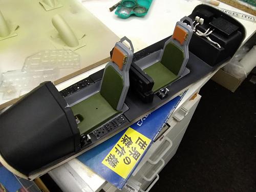

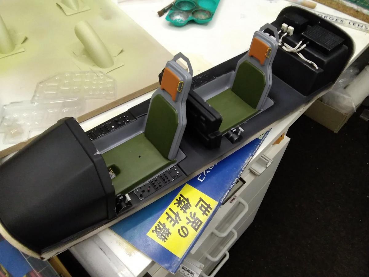

      Cockpit is done, still need to get the pilot in, and fix the canopy...

        That really looks nice! You're gonna make me do mine aren't you? LOL

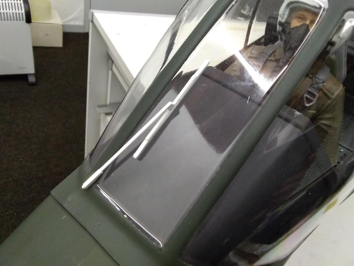

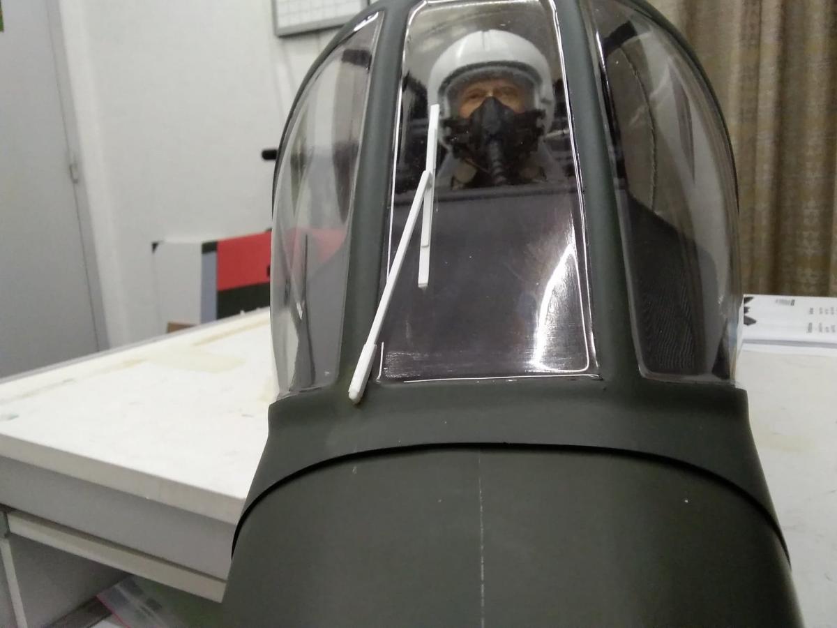

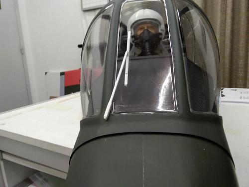

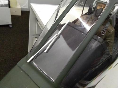

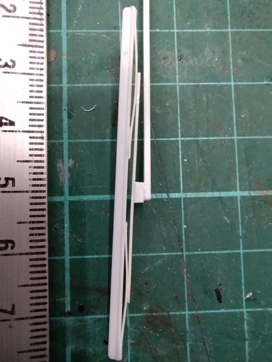

            In the meantime i made a window wiper, it was a detail that just had to be made... it's entirely scratch build from plastic strip and sheet...

              Now there's a modder that is def in the details zone

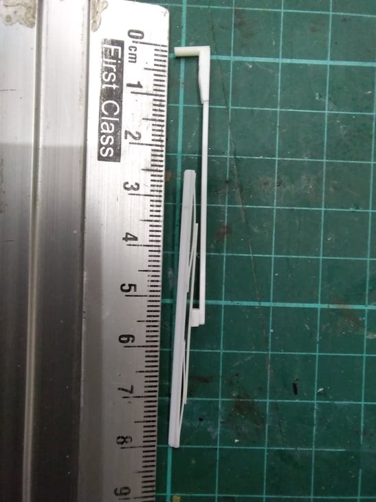

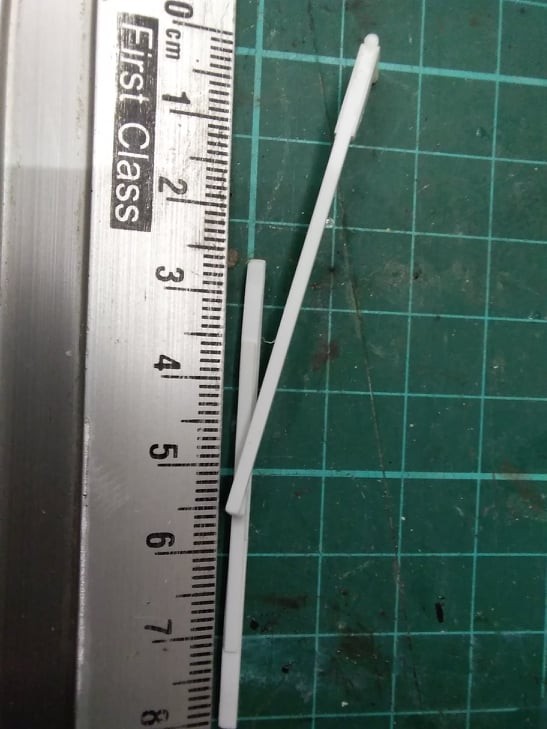

                Can i ask for some detail shots and dimensions, i would like to copy you fine work on the wiper. I wish i was more proficient with my 3D printing to make this and the panels but Evergreen is still my best go to.
                Great job on these details as it will add some character and Im doing panel lines currently with shades of gray and black before i do final assembly and placing the Callie Graphics.

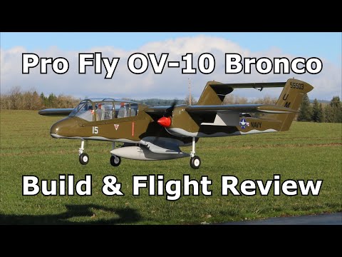

                    Hello Gents, I completed my build video for this bird. It's not comprehensive but it touches on a few things that I haven't seen covered in other builds. I've never created a video like this before as most of my stuff is eye candy or occasionally filming another pilots build process. I hope it is useful.

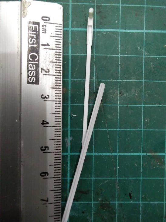

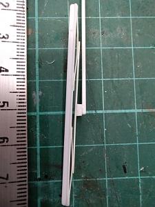

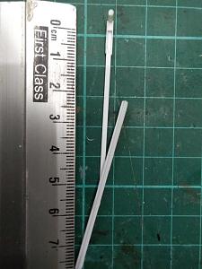

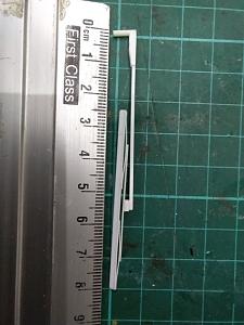

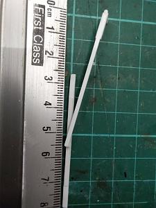

                      Sam, i've made some photo's alongside a ruler, i hope it helps! if not, just ask

                      Really looking forward to your result, especiallly the panel lines...

                        Kudos on vid WBRC, really like the rear cargo mod as i was able watch troops be dropped while i lived near Camp Pendleton way back. I have the same lighting system also that i got for my A10 but never got around to install it so it will be used on the Bronco.

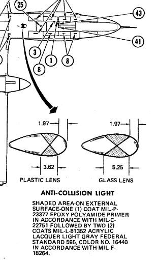

                        Wing tip light lens are the ones from the L-39 but i need to find two suitable tear drop lens for the anti collision lights. The landing light is like you, a flashlight LED and the lens is from the craft store, found a package of large rolling wiggle eyes that fit perfect.
                        Thanks didier for the above pics, should be a easy build

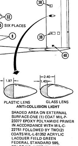

                                  Can anyone point me to a suitable plastic lens, tear dropped shape, clear or red, that I can heat and mold or is preshaped for the two anti collision beacons.

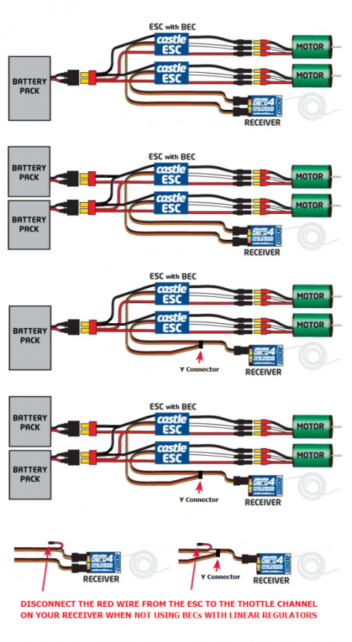

                                          Gents...I found a drawing to help make a dual battery dual ESC Parallel system cable
