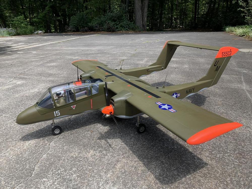

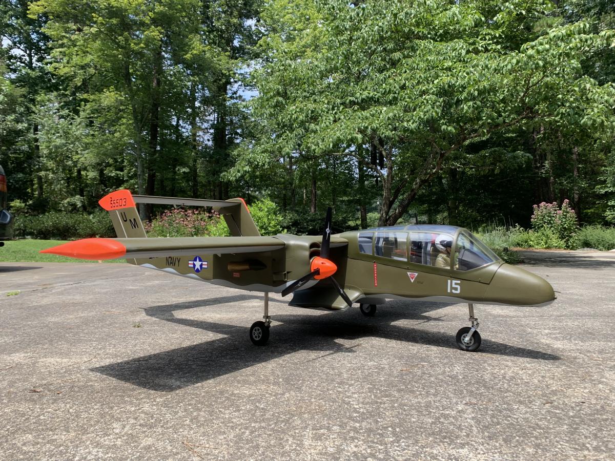

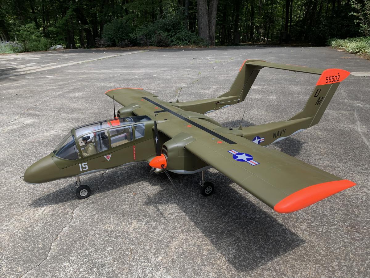

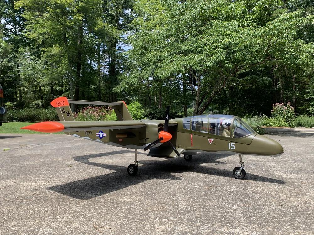

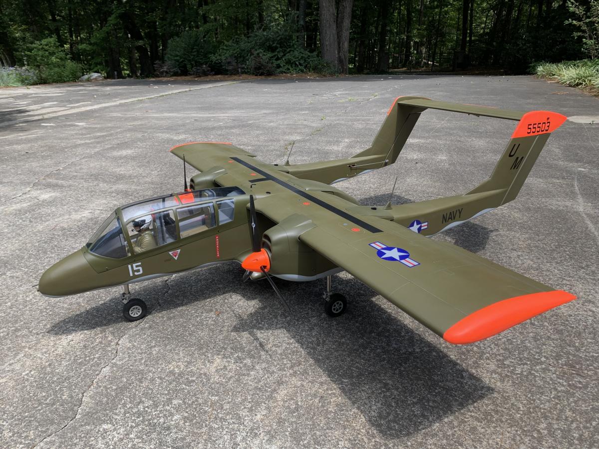

                  Click image for larger version  Name:	731097B0-2E25-4836-8A7F-0660BF4612EB.jpeg Views:	0 Size:	224.7 KB ID:	320882 Ready to go, few more tweaks and radio set up and this thing is in the air…2x power 52’s swinging 14x7x3, all up weight with 2 6s 5000 on board 17lbs.

                    Looks Great.

                      Looking sharp, I would love to see it in the air!

                        #931
ID:	321046 Thanks guys! Much appreciated, will try to get some video when it gets in the air.

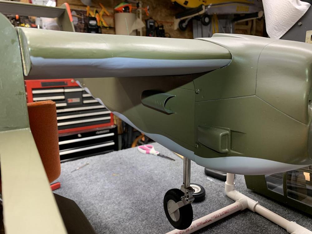

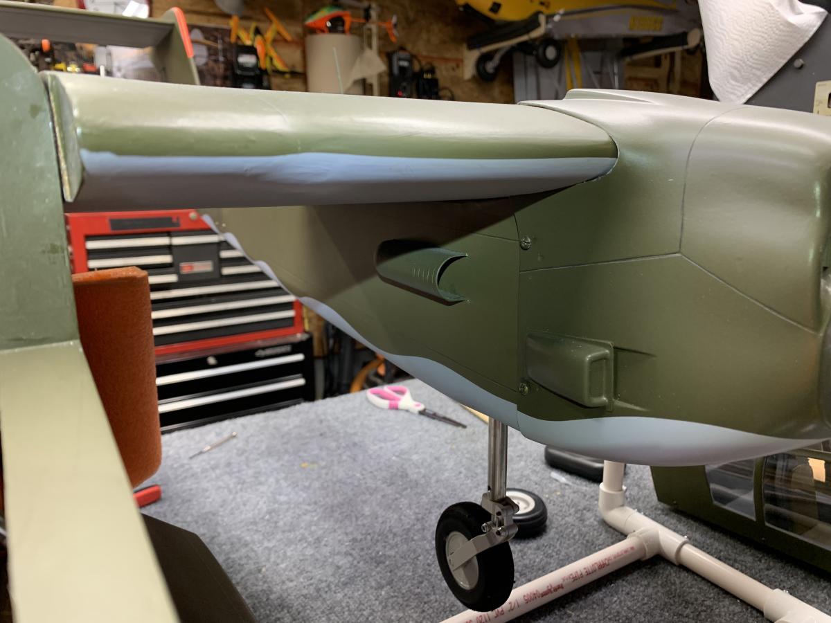

                              #934

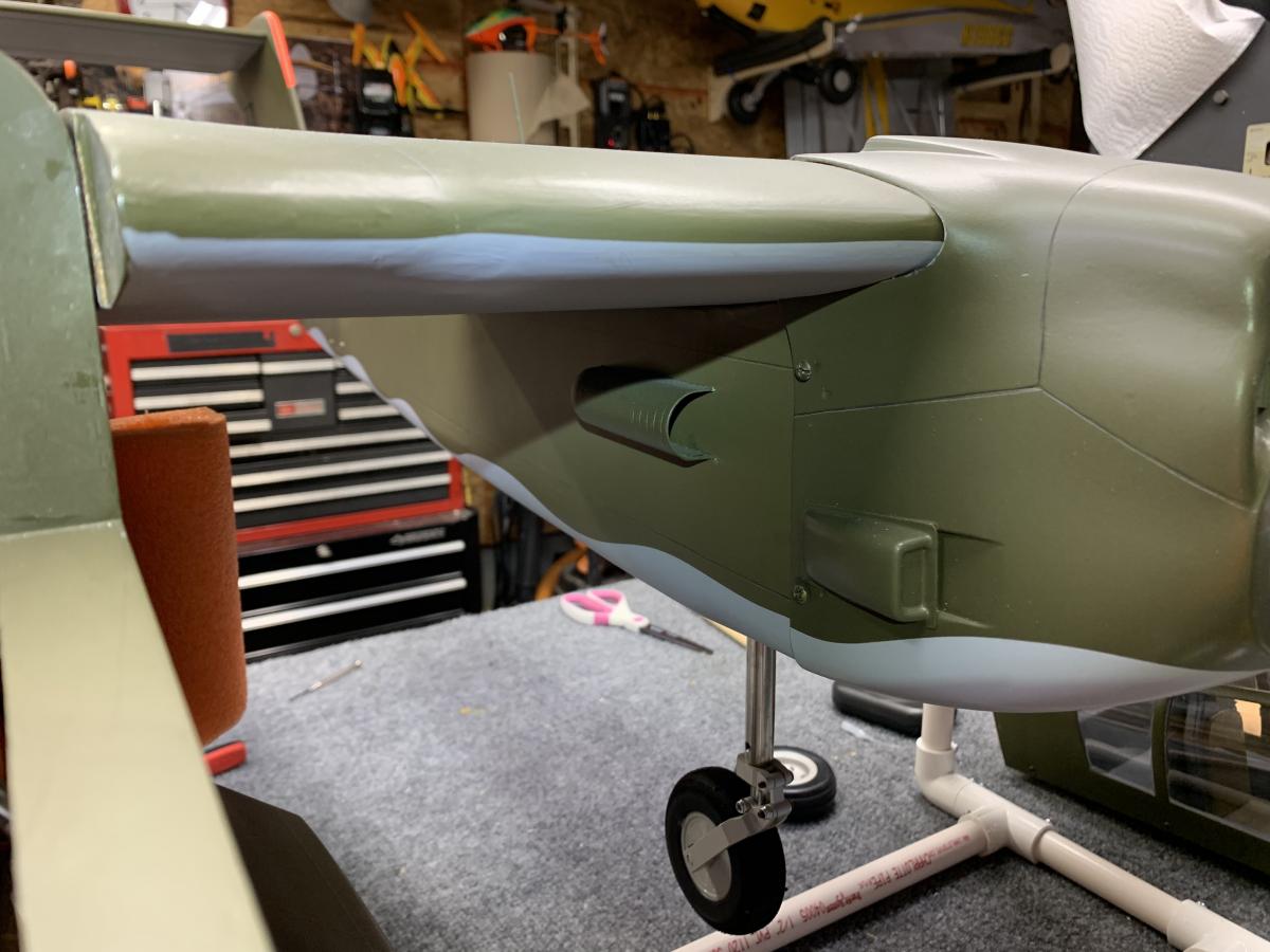

                              Hi Sam, yep counter rotating. I put my esc in the booms, using the freewing 100 amp pair for the a-10, caps in place and plenty of wire to get thru wing to fuse. I am going to keep wing and booms as a unit( I have a older Honda van for hauling planes)I did add intake scoops on inside of booms with a flonase cap sawed in half to get some cooling air into the compartment. Vallejo dark olive drab is a perfect match for the green.
                              Got my radio setup done and ran up on a receiver that would not bind, contacted them and they want it back, so will be another week before I can get a new one, still need to check cg and a few other items,like the painted prop tip idea. Here’s a shot of my intake scoop

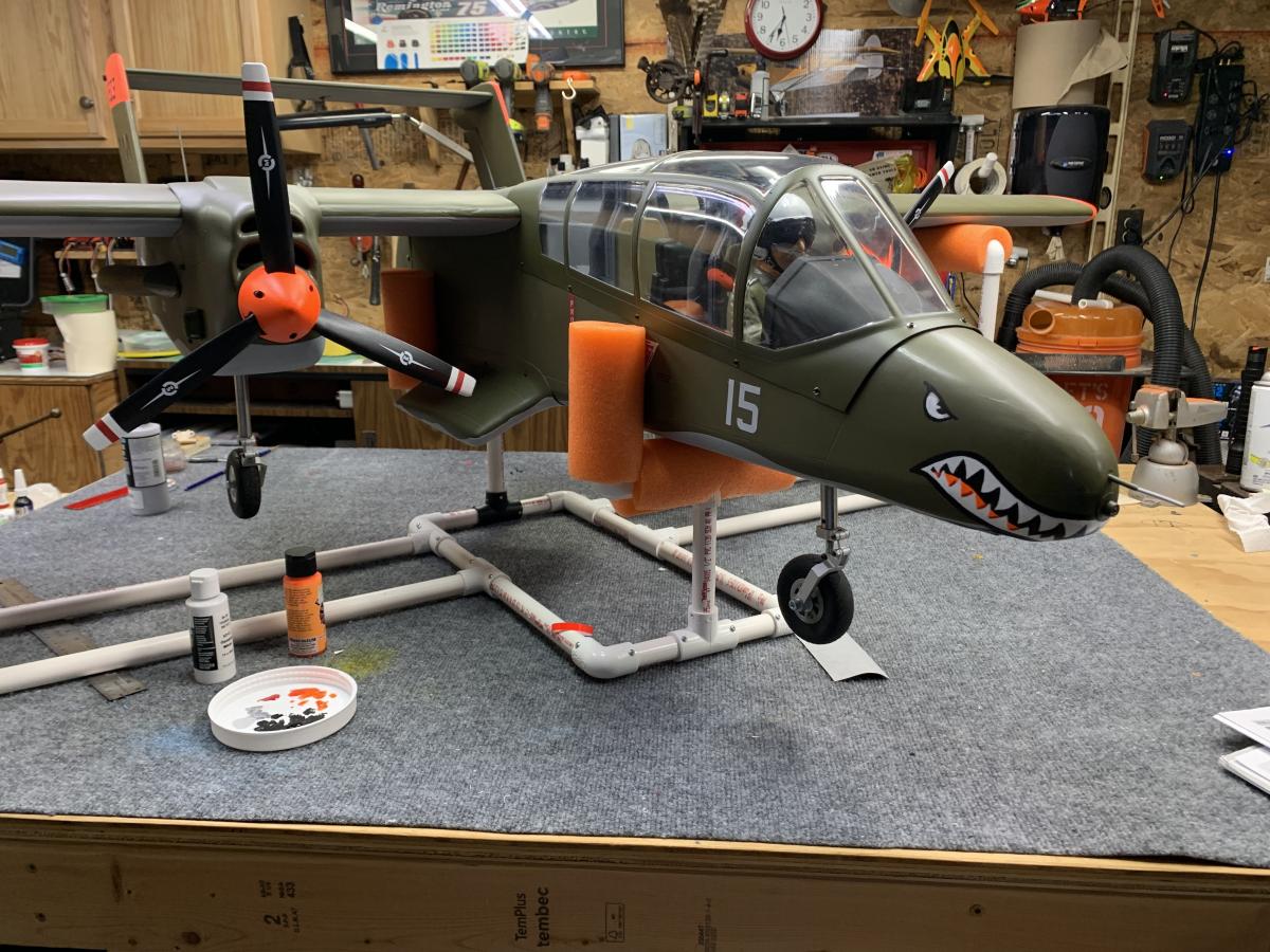

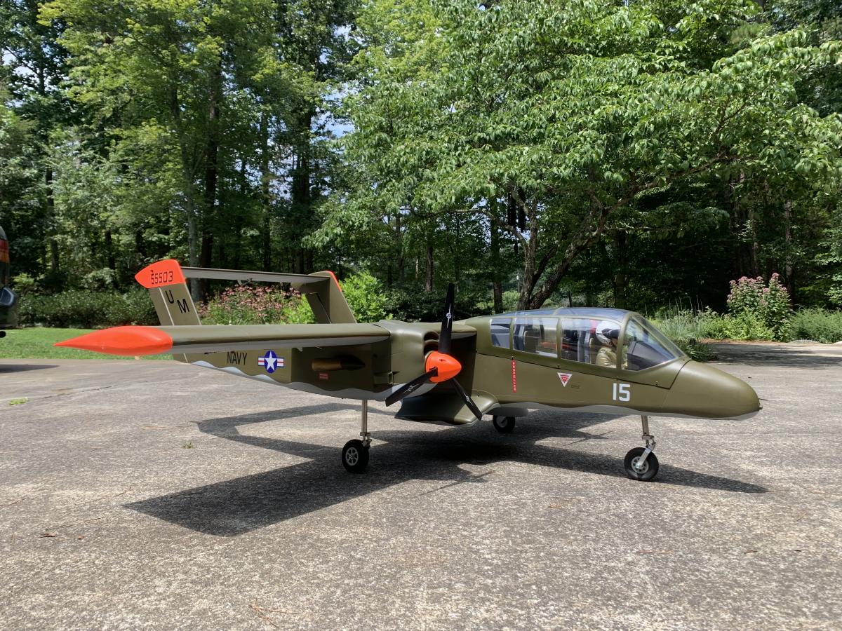

                                  Got props painted , and added nose art which really kicks it I think, got new receiver today so might get it in the air soon, weather not looking good for a few days.Click image for larger version
