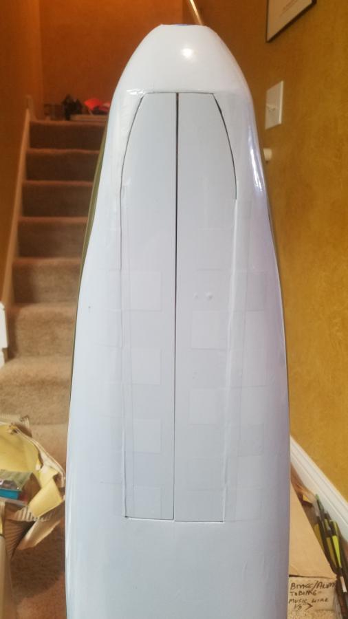

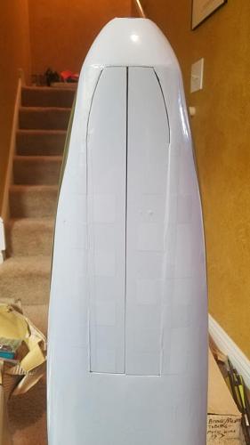

      This may just work out for gear doors
      The laminated nose door is 1/16 so by applying a 1/16 overlap on some monokote hinges, i can keep the door snug and flush to the side of the nose bay. For the closing and opening, KISS is in force here
      as a torque spring on each door will open them and a U shaped wire catch that will connect to the doors will close them as the gear leg is retracted. This may work equally well on the mains also but lets fly it first.

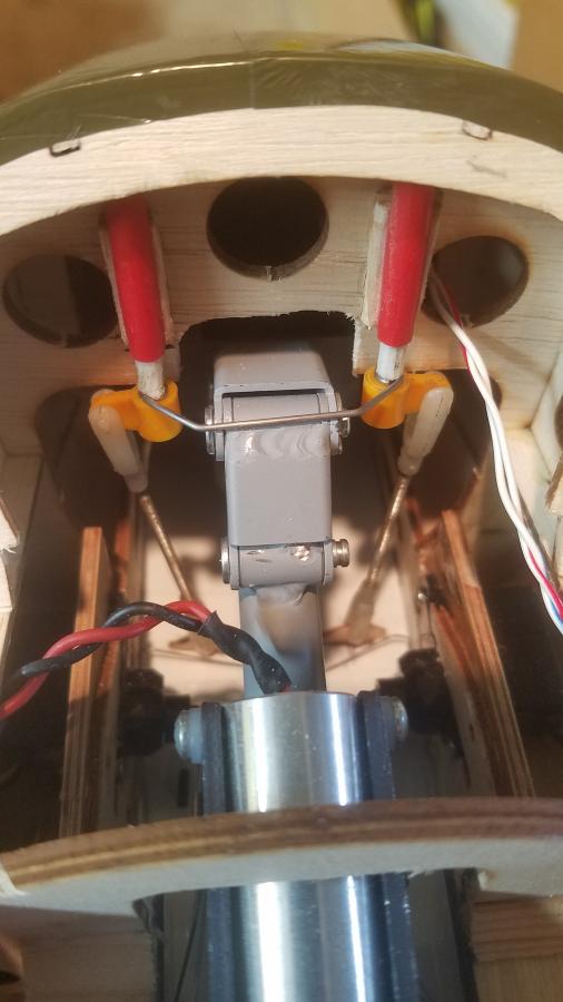

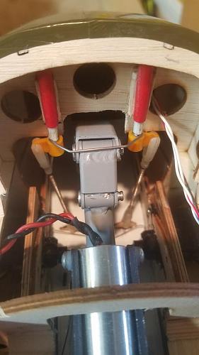

        Well i just got to thinking way to hard and came up with this.
        Monokote style hinges, wire torque rod for open. Now thinking on the closure rod that will catch the last bit of travel of the gear to close them.

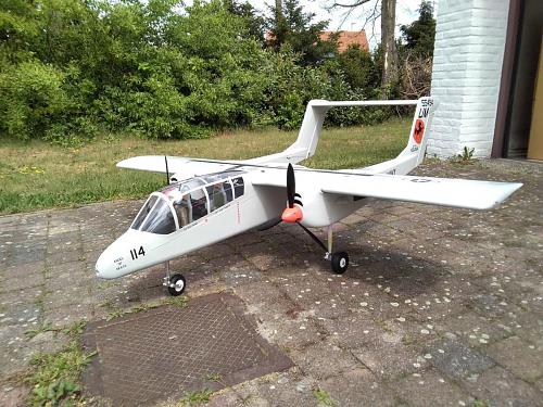

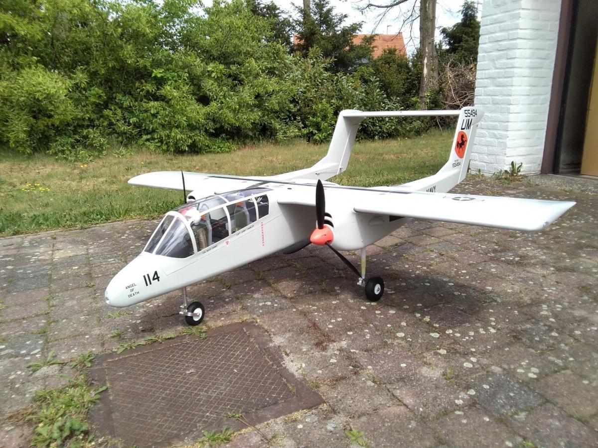

                    Progress so far... still need to paint the LG, some details and weathering.... almost done...

                        I'm at 8.8 kg AUW now... hoped for a bit less...

                                      Well, Its done and works like a champ. No servo, no sequencing, just a simple mechanical actuation which can be used also for the main doors if anyone else feels ambitious. The main doors are not as simple as the bottom of the booms have a curve to it that prevents the same type of Monokote hinge i used on the nose. The doors open by a torsion wire that is shown in the prior photos i posted and shows more details. Enjoy and hope this inspires others to be able to install gear doors if so inclined.
                                      Further details available and other suggestions appreciated.:ov10::ov10::ov10::ov10::ov10:
