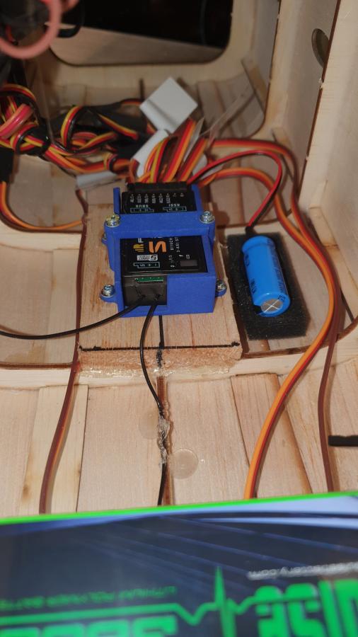

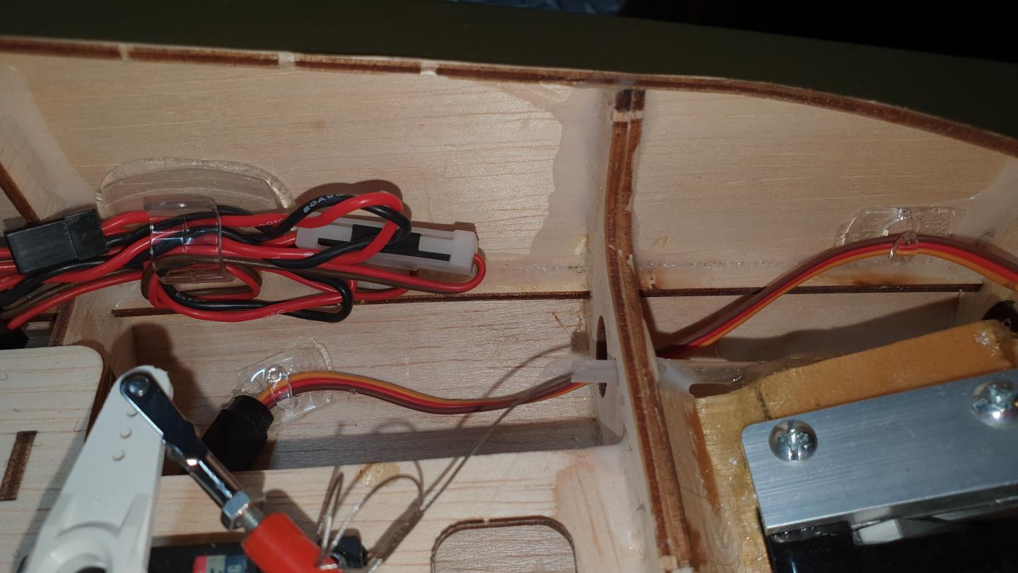

      Just finished hooking up my two receiver's, one in each fuse. So now putting together at the field I only have ESC to battery out of one wing and the same on the other wing plus nose gear lead.
      Hopefully it looks like it all works well...………….well till the test flight. Still waiting for MRC to get the retracts in, got to be soon, surely

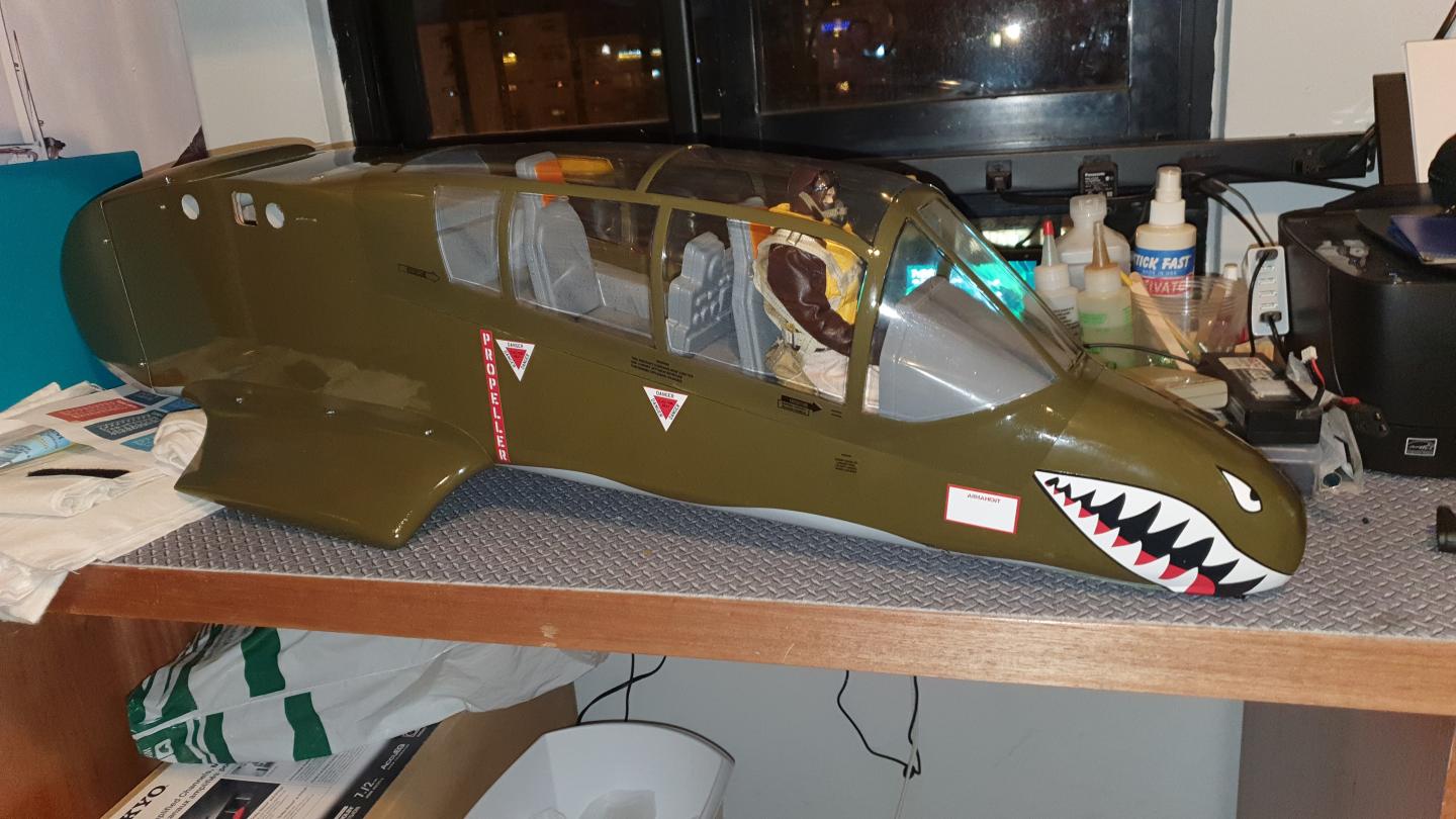

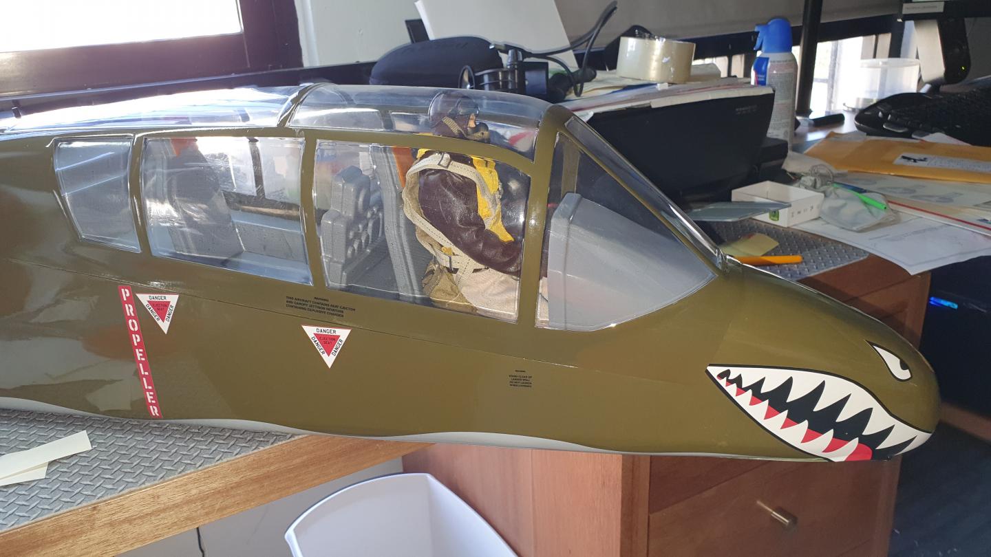

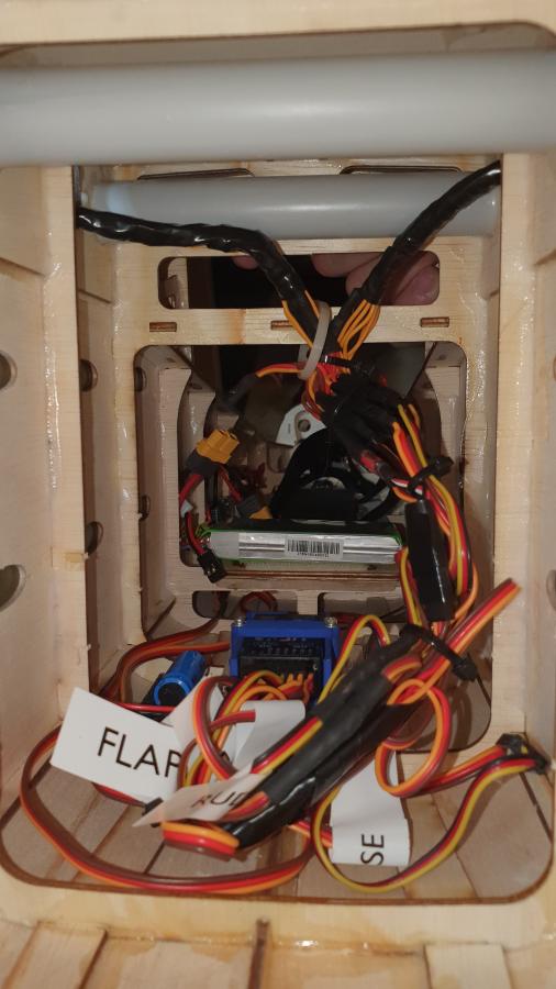

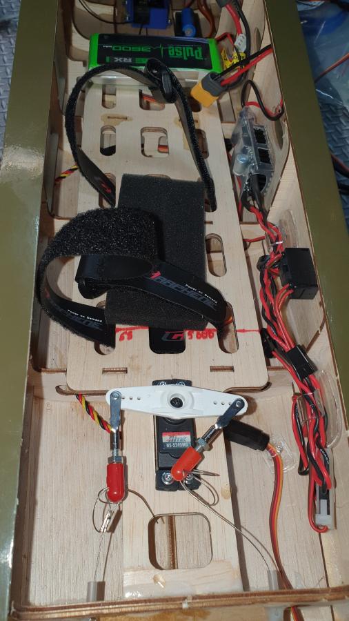

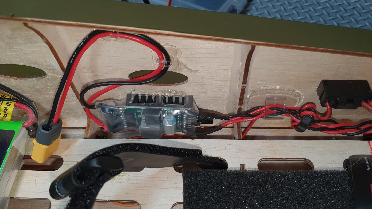

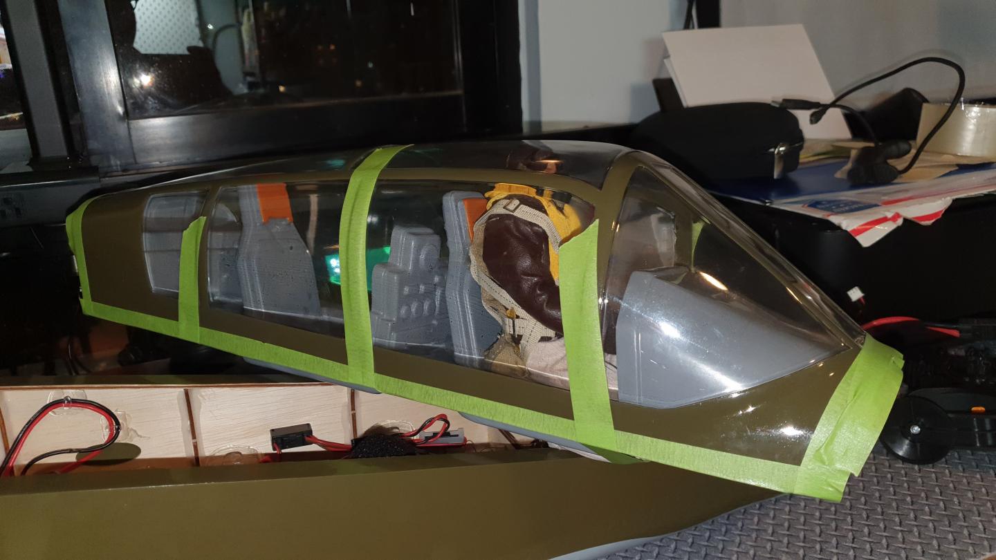

              I just resume the assembly, now the electronic part is in position and tested.
              • wrangler1
                • Feb 2019
                • 116
                • Dominican Republic
                #687

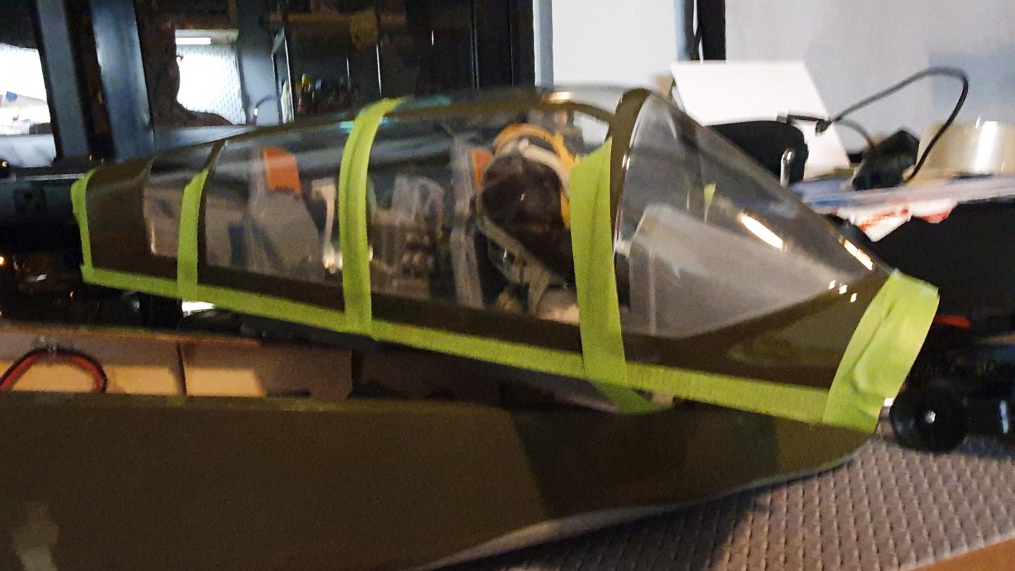

                Now cockpit turn.
                • wrangler1
                  • Feb 2019
                  • 116
                  #688

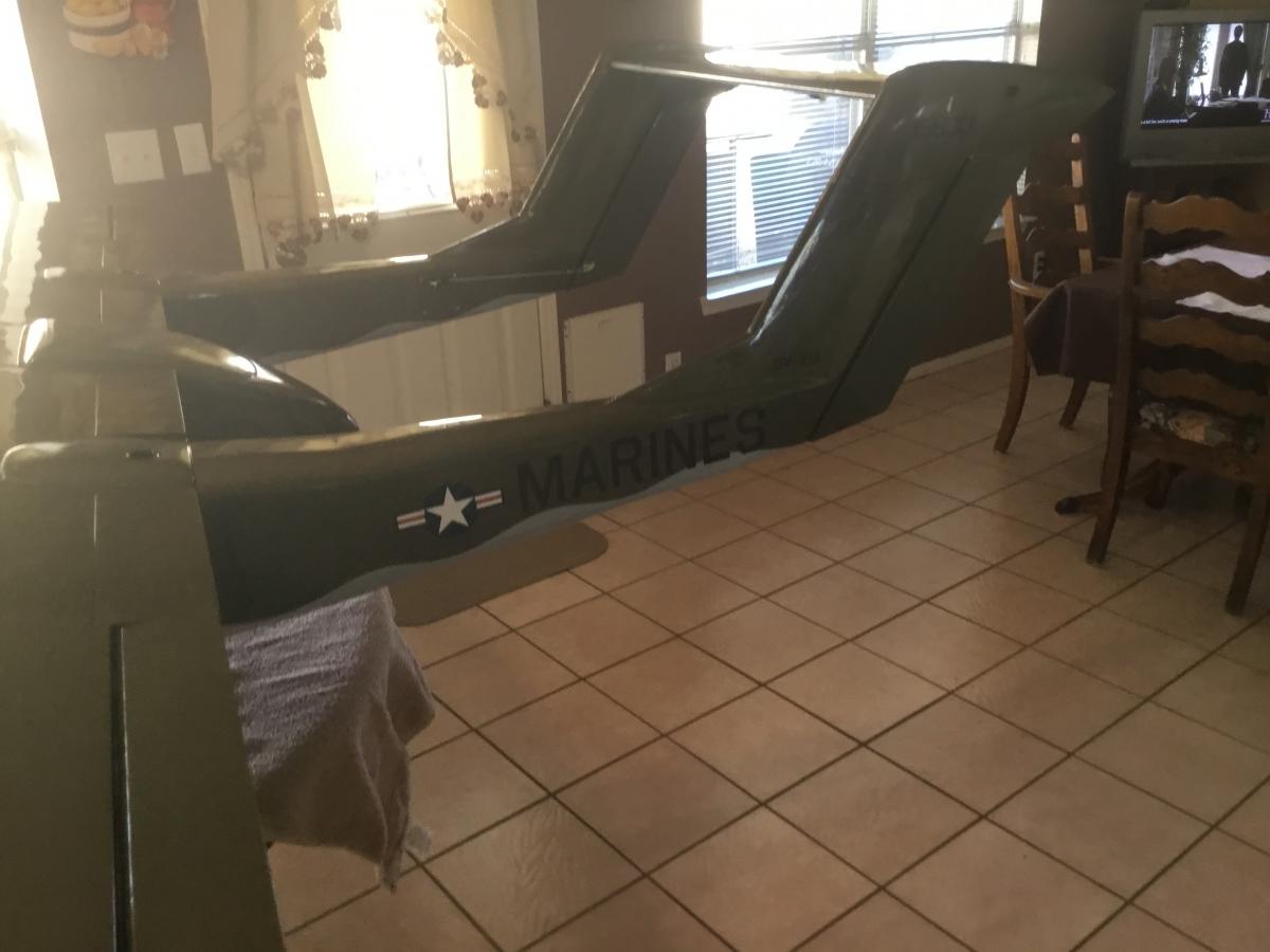

                  Decals on.
                  • wrangler1
                    • Feb 2019
                    • 116

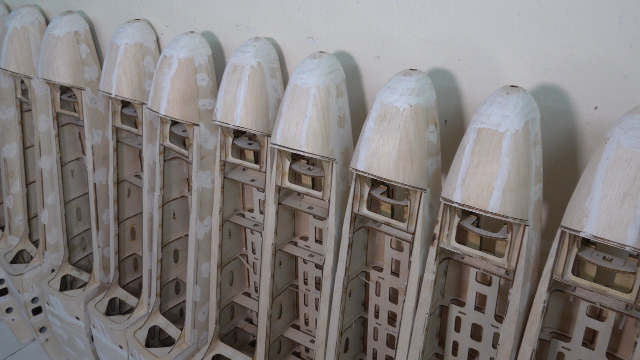

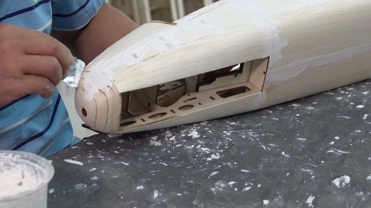

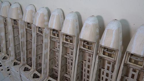

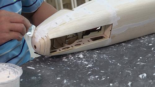

                        I recall a question earlier regarding the Bronco's nose. Here are a few pictures I took earlier this summer at the factory. Perhaps it will be helpful for those planning to drill the nose to install a nose light. You can see the layers of balsa block that are then sanded to shape. Not seen is the jigs to pre-shape the layered pieces beforehand this final step of putty and sanding.
ID:	223896Click image for larger version

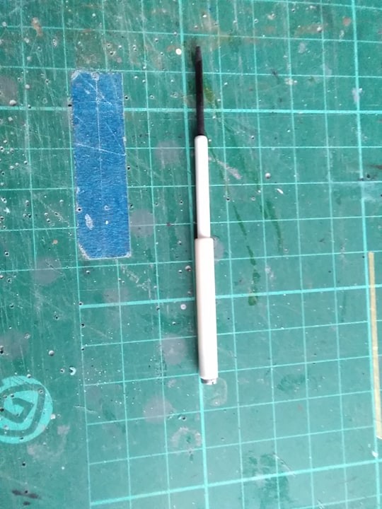

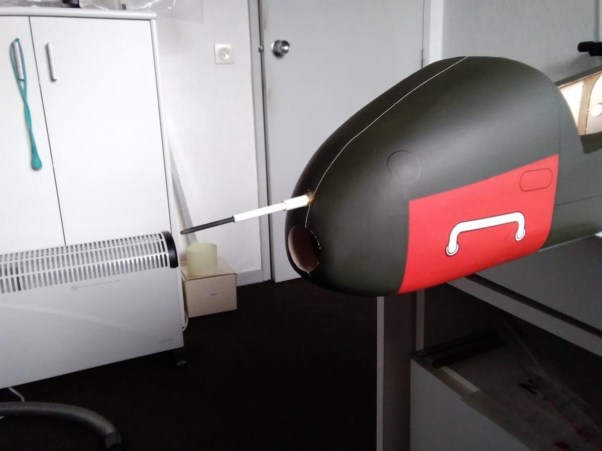

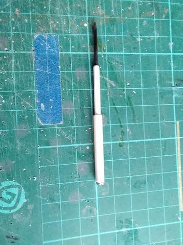

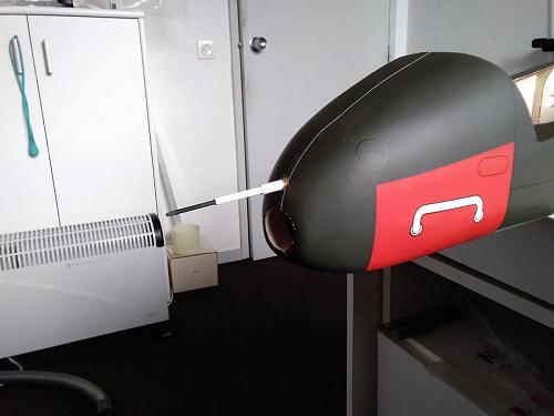

                            I started the build...
                            First i made the pitot tube, it's made of plasticard tubing and carbon rod, with a screw glued in the end..
                            A brass tube with a magnet glued in holds it in place.... this way it's easily removable for transportation..

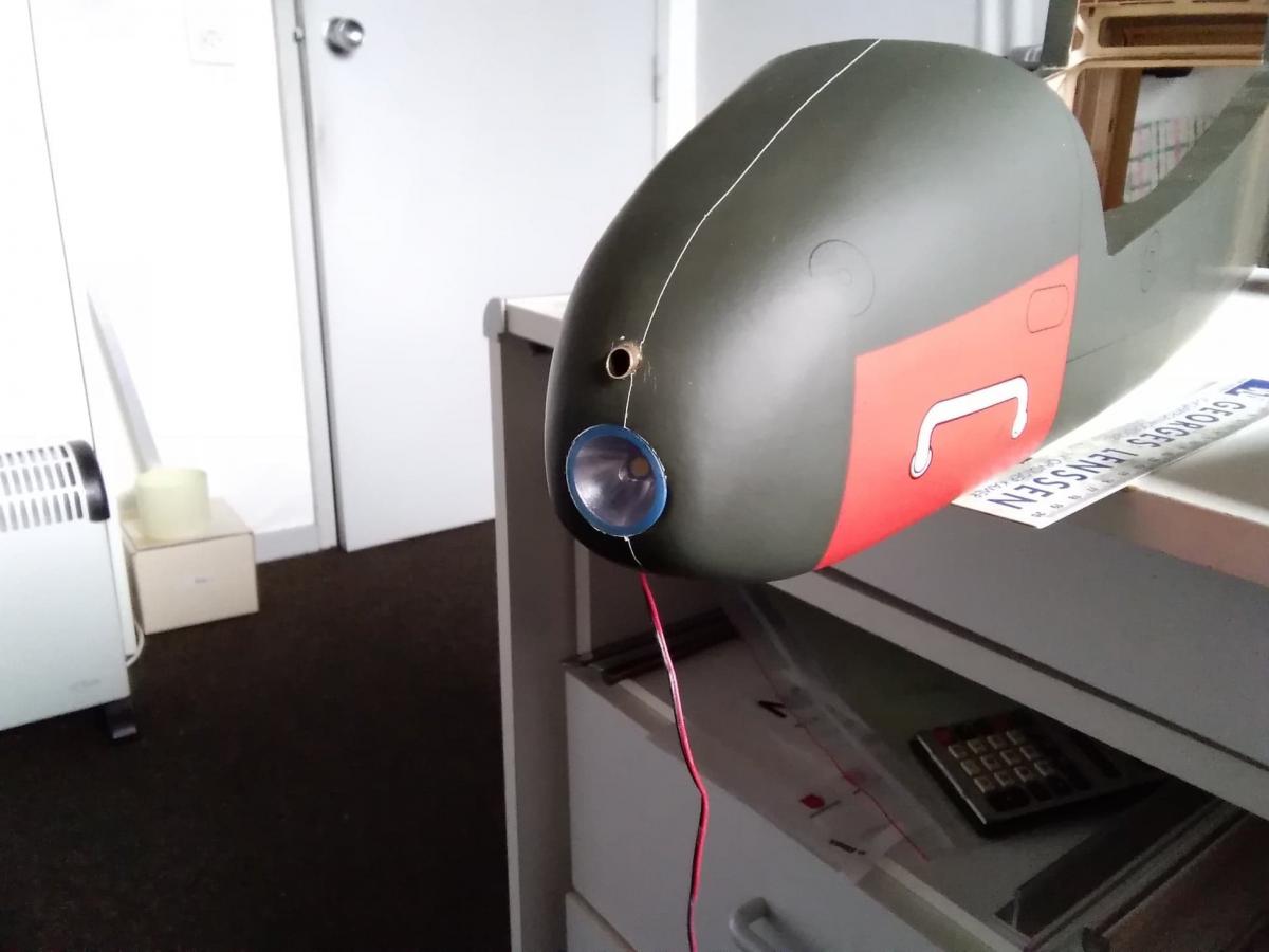

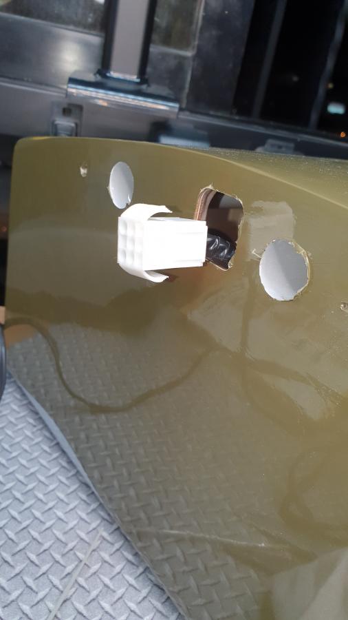

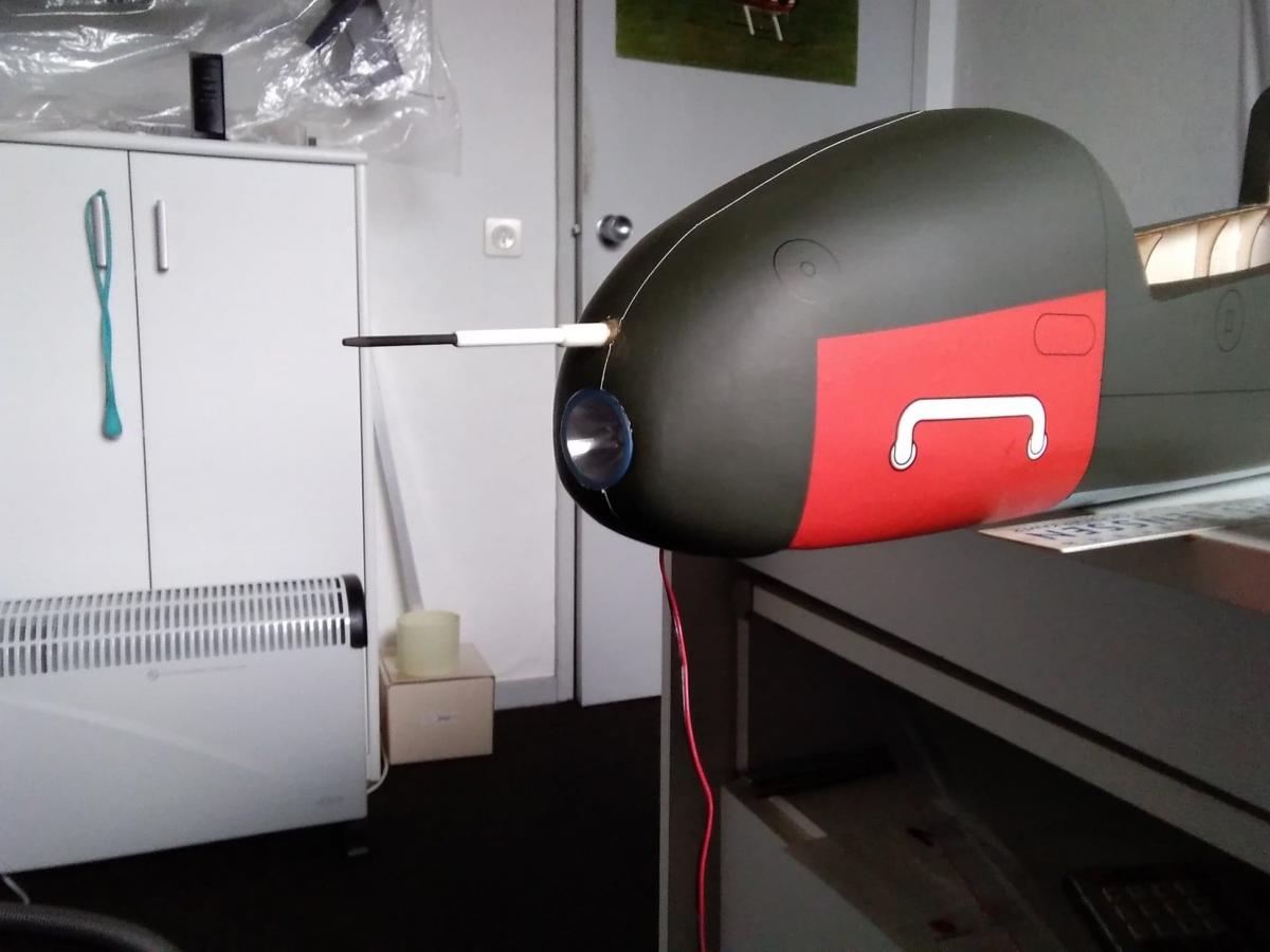

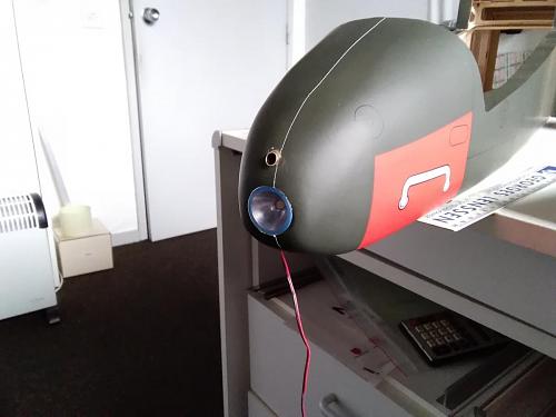

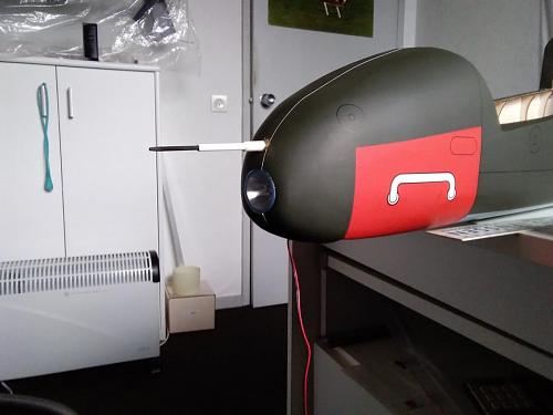

                            The hole for the nose light is already made...
                            The reflector is scavenged from a flashlight, the LED is from a freewing landing light i still had...
                            Everything will be glued in place at the end of the build, and painted accordingly....

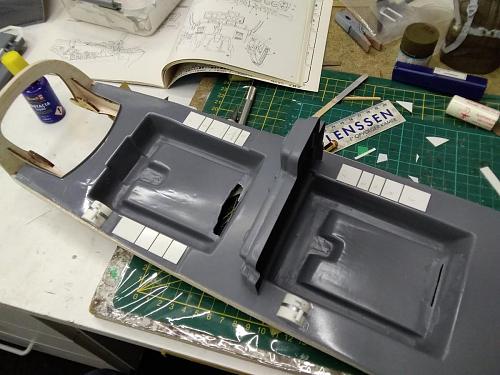

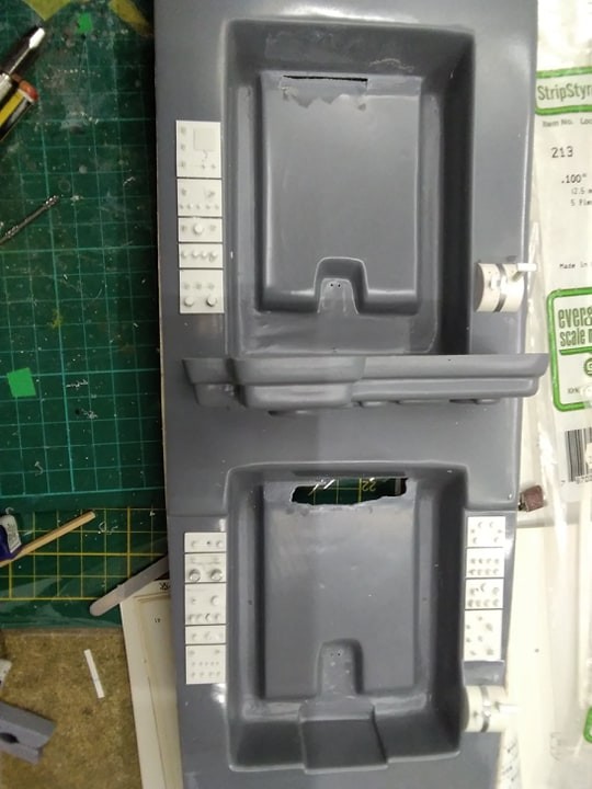

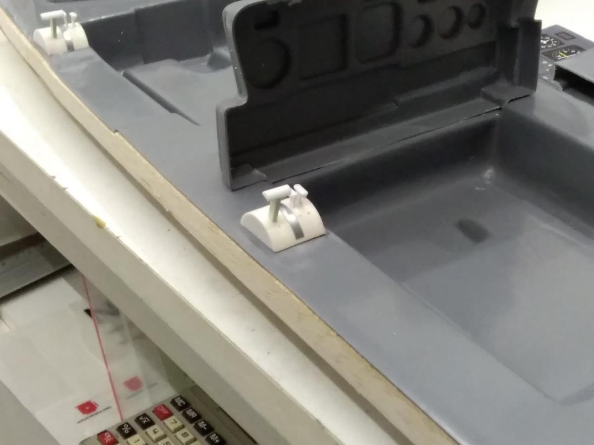

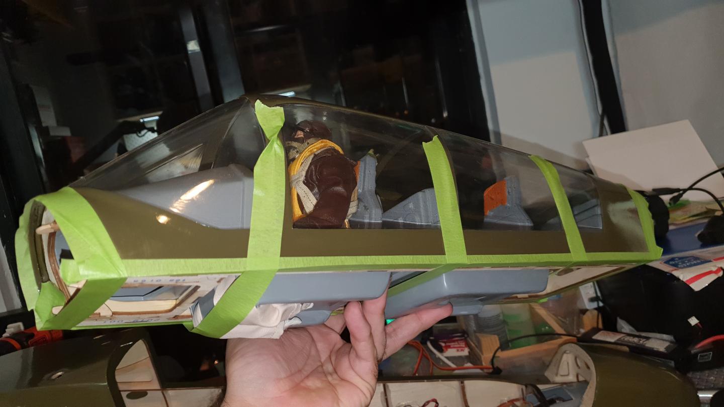

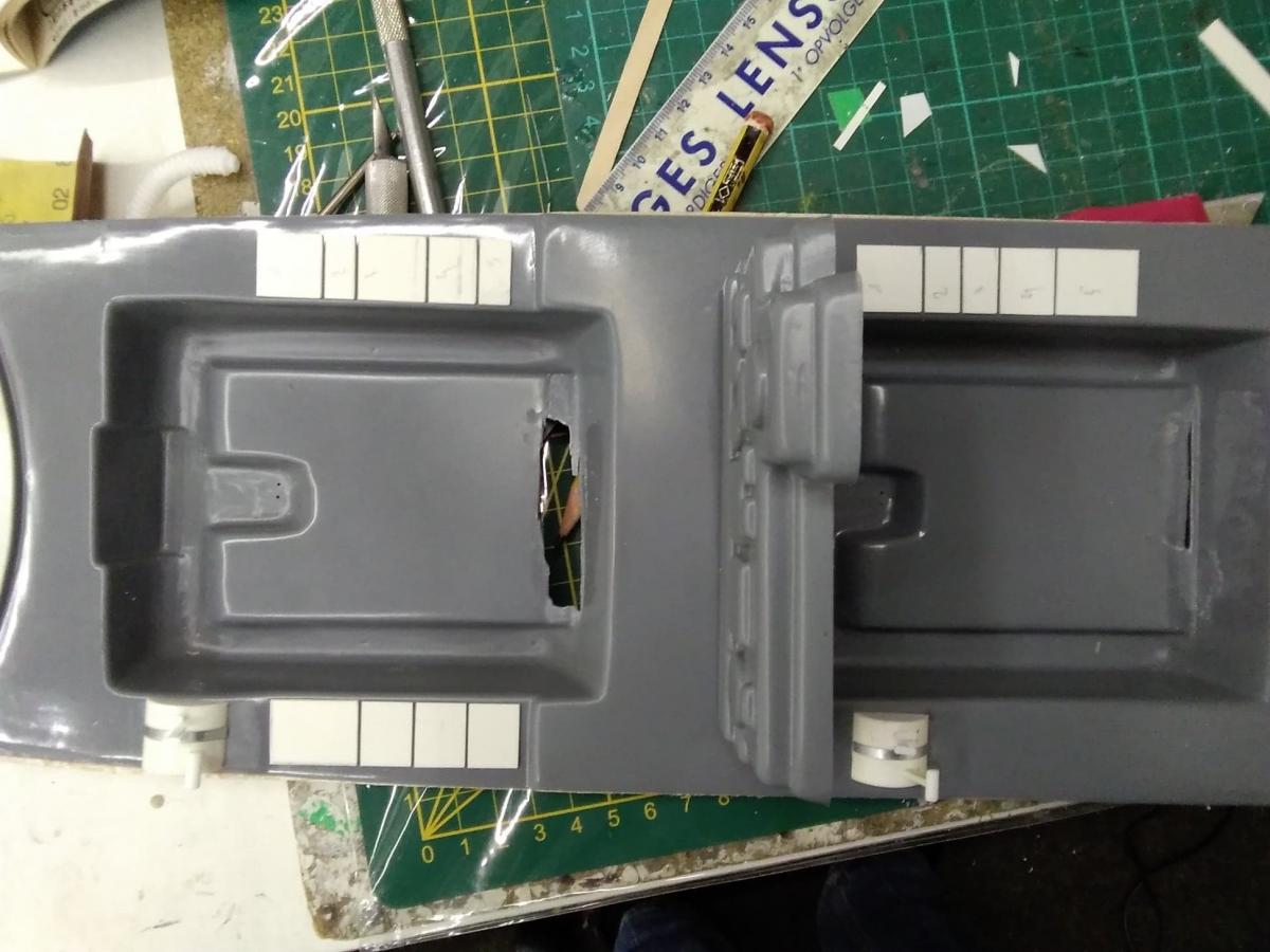

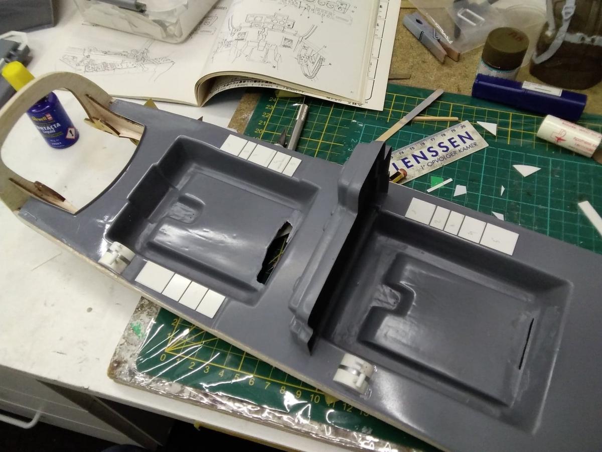

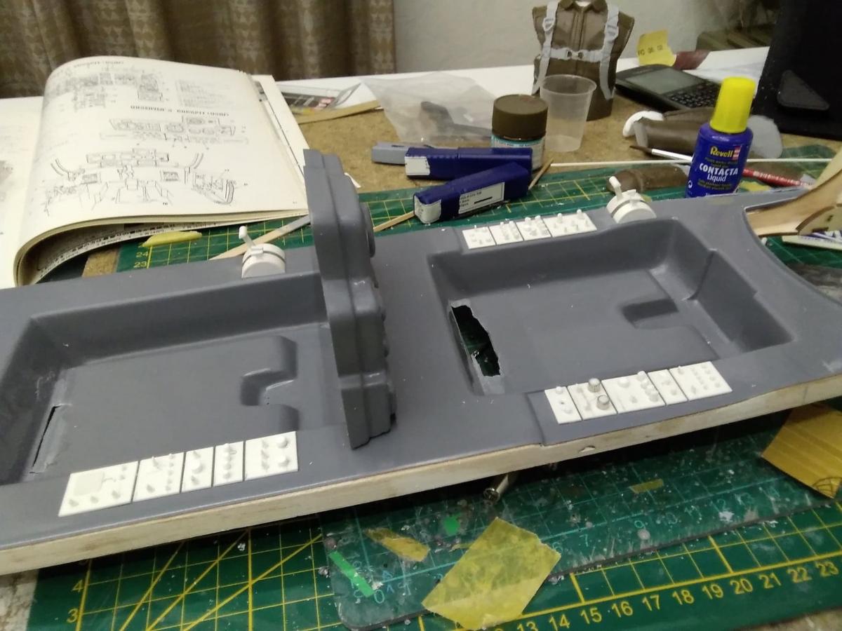

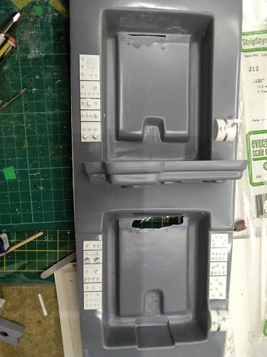

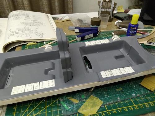

                                          I ve been working on the cockpit... Being very visible I couldn't resist to add some detail.. Instruments are made from plastcard strips and rods.. Time consuming but well worth the effort I hope..
                                          Click image for larger version  Name:	81486193_587807545332517_3045275677088546816_n.jpg Views:	0 Size:	129.6 KB ID:	226258
                                          Click image for larger version  Name:	81376403_584656032328630_7241363020524290048_n.jpg Views:	0 Size:	117.4 KB ID:	226257
                                          Click image for larger version  Name:	81222246_2975155162545458_371245462553886720_n.jpg Views:	0 Size:	68.6 KB ID:	226254
                                          Still a lot to do...
                                          Grtz,
                                          Didier
