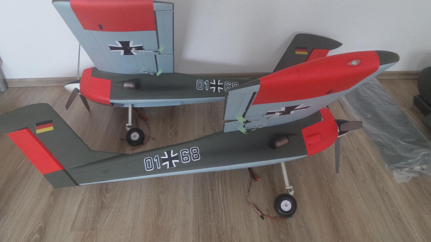

          And now I am ready. Click image for larger version
          cheers
          Markus
          • MikeT
            Here......Hold my beer.
            • 1060
            #505
            Nice.
            Mike
              cheers
              Markus
              Very nice !!!. By the way i see that you put lights on it, where did you find those and type ?. i have a few day looking for some light kits that looks fine with the airplane scale.
              Thanks.

                    Hi, thank you for the praise. The lamps set (3W) with electronics I bought at this shop all together have only 100, - € cost. Maiden was a year ago flying fantastic. Best Regards Markus
                    LED Sets für Flugzeuge - www.LEDPROFISHOP.de
                    Pichler OV-10 Bronco Maiden - YouTube
                    Pichler OV-10 Bronco - YouTube

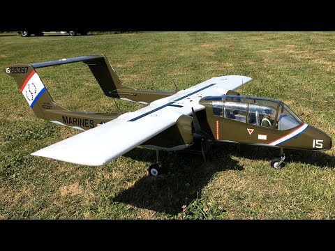

                                This is Robert's third flight!
                                • MikeT
                                  • 1060
                                  #516
                                  Looking like he's got a handle on it very smooth.
                                  Mike
                                    Yes Robert certainly has the flight routine down pat. Smooth. I love the color scheme and markings for this particular airframe but am curious as to the color of the top of the wing. Is it white or a light grey? Any clarification would be appreciated.
                                    • TLAR
                                      • Jul 2019
                                      • 4
                                      #518
                                      Caddguy6, the wing is white on top and bottom. IRL this makes it easy for the attack aircrafts to spot the Bronco working down low among the trees. Thanks GBLynden again for recording my flight despite the challenging light conditions.
                                      • sam51401
                                        • 368
                                        • Sellersburg IN
                                        #519
                                        VMO2 i think had several different schemes covering the 76' Bicentennial but i do have the T.O manual that gives the wing top as white and bottom as gray. This also has all the stenciling wiht locations, sizes and all. The neat thing about this scheme is that its all listed as gloss which means not much if any work is needed to dull the shine. I have the same Callie graphics to add to mine and also using cut vinyl to accent some panels and such. Yours is top notch TLAR and enjoy your videos thanks to GBLynden for filming. Keep them coming as inspiration please.
