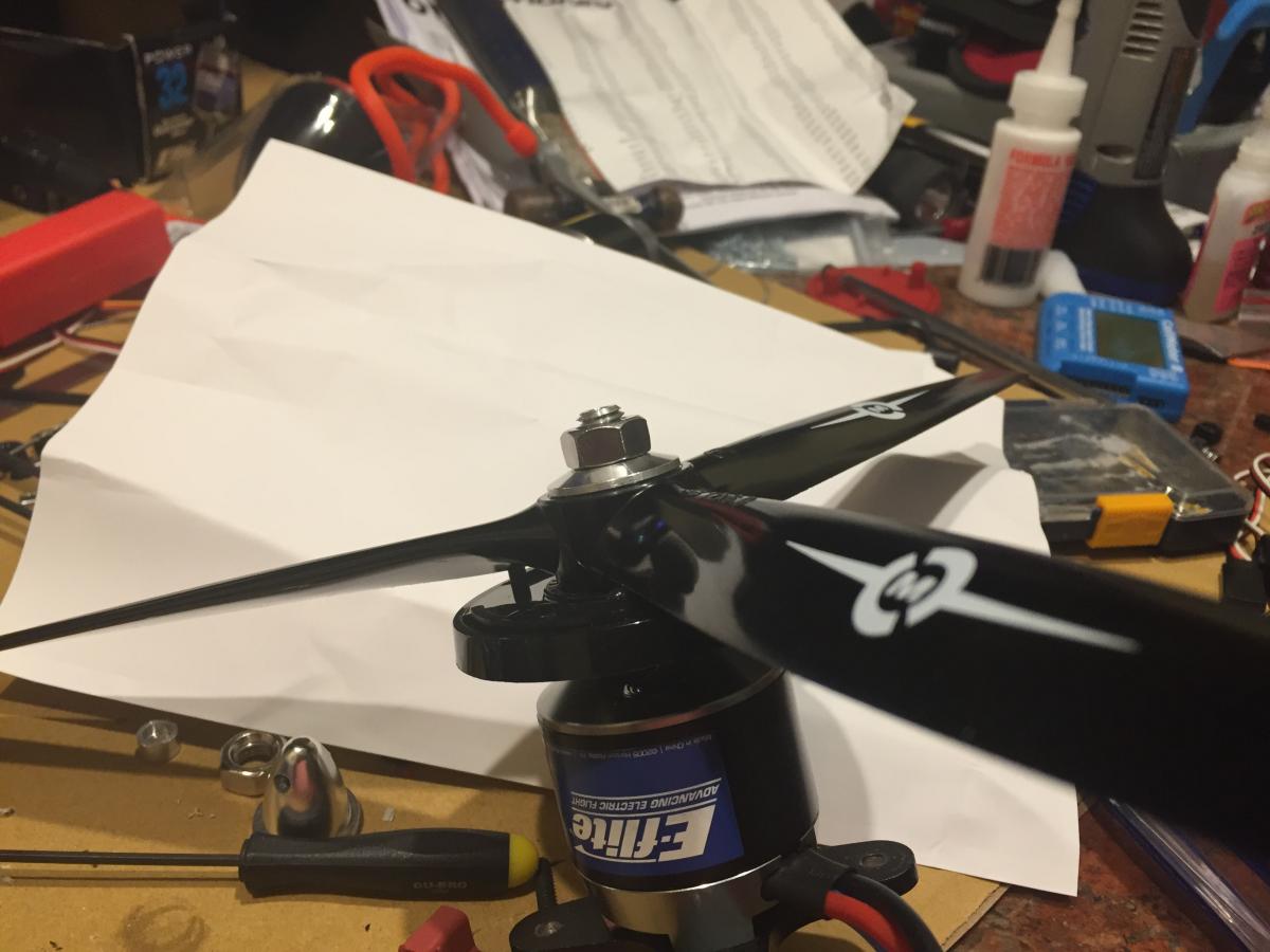

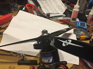

      Originally posted by Rosytime
      I wish I knew someone with a CNC lathe to make mine. I'll just wait for the Tru Turn adapters to arrive. Here's some pics of mine assembled. I just need to put the decals on, from Callie Graphics, and finish up some final assembly. I'm going to have to change out the retracts since for some reason they all wont retract or extend together. Don't know if it's a voltage issue or what but they are out of the A-10 and they worked fine there. I might have to run a separate lipo for them and possibly all the servos. Just waiting for an answer from Motion on when the retracts they have are coming in before I go ahead and purchase another brand. I can maiden it with the gear that I have now and just leave the gear down. I'll make that decision soon. I do have a set of electric Robarts in another plane and I do like them because of the positive lock up and down. I just don't like the price. The E-Flite set might be the answer. Attached are some pics. Take note of the spaghetti mess in the fuselage with both harnesses going into all the wyes into the receiver. I can't do too much about that for now. Lots of labeling on the wires. By the way I got those labels from Hobbyking and they are much nicer than using tape and a sharpie. Click image for larger version  Name:	OV 10 9.JPG Views:	0 Size:	107.4 KB ID:	206269Click image for larger version  Name:	OV 10 10.JPG Views:	0 Size:	115.3 KB ID:	206270Click image for larger version  Name:	OV 10 11.JPG Views:	0 Size:	113.7 KB ID:	206271Click image for larger version  Name:	OV 10 12.JPG Views:	0 Size:	120.0 KB ID:	206272
      On the issue that you mention about running with a separate battery...I decided to run the plane with 2 6S 5000 and the electronics with a LIFE Battery with a independent 15amp UBEC.

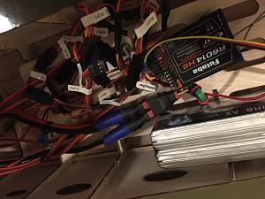

        I just got my receiver holder. I will be using the FRSKY S8R with telemetry and 3 axi stabilization. FRSKY 150 AMP Meter and a Frsky Voltage meter. The Amp meter will be on one battery line and the voltage on the other put together on lazy chain. That way i can have an idea of the status of each battery, also the rx battery meter will be by default thru the receiver sensor. so in my radio i will have 4 power related meters at the same time. (radio, rx, 2 batteries).

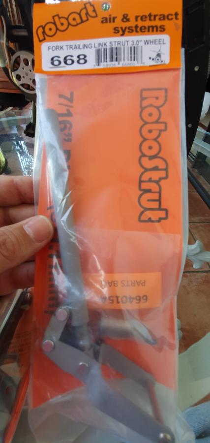

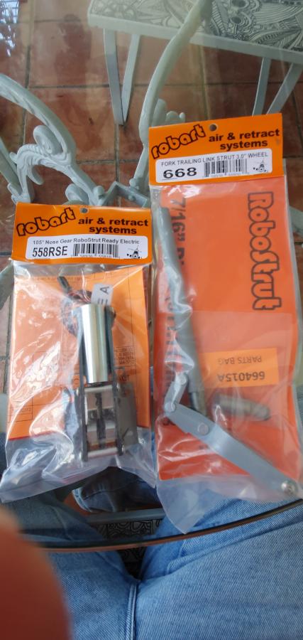

                        I just got my Robart parts: Nose gear retract and the 668 Strut. This thing is huge !!

                          Originally posted by wrangler1
                          I just got my Robart parts: Nose gear retract and the 668 Strut. This thing us huge !!
                          Can the strut tube be shortened?

                            #413
                            Kangi... yes. I have the same items going in mine.

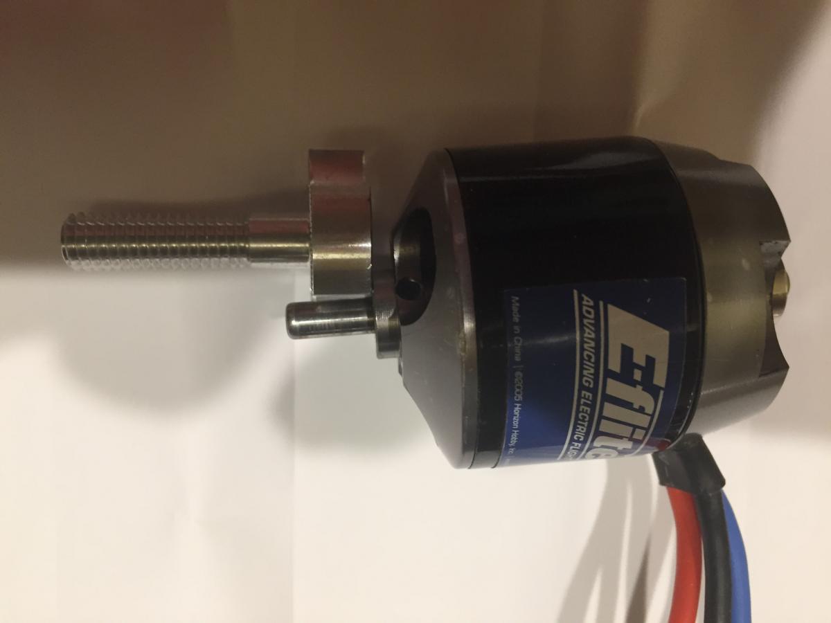

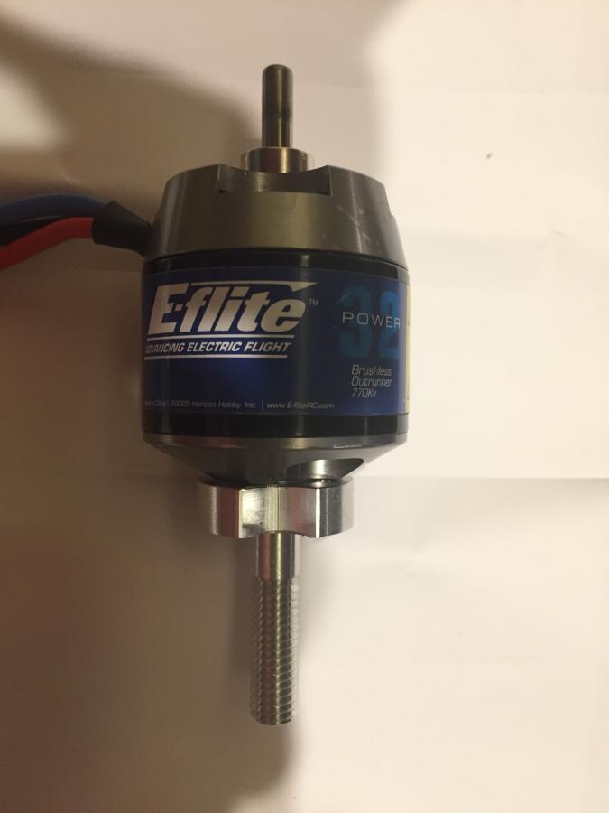

                                        Here's a pic of the Tru Turn prop adapter that I got for my Power 32s. As you can see, the shaft is much longer and plenty of thread for the spinner backplate and the prop. The other pic shows the motor with the adapter and the adapter on the motor. Notice how you have to move the motor shaft towards the rear for the adapter to fit. Tru turn makes adapters for many motors and total cost was 56$. If you have an odd motor, I'm sure that they can figure it out for you. Click image for larger version
ID:	206840Click image for larger version
Name:	Tru turn2.JPG
ID:	206841Click image for larger version
Name:	Tru turn 3.JPG
