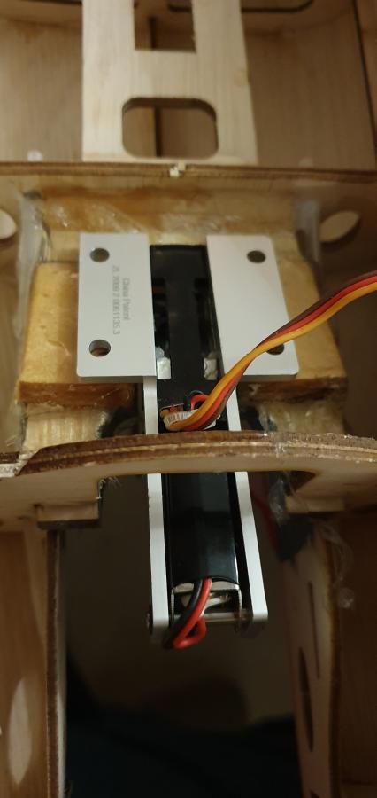

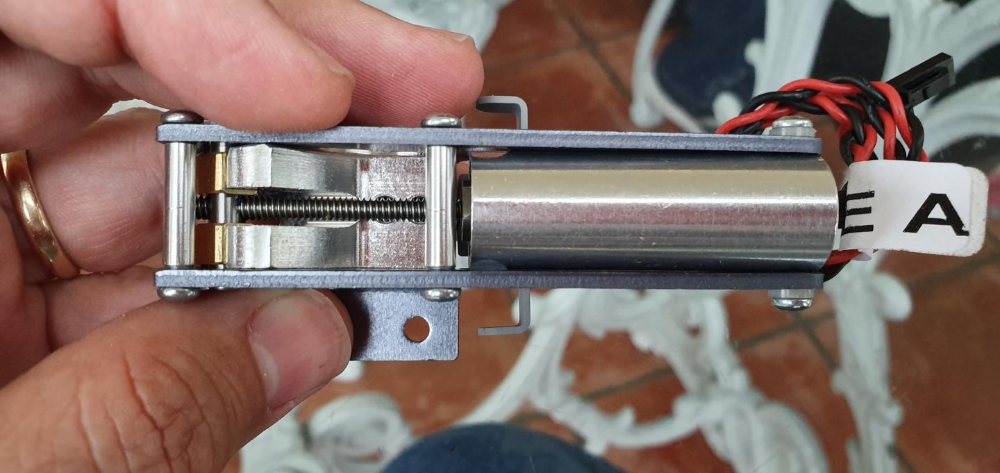

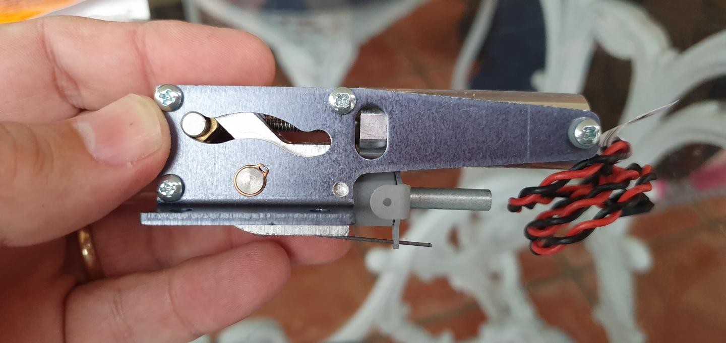

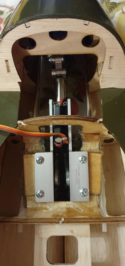

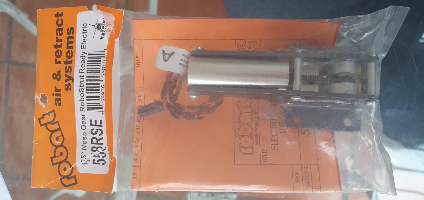

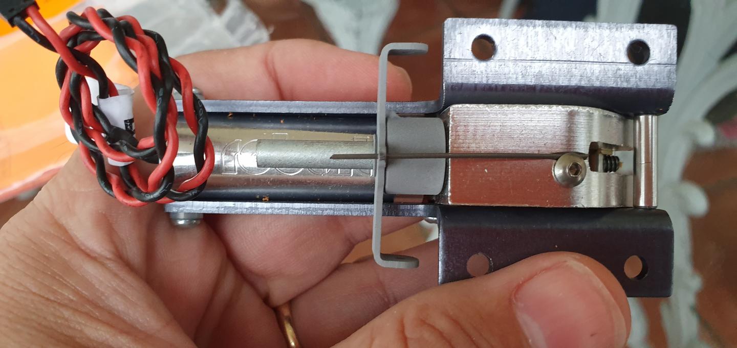

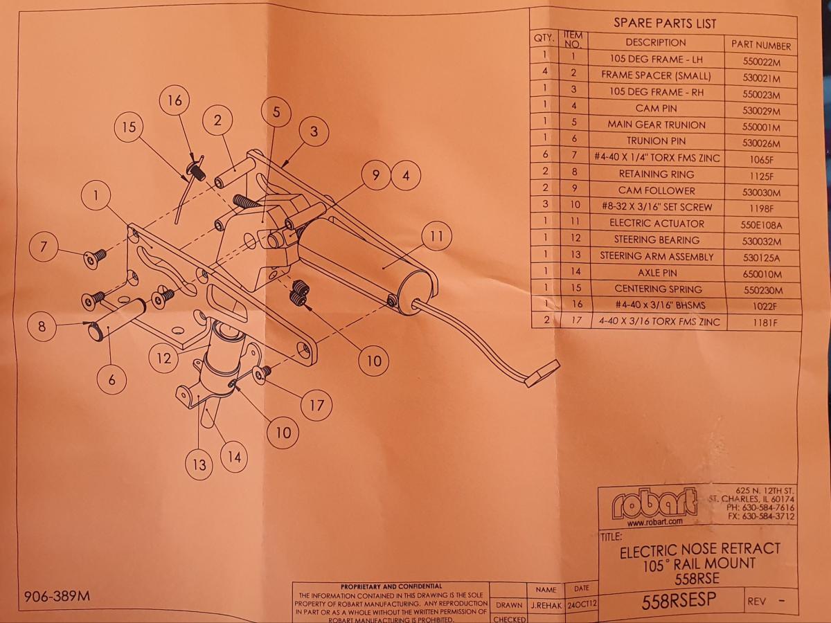

                    I’m most interested in what nose gear retract he used and what mounting modifications, if any, were needed. If any of you guys have installed the Robart 105 degree retract, I'd also like to know (see) how that worked out. Please?

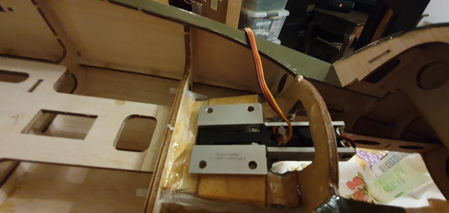

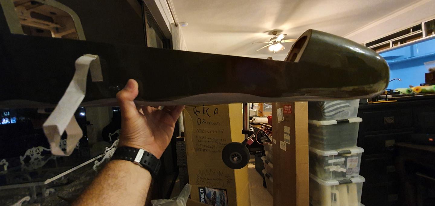

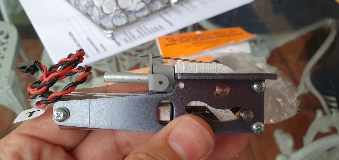

                    • wrangler1
                      • Feb 2019
                      • 116
                      • Dominican Republic
                      #450
                      Looking at the Robart 105 retract that i have here i assume that will have the same travel as the eflite that i installed on my plane. So looking at that, i assume anyone that will decide to use it will have to do the same work that i did on my Nose retract wood base.
                      Photos below

                          X Wave retracts are in stock. Just ordered mine.
                            Photos below
                            Yep. it looks like the Robart will require the angled shims as well. I just ordered the X Wave retract from Motion, so hopefully that solves the problem.

                                Welcome to the forum! Thanks for sharing your set-ups. You were able to install the nose retract without modifications to the mounting surface? No shims or change to mounting angle? Does the front wheel retract fully into the wheel well?
                                Rick
                                • TLAR
                                  • Jul 2019
                                  • 4
                                  #456
                                  No shims or changes to mounting angle required for the Eflite retracts. My nose wheel does stick out about 1/4 inch when retracted with the supplied wheel. However, the mains are fully retracted.
