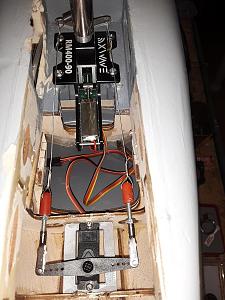

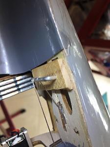

ID:	210223 Well I have two flights on mine now. On the maiden flight the first take-off attempt was aborted since it seemed that not enough elevator was available. I switched to high rates and it took off fine. A bunch of up trim was needed but once trimmed it flew great. I landed after 4 minutes and the front steering went whacky. Inspection showed that the cable broke. Bigger cable used for the next flight but it dug into the tubing and again went sideways. If you look at how the instructions tell you to run the pull-pull system, you will see the problem. My solution was to move the u-shaped metal rod towards the front of the tube exit and wrap it around back towards the steering arm. This should solve that problem. The wire will eventually cut into the plastic tube with the original routing. I also found that my power set-up is okay but not to my liking. I had to fly at 3/4 throttle to feel comfortable. I'm using E-Flite power 32s on 4s with a MAS 10-7 3 blade prop. I could go to a 5s set-up but will try an 11-7 3 blade next to see if that helps. E-Cal show that set-up will give about 1400 watts compared to the 994 watts the current set-up shows. Going to try a 2 bladed 12-8 for now.

        Somehow the pics didn't up load. Here they are. Click image for larger version

              After trying the original directions, and not liking the results, here is my answer to the nose gear setup..... then add doors or custom fit the plastic insert....... Click image for larger version  Name:	20190814_132638.jpg Views:	45 Size:	92.5 KB ID:	210250

                  That's an approach I hadn't thought of. Me like.

                    This would certainly reduce/remove stress on the cable and tubing. nice solution.

                      I was going to use a servo in the front but it didn't look like there was enough room with the wheel coming up. Might have to rethink it if this set-up gives me trouble.

                        That's pretty much the SOP for most nose wheel pull-pull steering set ups. Straight forward and it works.

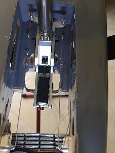

                              wow rosytime that looks like a lot of dead weight in there? how much did you need. thx

                                I wound up putting almost 6 oz of weight in the front of the plane. . I might try and put it in the forward part of the nose to see if I can take some dead weight out. What you see in the pic is 4 oz of steel weights. They're bigger than lead weights for the weight but it's what I had on hand. If I go to a servo in the nose as another flier has, I can reduce the amount of dead weight needed. And yes, I was surprised how much was needed but this is a heavy plane all around.
