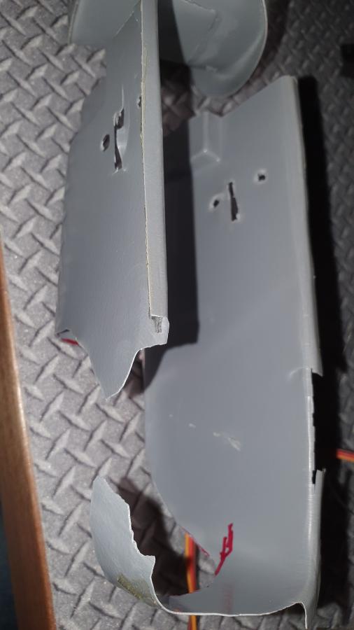

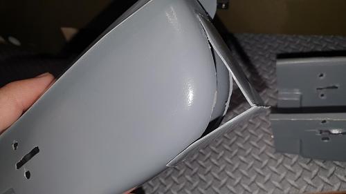

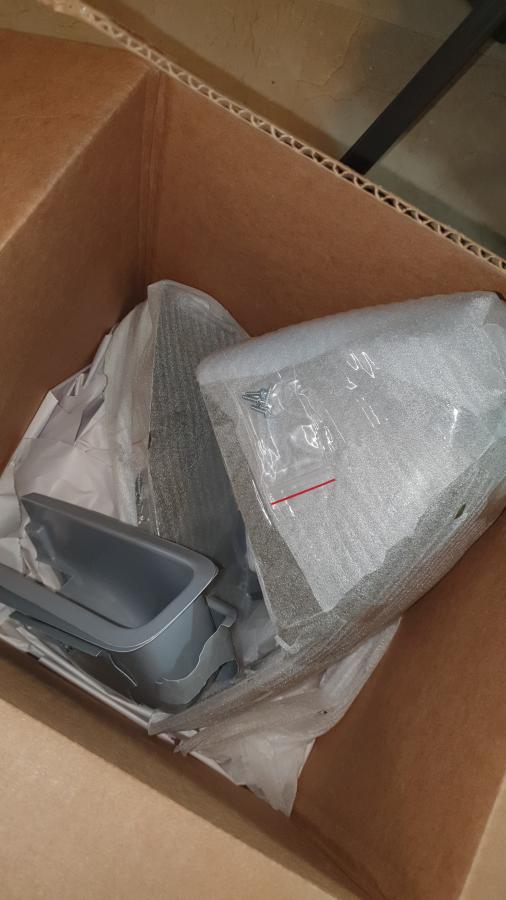

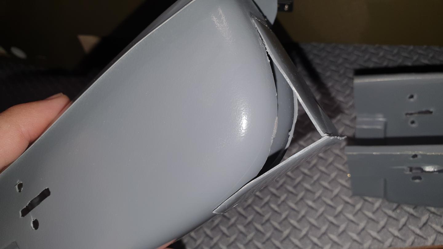

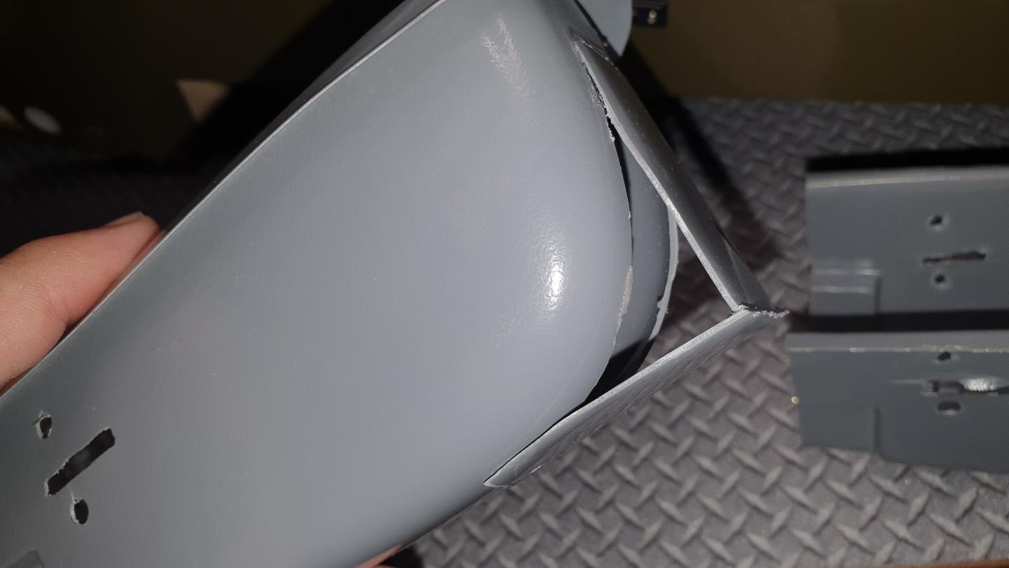

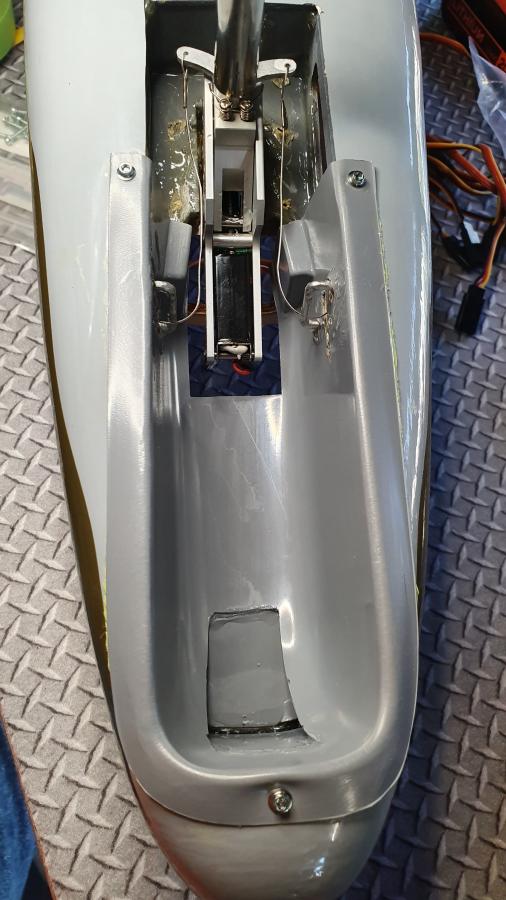

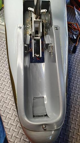

            • Hello to all, i resume the building of the plane and at the moment i just install the nose gear cover. I needed to order a new cover since i broke the one that came with the plane.
              On the power setup, i plan to fly it on 6S 5000 . Click image for larger version

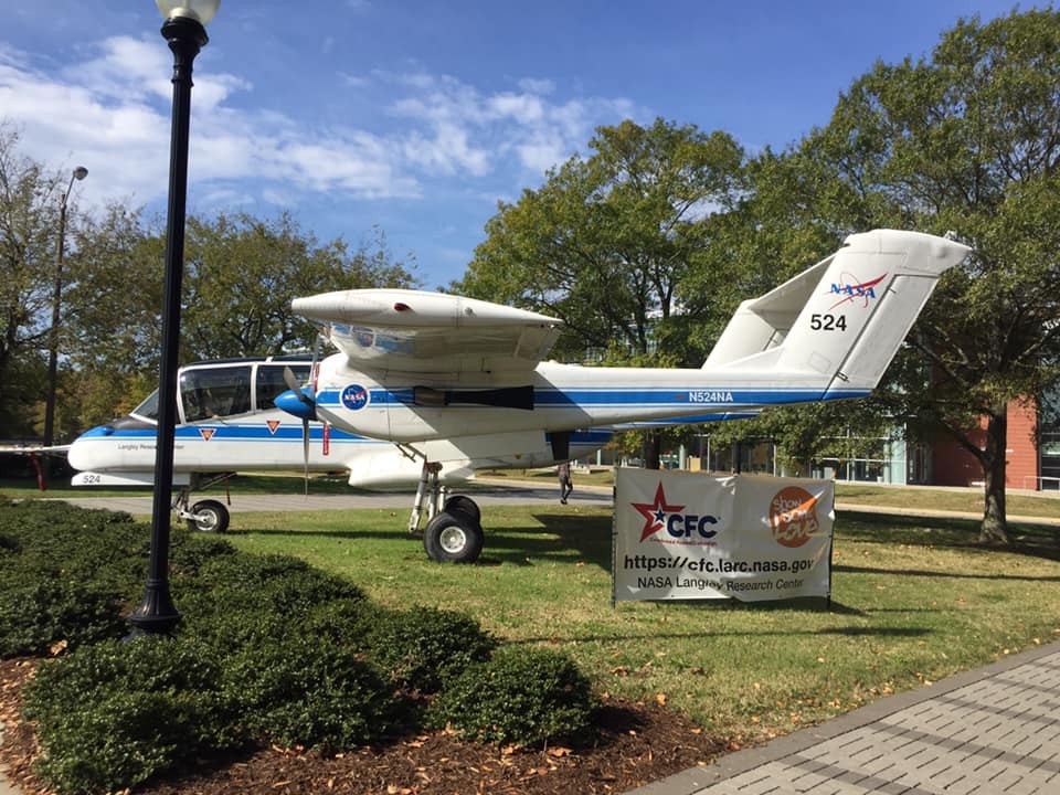

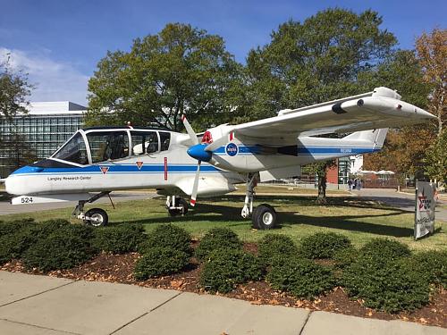

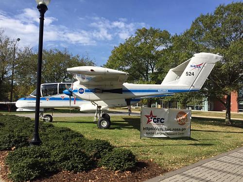

                • Outstanding find Mike..........in all the years of perusing the WWW I have never come across the NASA Bronco
                    Apparently there were 2 both now retired from I understand.
                    Mike

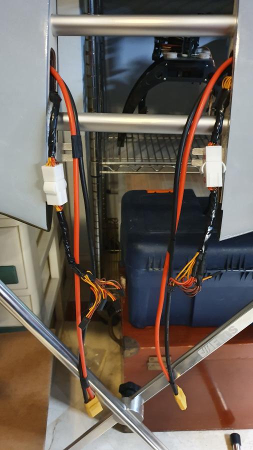

                          In my case i will do 2 options, a " y " extension to be used with one 6s 6500, and in case i decide to use two 6s 5000mah i will connect them directly to the ESC'S.

                              Is used in case you decide to use the ESC integrated BEC. So the receiver is connected to only one power supply. Is a common practice, but in my case due to the aircraft size and the time that i'm spending on it i choose to go with a separate power supply. A 2,500mah 3 cell Life attached to a 20amp Bec (was the one i have available). So in case something happens with the motor batteries i still have control.

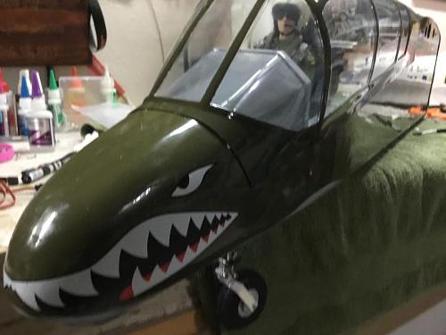

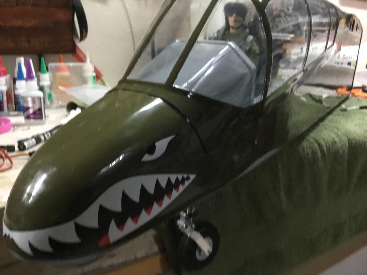

                              • Used some of Callie's graphics but decided to go with Motions A-10 Shark Teeth. The water slide with setting solution is a bit easier to work with.

                                • Fits it pretty well i say! Nice.
                                  • Originally posted by sam51401 View Post
                                    Just a tad larger than I would have liked but I don't think anyone will notice or even care.
                                    Mike

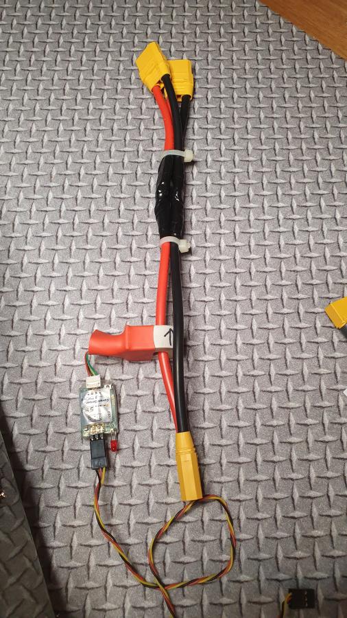

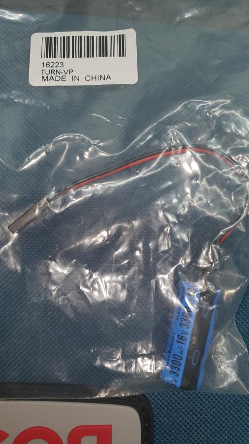

                                        Unless you have the capability to handle 2 receivers at the same time that are synchronized together, i never done that. So i can't help you there. Although it will be interesting to see how that works and what measures (if you think on those) will you take if something happens to one of the Esc internal Becs that affect the Receiver. Also i will suggest to add a capacitor to the receiver so when the engine starts (if it is electric) the amp draw does not affect the rx. i will post a photo of the one i'm using.
