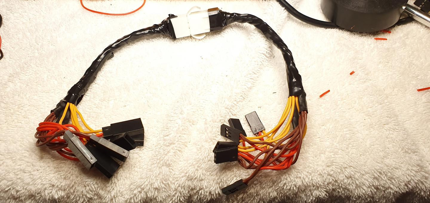

    Doesn't look pretty Yet, but it works very good !!!!

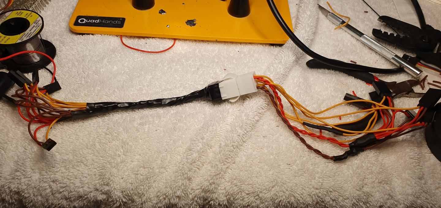

            Not Yet, at the moment i was making my multiple servo connector.

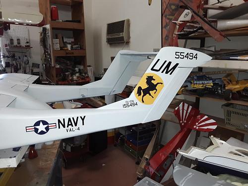

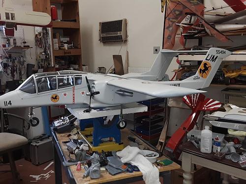

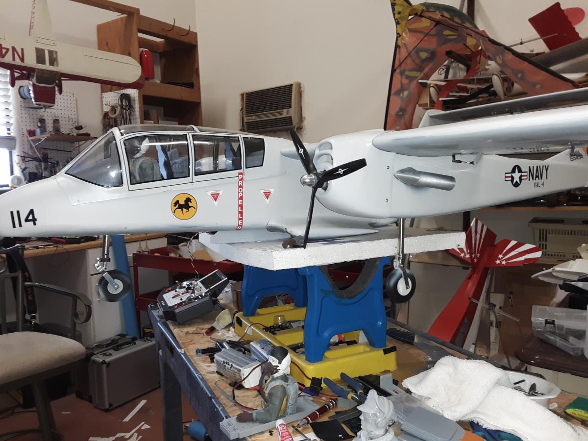

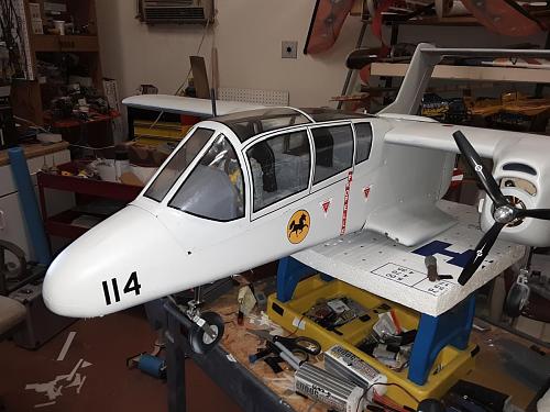

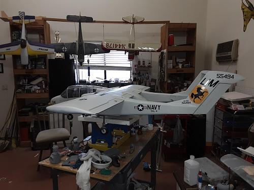

                      #590

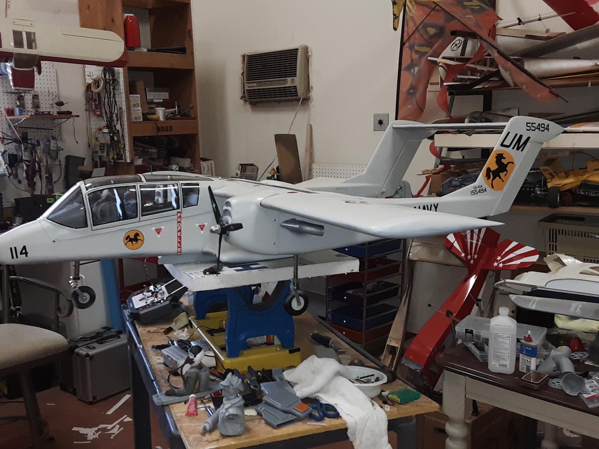

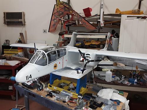

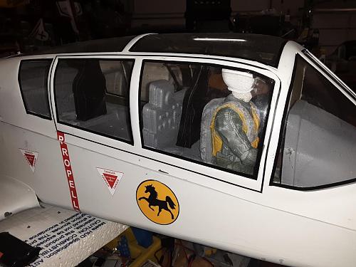

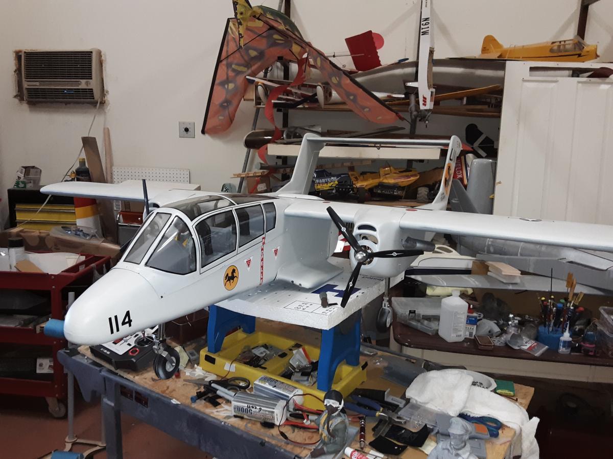

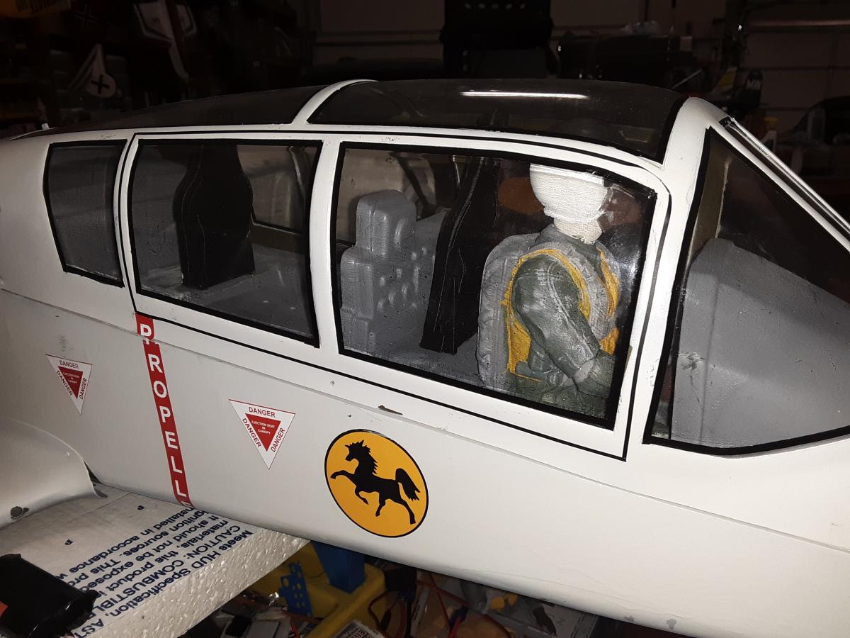

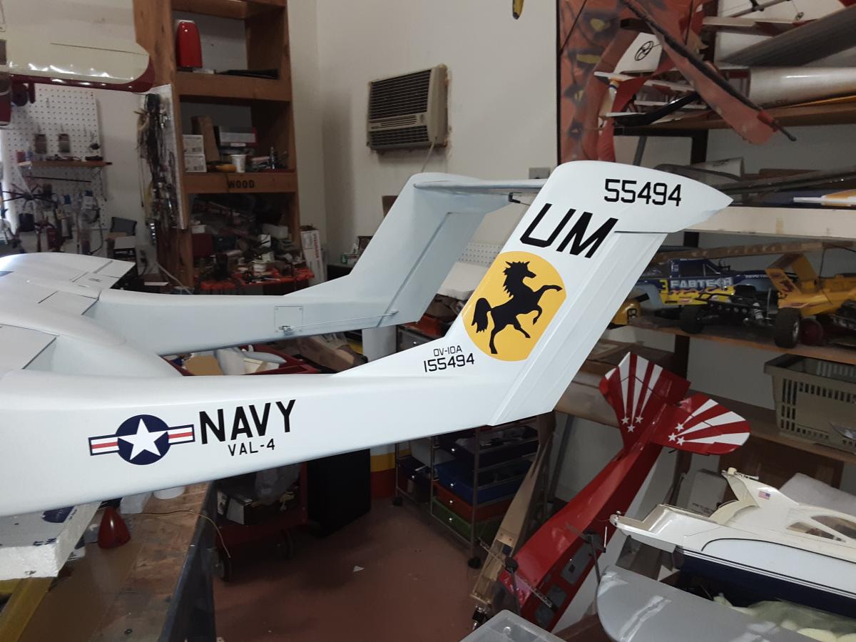

                      I decided to change my factory livery to the Black Ponies of Val 4, Vietnam period. I got the idea off a Squadron Publications Cover. Callie did the graphics package, great job. The plane has 2 Rimfire .60's, with 100 amp esc's. The motors are good to 62 amps constant draw. I probably will use counter rotating 12 x 8, 2 blades. and 13 x8 3 blade props if draw is under the 62 amp level. Power comes from 2 x 6 cell 5000 ma lipo packs Click image for larger version
ID:	215643Click image for larger version
ID:	215644Click image for larger version
ID:	215645Click image for larger version
ID:	215646Click image for larger version
ID:	215647Click image for larger version
ID:	215648Click image for larger version
ID:	215649 , and a 2s lipo battery pack for radio, and servos. I have saved at least 2 planes by having a power pack,separate from the esc power circuit. Personal preference...... Have not balanced the plane yet, but that is next. It has been a fun project.. We need to build a fire under everyone that bought this plane, and have them share there experiences with the gang.

                        #591
                        Hi Folks,
                        this is my first post in this forum and it's awesome to get such much information!! Thank you very much in advance.
                        Regarding the latter post, the OV-10 with No.114 must be "Gandalf the grey", if I'm not mistaken...
                        Greetings from Germany,
                        Axel
                        • Axelowski
                          X-O
                          • Oct 2019
                          • 10
                          • Wuerzburg, Germany
                          #592
                          Sorry, I was mistaken, "Gandalf the Gray Wizard" was No.107

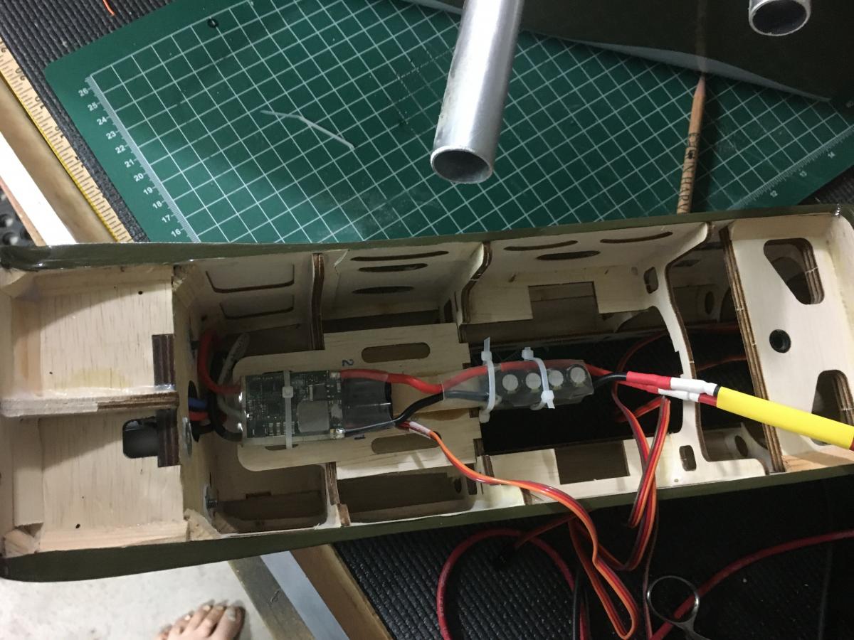

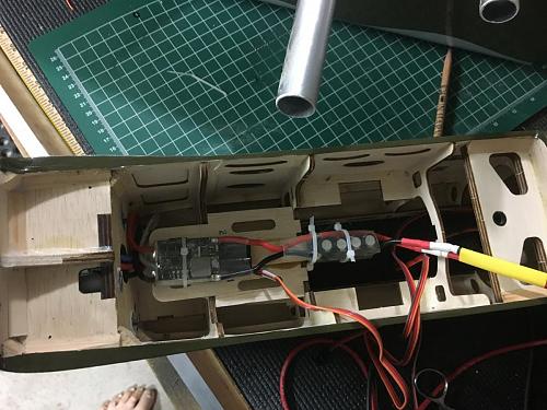

                                        #599

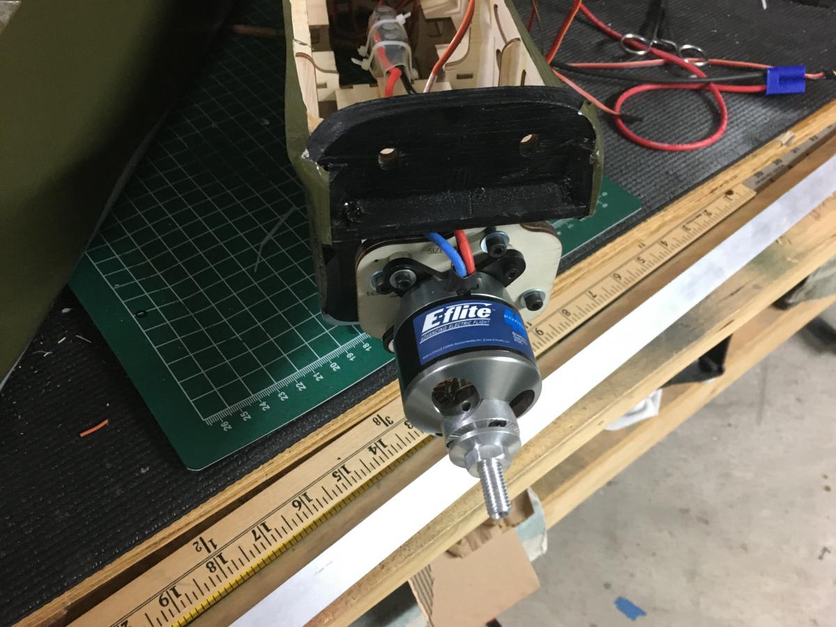

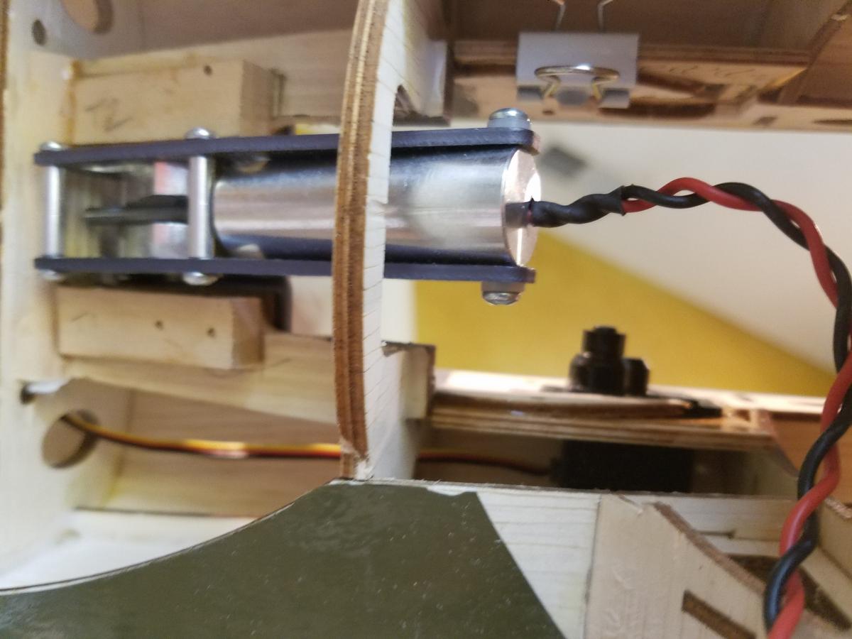

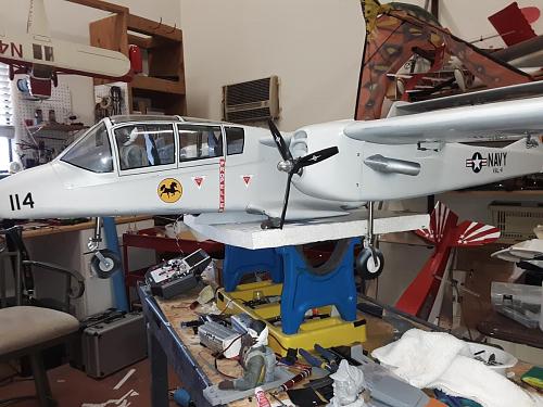

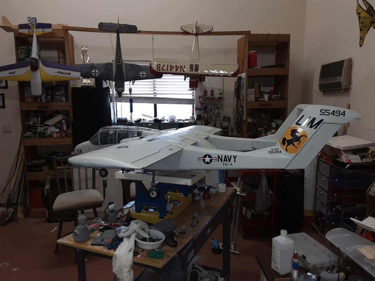

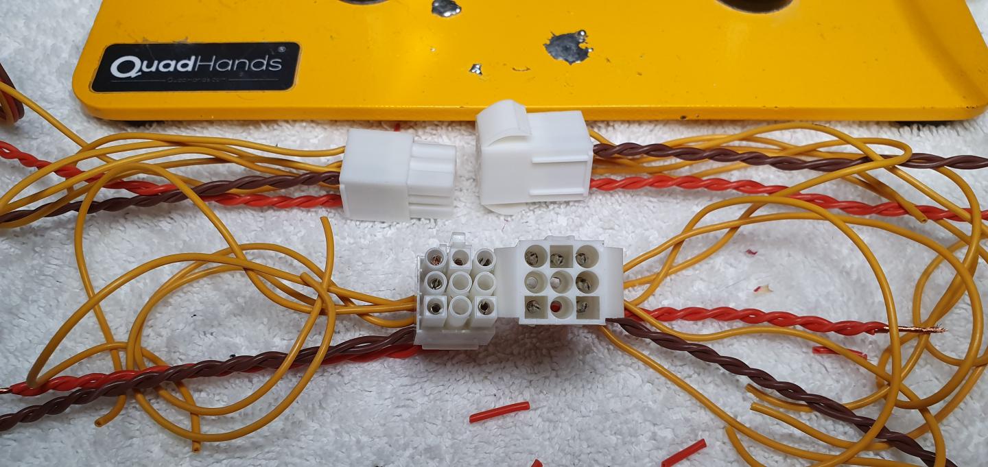

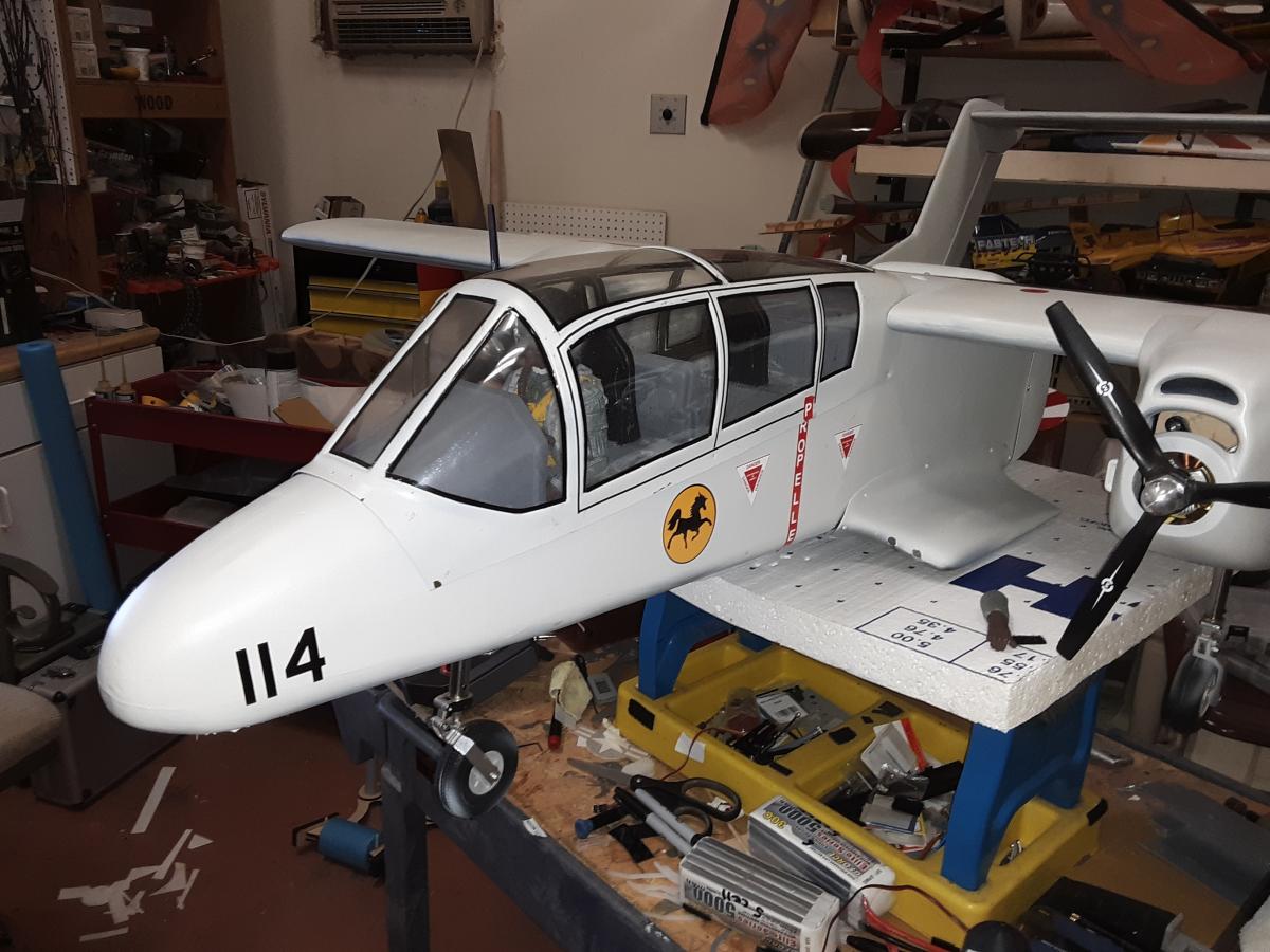

                                        Spent the last couple of days working on my OV-10. Got all the flying surfaces and servos mounted. he Power 46's are in and the ESC's and Caps mounted. I'll get the retracts in this week than figure out the hose wheel steering.
                                        Mike Click image for larger version
