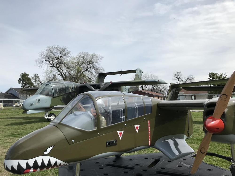

  • sam51401
    Well i must say it is well built to start with. I lost the the one in the pics above due to my absent mindless on the radio battery LiFe going too low and it went in just as i was turning to final to land. Lesson learned. The second has had its maiden and im finishing out the details and graphics currently. The power system is listed in this thread and also in a thread on RCG. I went overboard on the retracts but i think they look the best for stock hardware.
    I want to give a shout out to MRC support here as in the second one, i think one of the booms was build either on a Friday or Monday as when i landed on its maiden, the main gear mount broke as it was missing some triangle stock that is used to give the gear plate better support and additional load area was found missing. MRC sent another new boom in short order so im glad they still had stock available.
    I have made additional decals to add to the Callie Graphics and as seen i changed the scheme a little with only covering changed being the top of the wing. Be happy to give further details and pics for you if you like.
    Special note, i used MA 15x7-3bl on the first one and it was a little lacking so on #2, i went with 16x10-3bl and feel better. They are counter-rotating also.

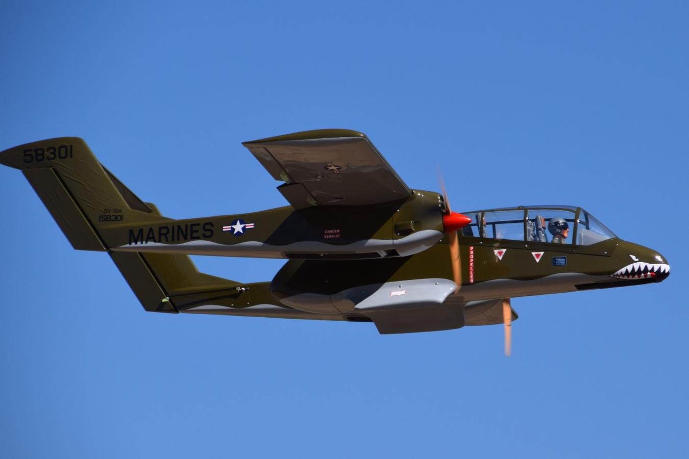

    Well its been way to long since i got this and now it has finally made it to the air. Successful maiden and another flight on the books.
    Short clip of maiden takeoff. https://youtube.com/shorts/Ph6TyPsO0pc?feature=share.

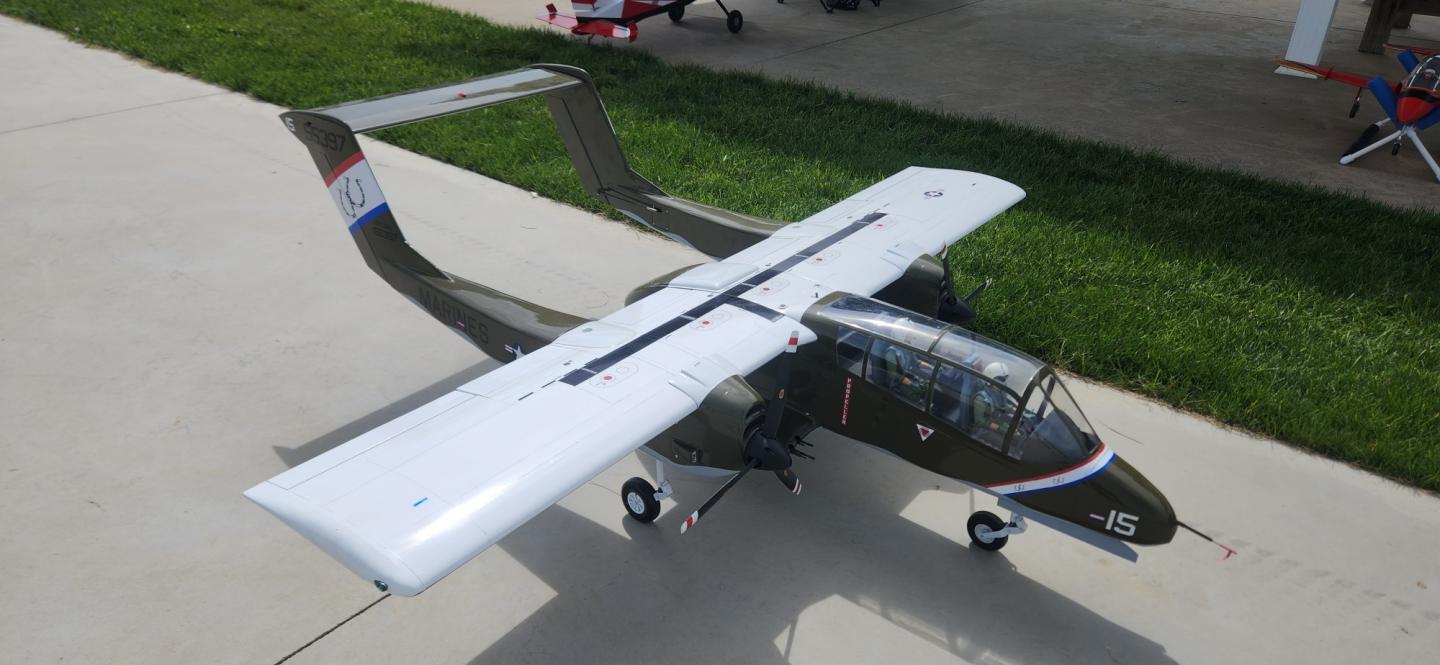

  • sam51401
    Well its been 5 yrs in the making and finally much closer to a maiden now. Been putting more than usual details on this but that white top just screamed for panel lines and nomenclature. More to come as i do some final touches and add a few more items.

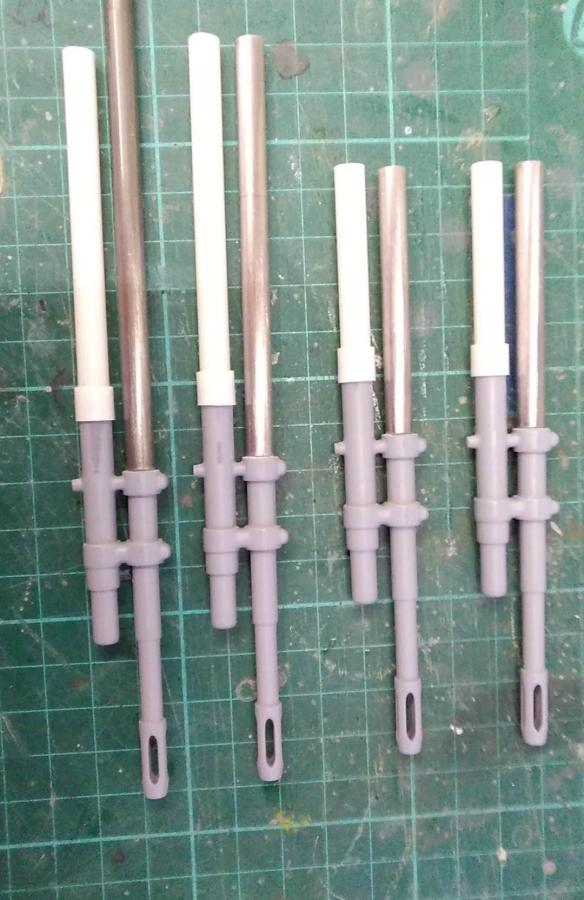

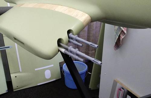

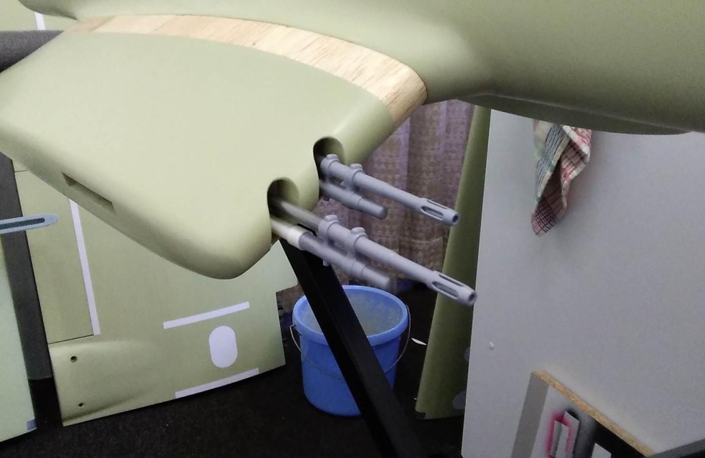

  • didier n
    Sam,

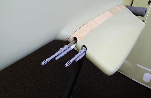

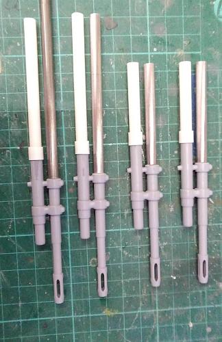

    Those are the Hangar 9 nacelles wich i modified to look scale, you can find the files for the guns in post #965, Tim made them... If you need someone to print them, you will have to search locally, and do it with a resin printer for best results
    Hope this helps,
    Didier
  • sam51401
    Where can i request a set of those awesome M60 prints for mine(Nexa)!!!! Didier, is that the Nexa or H9 nacelles?
  • Tim Anderson
    Didier
    thanks for posting, super pleased with your results! Glad to help

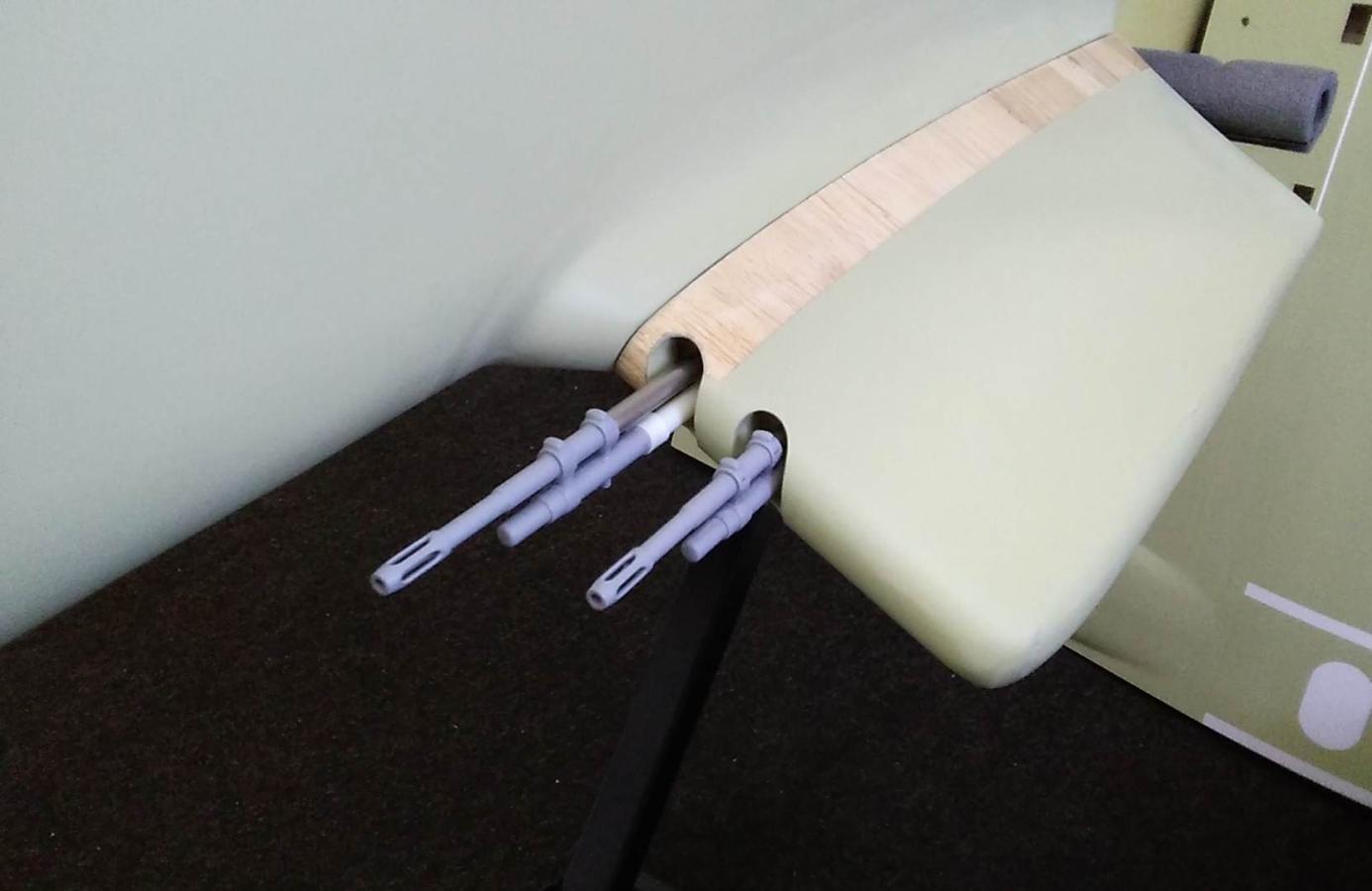

  • didier n
    Tim,
    I finally got the 3D printed guns, they look superb ! Thanks again!
    Some photo's of how they will fit in the OV 10 D
    Regards,
    Didier

  • Tim Anderson
    I hated to loose it , but don’t think I would build another , it flew nicely but was a pain in the butt to transport, awkward shape with wing panel on the booms and the center section with the winglets , I would prefer a design where the center and both booms stayed together, with outer wing panels removable, that way you could leave on the gear, the hangar9 is beautiful and a better design but have been on back order for ages now … and a significant investment, oh well so it goes. feel free to share the files with anyone who needs them!
  • didier n
    that's sad to hear, you'll make another one ? they fly great, that's why i bought the Hangar 9 one as well.
    It looks great !! i will now search someone with a resin printer, because sanding on such a part is out of the question i guess
    In the meantime there is some interest on Rc groups for these guns as well, do you mind if i share this information with them?
    thanks again, will let you know when i have results!
    regards,
    Didier
  • Tim Anderson
    Hope this helps, lost my nexa bronco this summer to a bad esc, total loss, congratulations on the hangar 9, much better design. Let me know if this works for you.
